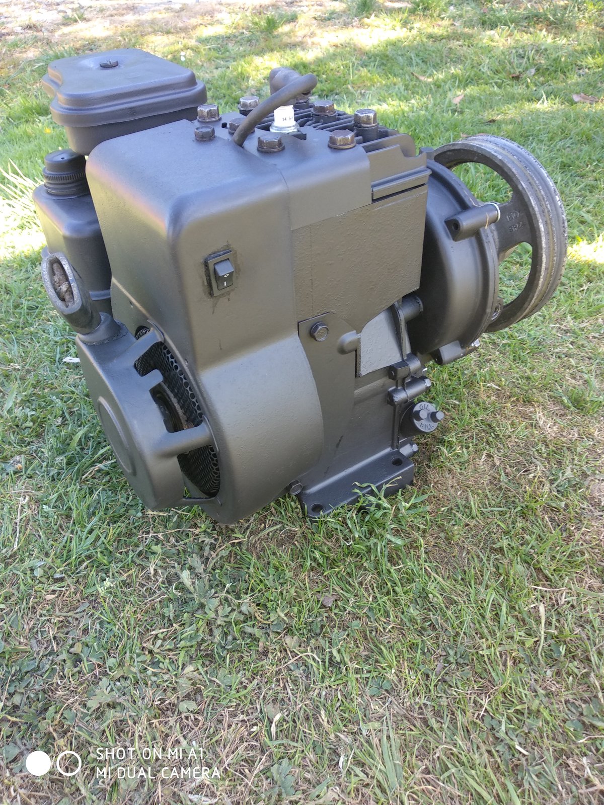

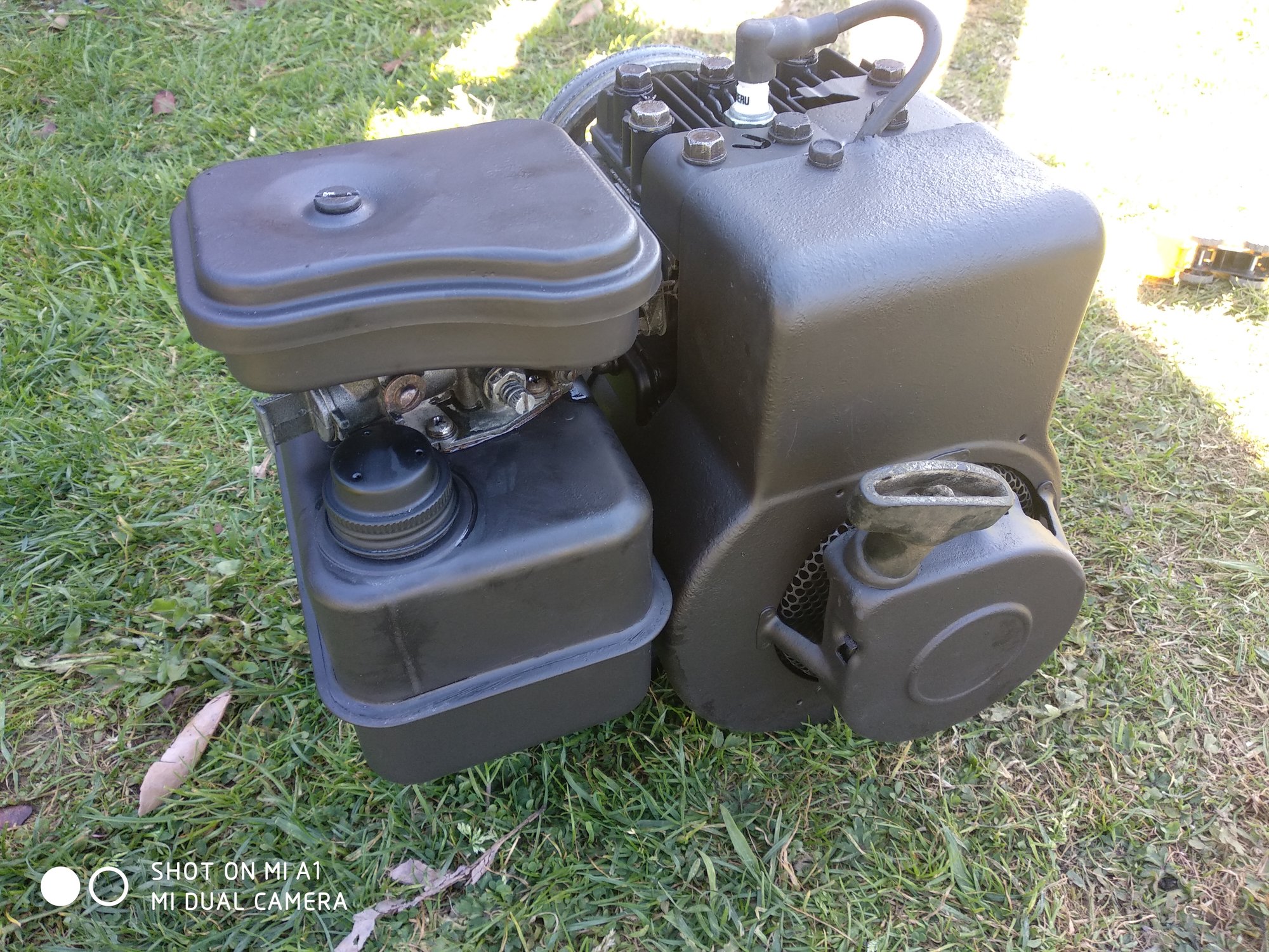

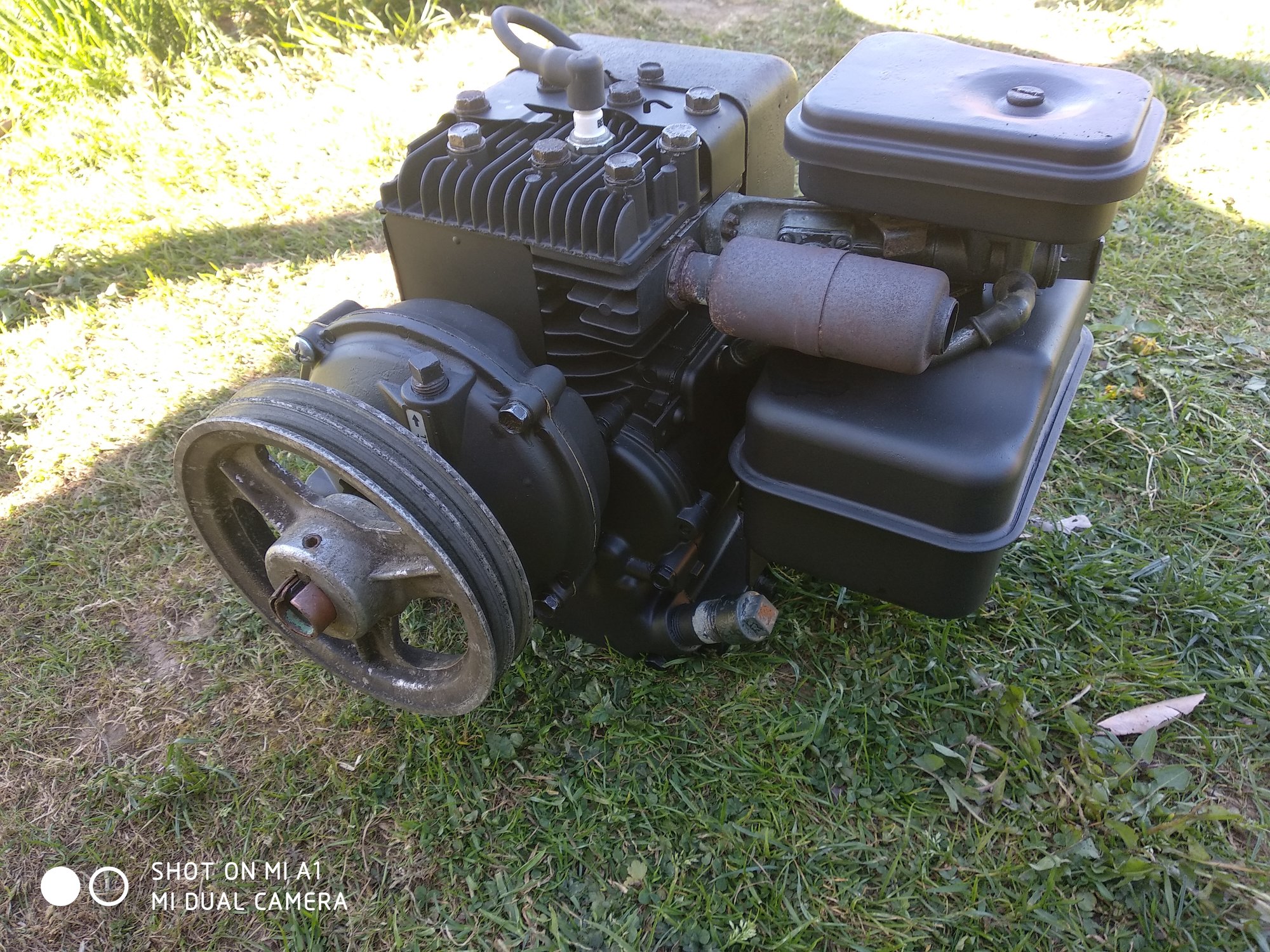

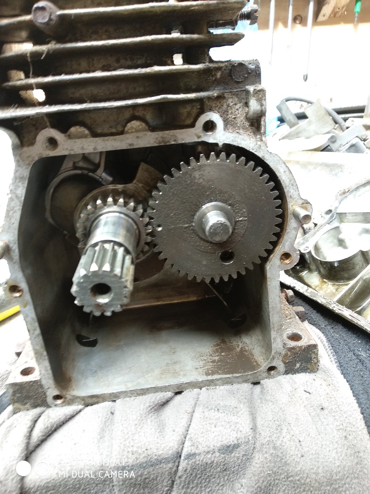

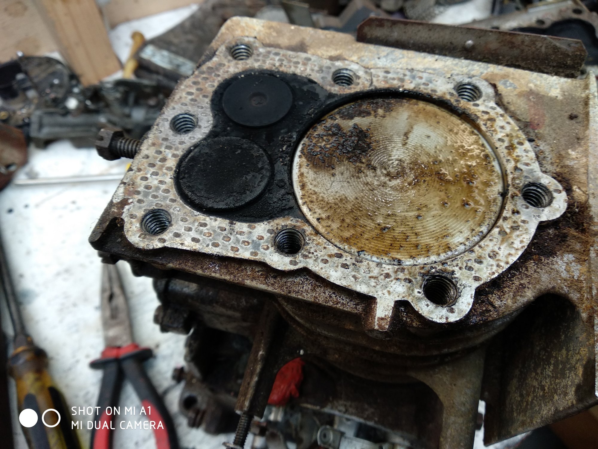

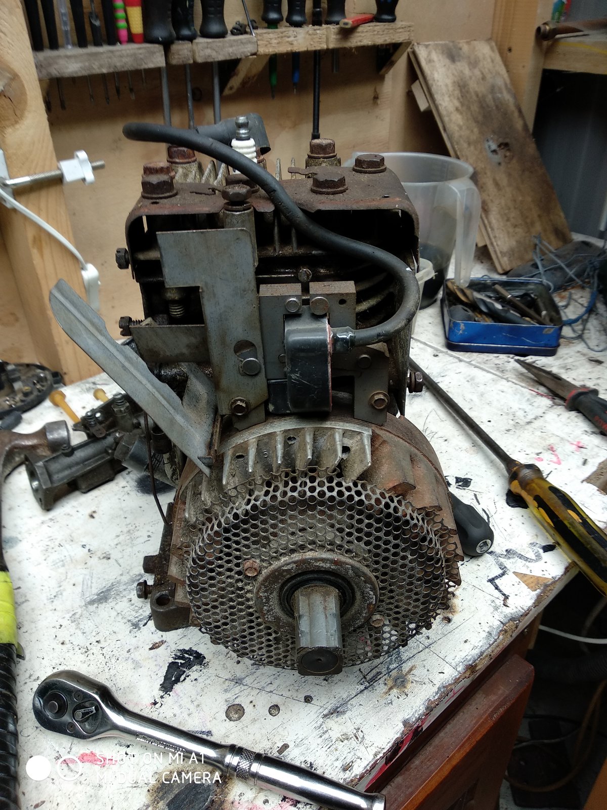

Nice idea for a thread. I'll chip in, started stripping my 3hp b&s engine. It originally from a hay bale lifter. It has a reduction gearbox. It will be stripped, cleaned, painted, new gaskets all that jazz. Piston and rings look ok and there is no carbon on the intake so I'll leave them alone I think. View attachment 227265 View attachment 227267 View attachment 227268

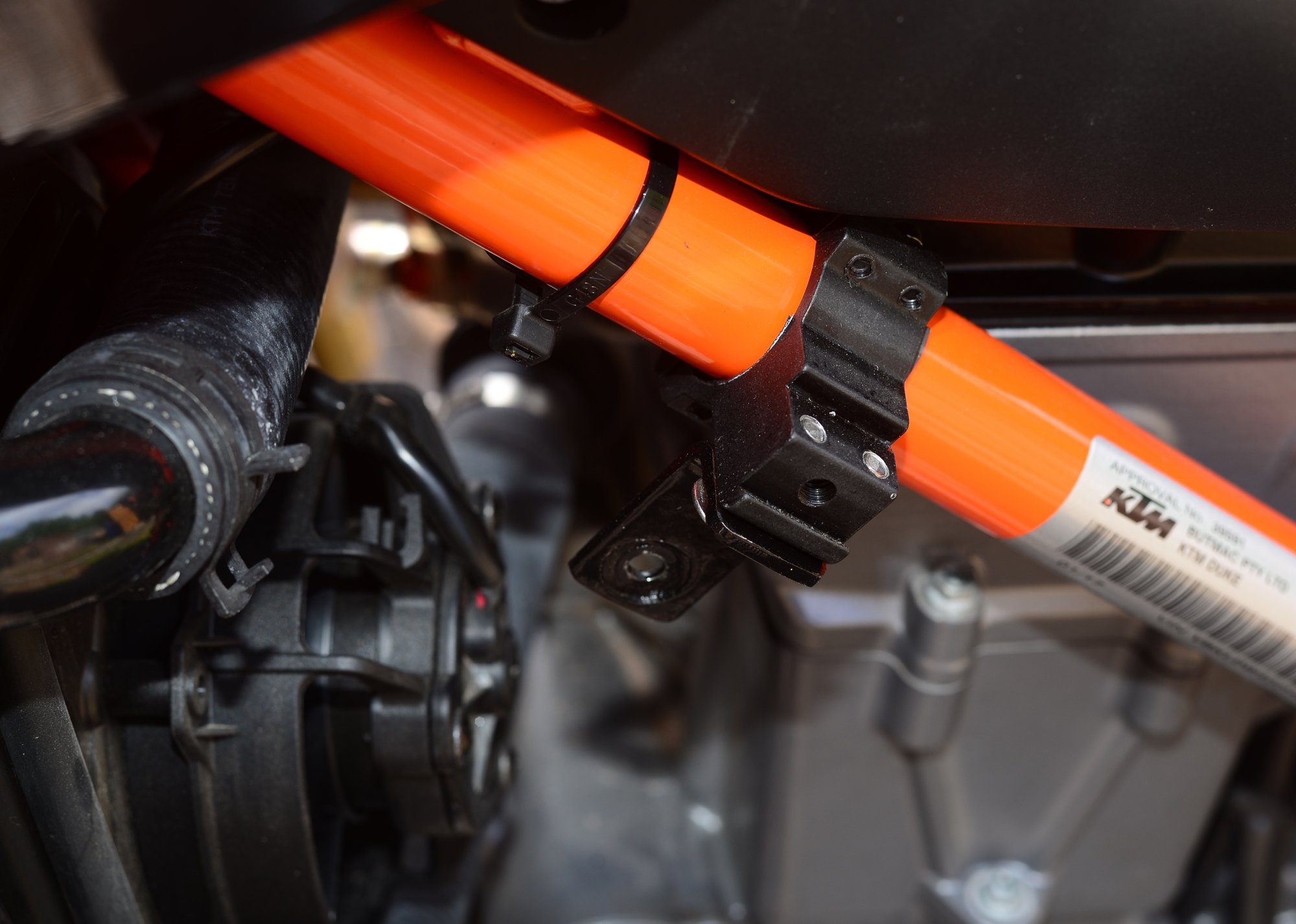

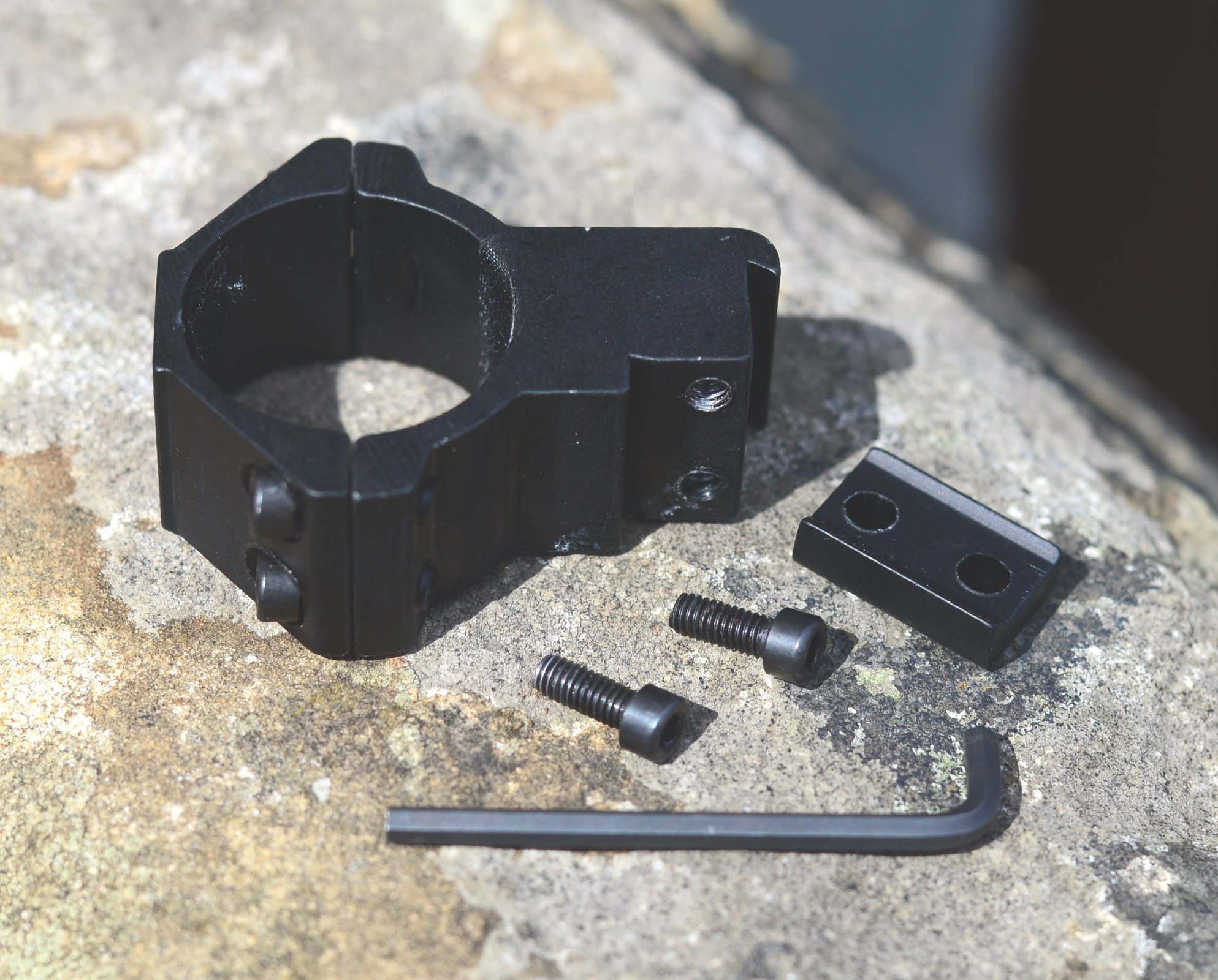

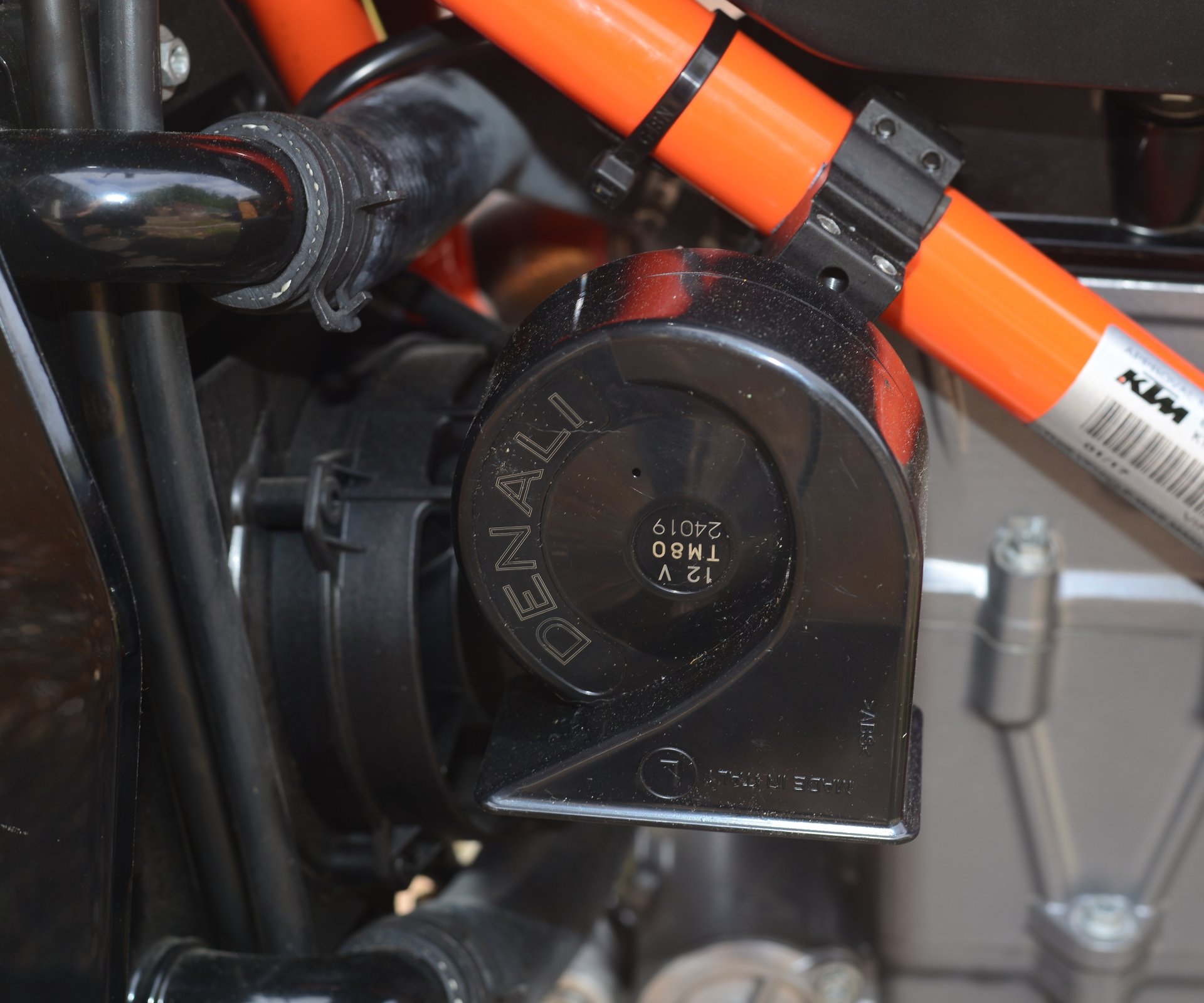

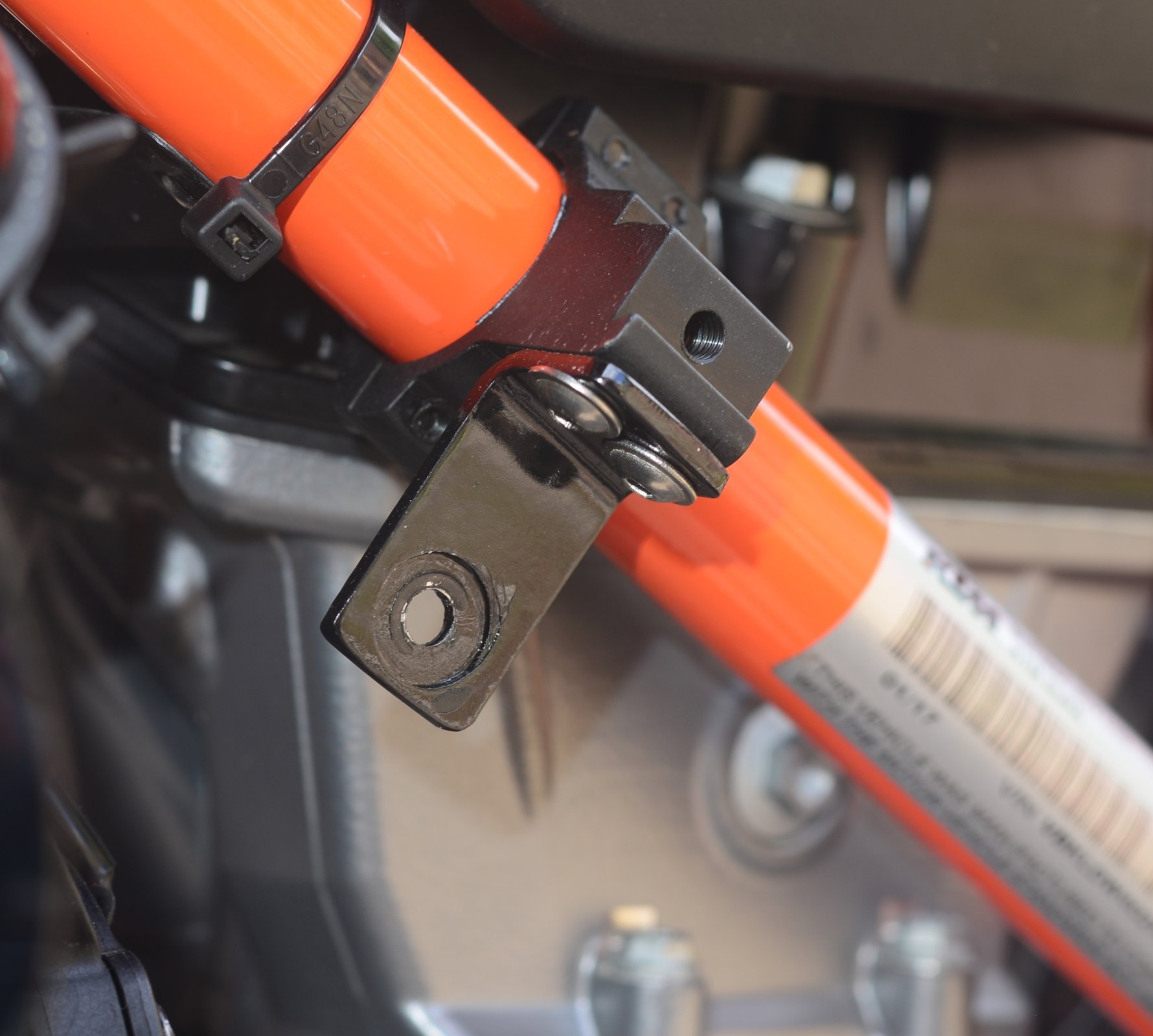

... one of the things I wanted to 'fix' was the anaemic standard horn....
Aye, what is it about motorcycle makers that they flog a bike costing the neck end of 20 grand and still fit it with something robbed from a 1960s scooter?
Even my Pan Euro had a fly's fart for a horn... until I bought a pair of twin-tones and shoe-horned them in - the fairings may look spacious but there's very little fresh air left behind them.
New relay and a dedicated feed from the battery and it sounds like a Scania (yes, I know, it weighs about the same as a Scania...)
