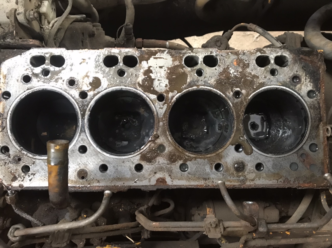

Not a lot but it’s losing its water into the oil. My initial thoughts were head gasket or slipped liners. Was hoping more for head gasket to be honest as liners are a nuisance.
Can’t find anything else where the water / oil are mixing.

Can we see an image of the bores and the piston tops?

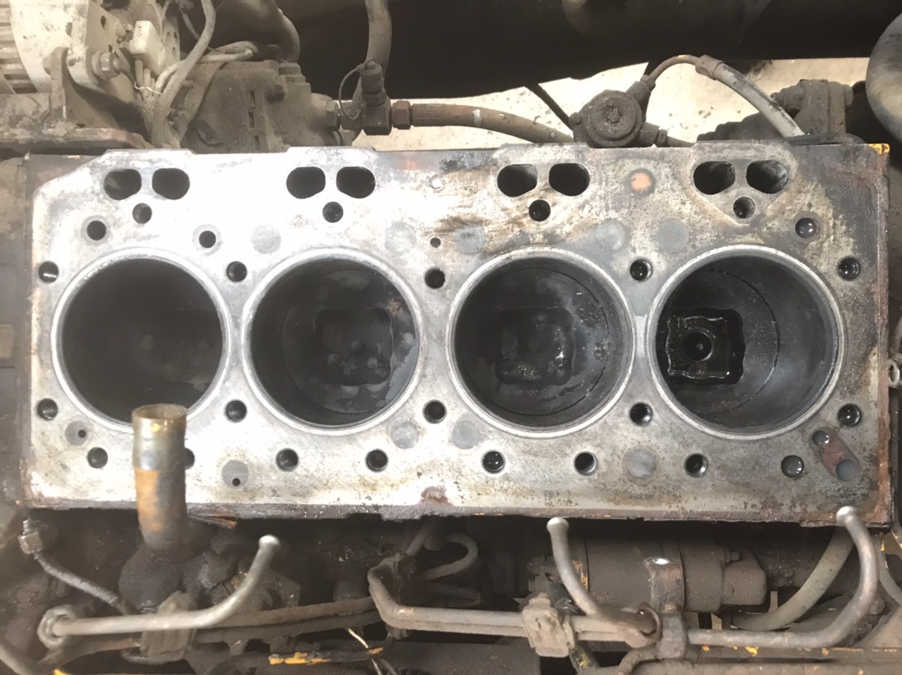

I think you've hit the nail on the head. I am still somewhat an armchair mechanic but having read up a lot on Perkins engines for my ongoing Fordson Perkins rebuild it is a common issue with these engines. Mine is a 3 cyclinder, but the proportions are similar - seemingly the cylinder spacing is such that its common for the head gasket to blow between a cylinder and the waterways.Having just re looked at the last picture I think it tells a lot? He had K-Seal'd the engine which has worked in my favour as a penetrant dye of sorts. Looks like although the gasket appeared to be fine it has lifted around 3?
The liners slipping is also a thing with these. To be honest its not something I would normally get involved in but its for a friend of a friend and he's a decent guy and everyone else is too busy.I think you've hit the nail on the head. I am still somewhat an armchair mechanic but having read up a lot on Perkins engines for my ongoing Fordson Perkins rebuild it is a common issue with these engines. Mine is a 3 cyclinder, but the proportions are similar - seemingly the cylinder spacing is such that its common for the head gasket to blow between a cylinder and the waterways.

Put a ruler over the bores and shine a light.It is but as @dobbslc says it works. Its not a bottle of rebuild hence people just keep adding it and avoiding the original issue
I'm not too worried about the sump gasket. I imagine RTV would be fine for this? Its what I've done countless others with and no problems yet, fingers crossed.
This was the hex headed bolts. I think it'd benefit from a new set to be honest. Hes keen to put money into it and keep the thing. I couldn't see any evidence of the liner having moved but not sure how the best way to tell would be? Looked like a hairline gap around them but they all had that and they're slightly undersize anyway to get them in?
Not a bit of a bodge A HUDGE BODGE.I'd not heard of K Seal before - it seems a bit of a bodge.
Thats what my plan was, sort of. Was thinking there would be a more approved way but then I think I was overthinking it, as per usual!Put a ruler over the bores and shine a light.
Look for gaps.
Simplest way to see if they have moved.
Unless the head was well and truly stuck and you haven't moves the crank they should be ok.
