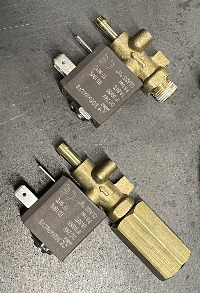

I think I've gas issues, had gas issues for a while

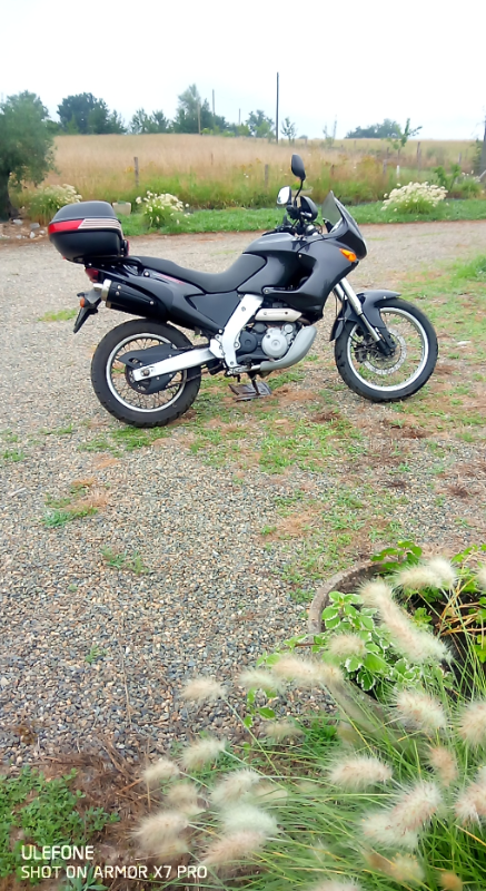

If there wasn't so much plastic in the proximity I probably wouldn't get to excited about it either, but you can see it's been melted quite a bit... They're renowned for it apparently..@MCKDAVID
The headers used to glow red on my T150 Trident when idling a long time stationary (waiting to board the IOM ferry). If they are single skin pipes and the plug is right I wouldn't worry about it too much.

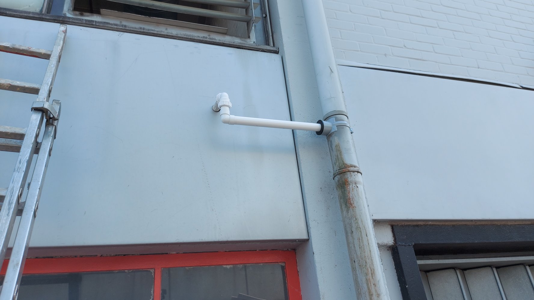

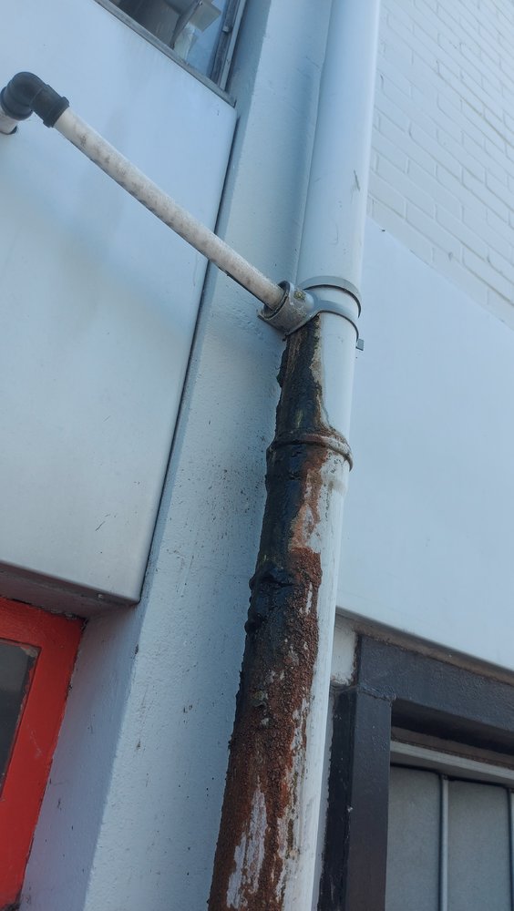

Dread to think what was leaking out of it.
Nice.........Begins with an s and ends in t !

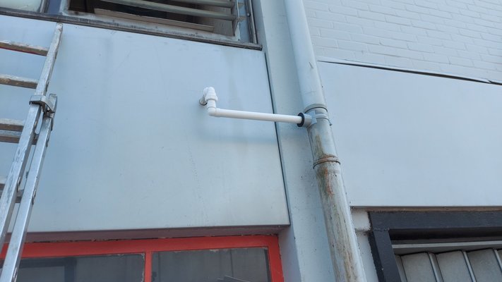

That's actually waste water from a compressor plantroom , they didn't glue the strap on boss to the soil pipe hence the detritus running down the outside ! Been leaking for a while

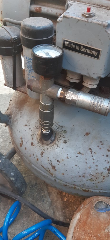

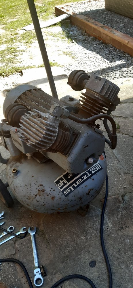

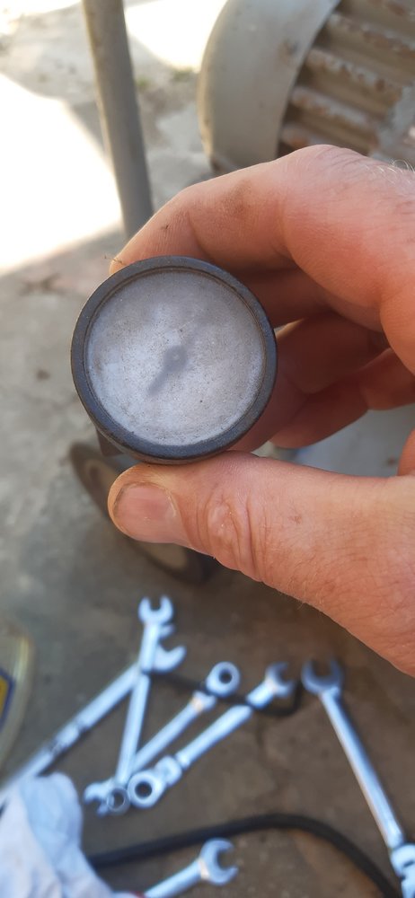

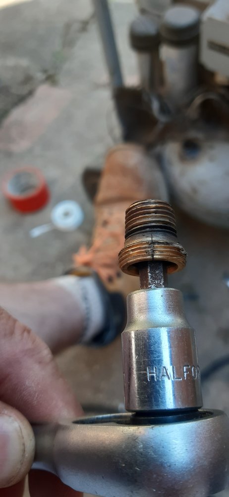

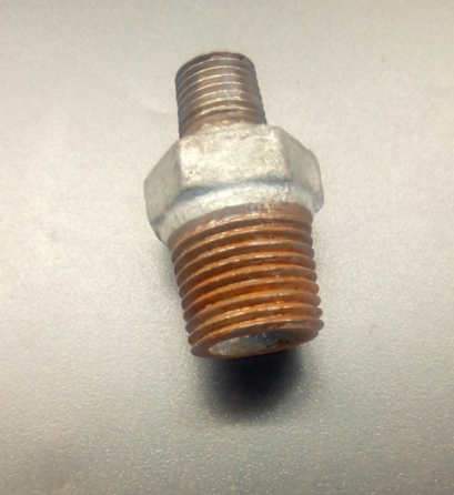

don't know where you'd get a specific one, but you would most likely be able to pick up a standard pipe nipple with the right thread sizes easily enough, if you have the room to get it in?I got this old compressor a few months back and finally had a go at fixing the leaks.
It leaked on the outlet of the tank and after a bit of heat I got the union out and found this
If anyone knows where I can get a new one let my know.
In the end to get it working I just fitted a PCL tail and a quick release fitting,

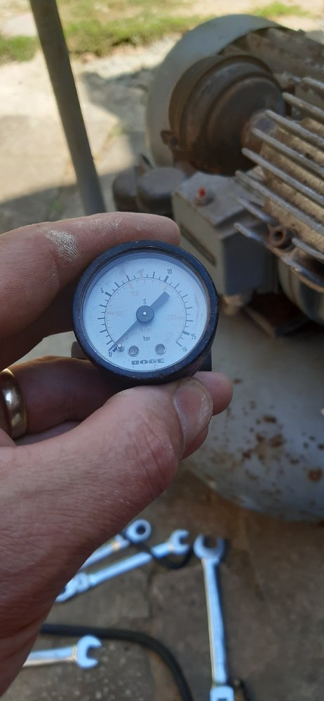

The pressure gauge was unreadable so I cleaned it with a bit of T Cut and it came out ok,
Before,
After,
All working

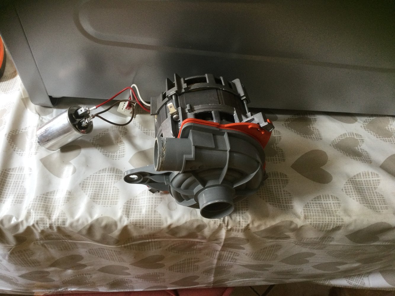

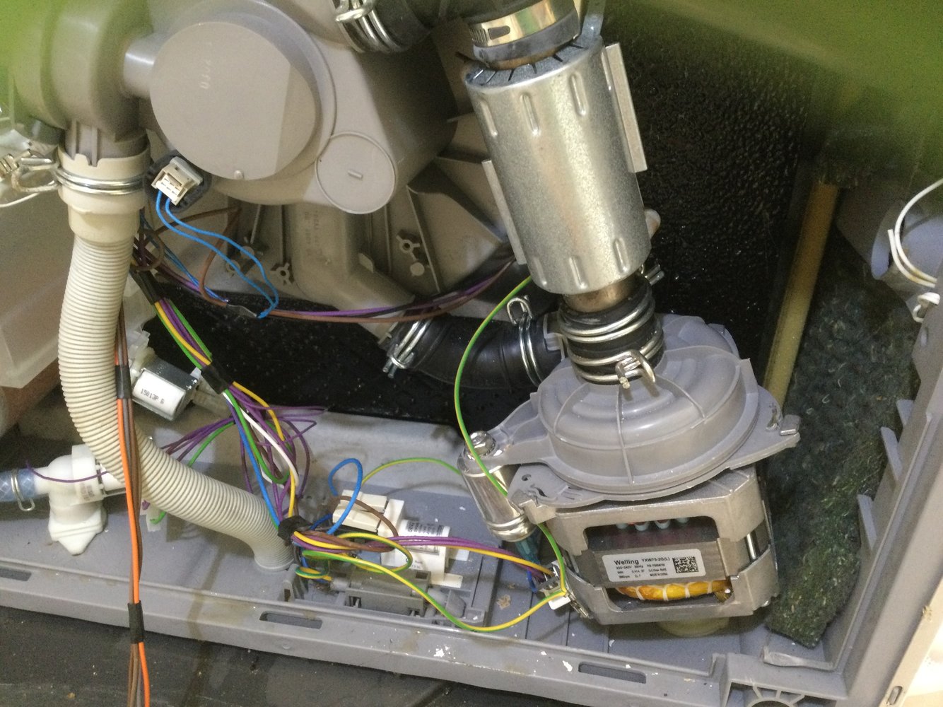

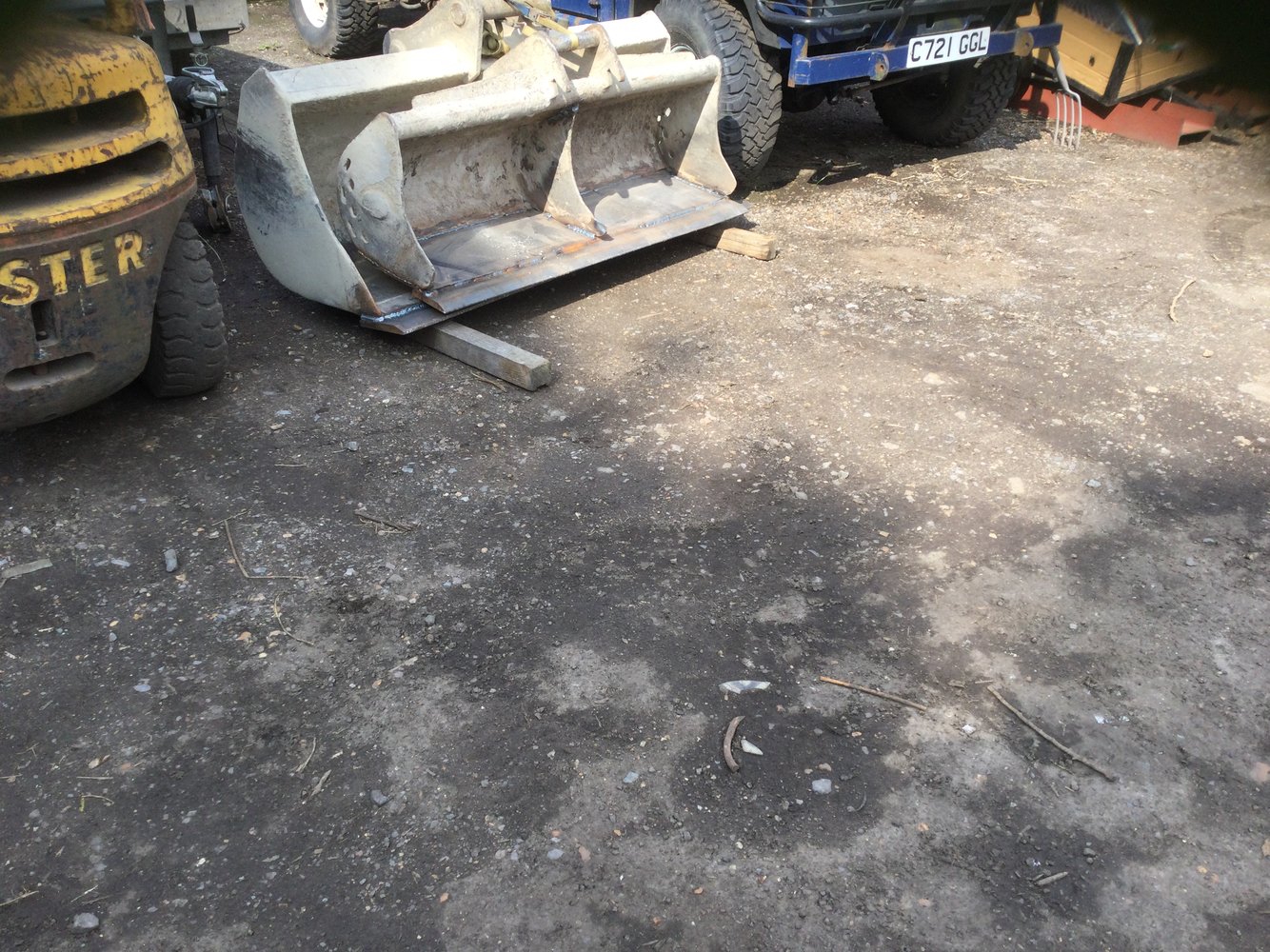

Kin hell. Not your buckets I hope?!Today I fixed the dishwasher because the motors hatitself. New one turned up on a clickncollect service next day
Fubared after it ate some glass that somehow got past the filter
Then made myself ill by letting a mate loose in the workshop so he could make a total balls up of repairing a couple of digger buckets. Complete waste of gas and mig wire
Had something similar happen some years ago. I think a little chunk of debris fell into the dishwasher sump while I had the filter screen pulled out for a few minutes for its monthly cleaning. Can't remember what the debris was...might have been a rivet from some salad tongs or something like that.Today I fixed the dishwasher because the motors hatitself. New one turned up on a clickncollect service next day
