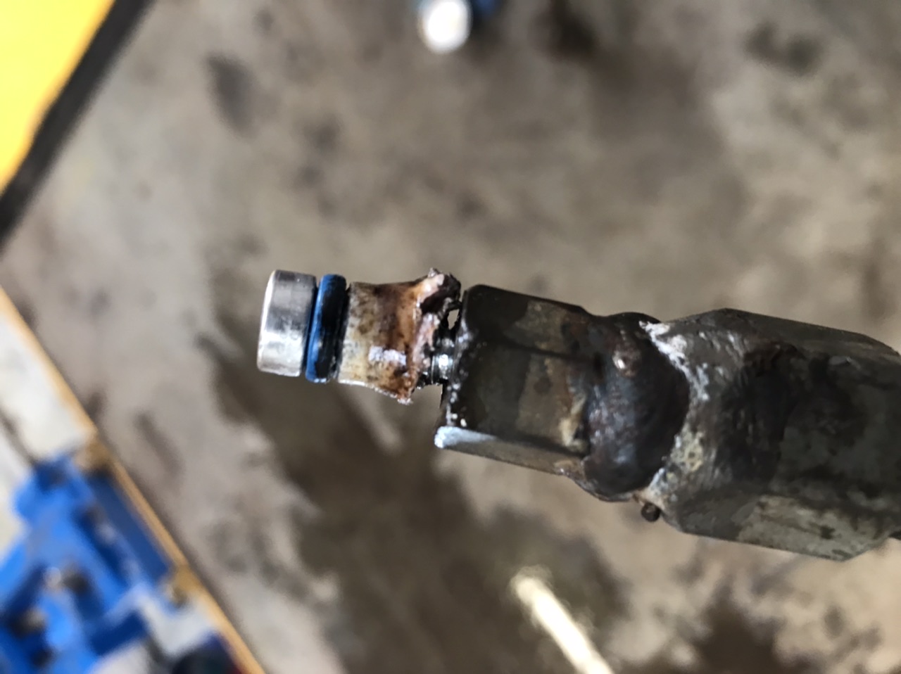

Usually a suitable torx bit hammered in get them out.New shape transit custom hard return PAS pipe from rack to reservoir.
It’s an alu pipe into a steel housing with a steel clamp and they corrode and fracture. I got asked to removed the broken off bit from inside the port on the rack
Plan A was to remove from van and machine it out. As I was passing I thought I would look. Stud extractor to break the oxide bond and a slide hammer / self tapper to remove it. Easy enough and happy customer.
No during pic as I was busy thinking!!
Anyone with these, check your pipes as it’s common. Feed pipe is mild and that didn’t look too clever either!
You do lots of them I take it.Usually a suitable torx bit hammered in get them out.
even the wife is now pleasant.
Lots.You do lots of them I take it.
it’s a stupid design!
Cos you Scottish boys aren’t shy with the salt!!Lots.
Strange thing is, chatting to colleagues further south, they hardly ever change them.
