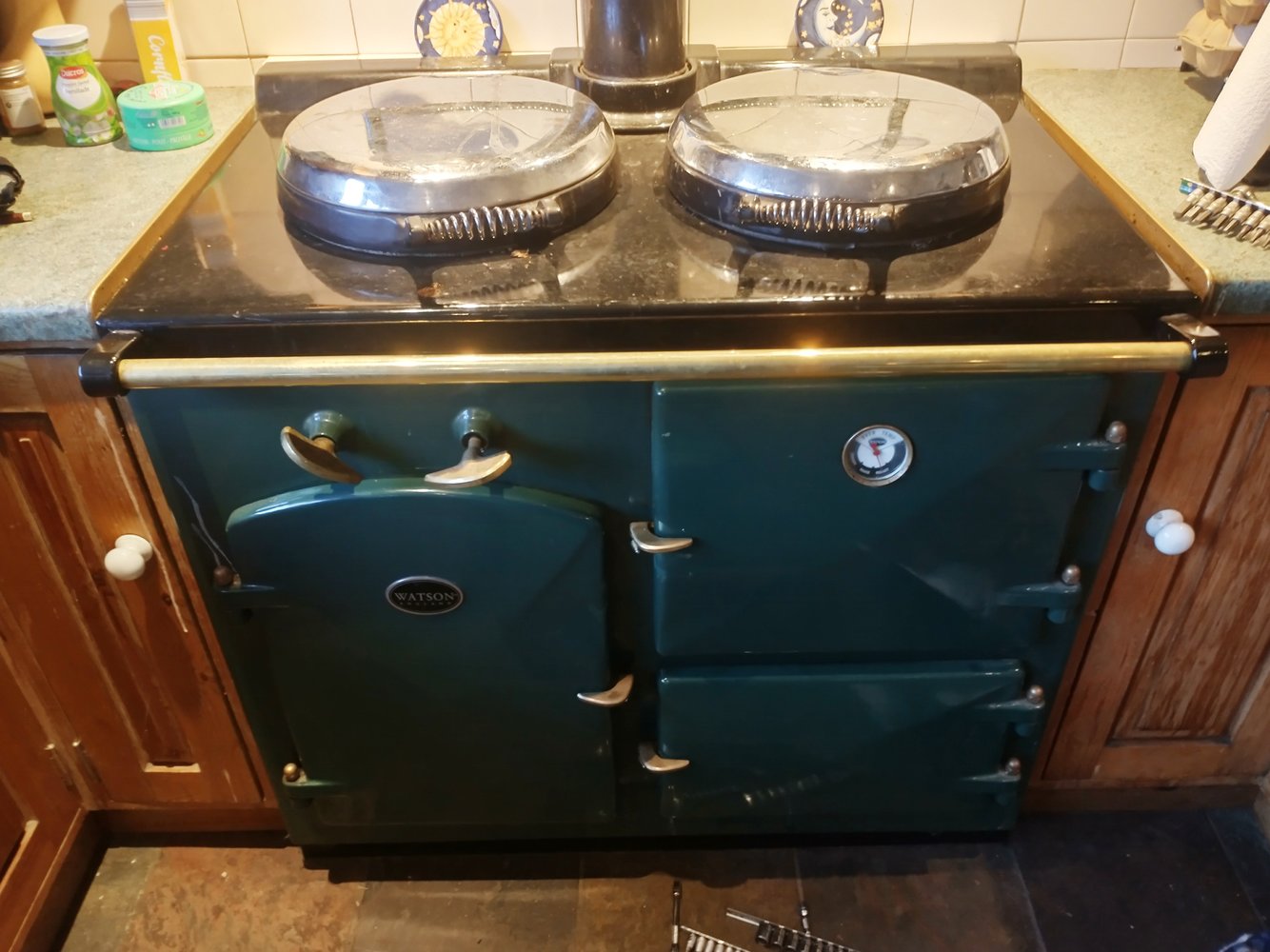

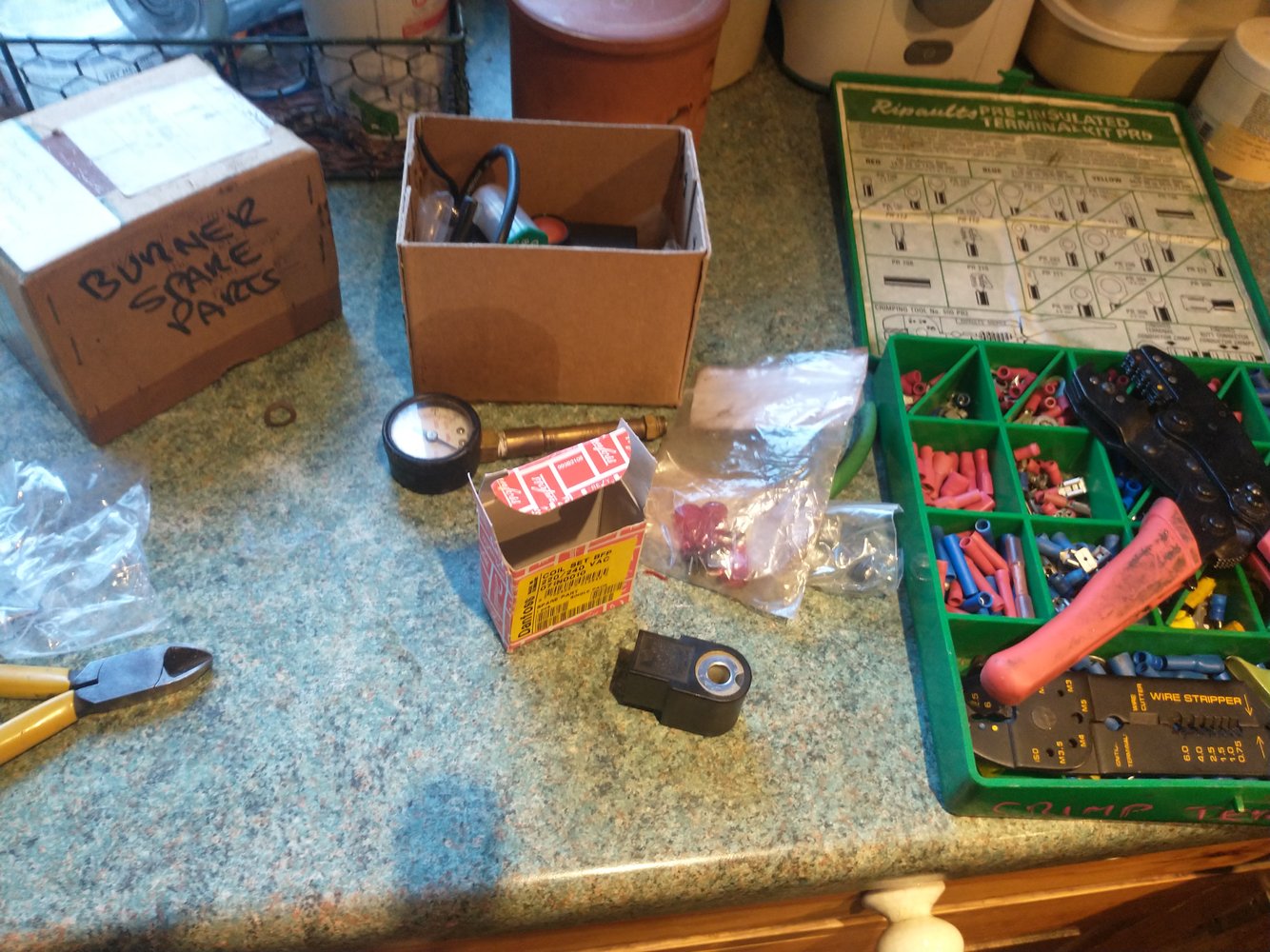

My AGA is pretty foolproof - uses a high tech wickWith exquisite timing our oil fired range went properly on the blink on Christmas morning. Once the cooker got fairly warm, the pressure burner would lock out. You have to wait several minutes before the 'lock out' button will allow the burner to re-light; 5 minutes burning, lockout again rinse and repeat. We had 8 guests, dinner was an hour late.
So, today with the range nice and cold, I removed the burner unit and unearthed my box of spare parts for the Ecoflam/Monoflam burner. With fingers crossed changed the Danfoss oil solenoid coil for a new one. Just tested it and it ran straight up to 180C without a hiccup. Testing the old solenoid with a meter shows that it's just fine, obviously the heat is revealing a break in the windings, the first time this happened (about ten years ago) it took me a long time to realise what the fault actually was.
BTW, the only company who I have found who are prepared to repair or service these Watson ranges is located somewhere up in Derbyshire. The bloke who does repairs seems to have a lead time of several weeks before he visits 'darn sarf'; hence my comprehensive spares kit, which now includes a ebay purchase used complete burner where the key components are the same as on 'our' Ecoflam unit.
Yep, I've had exactly that problem with one of those.Testing the old solenoid with a meter shows that it's just fine, obviously the heat is revealing a break in the windings,
