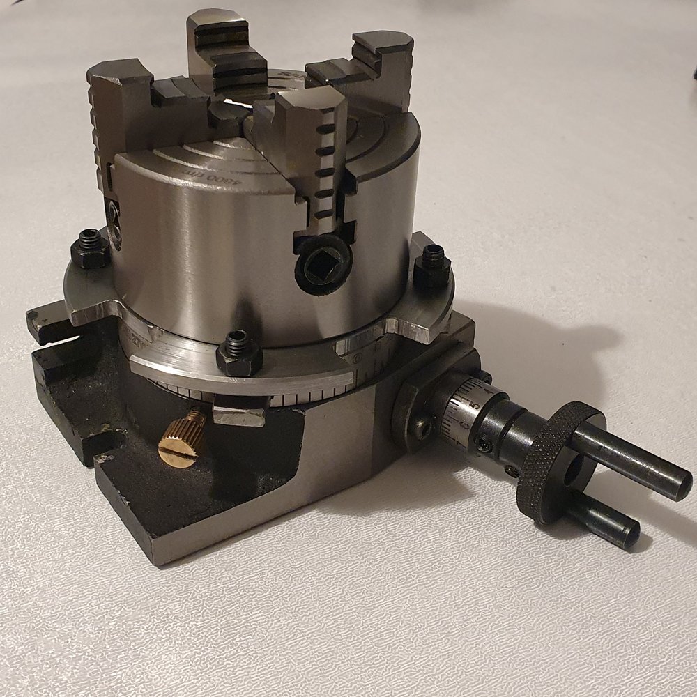

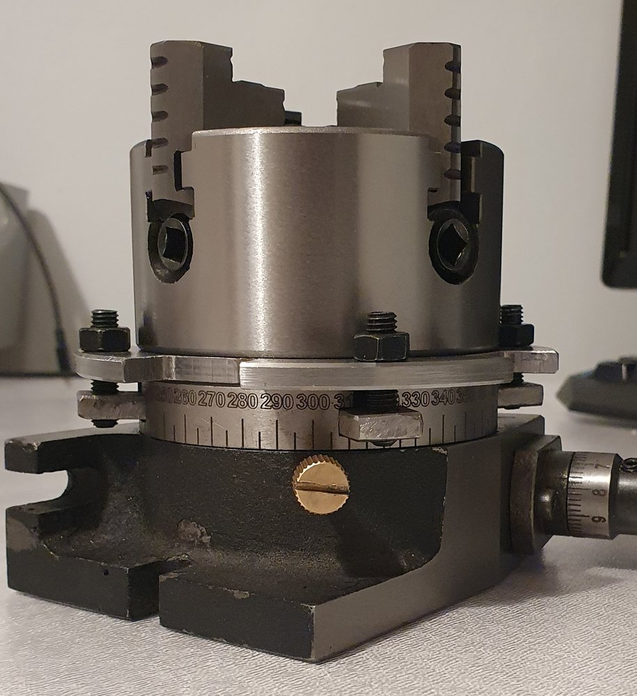

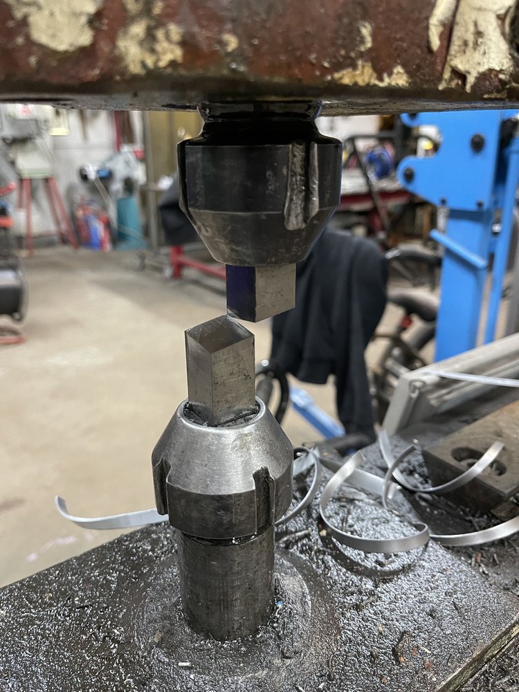

And voilà!
I know for a fact that each side of the plate are not perfectly parallel (like 0.01mm over 70mm which equates to 0.008°) so not an issue for my hobby stuff. Haven't tested the runout yet but I'm fairly certain both spigots are concentric and if not it'll only be a tiny bit.
Overall it was much cheaper than buying a new plate/plate+chuck and a nice experience (apart from the sharp as f*** end mill cuttings which I have to thank for my phone fingerprint unlock not working till they heal...)
