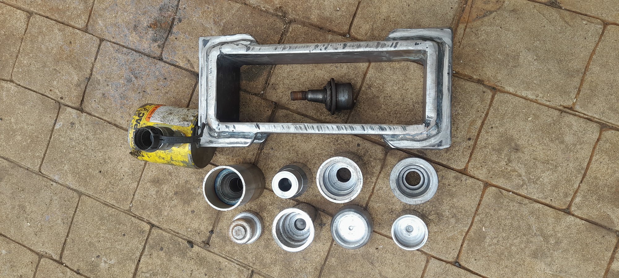

Put a bit of ram pressure on it then smack the eye end of the ball joint with a 2.5 engineers hammer that usually frees them long before you pump the 30 tons up .Made this a while ago it's for replacing steering axle knuckle ball joints on Disco's/P38 Ranges, lets just say they have a reputation to be a bit awkward and stubborn at times.
The 30 ton ram tends to move them...
Drawn on paper to prove then thought why am I messing about tracing this on 2D cad when I can draw it as a parametric and send straight to dxf. Few changes I'd make in future, in the corners, there's too much clearance. Then again in sheet metal it was set to 1.5mm and ive actually used 1.0mm.
View attachment 349025 View attachment 349026
It never gets to 30 tons, a 10 ton ram is a bit under powered at times (hammer assisted as you say, but I have heard of the eyes breaking off/cracking), so being as I own a 30 ton ram that's what I made the frame to fit.Put a bit of ram pressure on it then smack the eye end of the ball joint with a 2.5 engineers hammer that usually frees them long before you pump the 30 tons up .

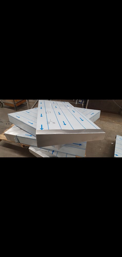

Lovely workNot made today, but finished off fabrication last week.. 2 of these tanks.

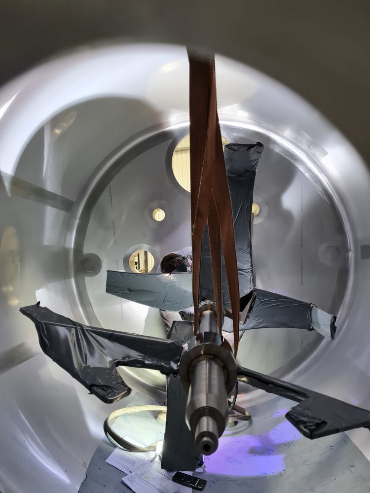

Agitators finally rocked up today, so installed one set. All passed through the manway in kit form, and paddles welded to the shaft inside, motor and box fitted on top. Just need to install the bottom bearings now, which means standing them up again... then lay down again for transport.

3mm 316 internal, 2mm 304 cladding. MostlyHow thick and what material ?

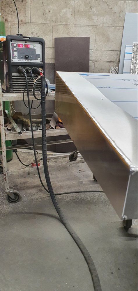

Lovely welding!A lot of these wall caps lately in all shapes and forms, fill them in then buff down, always full penn as some lads get heavy with the grinder
