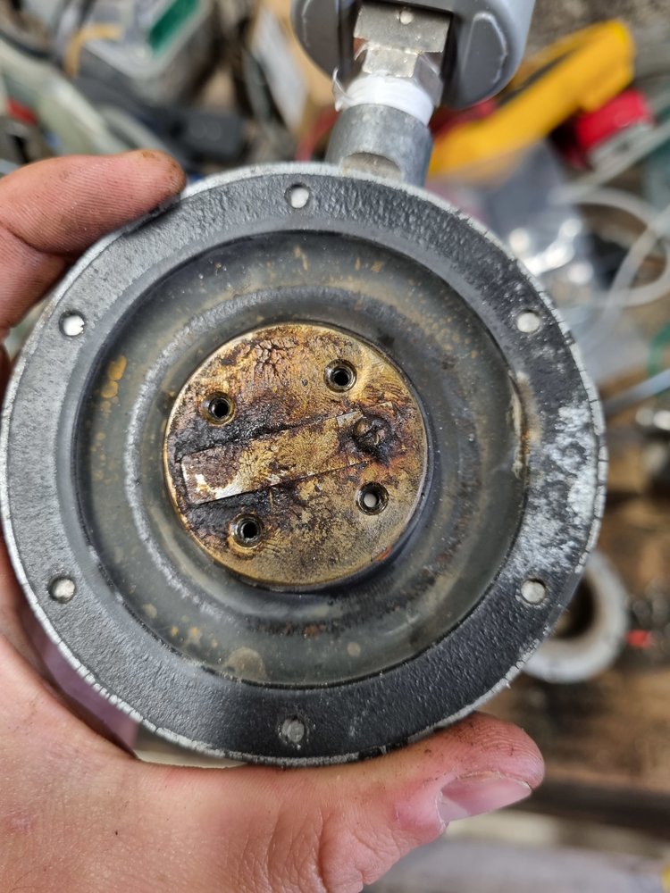

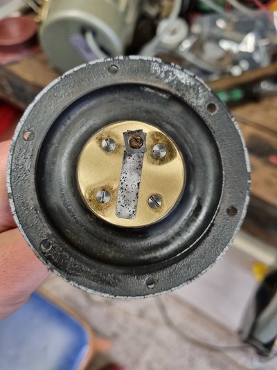

I've had it in my treasure pile for years waiting for a use. It occurred to me today it might work for vacuum filtration, so I stuck a gauge on it and the needle was bouncing between about 375 and 500 Torr, which dropped back to zero almost immediately. I took it apart expecting to find the diaphragms all perished and leaky but luckily they were fine, the reed valves however were seriously manky:
The tar came off easily enough but the sealing faces were corroded and pitted so I cleaned them up with wetstones, working up to 8000 grit, much better now (I didn't bother cleaning the pitting off the back face).
Tiny drop of light oil should keep them sealing tight, all back together and it easily pulls 625 Torr, which takes a few seconds to bleed back down to zero now. I put another gauge on the output and it makes it to 40psi before the PRV opens, not bad at all. No idea what it's rated for, where it came from or what it was used for, quality little unit though. There's a small leak where the diaphragm meets the casting, it's not a machined face so I might pull it apart again and see if a light skim on the lathe can get it to seal, maybe get a few more Torr out of it.

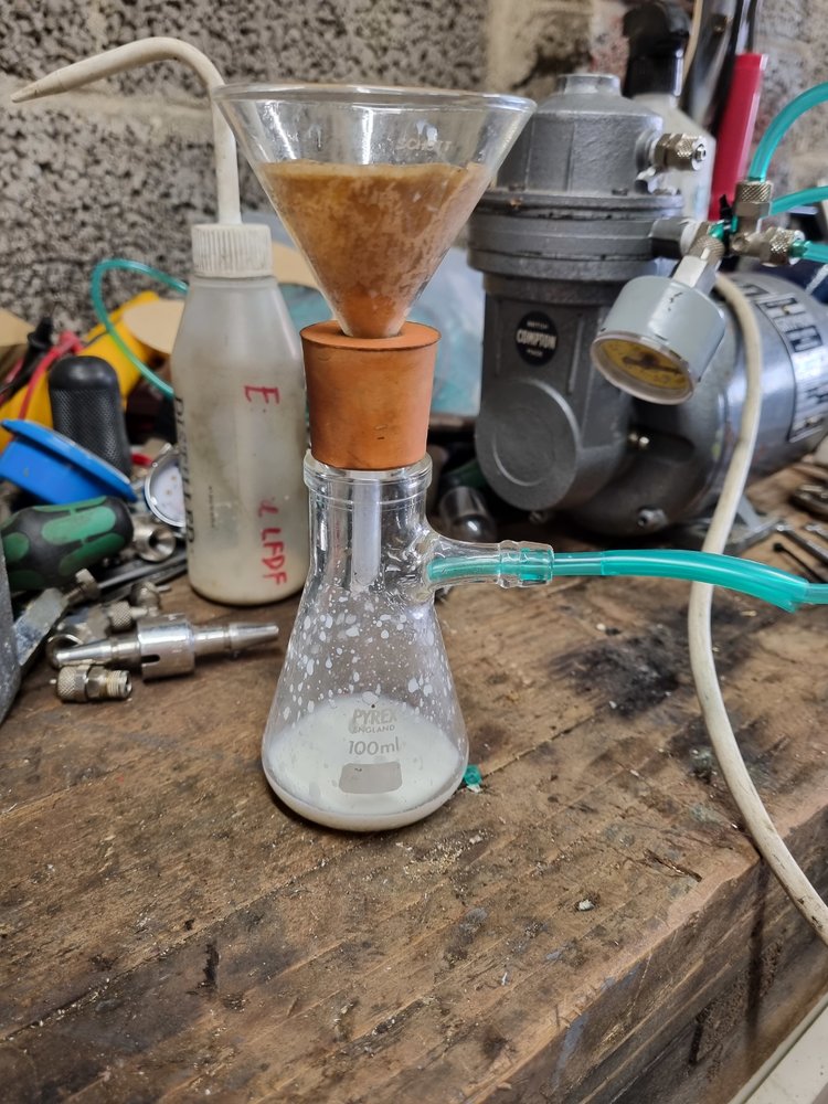

I of course had to try filtering something so had a rummage around and found a cute little side arm flask, a bung that didn't fit it and a narrow stem funnel (Exactly the type you wouldn't use for filtration). Cut a circle out of a coffee filter, filled it with cutting fluid, fired up the pump and it pulled it through in less than a second.
Looks like my cunning plan is gonna work, next job will be to make a big special Büchner funnel, something like this:
Stay tuned.![]()
What are you filtering with it?I made this old air pump suck twice as much.
3D print a funnel with drainage grooves on the inside , running into the funnels spout . .. giving you numerous ports & gullies for drainage down to the outlet pipeFoodstuffs mainly, all that Heston Blumenthal, molecular gastronomy crap.
It was actually dashi that's brought this on, there was a bit of stuff which passed through a sieve, I tried a coffee filter but it was taking forever so I just left it in, it didn't matter and the soup was delicious but it would be nice to have the option to easily filter broths and things in the future. My main use will be cold-brew coffee, I make a litre at a time and it always blocks normal coffee filters, which takes ages and usually needs the paper changing, it does need filtering too as I store it in a cream whipper under nitrogen and fines might make the valve leak. This setup should allow more area of the paper to actually filter, hopefully reducing clogging (In a V60 or Chemex there's really only a small circle at the tip of the cone that actually does any work), the extra force should make clogging less of an issue and generally speed the whole process up too. I asked how to solve this problem on here last year and was met with a resounding "Stop making cold coffee, you freak".![]()

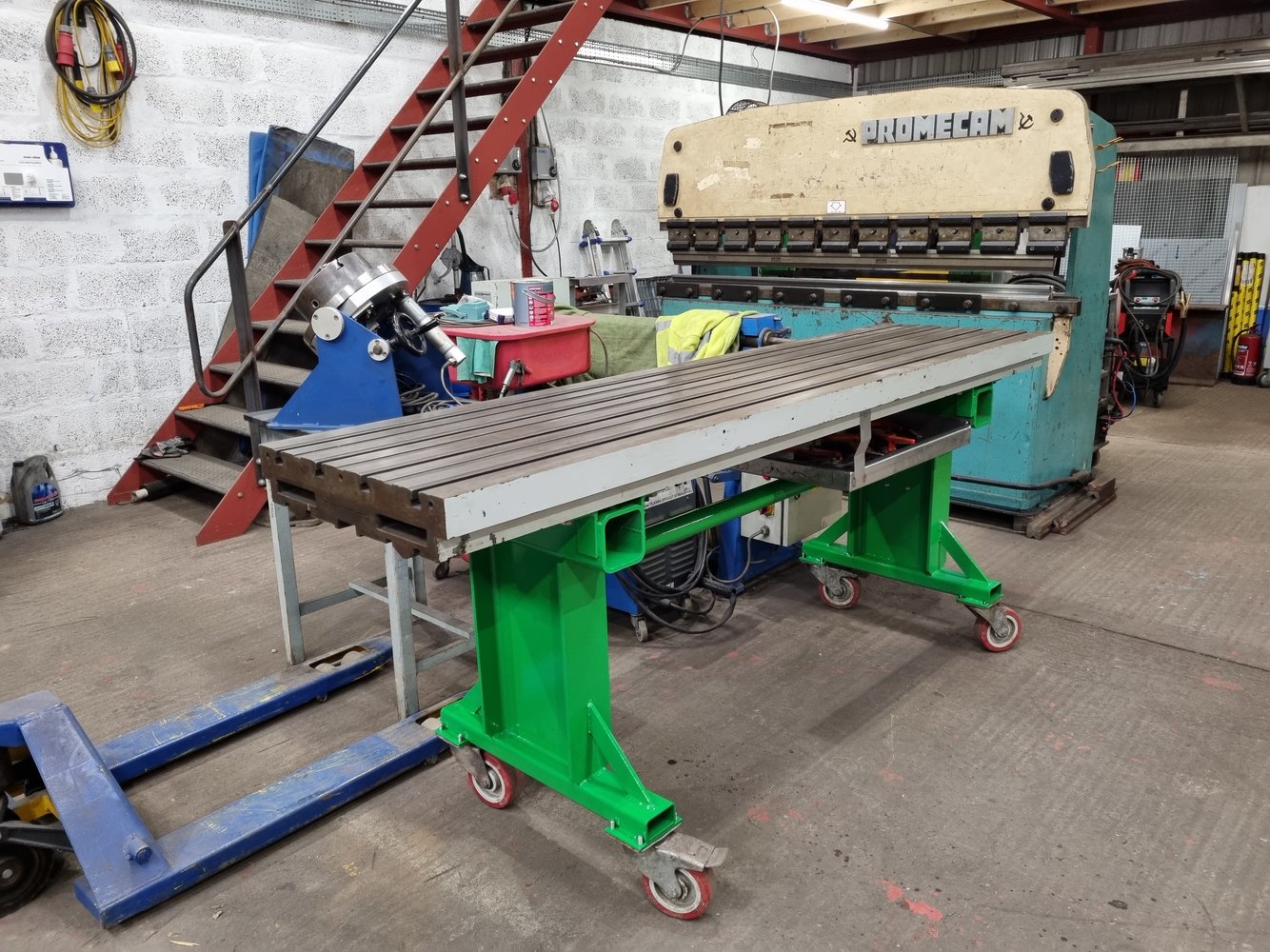

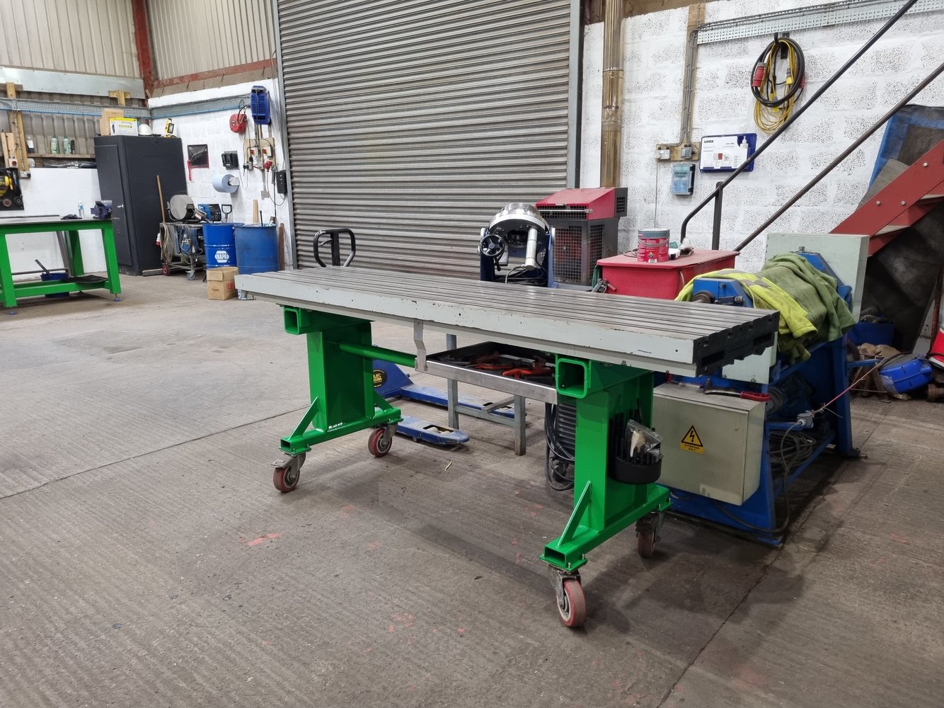

Nicely designed and made table, is that alu extrusion on the top ? Steel ?Made a leftover stainless steel tray fit the "heavy" which has just been painted this week now I've actually caught up with stuff needing done. Holds all the carver tee slot clamps etc.
ThanksNicely designed and made table, is that alu extrusion on the top ? Steel ?
Nice table anyway, nice drawer. Damnit, all nice.
Looks like a planer bed. Nice thing to haveThanksno actually its a machine bed with tee slots. The white paint on the side of it makes it confusing to look at but i didn't want to paint the bed as well as the frame. This might give a better impression
Very nice.Thanksno actually its a machine bed with tee slots. The white paint on the side of it makes it confusing to look at but i didn't want to paint the bed as well as the frame. This might give a better impression
