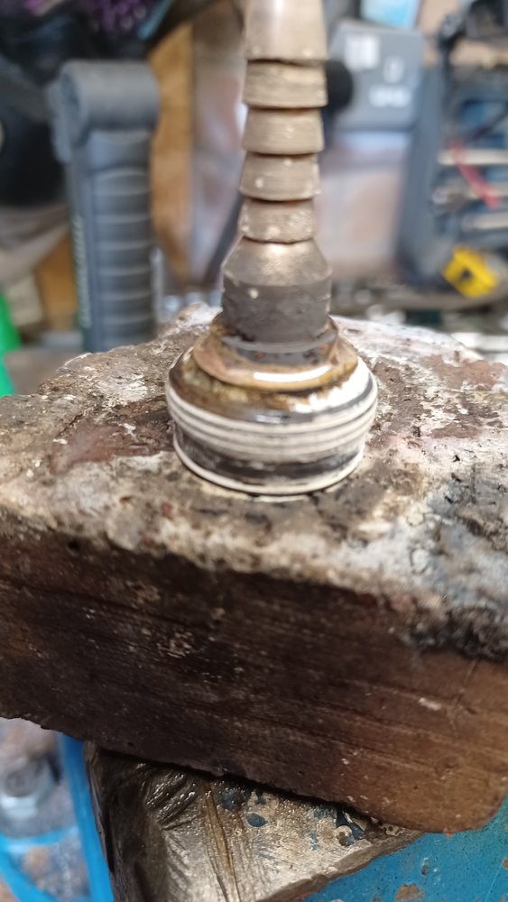

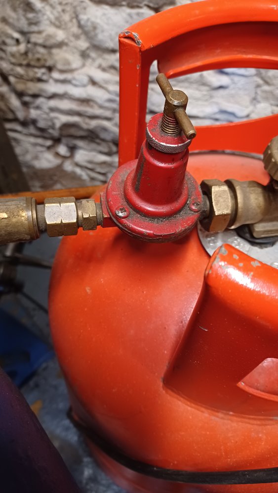

Does it work? I thought the direct attach torches had a big restriction to drop pressure down, and if your feeding it from a low pressure regulator, not much will get through?made up an adaptor so i can run a rothenberger off a big propane bottle
hacksawed the threaded end off its disposable bottle and silver soldered a hose tail on it , worked oiland chalk into the theads to stop them scaling

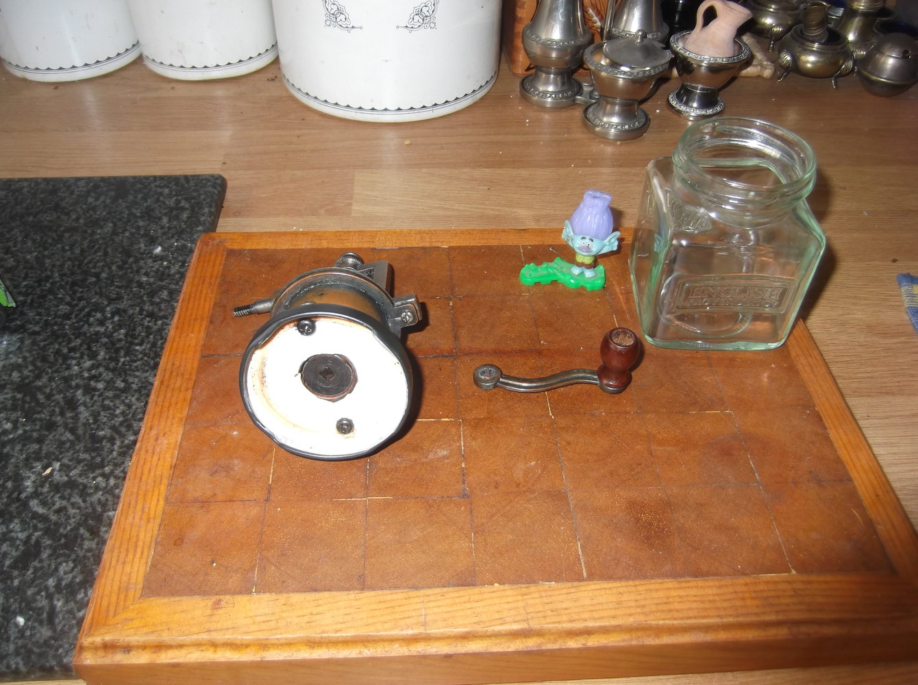

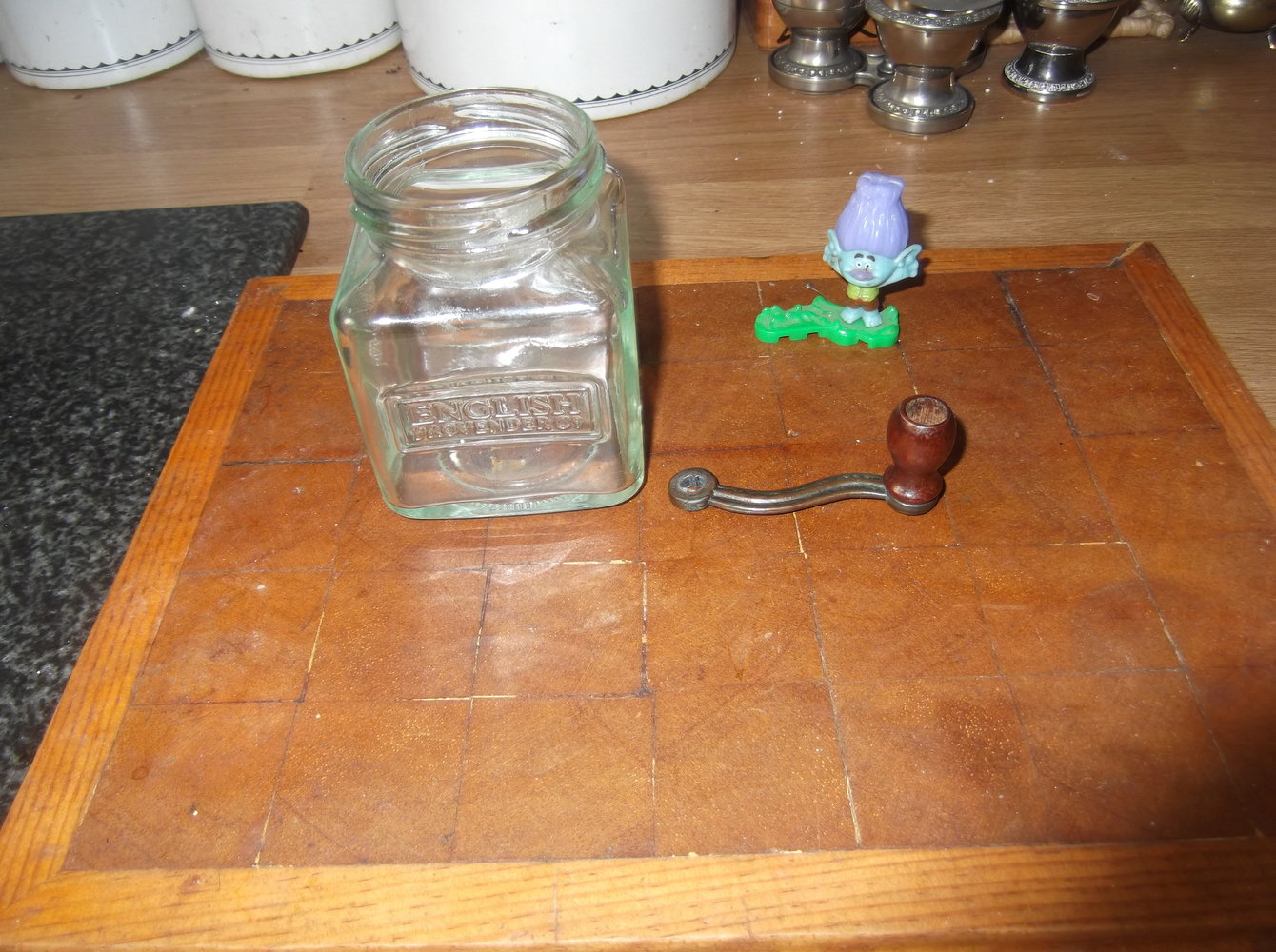

Theses two items have been waiting to have something done to them for a while.
I found a lid, that fitted the jar. The dark stains are were the paint cracked off.
It has been re painted.
The grinder attachment was found in the dead pile of a charity shop.
Just need one nut to finish.
