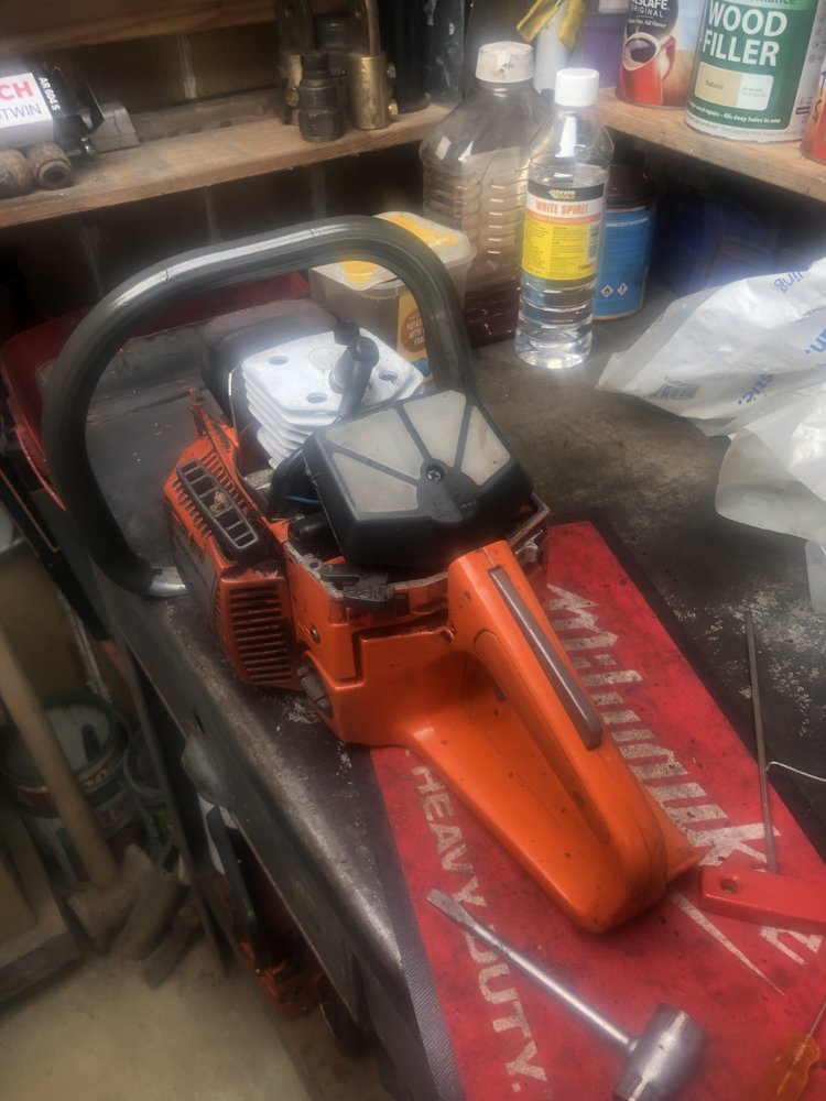

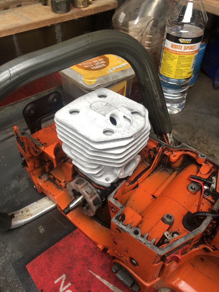

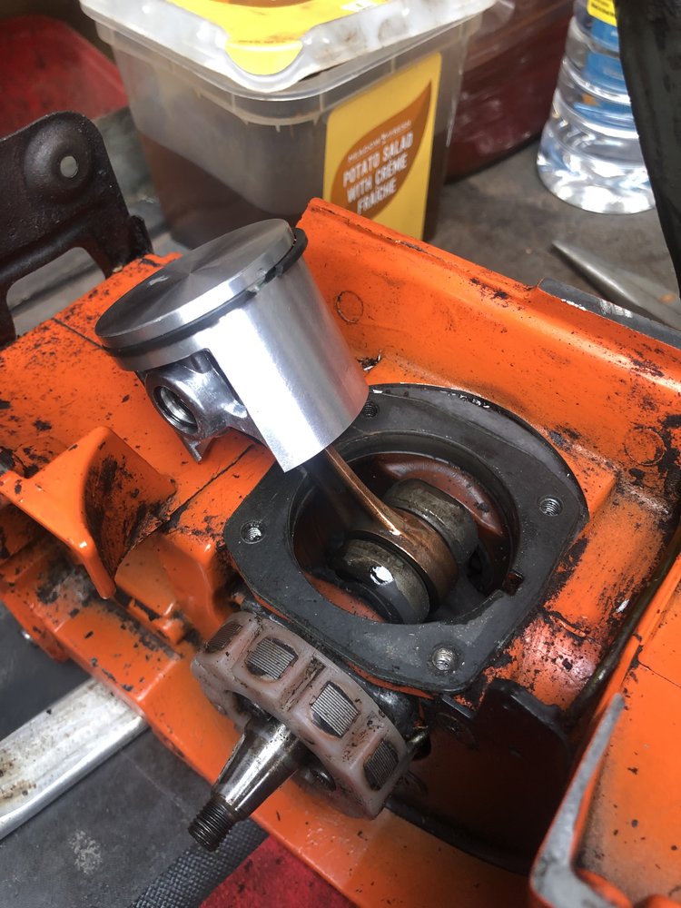

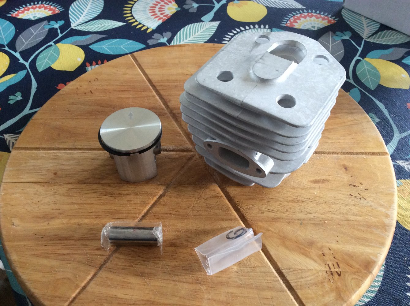

Once you get the dull grey colour in the barrel , usually on the thrust side of the piston travel it's time to replace barrel & piston as the chromed surface has worn away & it won't belong before the piston rings start picking up off the cylinder walls .This showed up yesterday, everything in the right orientation, holes in the right places. No toughness in the bore or on the piston that I can feel. I had this ordered before I tried cleaning the old cylinder with oven cleaner. It’s nice and smooth, there is like a dark shadow that I can’t shift. Might just buy another piston and use it and the old cylinder on the other 254 I have.
....If you do a fair few overhauls it's sensible to modify a chainsaw spark plug so it becomes a screw in compression gauge . Then start recording what a fully repaired saw registeres after a complete over haul with pot, piston and crank seals ...pressure test wet & dry are for all the properly repairs gear is .
It a doddle to whip off the air filter , wash of the plug area , give it a breath off an air line , remove the plug & insert the tester . open the throttle wide and pull it over three times ..... doing both a wet & dry test .
That way within 3 to 4 minutes you can tell the owner what it will cost to repair and not be left with a scrap chainsaw and a loss of income due to time taken investigating things when they don't come back to you for a repair or a new one .
I rarely did a pot & piston without replacing the crank seals as well as checking the float of the con rod on the crank . engraved the job number on the body & wrote every thing down on the invoices /quotes as I kept a copy .

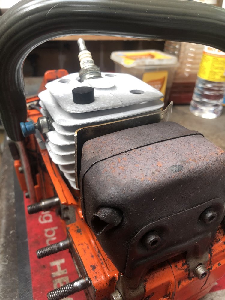

Were you in your Mankini?First start up went well, two or three pulls and she went. Needs tuned but she’s alive! Tried to put the video up but can’t. Me jumping about like a loon shouting, she’s alive she’s alive was quite funny. Shame none of you will see it![]()

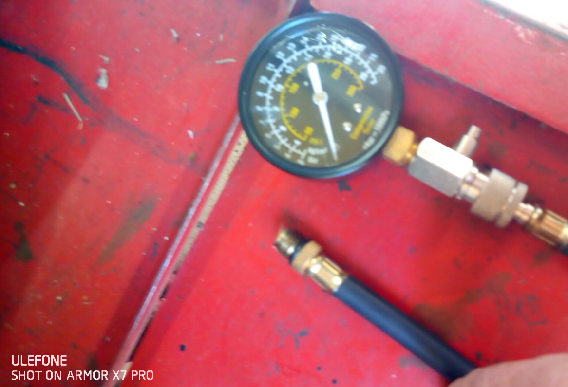

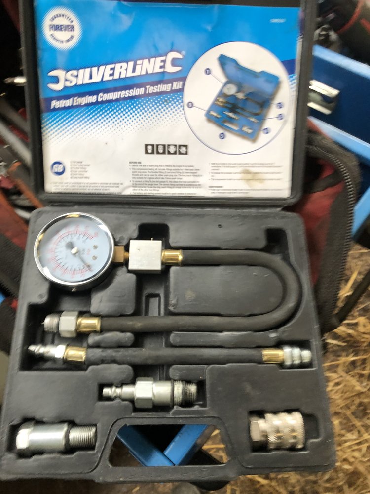

This one lives in the truckFunnily enough I’ve been looking at pressure testing kits.
Do you get a decent range of adaptors for that tester gauge set ?Agree entirely, first thing I do when anything small engine comes in... best thirty quid you'll spend, plug out, that tells you how it's running, two minutes later you know compression, so like you say three to four minutes you pretty much have the history of the machine.
You have to be careful with the reach of the thread of the adaptor check it is the same length or less than the spark plug thread & gasket or you might belt the piston head on the overly longer threads .

came with a couple of bigger sizes that this one screws into, I don't do cars or such, so pretty much have this one dedicated to the chainsaws, and small engine stuff,Do you get a decent range of adaptors for that tester gauge set ?
I had a set with three adaptors and none fitted the disc or chain saws Partner,Sthil , Jonneer . Husky or Maculloch 's ( sp ? ) , so I brazed the biggest adaptor on top of a spark plug that I'd knocked & cleaned out the ceramics from and taken off the earth electrode .

I also used to own a Gunson colour tune with a hand full of adaptors , lovely bit of kit but no adaptor for the two stroke saws at the time .

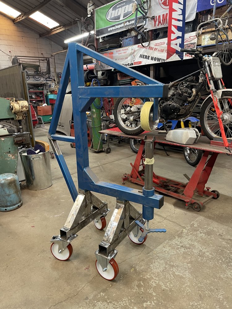

Two non swivelling wheels perpendicular to the “wheeling” wheel on the front and two locking swivelling wheels on the back to keep it from rolling when in use.How do you stop it moving around when you use it...??
