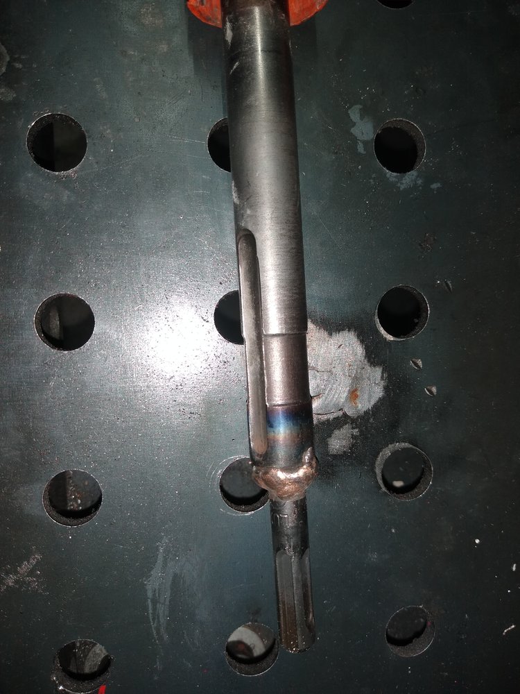

It wasn't intendedWhy?![]()
Unfortunately not however it was provided by my previous employer so wont have been the best i imagine, APT is whats primted on it.@paulmitchell1984
It wasn't one of those bargain carbide burrs from Ebay that everyone was buying recently was it?

Nothing wrong with it, from the colour you have allowed it to overheat to 300c+ and the brazed joint has let go. Braze may have a melting of 600-950c but the working temp is only upto 250c, they all loose strength above that. Not many burrs are solid carbide, branded or not.
