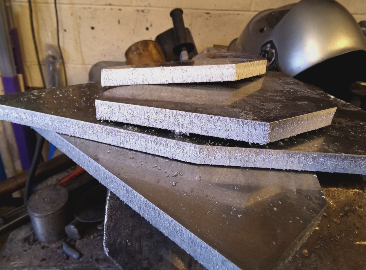

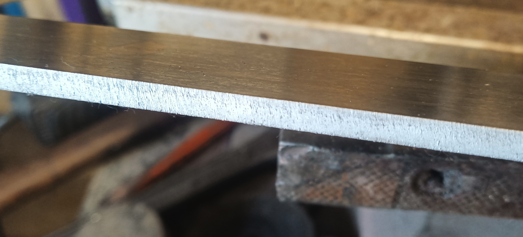

Was cutting some more 5mm 5083 up today and remembered to take a close up pic for youWhat is the cut surface finish on the alloy? Have you tried the raise the water level yet?
AluminiumLovely work @Cheesie! Are they stainless or alloy?
And for completeness here is the finish on 12mm 5083What is the cut surface finish on the alloy? Have you tried the raise the water level yet?

How much energy does the water jet use? Some of them are scary I understand.And for completeness here is the finish on 12mm 5083

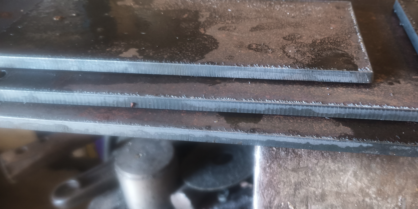

And as I have also just cut some 5mm steel I took a pic.
Consumables, if anything, are lasting a bit longer but it has been a while so... It is certainly no worse, I can say that with confidence. Regarding the torch, so far it has been fine and that must be a couple of years.All top dross, not much at all on the bottom

It is plasma.How much energy does the water jet use? Some of them are scary I understand.
Meant to say there is no bottom dross on the steel and the top just falls off if you wipe your finger over it as it just a fine spray like dross.All top dross, not much at all on the bottom

Ahh sorry I misread - thought it looked rough for water.It is plasma.
