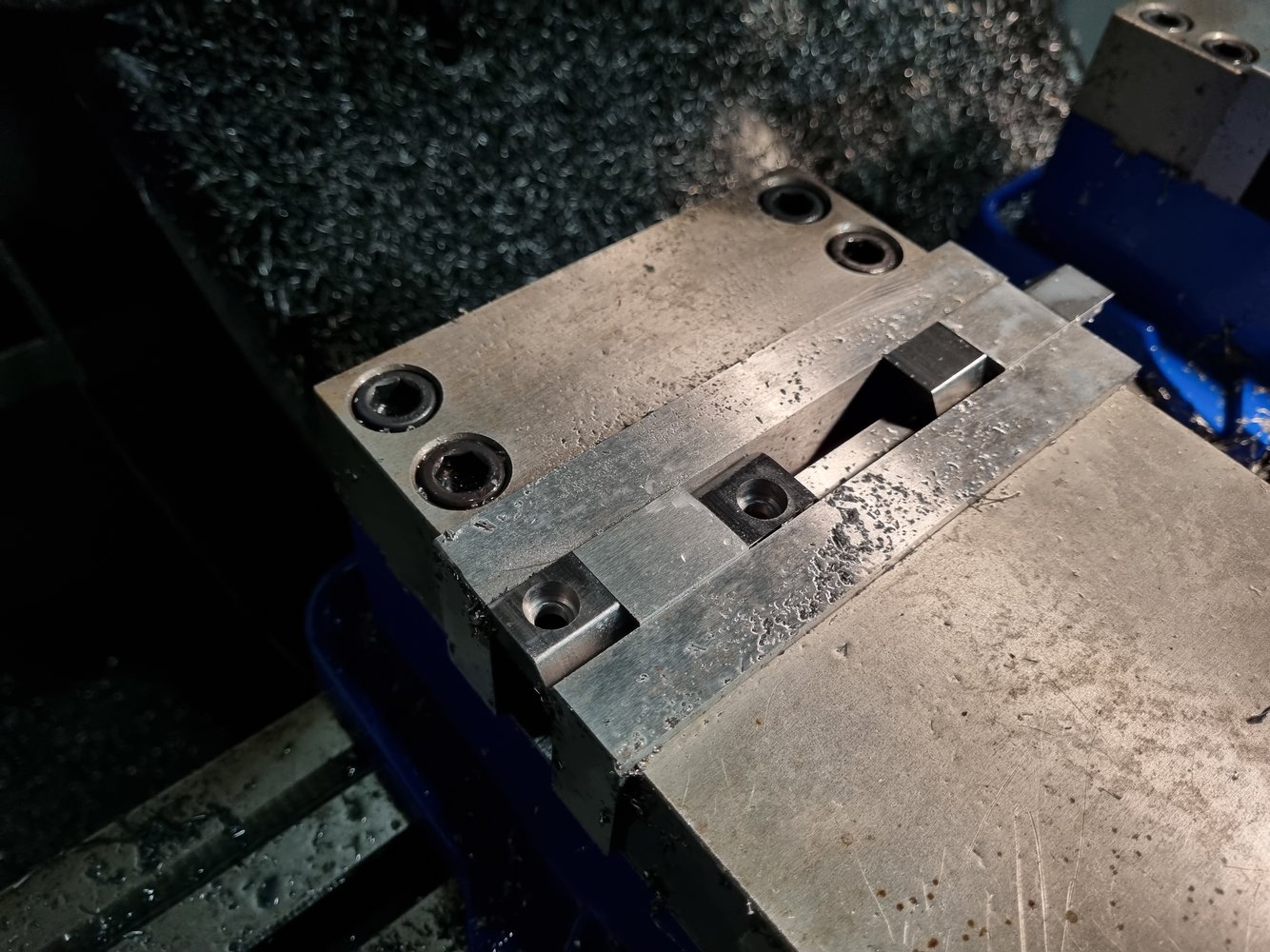

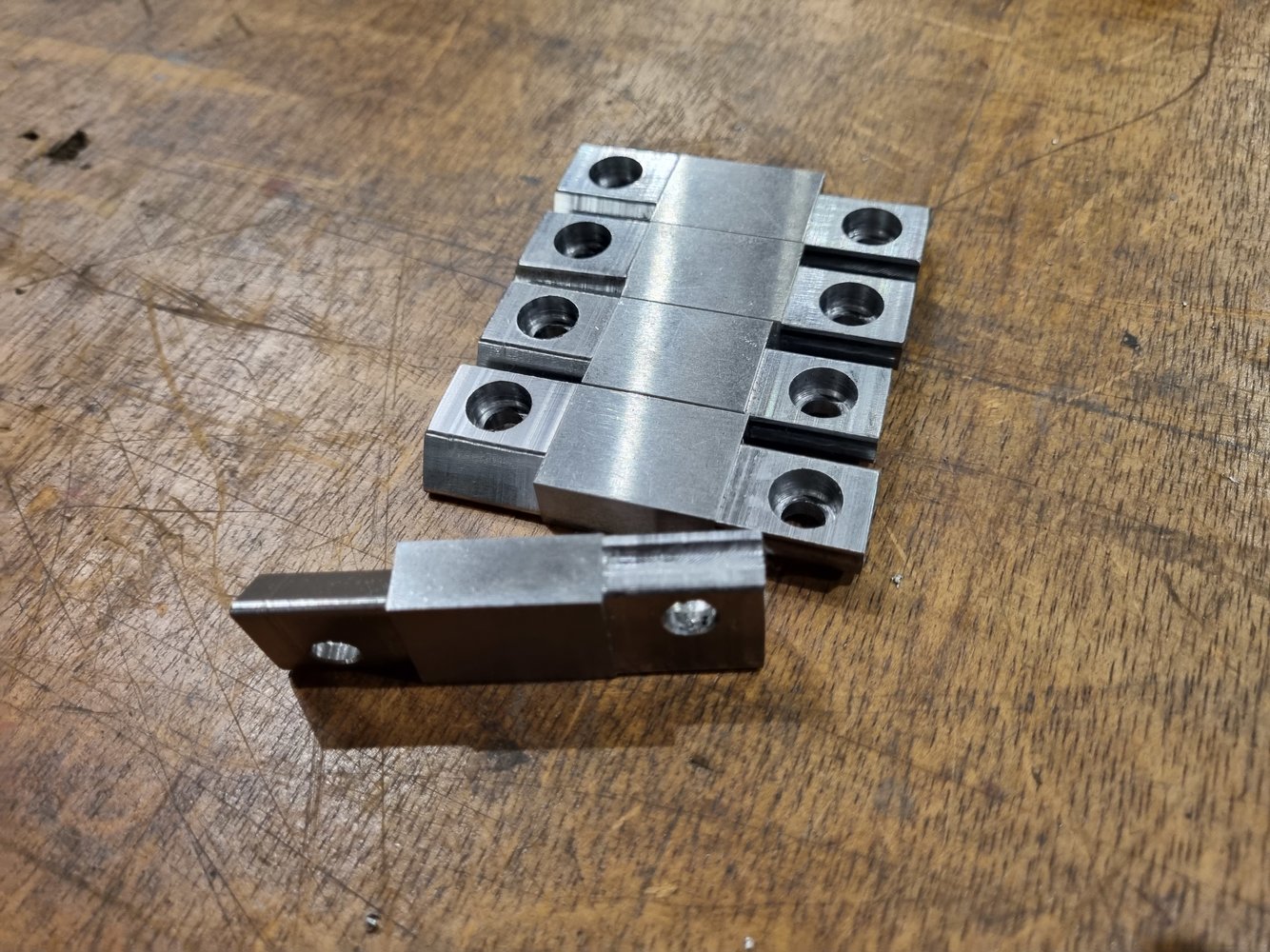

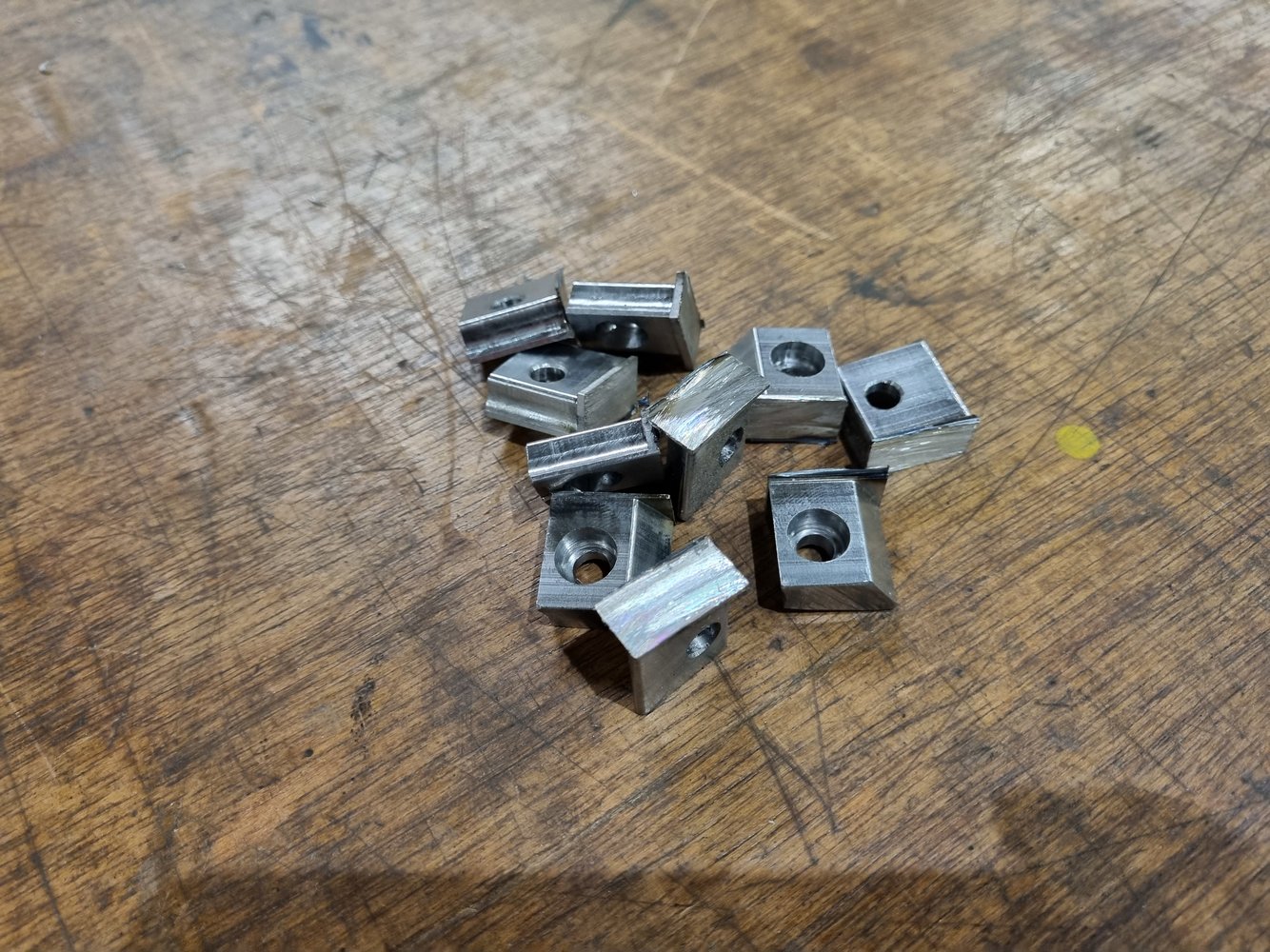

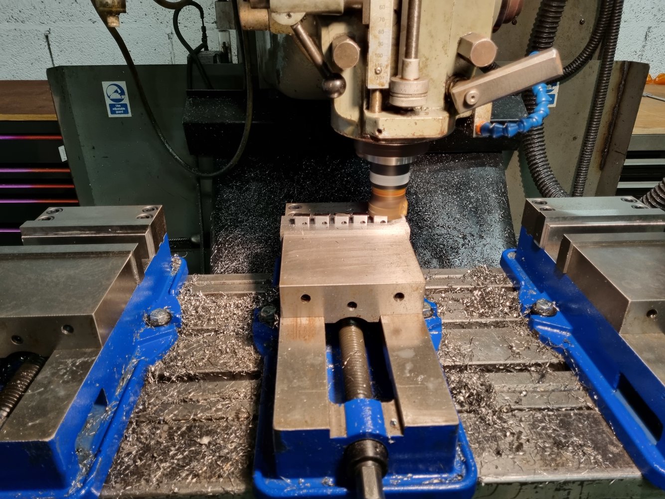

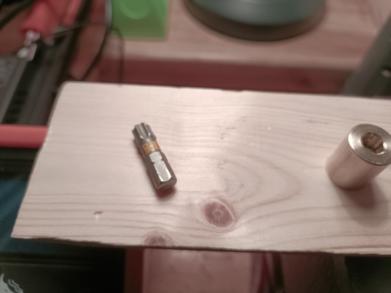

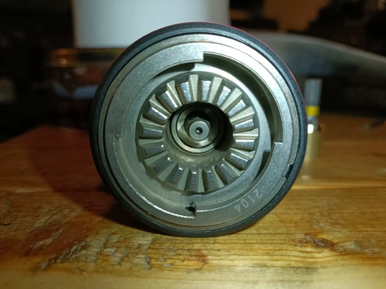

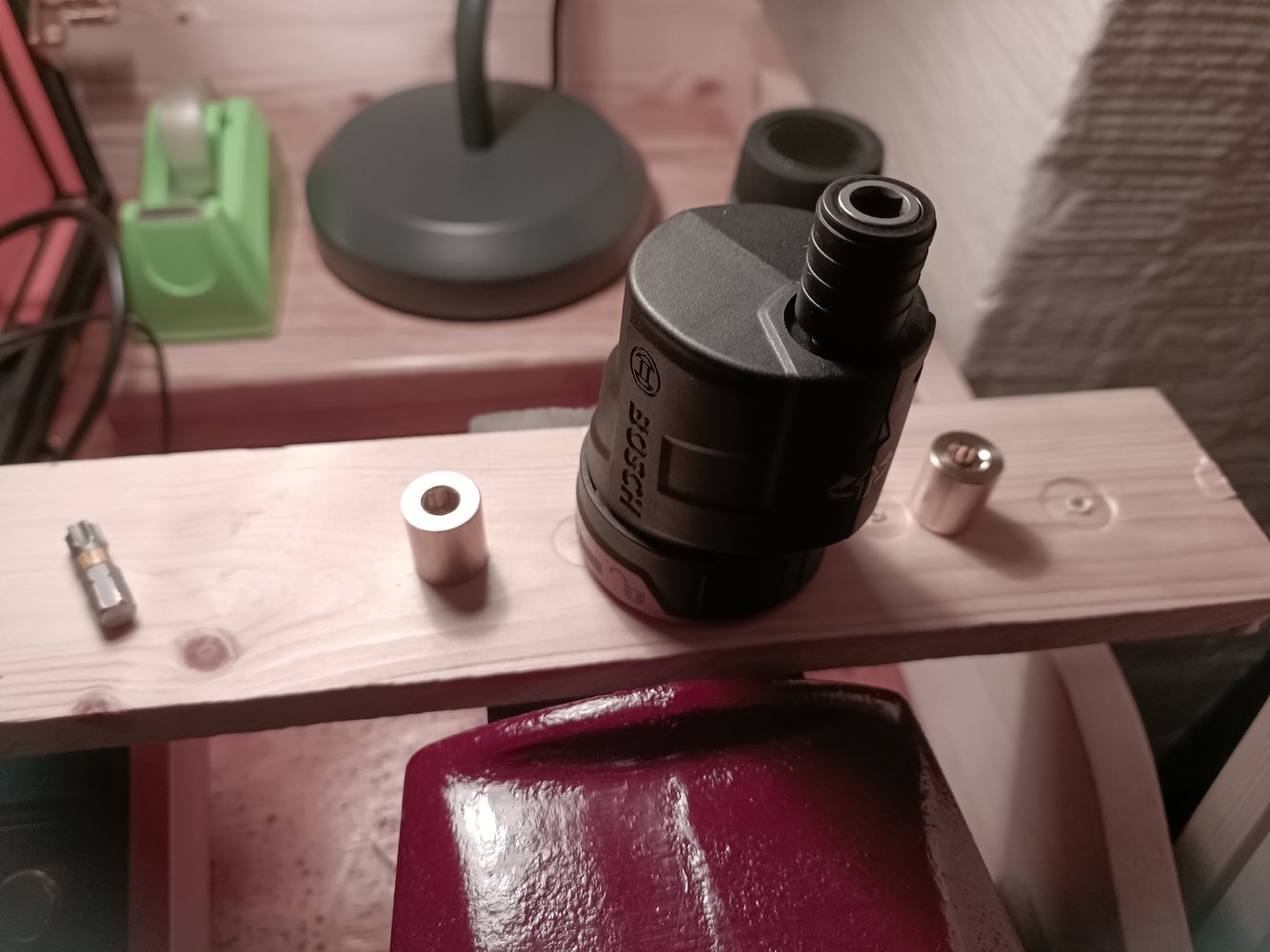

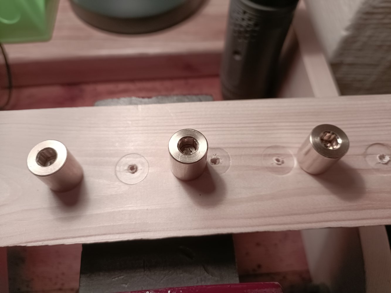

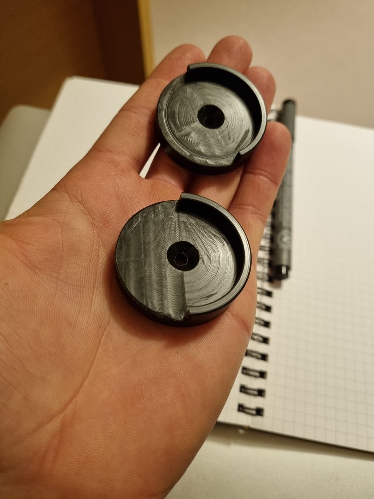

Am I missing something, why not just drill 7mm or so to clear the points on the hex?It's been a ballache to make the ¼" hex in these, but got there eventually.
6.5mm hole, & then used this to make the hex.
They're holders for the 18V flexiclick heads. Can't use the same method as I did for the 12V heads, as there's no flange/step, so went with these for the drive hex on the heads to slot into.
They've taken a lot longer to make than I hoped/expected, but they're made now.
Tried that first off. Not as secure a grip as I'd like.
Besides, where's the fun in doing something that simply?![]()

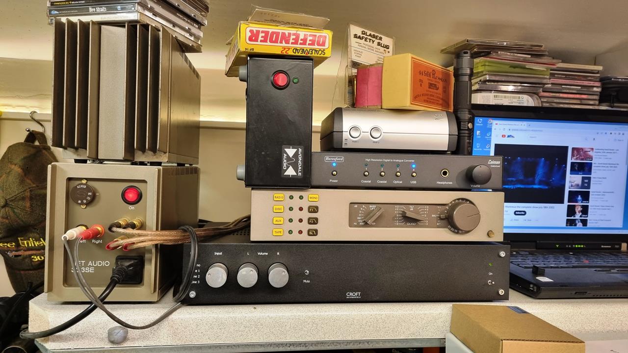

Finished shuffling the Hi-Fi about in the office, much better now:

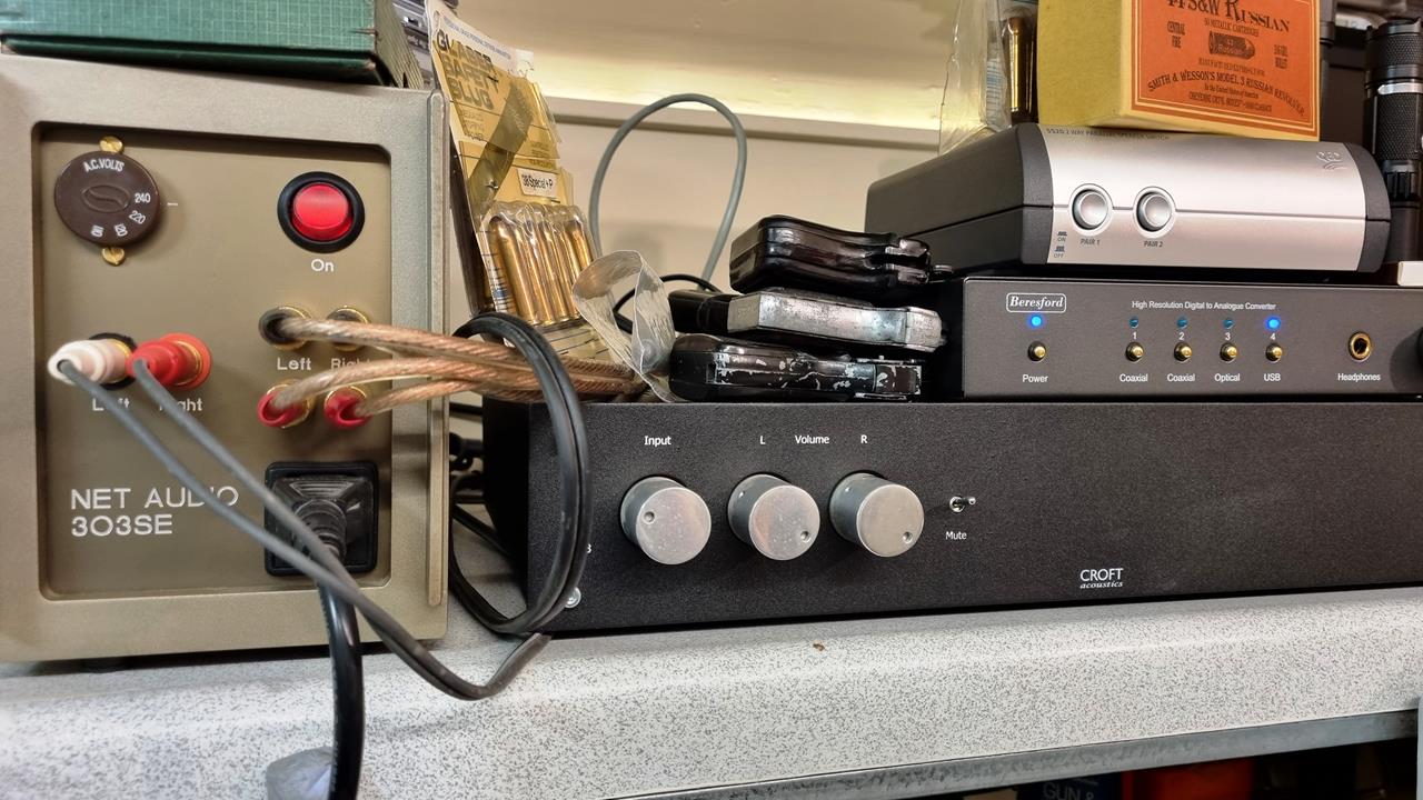

Decided to re-shuffle the shuffling, as it were:
Can you tell I like Quad Amps?
Very nice, they would go well with my 57-ELSs
