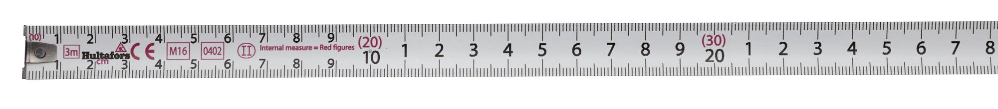

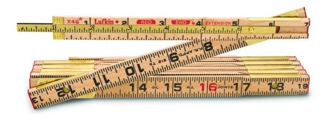

For tape measures this works well when you need accuracy for internals.
Folding tapes don't survive well in my tool boxes. Gave up on them after the last break.I used one of these for years:
Now available on Etsy, but be quick only one left
Vintage Wooden and Brass Measuring Rule - Etsy UK
Vintage American Craftsman extension rule 3931 measuring up to 72 inches. Wood and brass construction with dimensions in inches. All hinges are right and tight and graduations are nice and clear, this is a very usable tool. Would also make a great display piece or photo prop Lots more to see in mywww.etsy.com
My toolbox must be worth a fortune, I think I have four or more in there. I must say though the earlier ones are very well made, not so much the later models. Only come in inches though.

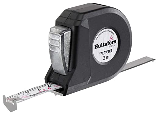

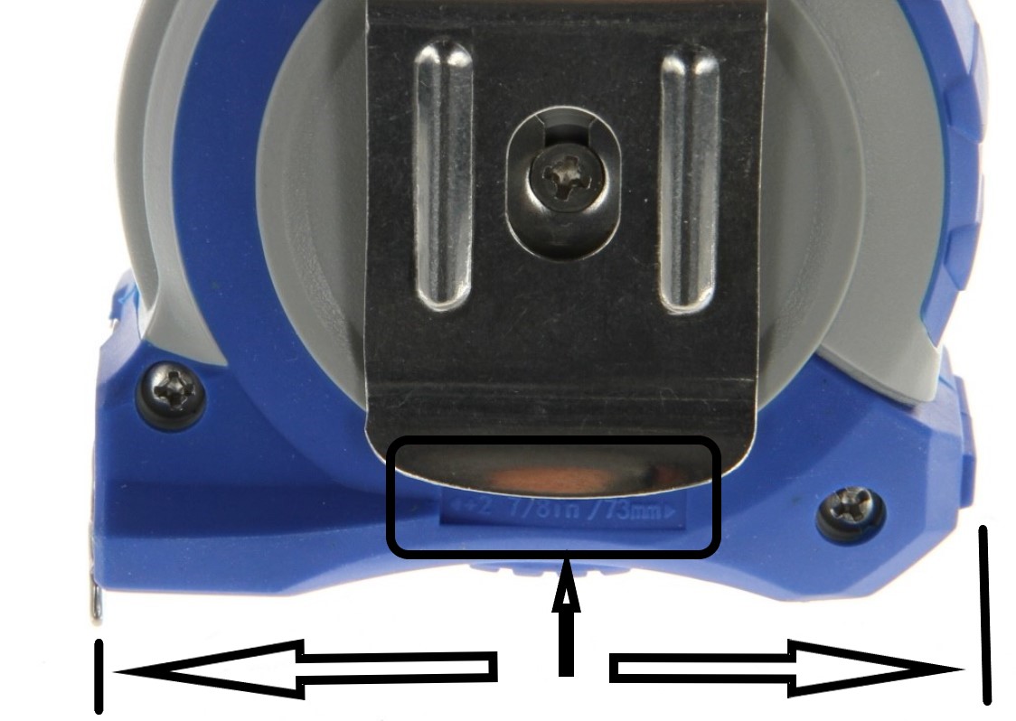

Do most tape measures not have a fixed size for the case? I am sure most of mine have the dimension moulded into the casing so simply add that to the measurement of the tape and you are set.This one works really well: a tape measure with a fold-out bit that sticks out the back (but rolls up when you don't need it).
https://amzn.to/3Gf2Ah5

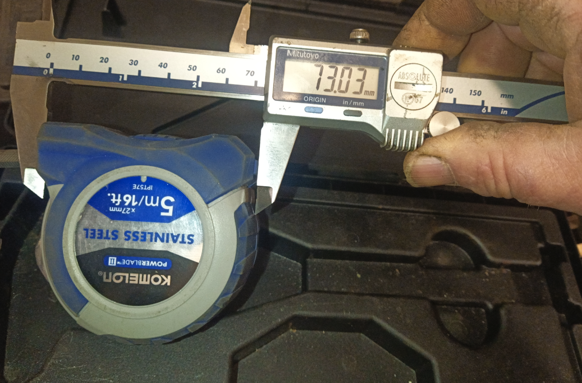

Some do. Some don't.Do most tape measures not have a fixed size for the case? I am sure most of mine have the dimension moulded into the casing so simply add that to the measurement of the tape and you are set.
It is American so it is really 2.7/8" which is 73.025mm so actually even closer than I thought^ Would it have killed them to make it 3" or 75mm? I'm all for round numbers.
