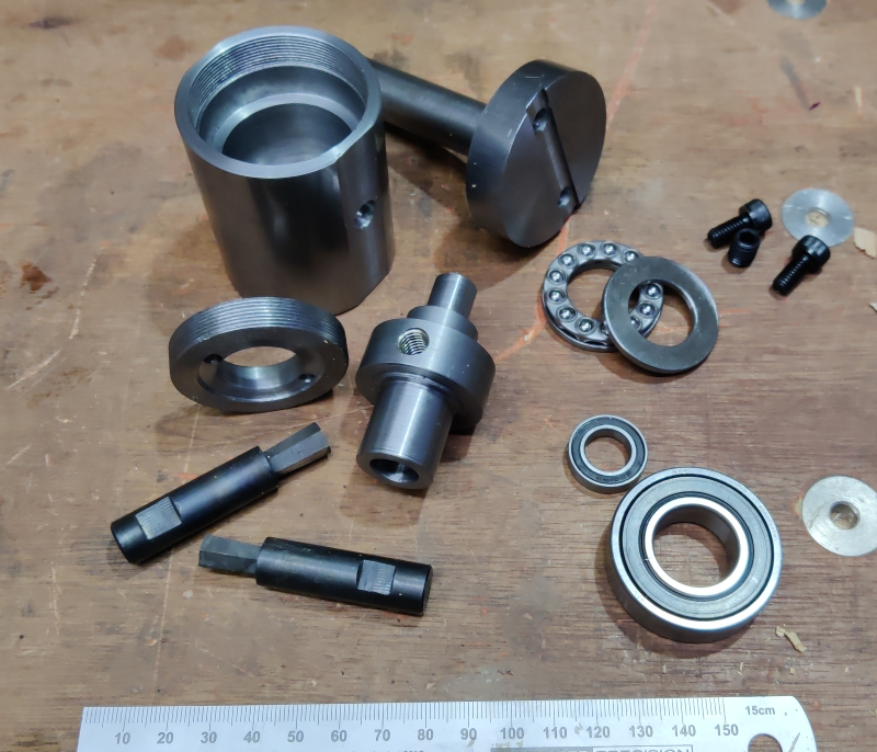

Have you got the plans? I fancy a go at one of these.Today & yesterday I made these bits (apart from the bearings and screws, unsurprisingly):
I then put them together to make this (the big one, with its little brother that I made from a kit a while ago):

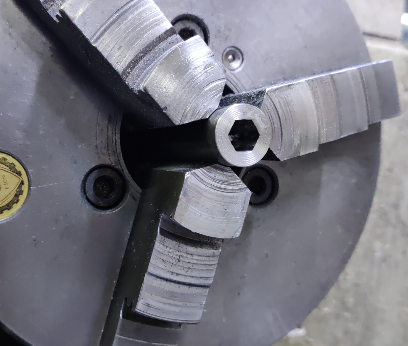

I then tried it out and made this...
... 8 mm AF, 15 mm deep hexagonal hole in a bit of 16 mm stainless steel bar.
The design was very closely based on the one from the Hemingway Kit that I'd previously made. I basically just doubled most of the dimensions and then tweaked it for 12 mm silver steel broaches and to suit standard size bearings (as you can't get bearings in exactly double the size of the ones in the Hemingway kit).
The Hemingway kit one will do up to 6 mm AF and up to 7 mm deep, but I want to be able to cut a 14‑ish millimetre deep, 8 mm AF hole for an upcoming project and I thought it would be fun to see if I could scale up the Hemingway design.

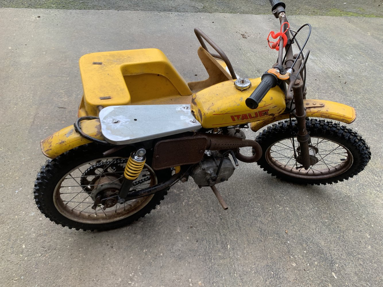

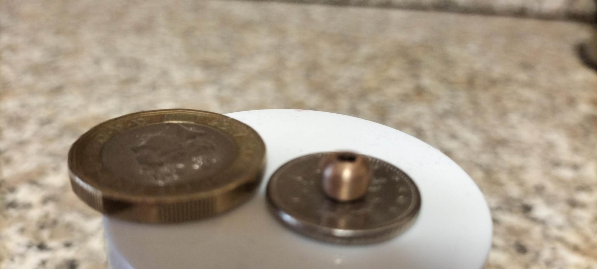

I would have thought due to the cold weather the monkey could have done with a weldernow, you all have to remember, I haven' turned anything on a lathe since I was at school. Our repair café has got a monkey in for repair. The motor has a very worn bearing which are unobtainable. So I had ago.
