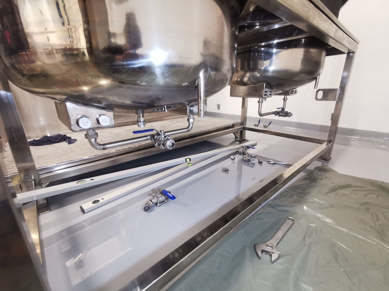

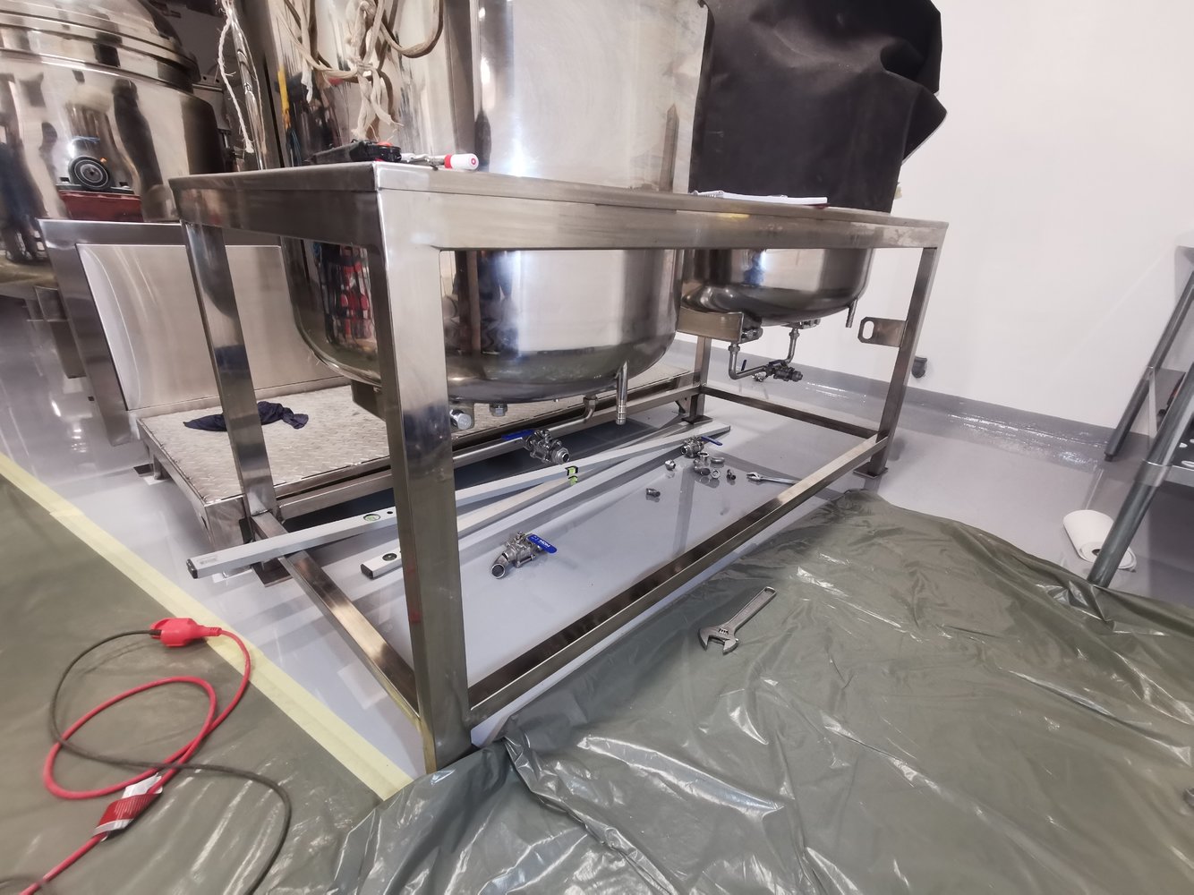

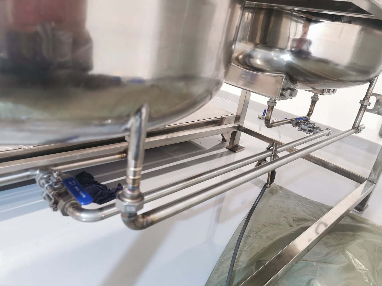

Supply line with shut-off valves and thermal oil return line.I assembled the pipes on welding tacks, then there will be a complete welding of the seams. Boiler heating system, thermal oil.
All this web of pipes will then go to the ceiling + expansion joints, silicone thermal insulation, casings over vertical pipes (protection of personnel from burns). Rotating hydraulic connections. Build in duplicate.

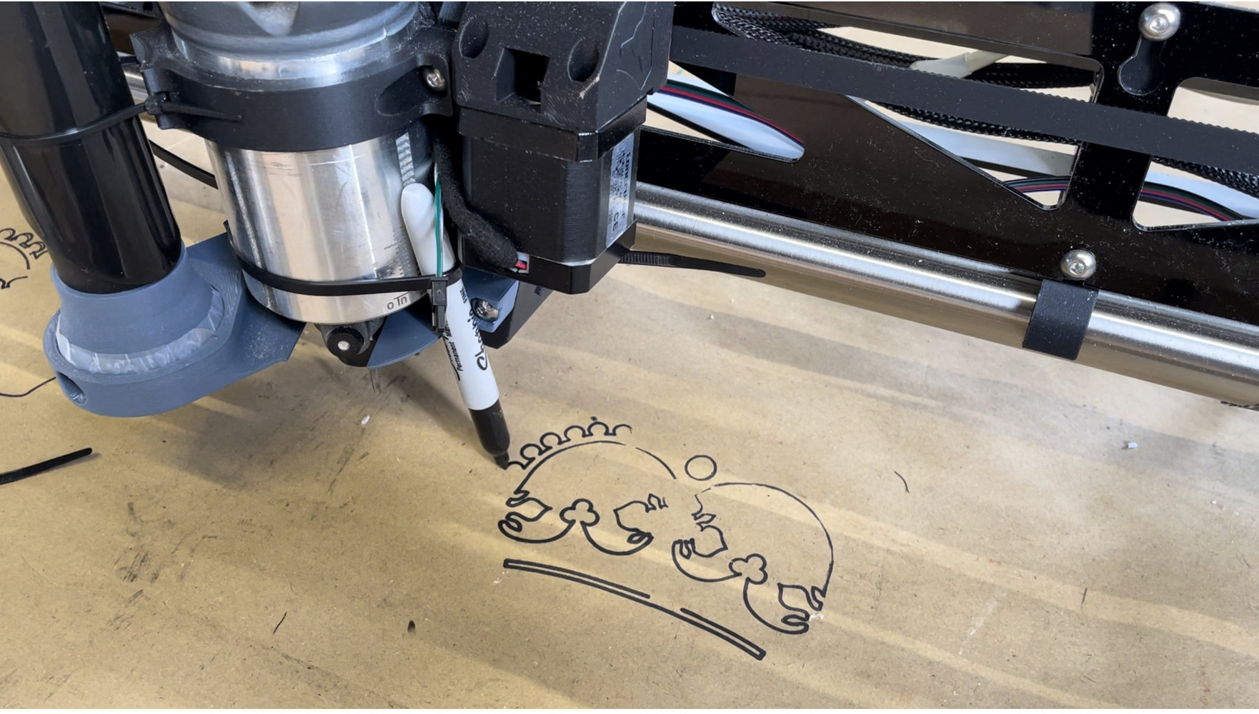

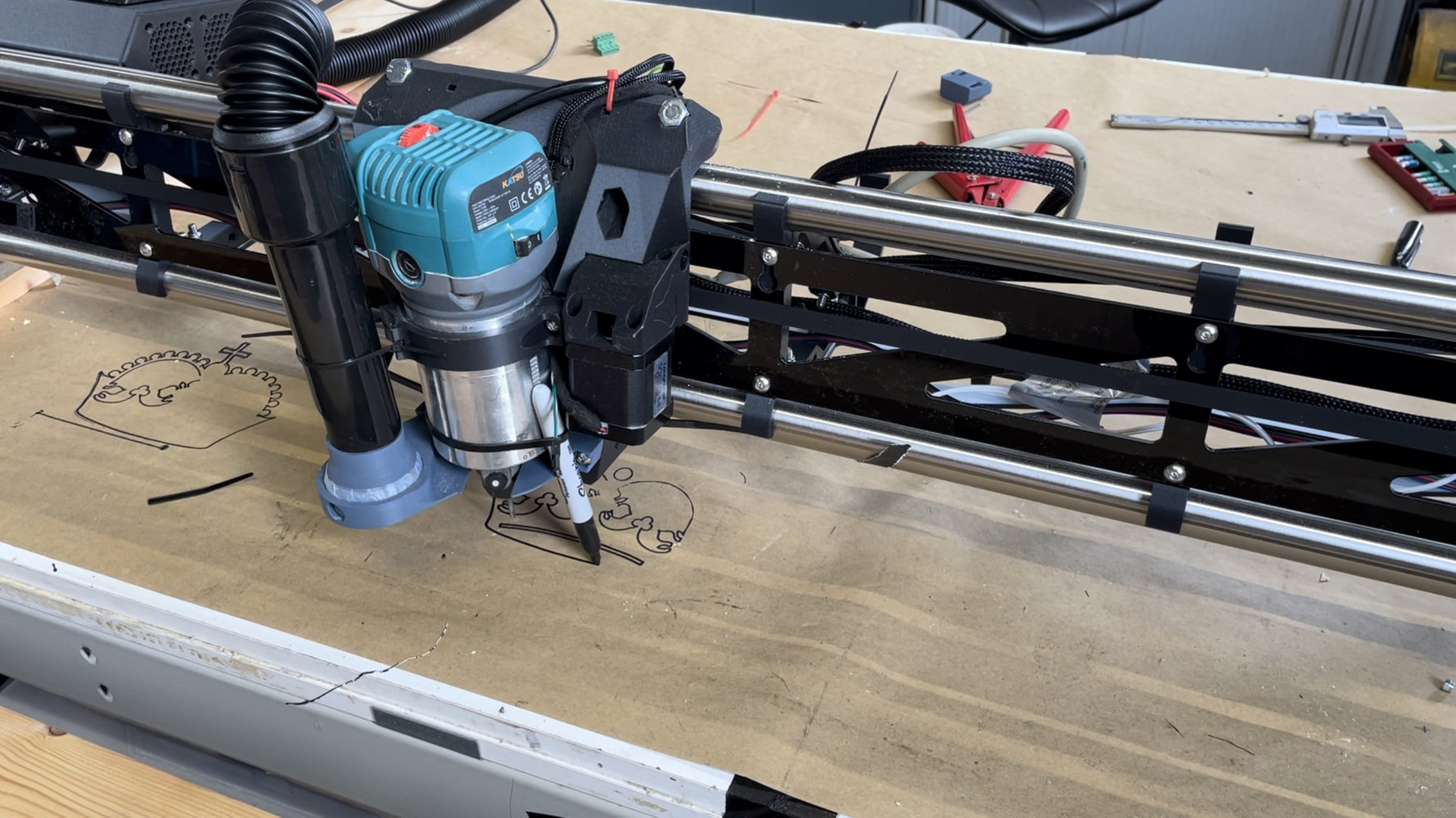

I like that machine... back to selling my body ............ again . How much will I need for a machine like yours ?Made some pretty pictures… successful motor and controller test of my Lowrider CNC build. Went and picked up a lump of MDF that’ll be the baseboard when I get to work on it next. Should be capable of everything my current one can do but now the working area is 1m x 2.4m

Nice job, ever considered an orbital welder?Supply line with shut-off valves and thermal oil return line.
I had to tighten all the union nuts before welding, collecting the parts on the tacks. (Teflon rings have not yet been used). The pipe is strongly deformed if cooked on a workbench. Cooked in all positions of my body, squeezing into the cracks or hanging over the lower railing.
Welding modes: 75A, 30 Hz., blowing pipes from the inside with argon, welding "with your own body". Pipe 1.6 mm thick.
Threaded fittings are noticeably thicker, but butt welding is no problem. I left a couple of ring seams for Monday. The body hurts everywhere, a hot bath with clove oil relieves pain ... I would like to have a compact welding half mask with a chameleon.
My 3M XXL is too bulky for this kind of work, falls on its side when working lying on its side.
Shortened electrodes and a small 2" long cover cap made it possible to get into difficult places. On the next set of boilers, I will shorten the tungsten even further using a cap in the form of a button.

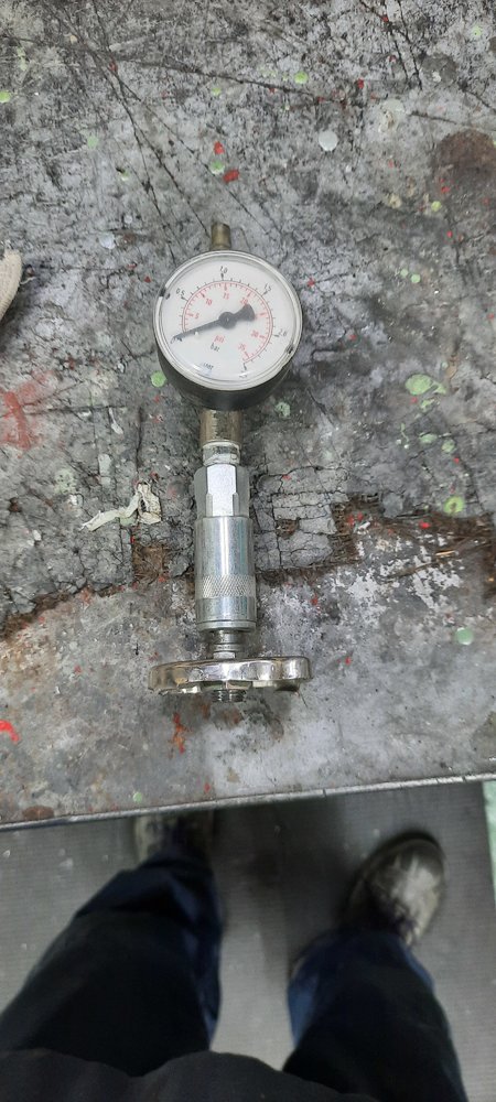

After assembling the whole system, I will weld a separate valve and pressurize with compressed air to 5 bar + control pressure gauge with exposure for a couple of hours or more (control by pressure drop) + spray with bubbles to search for holes (I hope everything will be ok).
full self build, all sourced from Amazon or aliexpressI like that machine... back to selling my body ............ again . How much will I need for a machine like yours ?
Full self build inc/ printed parts or parts purchased and you assembled it ?
Controller 100
stepper motors 30
belts and pulleys 20
3D printed parts 60 (3 rolls of PLA)
25mm pipe 30 (less if you use galv conduit)
wiring 20
router 50
nuts bolts and bits 30?
wood bits 30
It's a one-time job and my job is self-employed. I will make 2 sets of triple boilers by hand. I read a guide on orbital welding, the technology is cool, but not this time. A band saw, a band grinder, a measuring tape, a laser level, a little tig welding and a ball of spaghetti straightens out.Nice job, ever considered an orbital welder?
