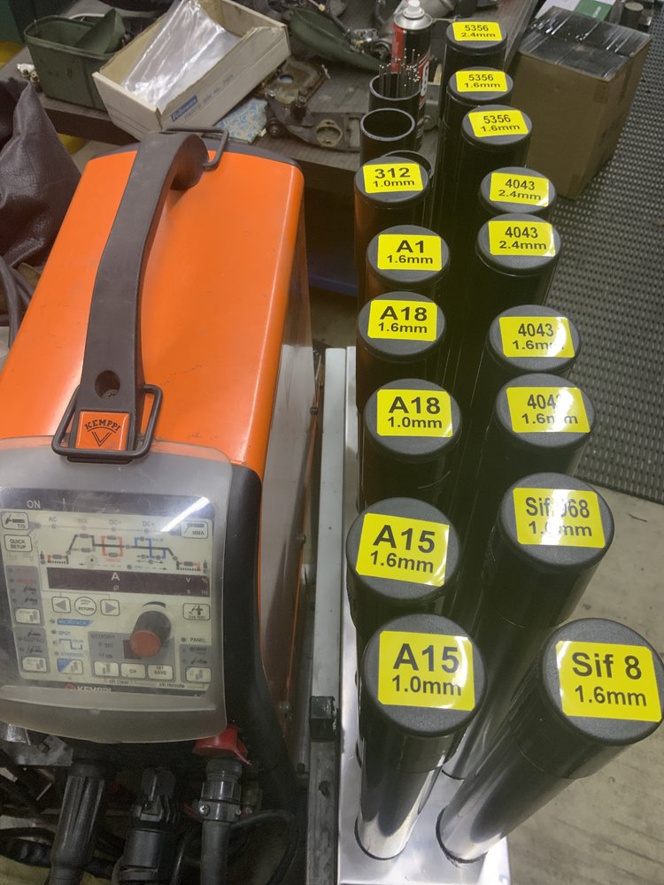

First one I've done, I didn't clean the core itself enough I'll know for the next time the pipe is new aluminium, cut with band saw, de burr, scotchbrite acetone, then weldReally nice work. What do you do in the way of prep? Or do you let the cleaning action take care of it?

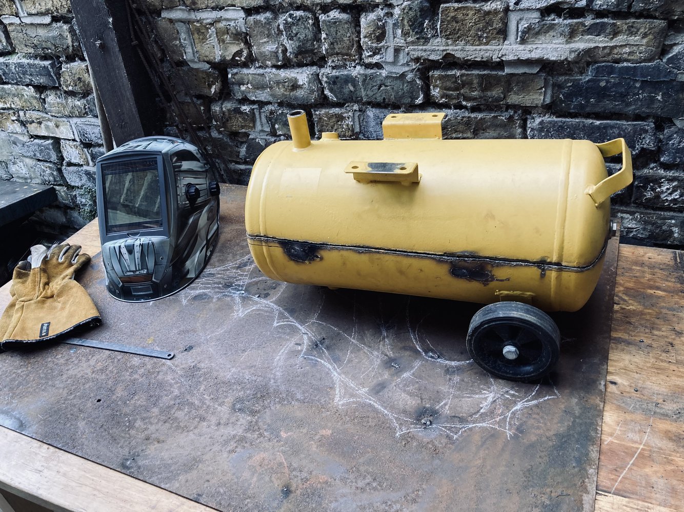

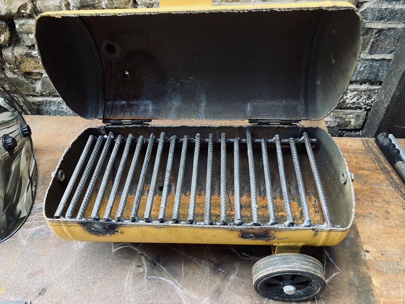

Are those plastic wheels ? wonder how long they will survive if they areOld Compressor BBQ No prep, redneck style
Easy clean rebar grill just run a wire brush/ grinder combo over it.

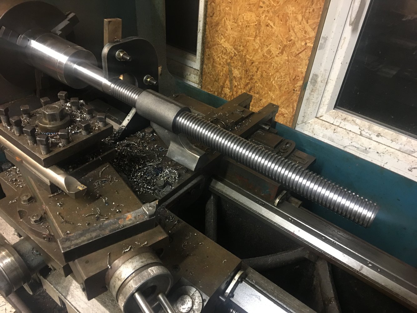

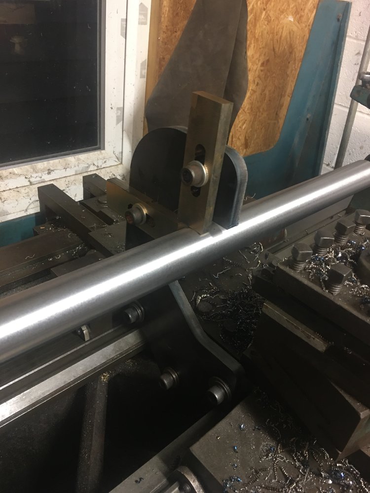

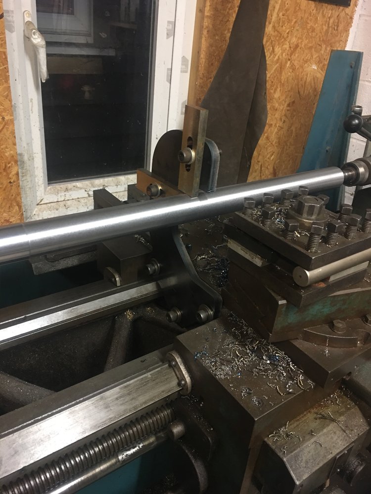

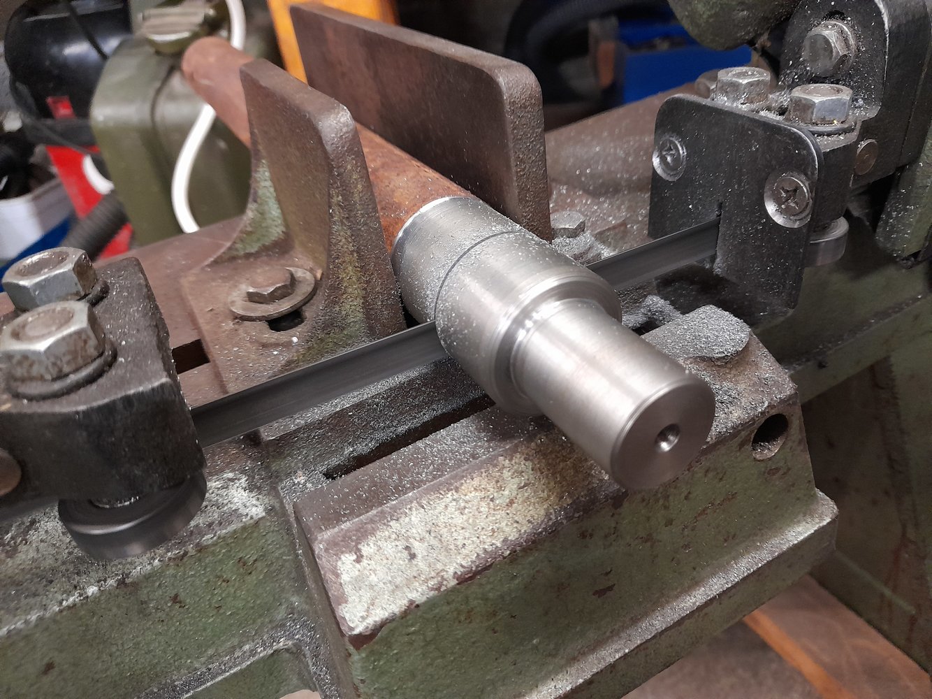

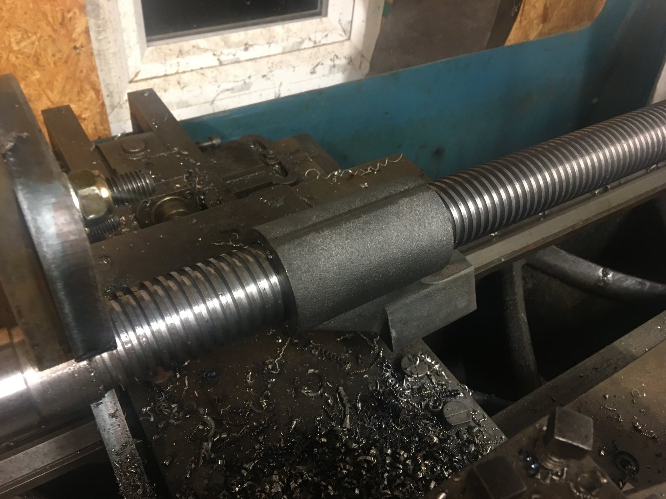

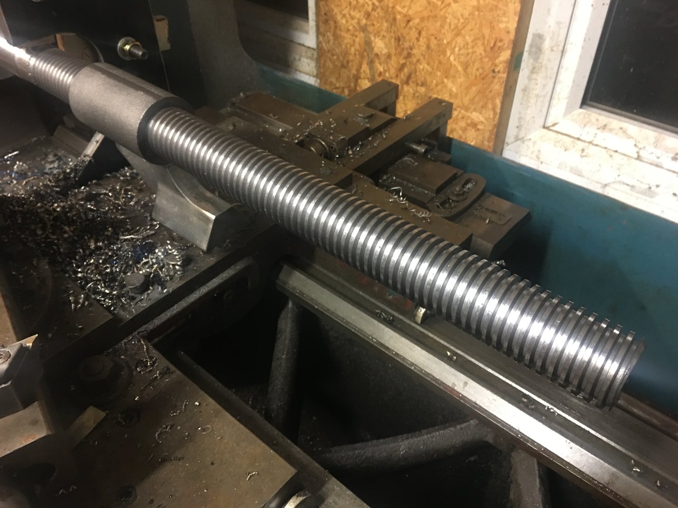

You donut, why didn't you ring me?Made 44mm vice screw and a quicky travelling steady
Needs bsw bolts for steady. Got stuck in traffic and ruined half a day getting them , got home and they’d given me unc
Then I found some at home whilst looking for m12
Power been off since Friday but they’ve connected generators now so I could get on
View attachment 389046 View attachment 389047 View attachment 389048 View attachment 389049 View attachment 389050
Thanks but I just went to the fasteners place as that’s where you find them!You donut, why didn't you ring me?
Nice job. I could do with making a steady like that.Made 44mm vice screw and a quicky travelling steady
