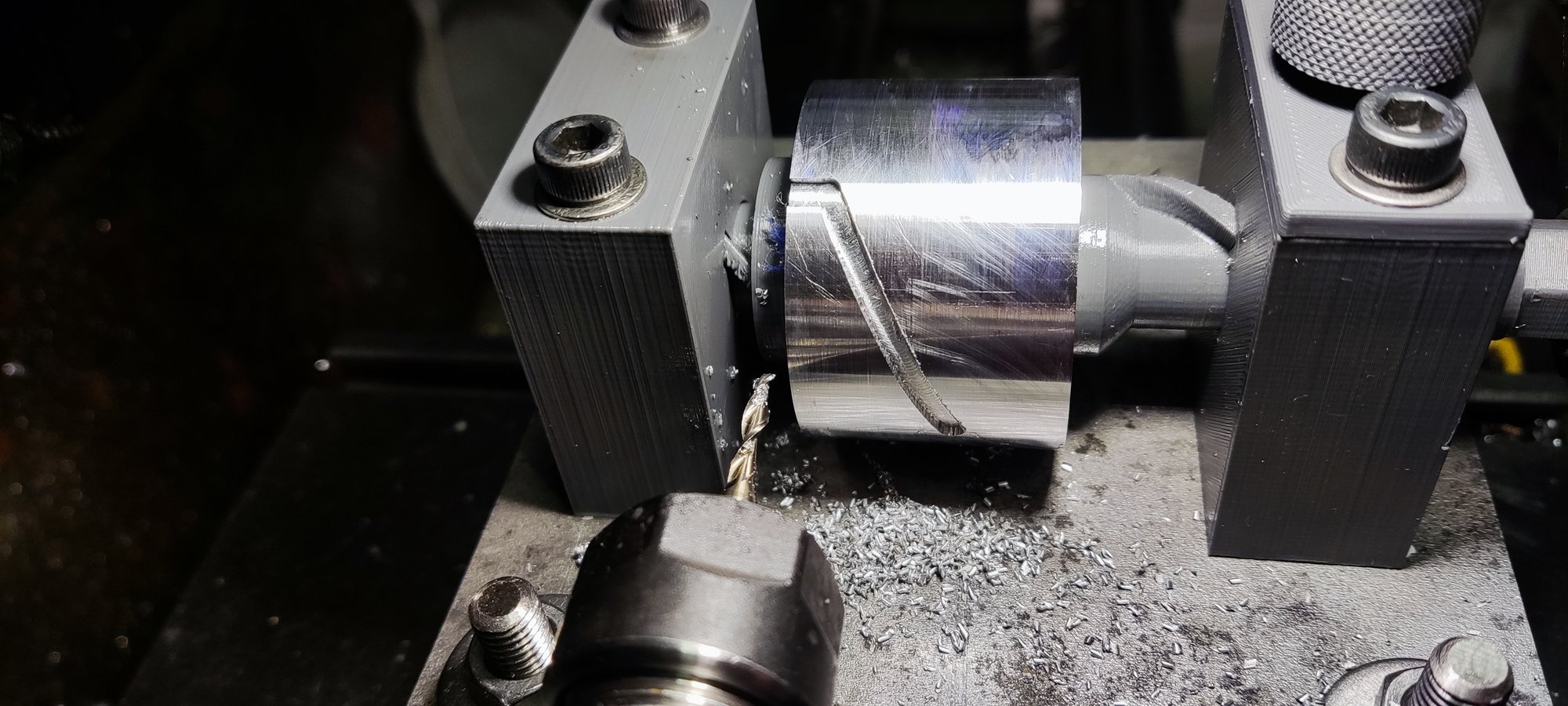

I had an attempt at helical milling with @Onoff 's printed jig.View attachment 389407View attachment 389408View attachment 389409
It works! Three 1mm deep cuts.
Difficult to feed smoothely and can see it in the finish.

Would a four or six flute cutter make any difference to the finish of the helical?As per the pm I think they're "chatter" marks. Basically the irregularities and imperfections of the print being faithfully transferred and "copied" by the cutter. I'm oddly pleased it copies so accurately!

Are you cutting that dry? I reckon some cutting lubricant would help.

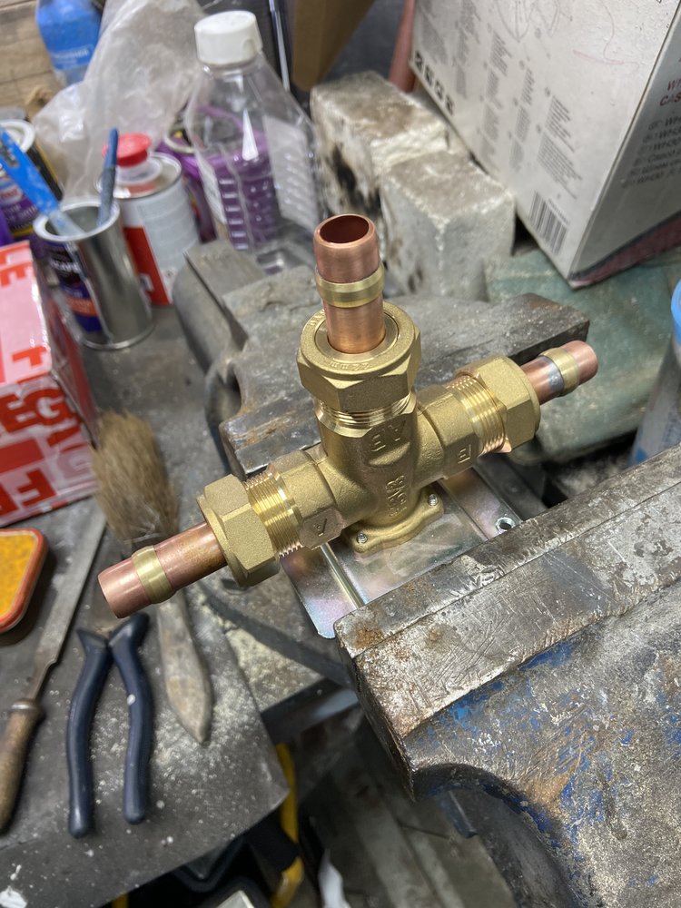

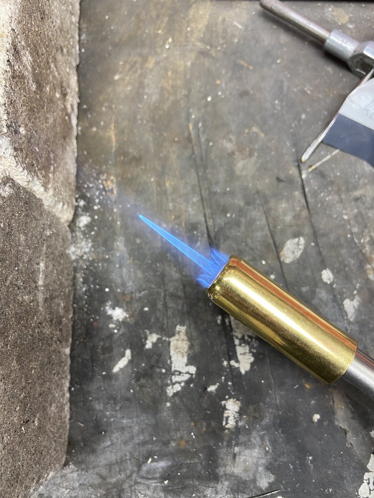

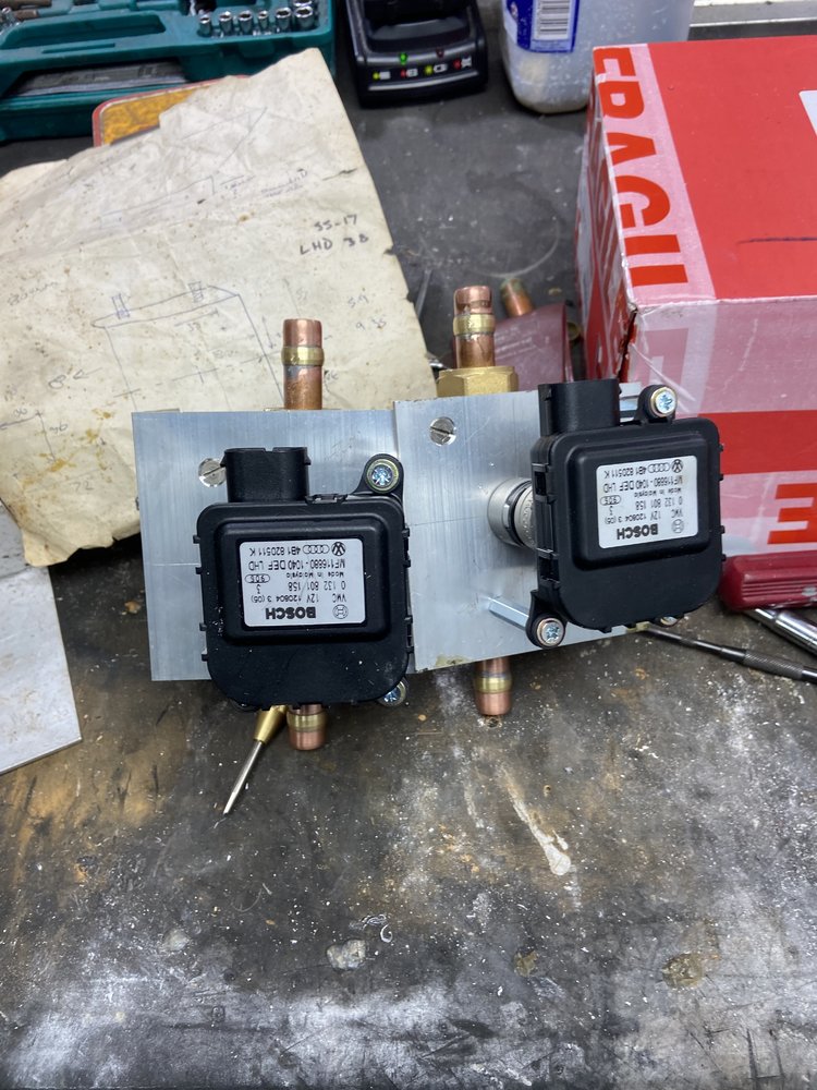

Did a lhd and rhd heater valve for the MGZT260 owners club shop. Im extremely impressed with the mapp gas torch I bought the other week

Thanks Ill get a propaneI wouldn't use mapp gas to do soft soldering, its too hot & its very easy to overheat the fittings & boil the solder & flux. You are better to use straight propane (black or red cylinders), they don't burn as hot & are much safer.
Its not that much hotter, just use a smaller flame. However propane is cheaper, and butane/propane mixes far cheaper if thats all the heat you need.I wouldn't use mapp gas to do soft soldering, its too hot & its very easy to overheat the fittings & boil the solder & flux. You are better to use straight propane (black or red cylinders), they don't burn as hot & are much safer.
