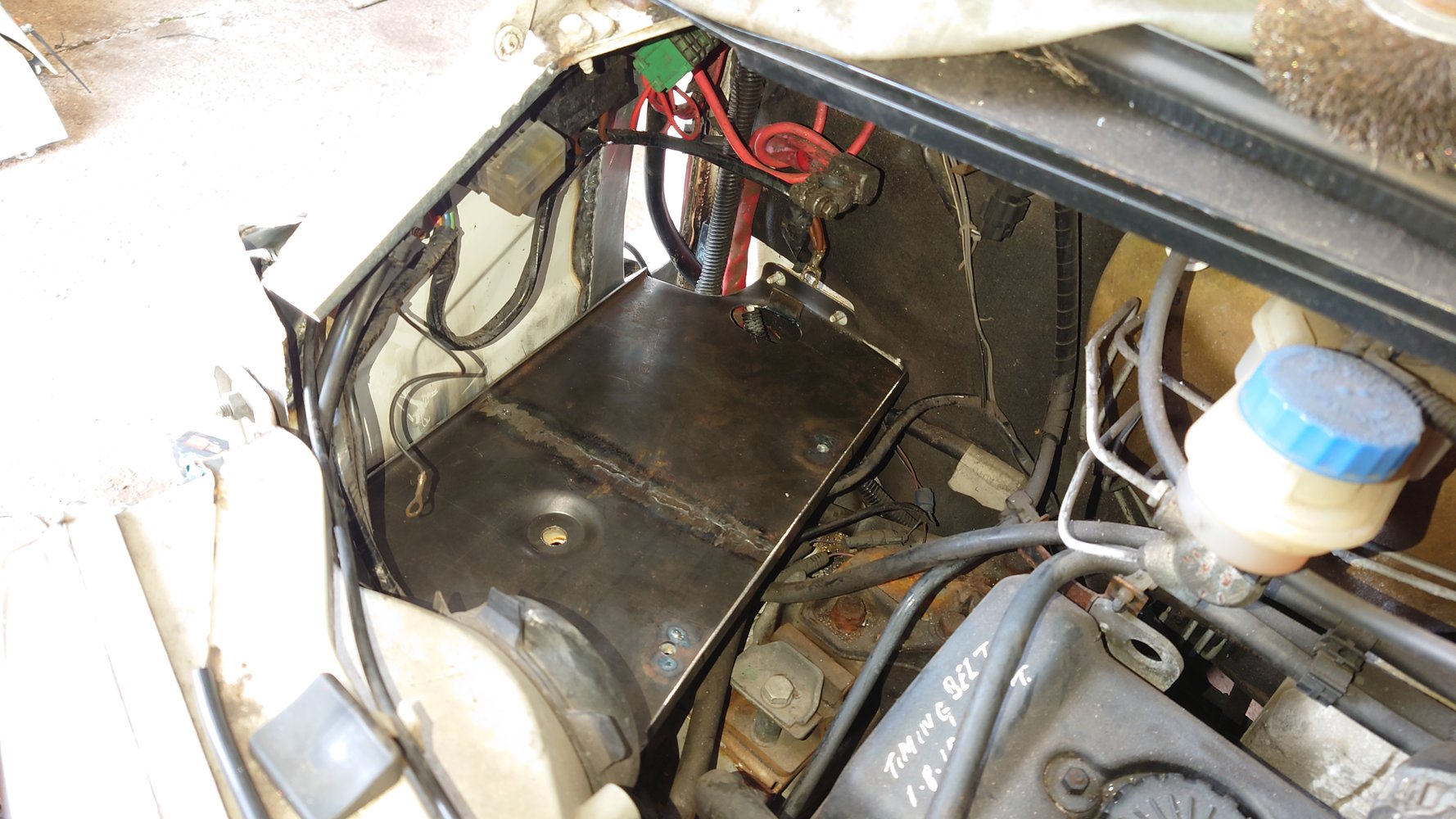

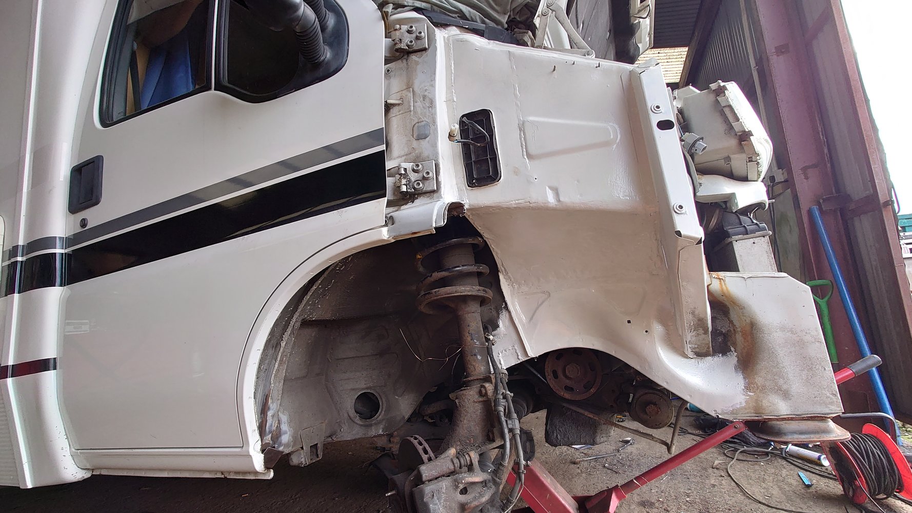

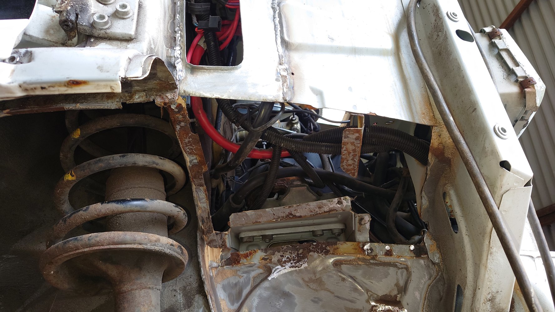

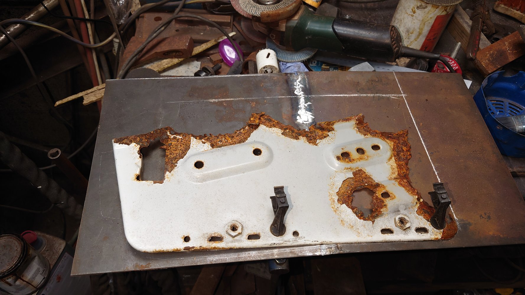

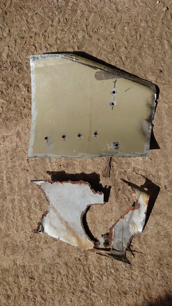

I could have shown you a complete-ish battery tray, it’s on my bench awaiting a repair. The baskets who made these vans never stopped rainwater running down under the bonnet, designed in failure...Today I made the camper van whole again.
I thought the battery tray would be the tricky bit but the DS lower inner guard was worse.
There was not much left for a pattern.
Forgot to take any photos during, but this is after a coat of white epoxy.
It's all a bit lumpy but it will do the job. I'll seam and underseal it after it gets its MOT.

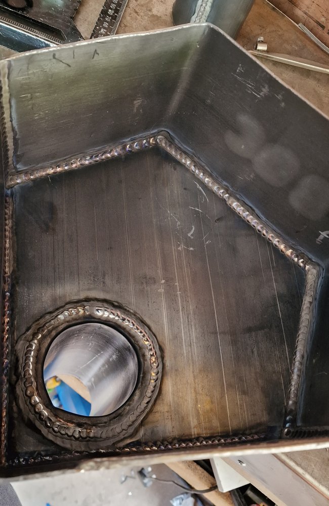

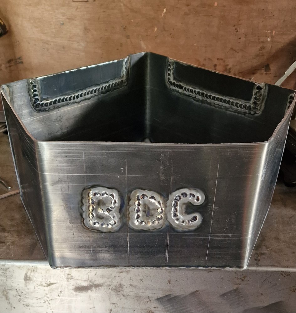

Battery tray was similarly lacking in areas, so made my best guess.
I used 2mm steel but didn't have a bit big enough so I welded two off cuts together.
Mig was at my mates shed so I used tig and planishing it flat.
My good helmet was with the mig and the one I had was flashing on and off so that's my excuse, but it's functional.
I used my press and a form tool I had made up for something else to make the pressing for the bolt hole.
I was pleasantly suprised when it fitted.
Other side was similar but not as bad.

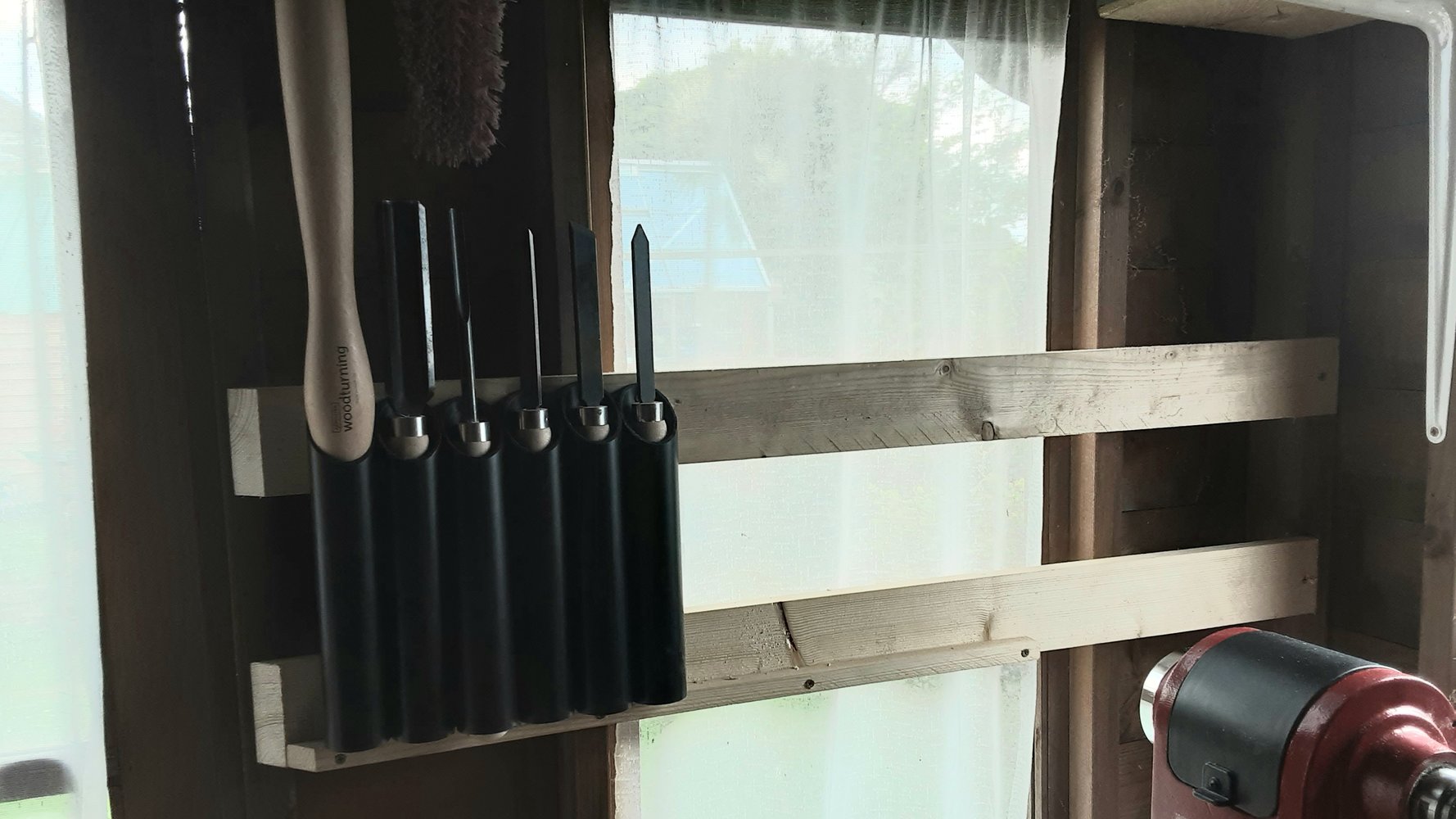

Having a few days off before starting the new job next week so I've managed to do a bit.

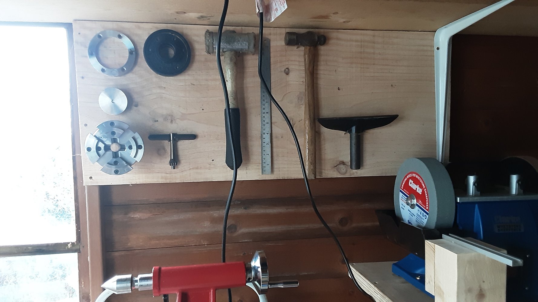

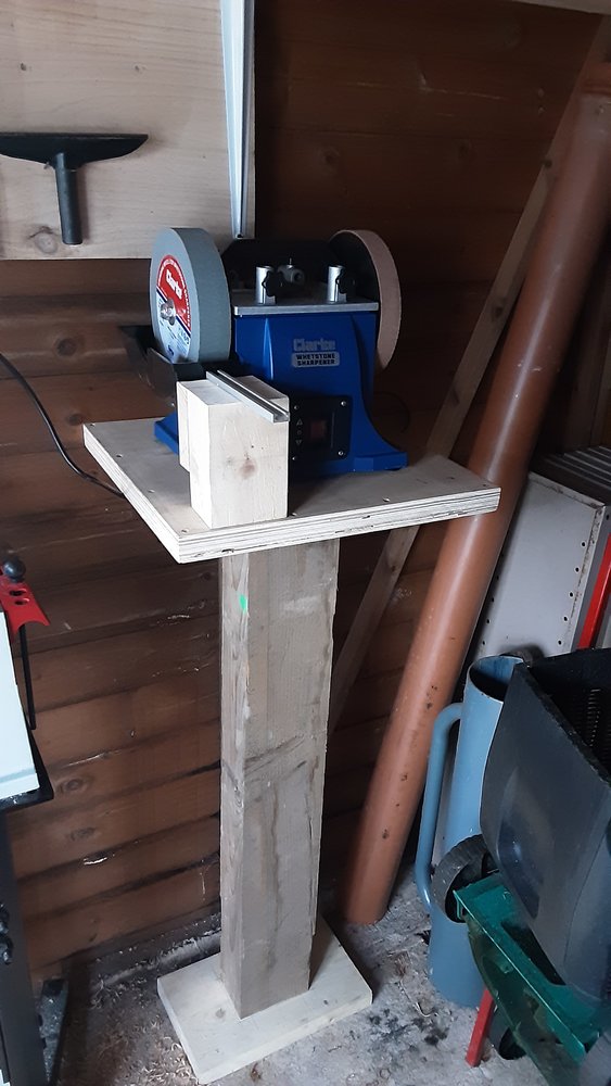

Picked up a "whetstone grinder" from Machine Mart last week for sharpening my wood turning chisels and it's now sat on a pedestal. The next task is to attack the block in front of the grinding wheel with a router and set the "T" track into it then make an adjustable bracket so the gouges will be ground at the right angle. (I briefly contemplated buying a Wolverine grinding job but my Yorkshire-ness objected to parting with the thick end of £200...)
An unused length of 1" thick pine board has been repurposed to hold chucks and faceplates and other lathe sundries:
And a similarly unused length of 40mm (proper measurements are available as opposed to this modern metric foreign nonsense which will never catch on ) drain pipe makes a great place to store turning chisels. And there's plenty of room for the inevitable future purchases :

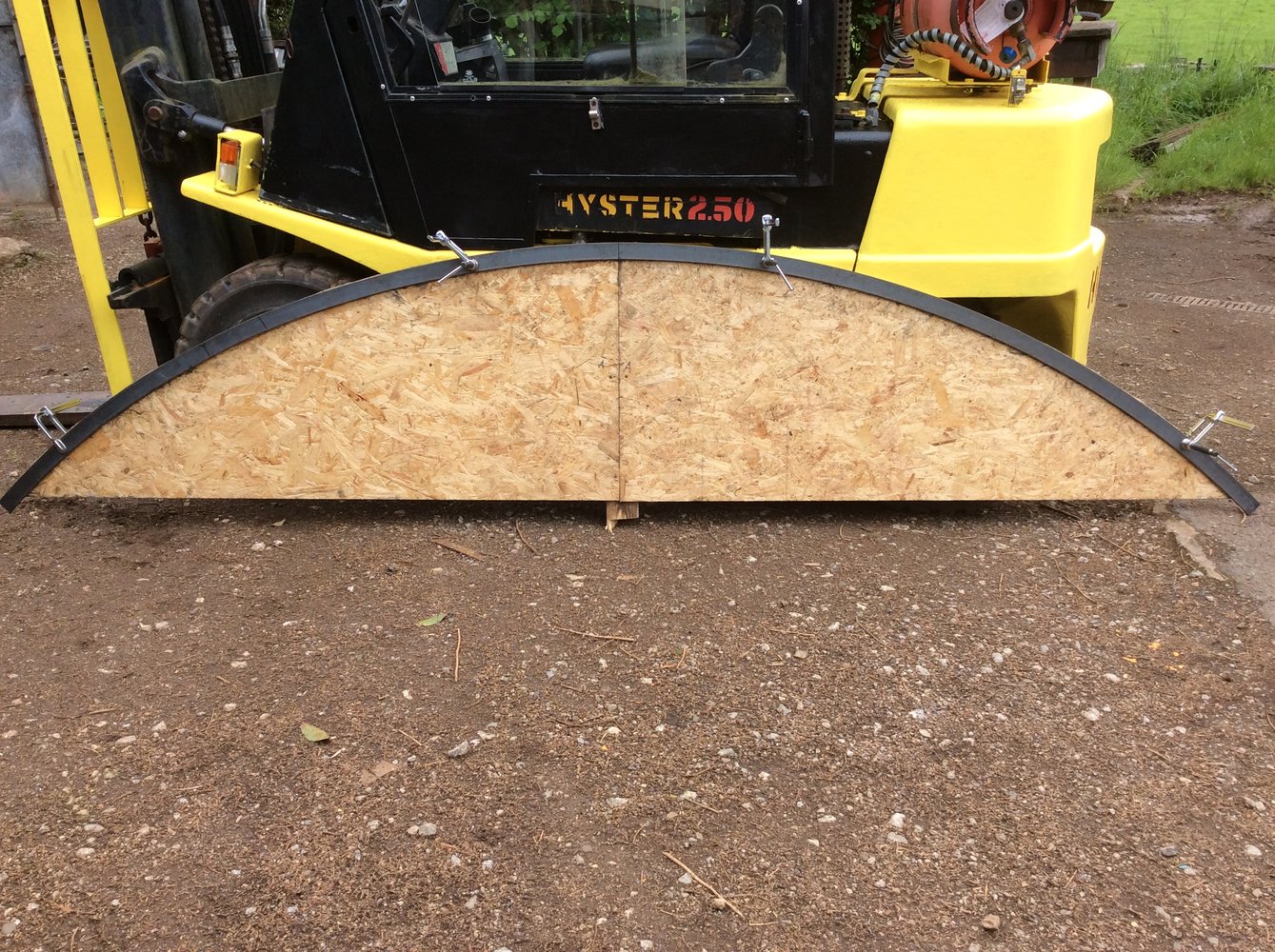

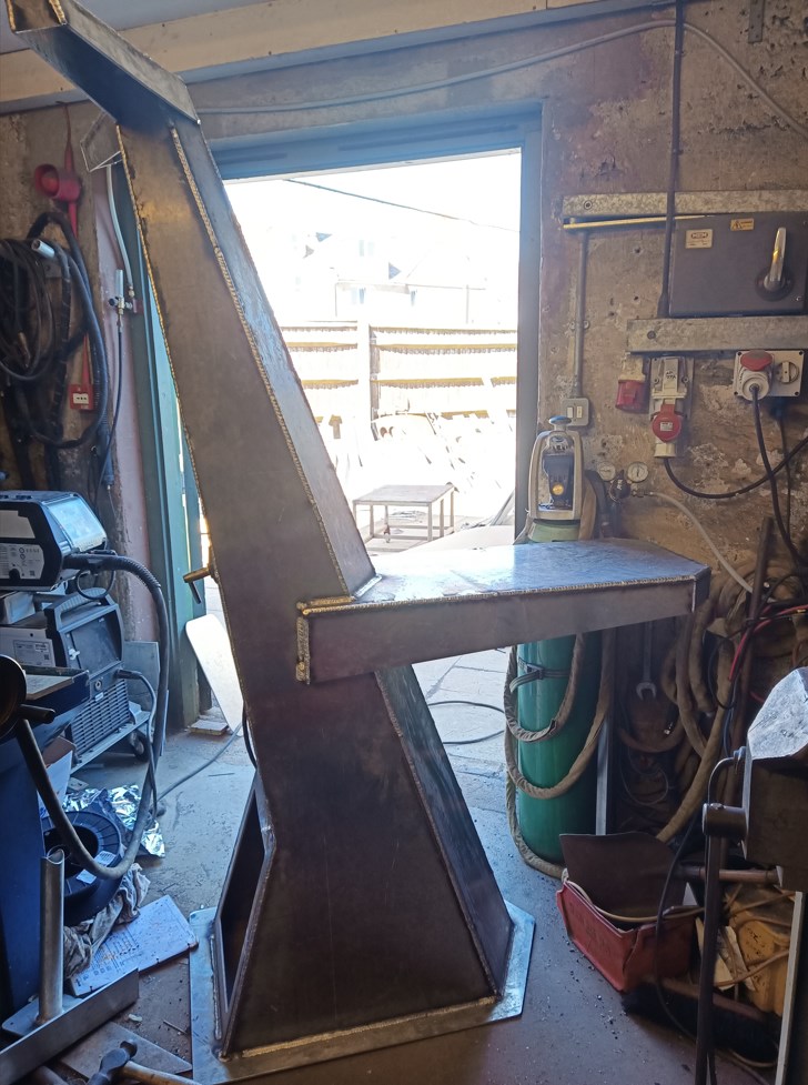

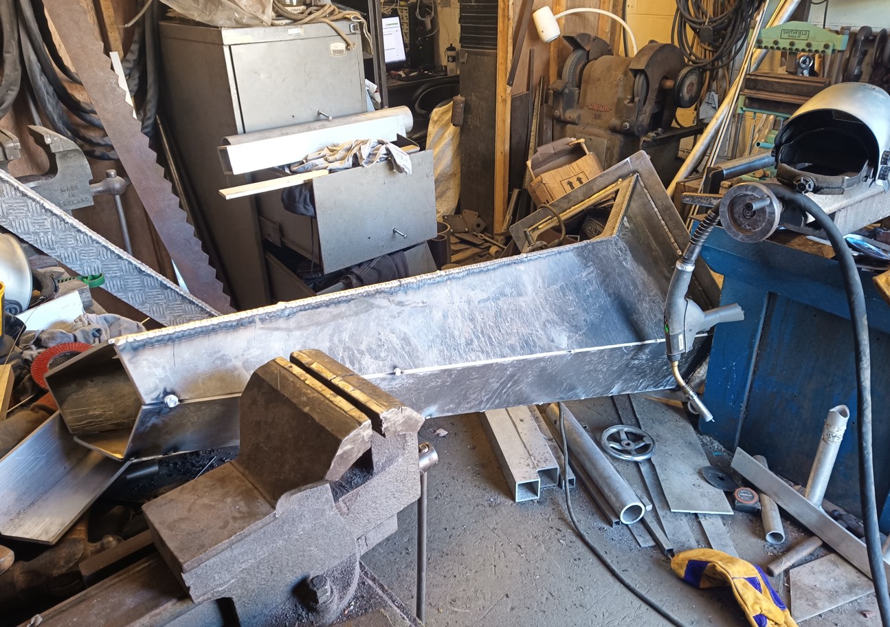

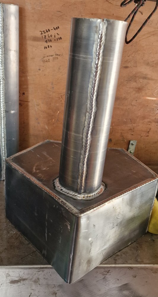

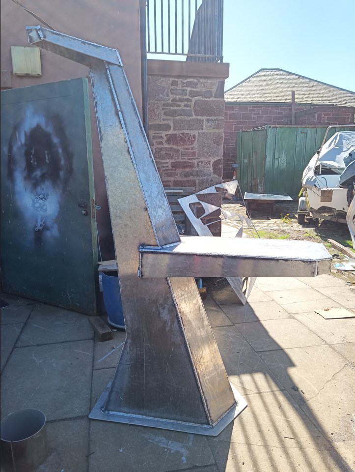

I don't know weather you may be aware but a cleanup might be called for I've got **** every where pushed aside as haven't had time to get it all cleared, just saying, might be worth a lookI was to be making a mast for a boat but I reckoned it was too big so I cut out some hardboard to let the skipper see and he agreed. So I scaled it down a bit and it seemed better although the radar plate looked a bit out of proportion but nothing can be done about that as he wants the open scanner type and the slightly smaller version would cost him £4k more.

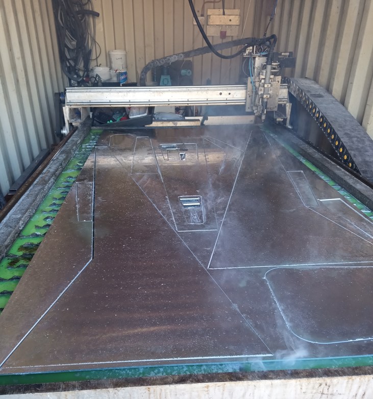

Anyway got two sheets chopped on the plasma.
Tacked it up.
Then the wind started picking up so I had to weld it in my workshop which doesn't really have much room.
Still have loads of brackets etc to weld on but quite happy with todays progress.
That is it cleanI don't know weather you may be aware but a cleanup might be called for I've got **** every where pushed aside as haven't had time to get it all cleared, just saying, might be worth a look
Not many pikeys round your way? Lot of offcuts in your yard….That is it clean
I just don't have room to put things, workshop is the wrong shape oh and BTW that is the part of my workshop with the most room in it

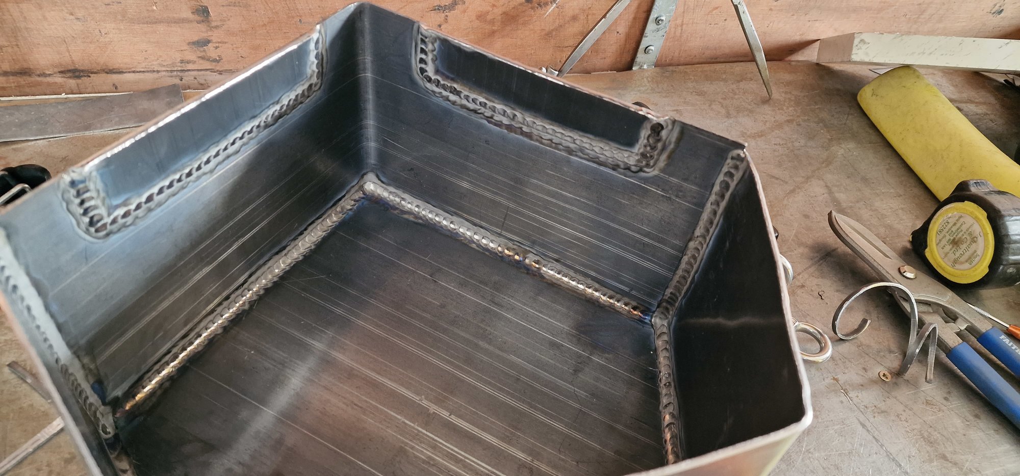

Bet you are getting really quick at doing those!Made 60 strawberry trollies 7 years ago,now due to regular punctures,farmers changing to solid tyres,so I’m putting suspension on each corner and widening them as he’s changed tray suppliers.View attachment 398626View attachment 398627View attachment 398629
