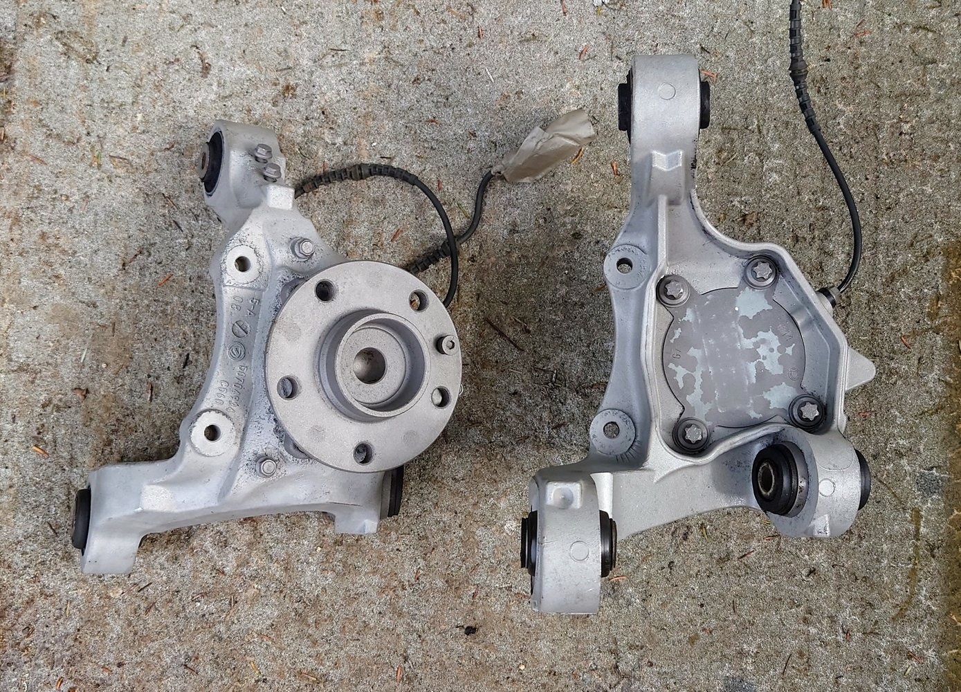

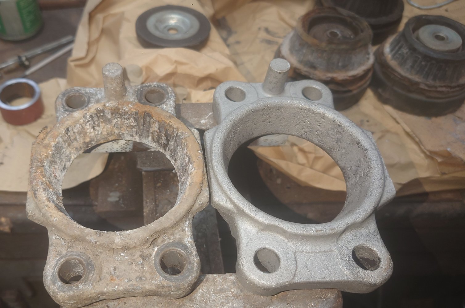

Is that a DIY process? I know nothing about it!Today I made the rear calipers on my Alfa 159 more presentable.
From this
To this
I used Cerakote H series ceramic coating and new seals.
First time I've used a ceramic coating so a bit of a learning curve and it will be interesting to see how it lasts.
Great company essential supplies
I would be interested to know what blast media you used?
Quite forgiving to spray isnt it! After my first few goes I realised you could really get that wet look they want from the tutorials without risk of running. Cerakote on calipers is quite advantageous because of the low thickness especially on contact points for pads.
The H series on callipers my customers have found held up perfectly. I don't do many calipers, and quite a few customers want a glossy look which I can't give with cerakote, so opt for powder coating instead (which I'm not a fan of).
On the subject of Cerakote, I think MC5100 is a game changer for aluminium parts.

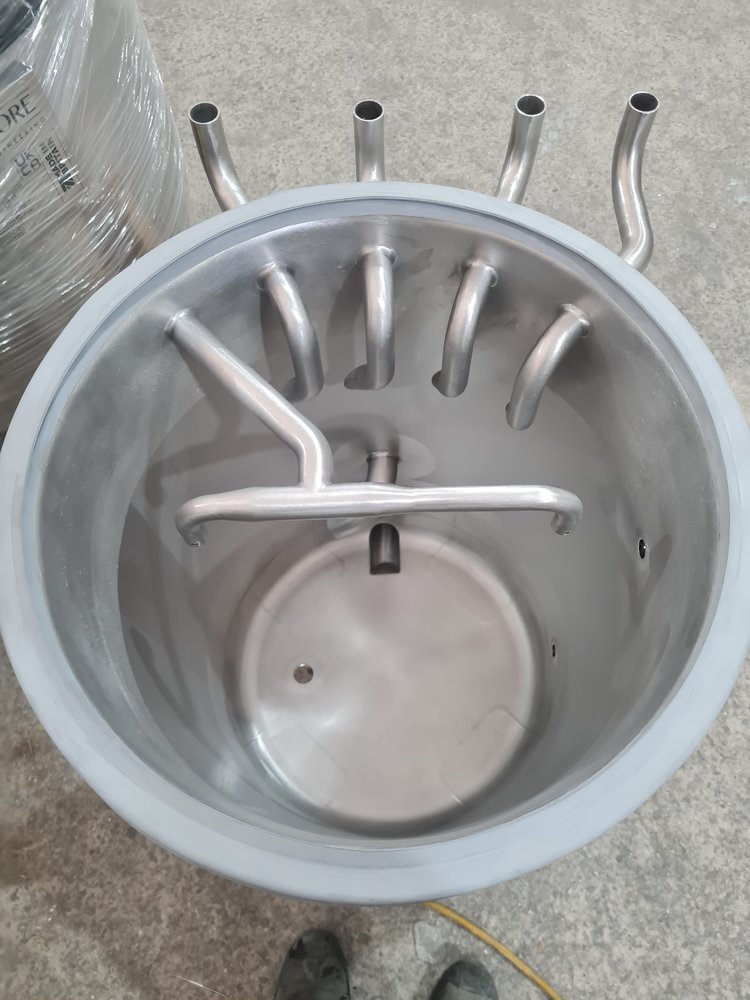

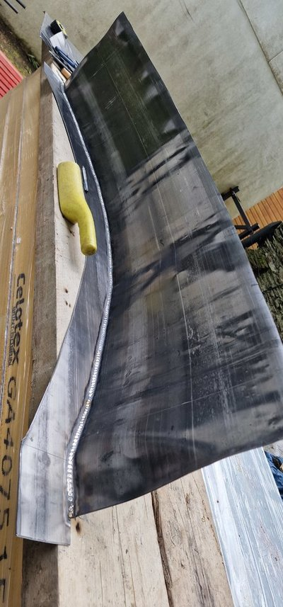

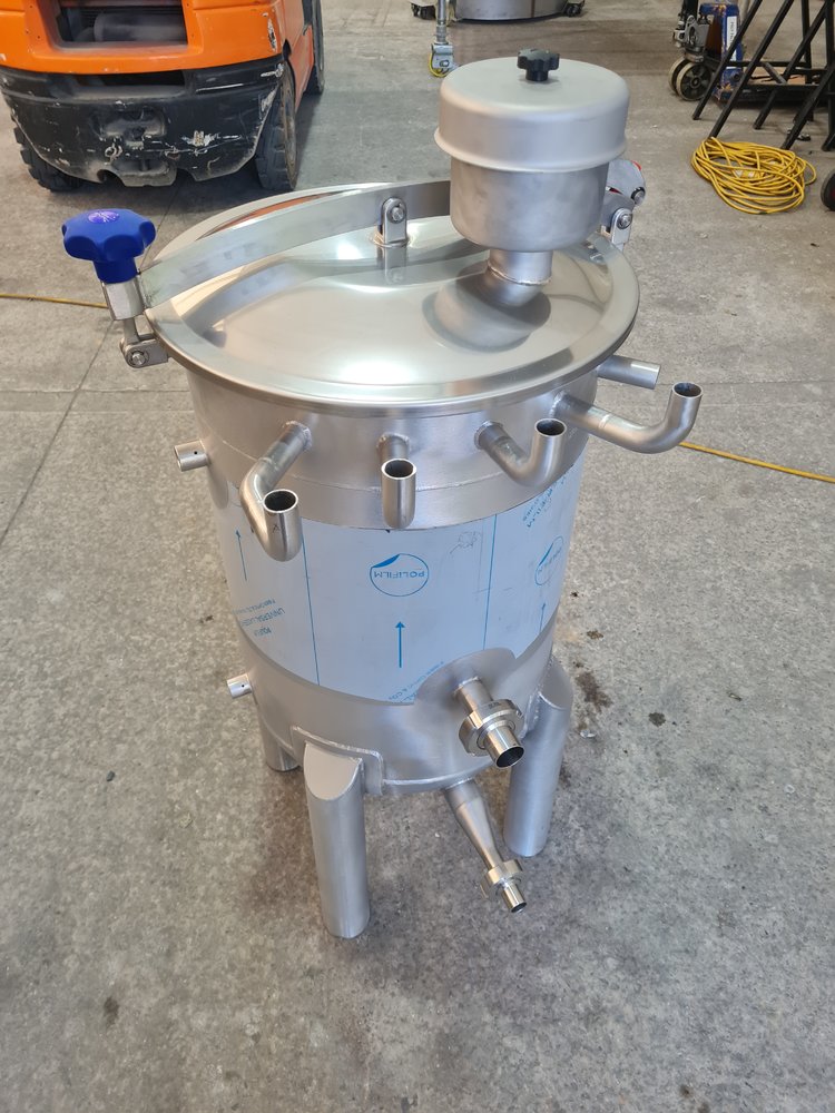

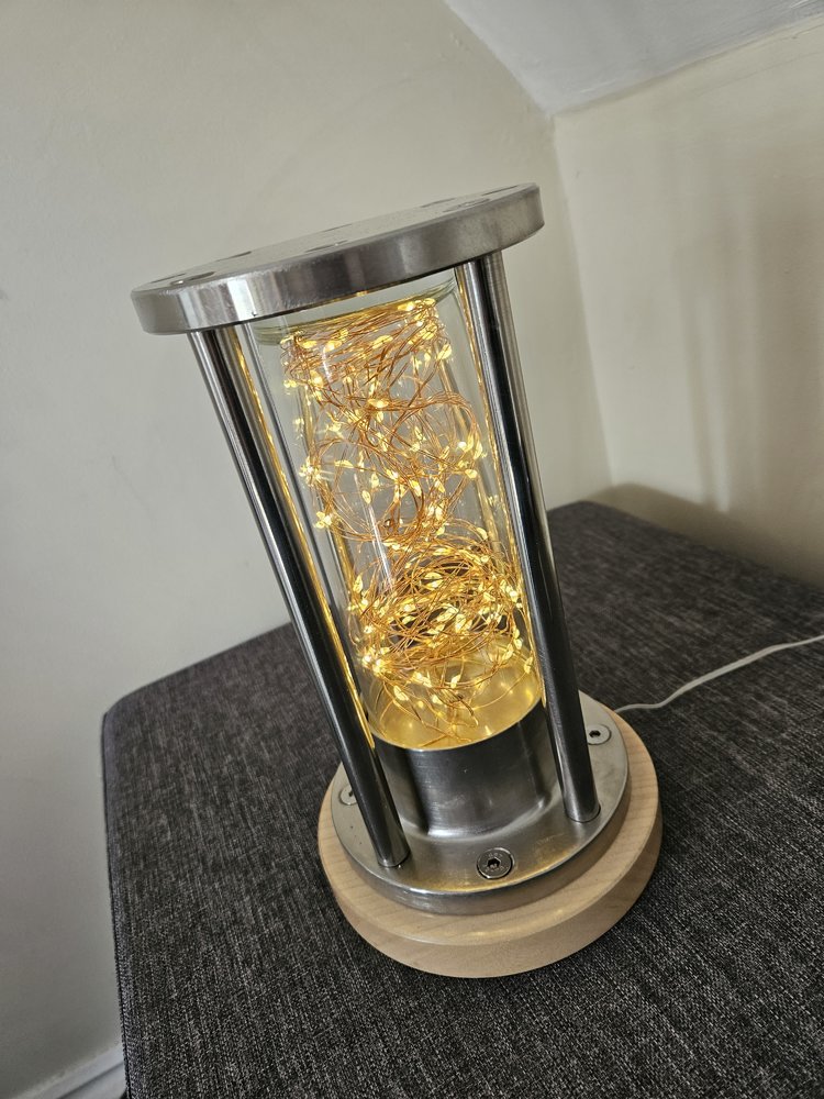

What is it?Finished off this one this morning.
I can't take credit for the polishing, passed that off onto our polisher while I helped him.out with some less technical polishing on another job.
Got to be a bit mindful how you build little ones like that, easy to screw yourself over and make things really awkward.
View attachment 410111 View attachment 410112
It's a small buffer tank, that will be part of a small cream pasteuriserWhat is it?
