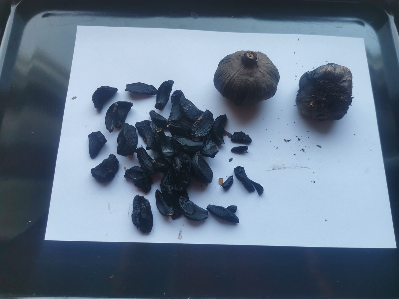

and what was the price and weight? Powder or granules?TriCalcium Phosphate

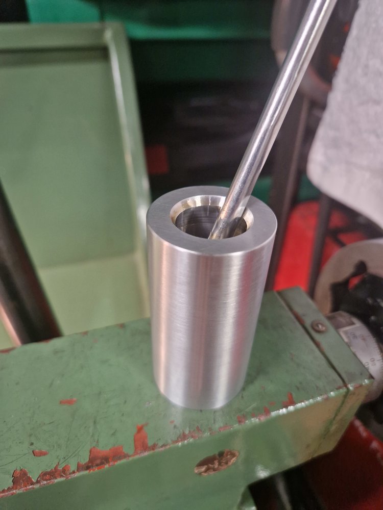

Hmm the insert angle might be wrong if its meant for DN**? I find this stuff interesting - having adapted holders with mixed success. Please update us after its done some turningThey're too small, and DCMT 11s were too big. The manufacturer data says it takes 55° inserts, and it's a pin type so it'd be DN**? But it also says 10mm cutting edge length, and the pin is short. I couldn't find anything like a DNMG 1002 though?
This is the tool data for the bar:

Either way, it works better for me using DC inserts than buying another type just for this.

Hmm the insert angle might be wrong if its meant for DN**? I find this stuff interesting - having adapted holders with mixed success. Please update us after its done some turning![]()
Powder.and what was the price and weight? Powder or granules?
It's incredibly expensive in my opinion. And the powder most likely is not suitable for color hardening. Granules are needed for spotty migration of phosphorus into the metal. However, this statement requires verification. I don't see any difficulty in granulating the powder.
I cant remember the details, but I was unsucsessful trying to use a "P" positive angle rake bar with "C" inserts. but the insert pocket is normally tilted over about 10-15 degrees for positive rake C inserts.
All dependant on bore size too, I think neatural are normally used on bigger bores, the insert pocket may be flat..?
No. For simple cementation there are simpler methods. This is for experiments on color case hardening.
