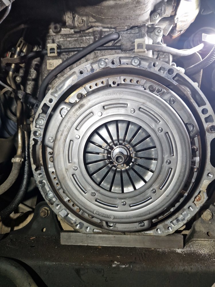

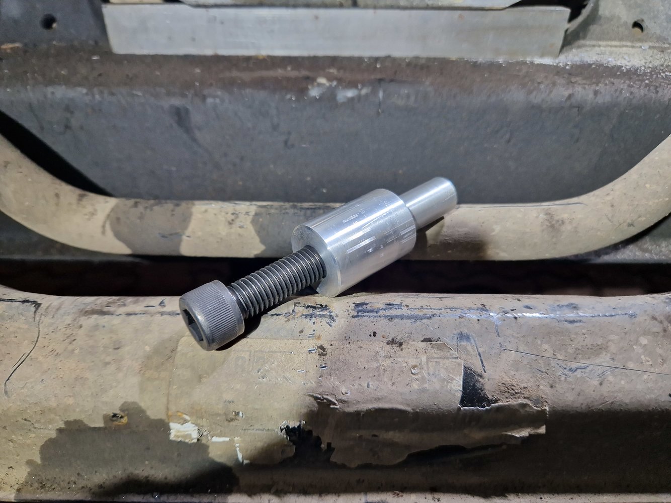

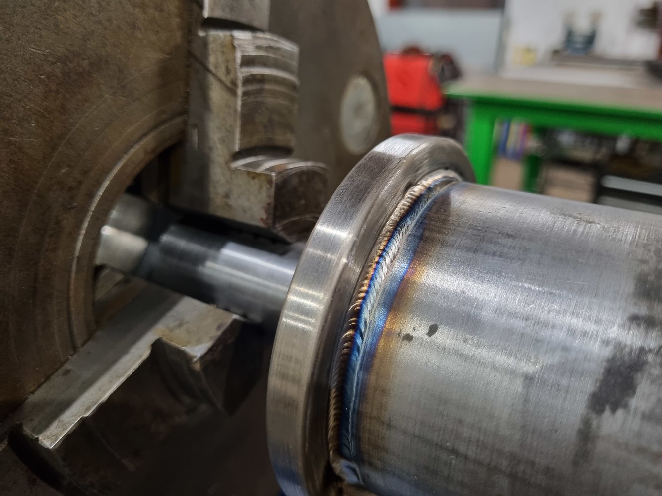

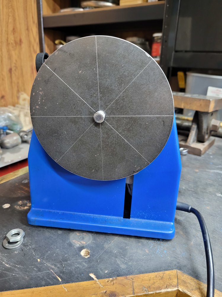

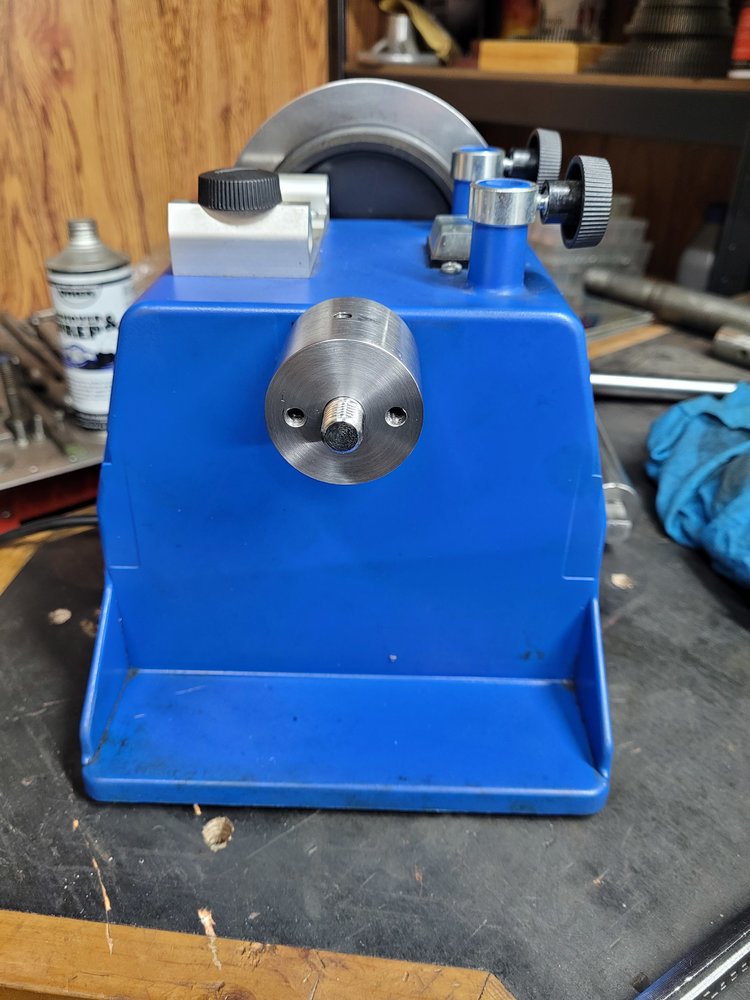

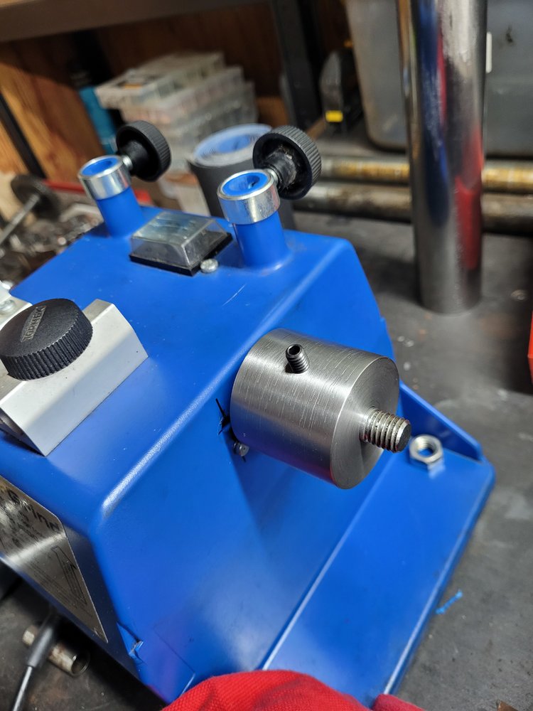

Solid flywheel conversion?A very exciting clutch aligning tool for my Sprinter. Nice quick lathe job.
I have other aligning tools i could've used, but there's something satisfying about having a dedicated one that fits perfectly.
There are but what it saves you in the cost of the flywheel, will cost you in dentist fees getting fillings put back in.It still has a (knackered) dual mass in it, for now. I don't think there's a solid flywheel conversion available for Sprinters, is there?
I have another flywheel to "convert" to solid.
We fitted a few to Sprinters and Transits, but I wouldn't do it.
Transits that got used for towing would shred the clutch plate as despite all the marketing about the super-duper sprung clutch plate doing what the DMF done, it didn't. The torque surges caused them to slip under load until they overheated and shredded.
And I reckoned they used to twist the crankshaft on sprinters. We done a couple conversions, but had to convert them back due to too many complaints, and even after putting a DMF back in, they were never as smooth.

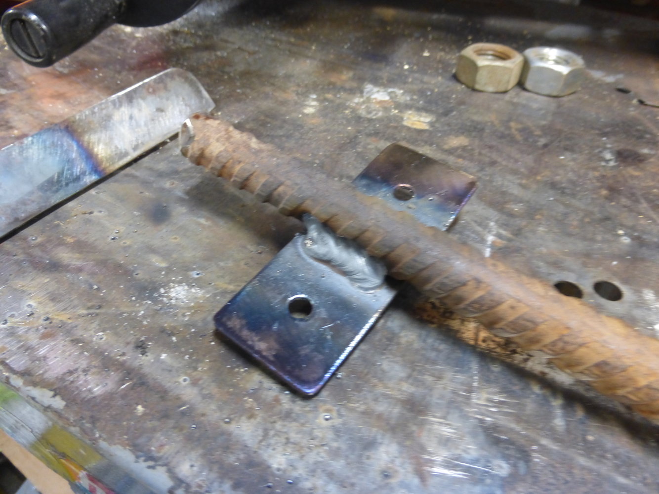

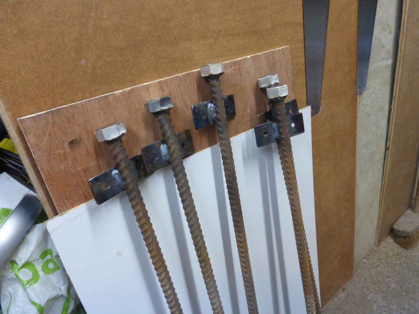

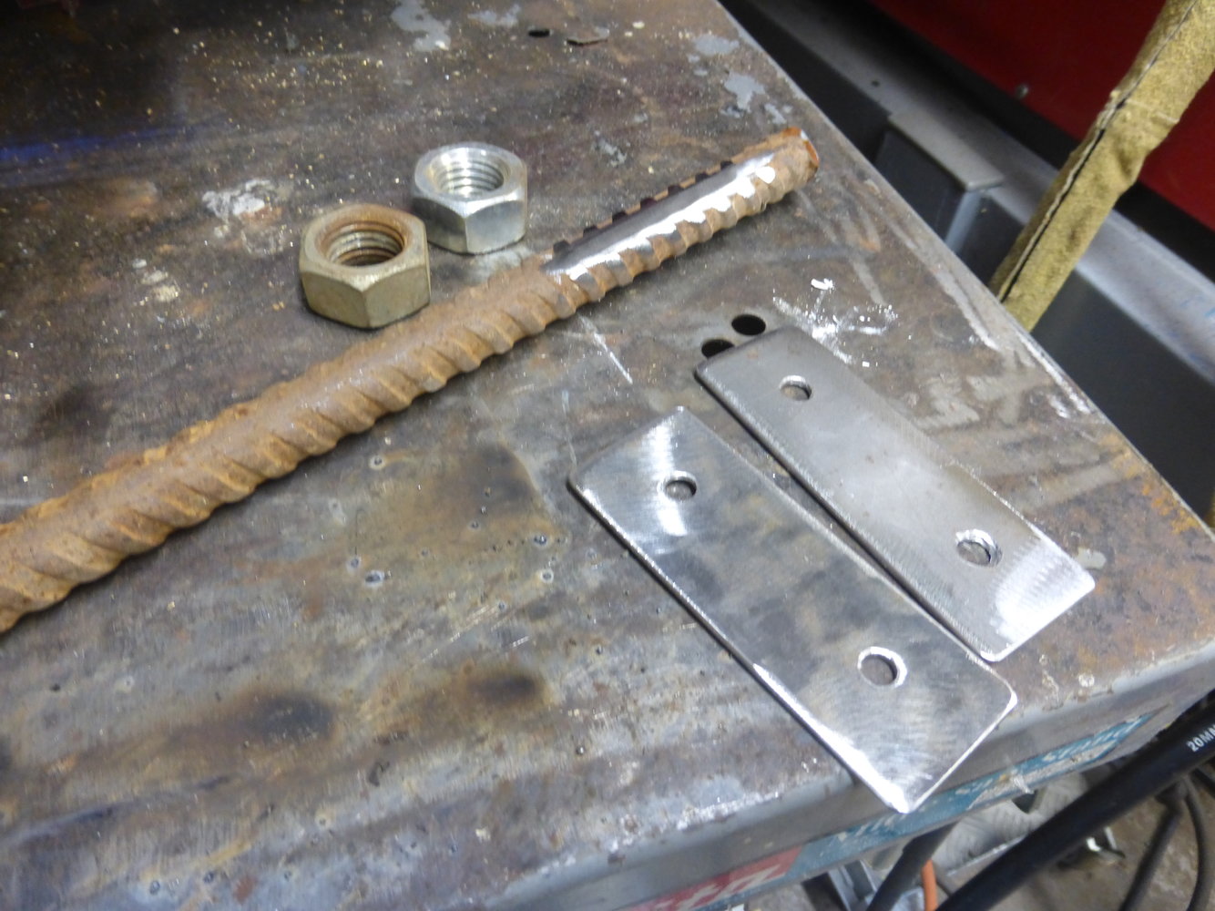

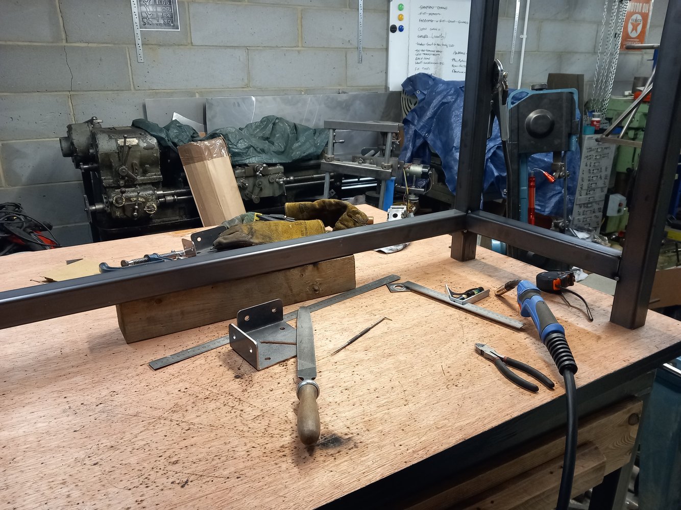

They make F clamps that slit into the T slot under the track, made my Aldi (?) plunge saw much more usable.Plywood sheets arrived nice and early this morning. An opportunity to try out my plunge saw. This pictured set up doesn't actually work. I can't clamp the track very easily so tried clamping some box section behind the track to act as a stop. The box interferes with the motor housing when the saw is plunged. Some lower profile steel strip would have worked but I managed without anyway. The saw coped fine, some more power wouldn't go amiss though.
Depends what you are doing, last time I used mine was to trim down an existing ship lap gate to fit the opening when I replaced a gate post. I did not take much off something like 0 to 10mm progressively along the height of the gate which would have been near impossible with out the clamps due to the uneven nature of the ship lap.Do you find they make much difference on a big sheet? I've got the f-clamps for my track saw, but I think I've only used them once or twice & only when doing short cuts: cutting very narrow parts (where the track might rock back & forth along its length).
For plywood sheets I just plonk the track on and rely on the rubber strip on the bottom to give enough friction to hold it in place.
