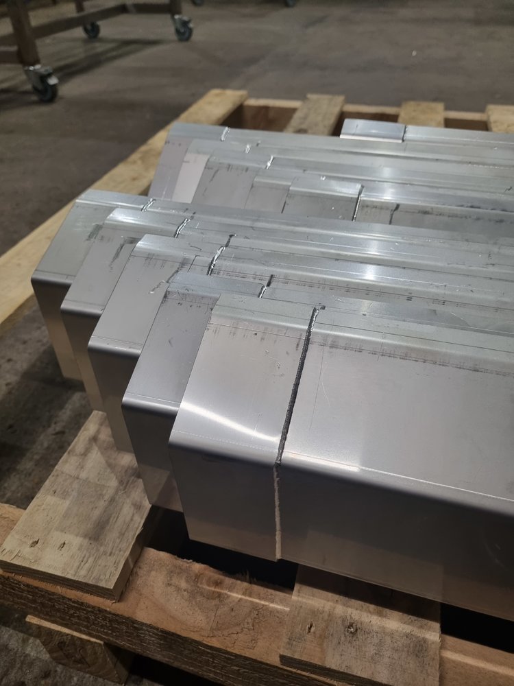

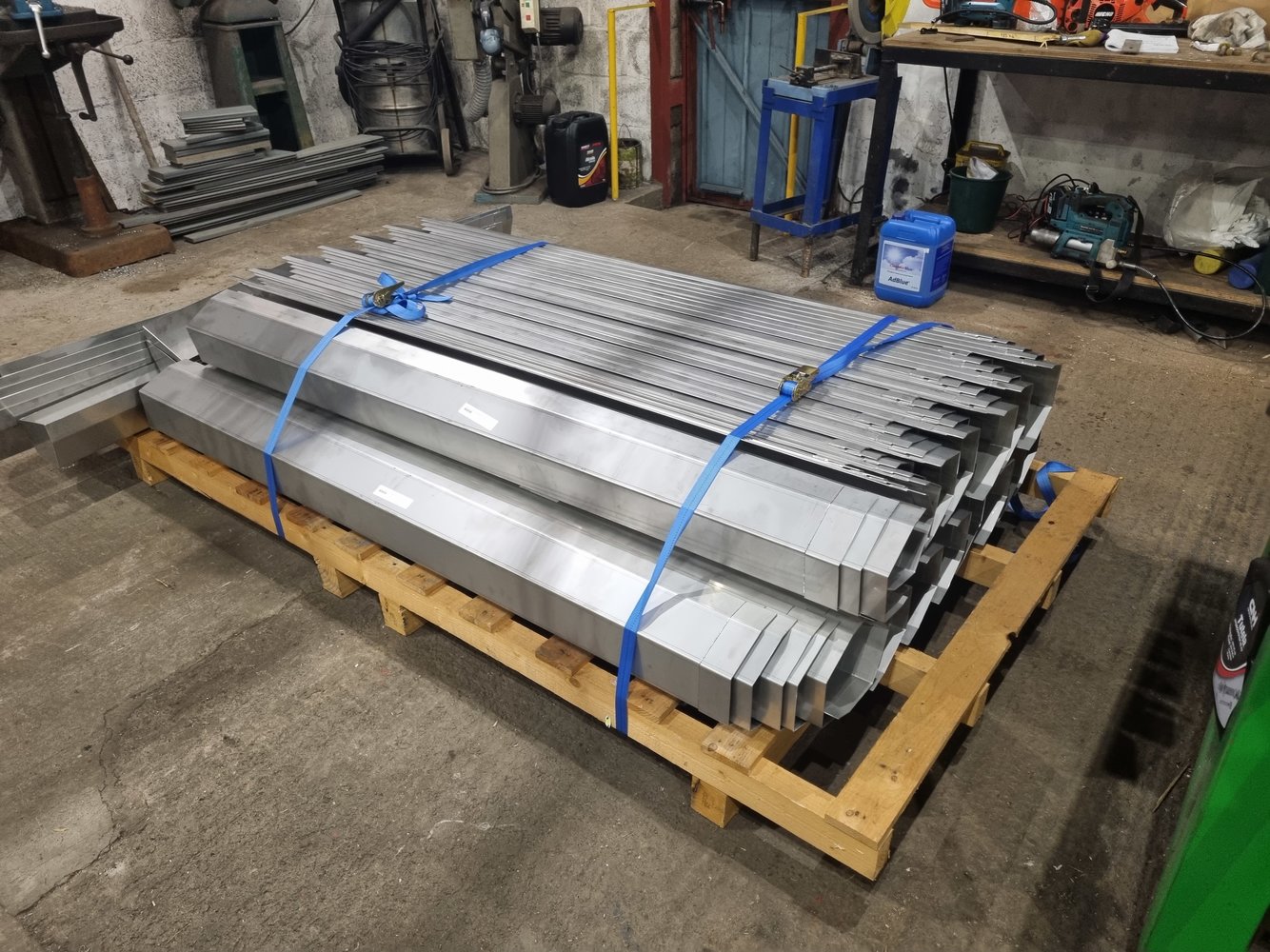

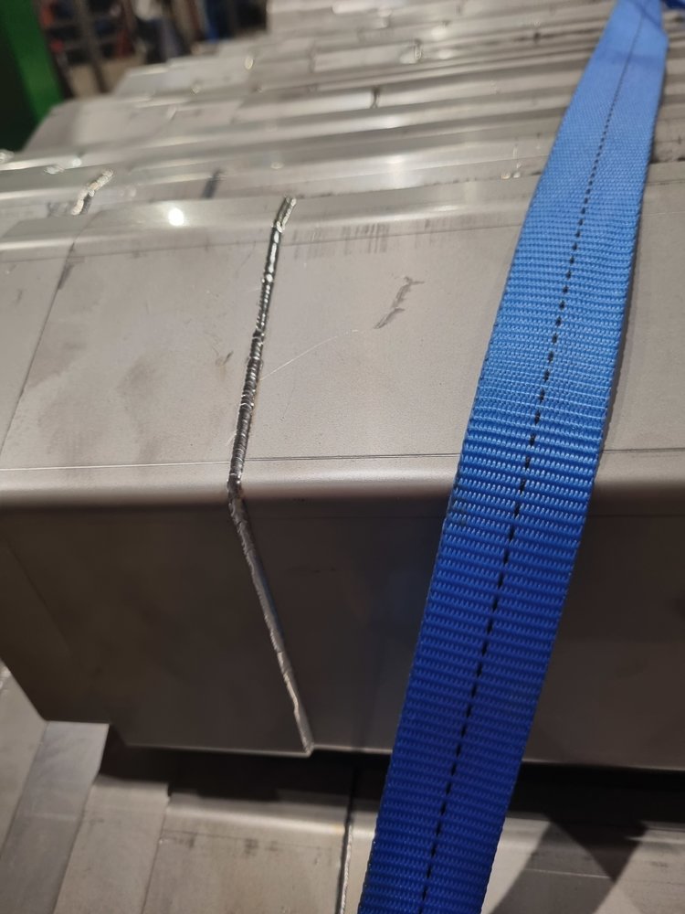

Thats posh, whats the stainless guttering going on?180 metres of stainless gutter sections, joints and ends welded and passivated.
I calculate that's 35 metres straight of TIG welding I did this week. In my spare time...

May have a job for you180 metres of stainless gutter sections, joints and ends welded and passivated.

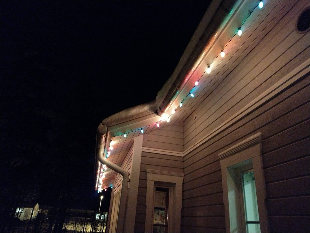

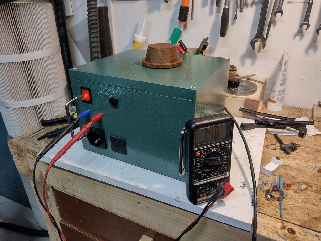

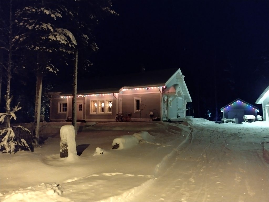

Not completed, still lacking two panel meters (amps & voltage) but functional. I turned a new dial from wood, turned out looking like a hat... What is it? A 4A variac for 0 - 230V based on an old transformer core from the DDR.
What's it for? For running my US sourced christmas lighting:
Haha i'm not setup for stainless really, to do any quantity you'd have to buy an electro passivating machine and i just don't do that much.And here i was thinking this would be a great job for you
Back on legs tonight. Got a relatively small batch to do before Christmas and then hopefully relax for a month. That, or 600 brackets come in
You can make an electropassivating set up for sub£100Haha i'm not setup for stainless really, to do any quantity you'd have to buy an electro passivating machine and i just don't do that much.
I don't enjoy dealing with the distortion anyhow, although it is fun to weld and aim to get better with each one.
I have a customer that wants 300m of 6-8" half round stainless gutter
Yep, have played in the past with phosphoric acid and a battery charger.You can make an electropassivating set up for sub£100
Passivating in quantity is a bit of a pain and yes the cost of the machine sucks. Its way faster using a "real" machine with some decent amperage behind it I agree. Then its all to neutralise afterwards, or you get left with acid salts that eventually corrode. Acid is around £100/gallon, so is most neutraliser, although I'm using one that dilutes 1:10 which softens the cost a bit. I have to price passivating pretty high, because neither me or my brother fancy doing it for labourer wages.Haha i'm not setup for stainless really, to do any quantity you'd have to buy an electro passivating machine and i just don't do that much.
Then you are doing it wrong.Yep, have played in the past with phosphoric acid and a battery charger.
Rarely are the results as good or as quick as the proper machines.
Okay Johnny, well why don't you enlighten us all.Then you are doing it wrong.
That comes across as more than a tad sarcastic. Sure someone as clever as you can figure it out, after all, it’s not rocket scienceOkay Johnny, well why don't you enlighten us all.
You're right, it's not. It's really simple - the more power, sophistication you have, the faster and better it goes.That comes across as more than a tad sarcastic. Sure someone as clever as you can figure it out, after all, it’s not rocket science
