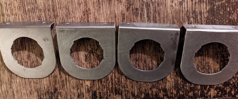

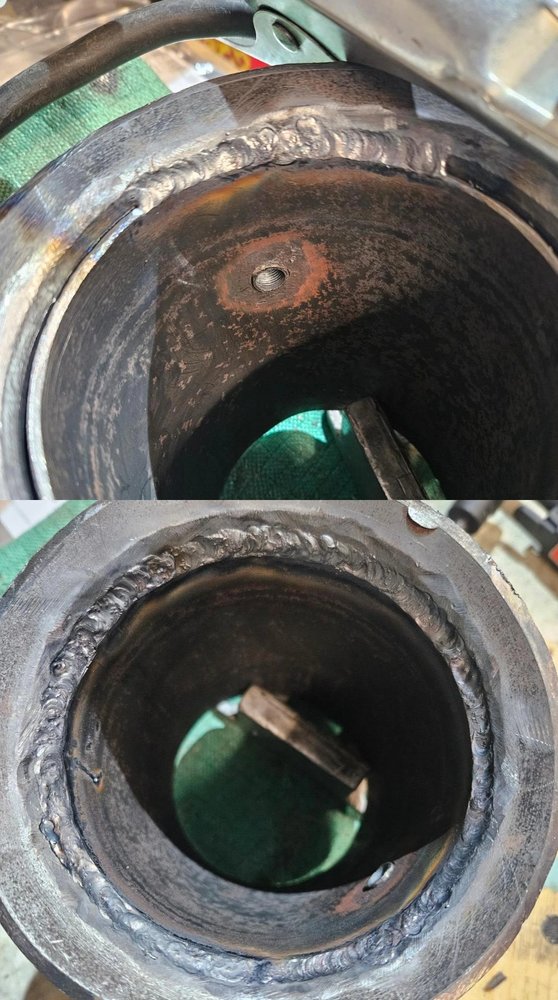

After messing about with a few practice scraps...and producing some messy-looking welds...I finally came up with some settings that worked fairly well as a starting point for mild steel 1/8" butt joints. I used pieces of 2” x 1/8” bar and 1-1/2” x 1-1/2” x 1/8” angle to make the mounting brackets for the tape rack. I cleaned the metal a bit, clamped the pieces together, and tacked the joint in a couple of places on each side.
I'll admit that I cheated a little by clamping a length of angle on the workbench to serve as a guide that I could slide my torch hand along to help maintain a straight line. Even using the guide, I still had to toss out a few less-than-acceptable (read 'ugly') welds, until I found a comfortable position for holding the torch with both hands and drawing it steadily along the guide. Using both hands really helped steady the torch. After welding, I trimmed off a couple of pieces of excess metal at the ends to check the penetration of the welds, and I was pleased to see that they had full penetration (see green arrow below). Note that I didn't put much of a bevel on the edges before welding. If I had made a deeper bevel, I probably could have used somewhat less current (I used 135A) and a little faster wire feed rate, which I think could have reduced the HAZ width The pieces below are my best efforts, which I think came out pretty well.

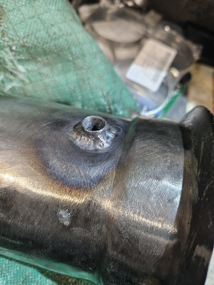

I welded a short piece of ¾” square tube (rotated 10 degrees) onto each of the mounting brackets to insert in the ends of the long 1” square tube that the rod-holder sleeves will slide on. Then I slapped together the rod-holder sleeves, which are pieces of 1-1/4” square tube with nuts welded onto them. The rods are 3/8” x 8" bolts with the heads trimmed off. If desired, the bolts can double as set screws to secure the positions of the rod-holder sleeves on the long tube.
After reconsidering the mounting position under the shelf, I ended up slicing 1-1/2” off each of the mounting brackets, which gave me a chance to check more spots for weld penetration along the butt joints (green arrows below), which was still excellent.
