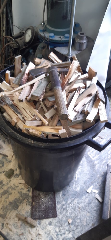

My mum had to teach me that 35 yrs ago when my dad's old pop-riveter failed to popMostly, I made my Unior pop - riveter start to eject used pins once more.

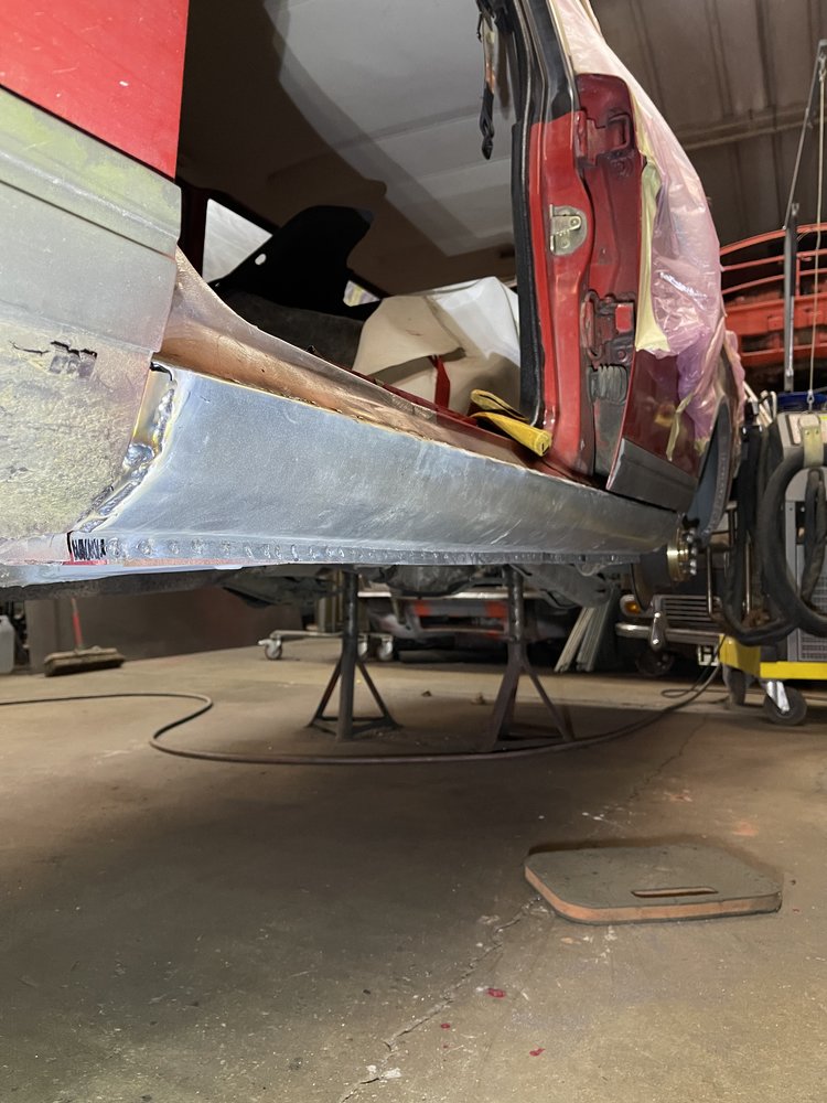

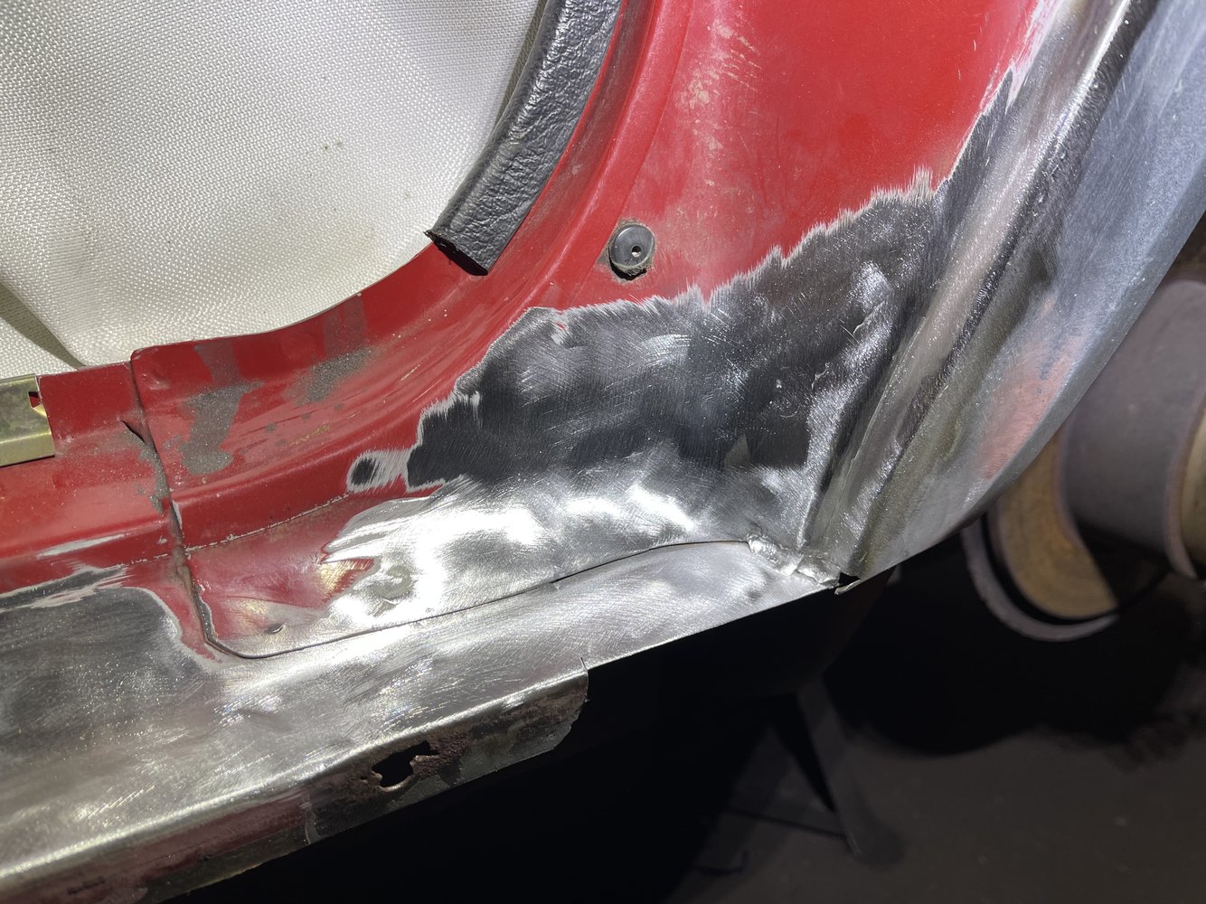

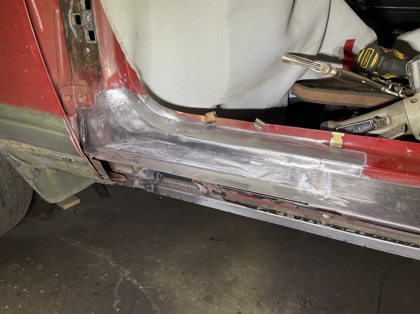

No bracing to prevent warping?Yet more Volvoing. The front step repair went in nicely then I made a repair for the rear step/door frame.
The left hand sill got prepped and fitted as well and that’s the last of the panel replacement!
No it’s not really necessary when you’re only replacing the skin of the sill. If I was cutting out the step and the inner sill I would add a brace but fortunately I didn’t have to go that far.No bracing to prevent warping?
That’s a bit drastic! Wouldn’t you be better using it on the fire

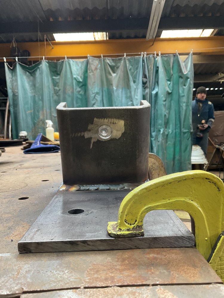

Why a LH drill?Making a batch of these today,that’s 140/140/10 box split in half,welded to 10mm plate,13/16” hole bored with a left hand drill,plasma cut 2mm cover plate to be added.7 in line on the bench.View attachment 440754
My drilling mc is very noisy from wear,yet dead quiet in reverse,so found some left handers in the usual sizes,Tracy Tools.Why a LH drill?
Burreg! I was trying to recall their name last week when I wanted a couple of taps.Tracy Tools.

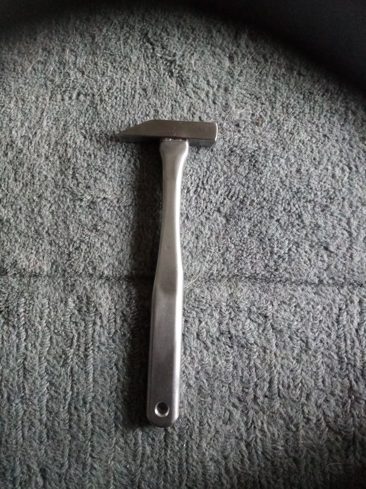

That's a bit posh for breaking up toffee.Little tack hammer. Carbon steel head hardened and tempered straw yellow with an aluminium handleView attachment 440890View attachment 440891View attachment 440892
Yellow's a little hard, I'd have thought.Little tack hammer. Carbon steel head hardened and tempered straw yellow with an aluminium handleView attachment 440890View attachment 440891View attachment 440892
Aye maybe brown would've been betterYellow's a little hard, I'd have thought.
I'd go with purple , better softer than hard as hell,it can crack shooting fragments which can cause serious injuriesYellow's a little hard, I'd have thought.
