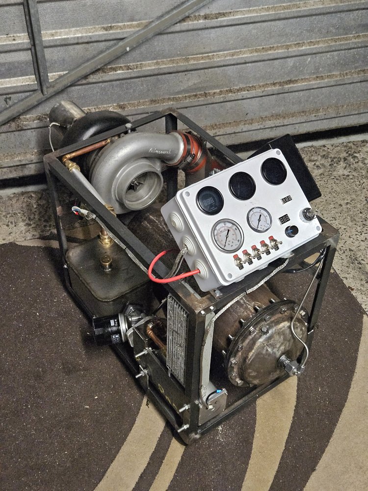

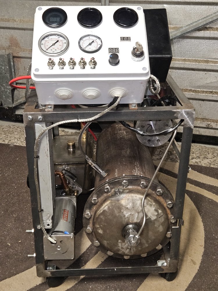

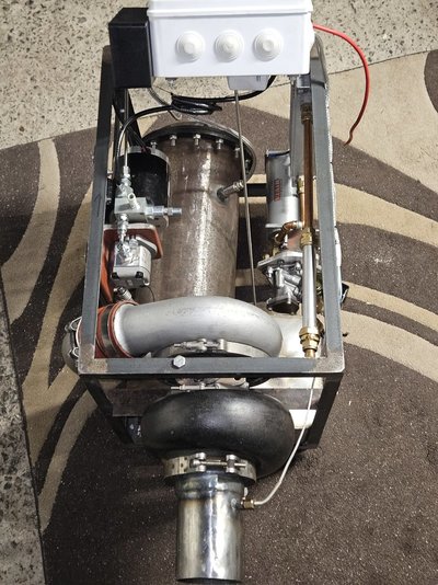

we will need videos of that beast!!It is done and ready for testing
View attachment 443326View attachment 443327View attachment 443328View attachment 443329 View attachment 443330
Gonna need a bunch of strong men first bugger weighs easily 80kg thank god I put wheels on itwe will need videos of that beast!!

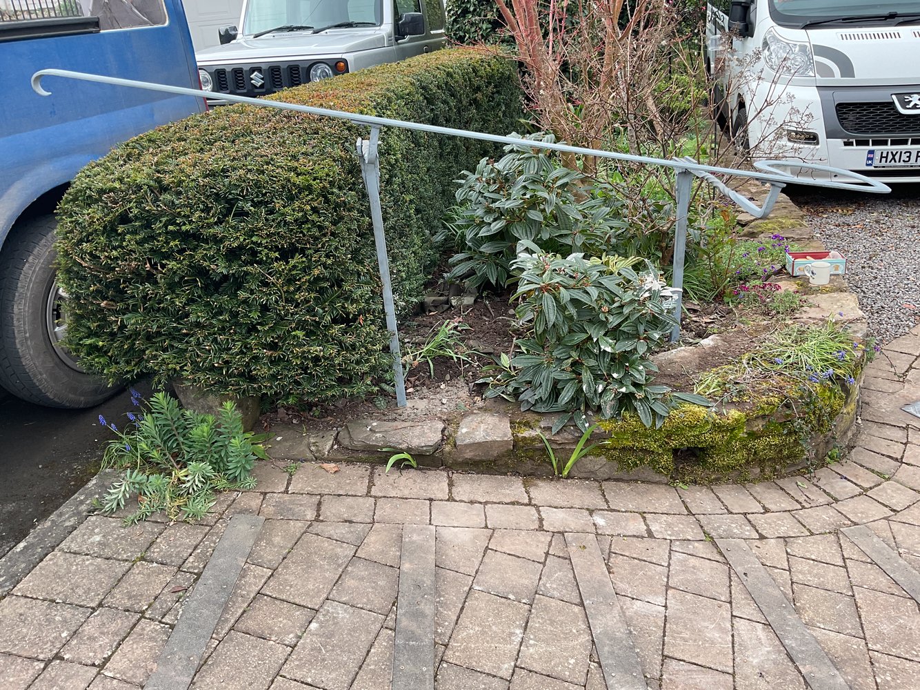

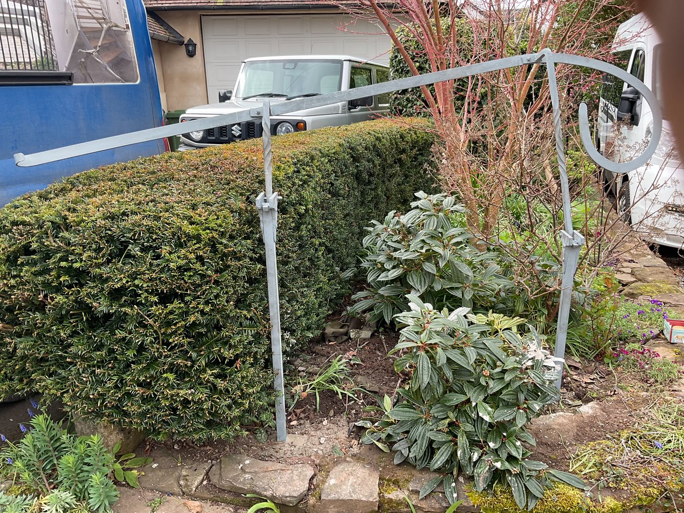

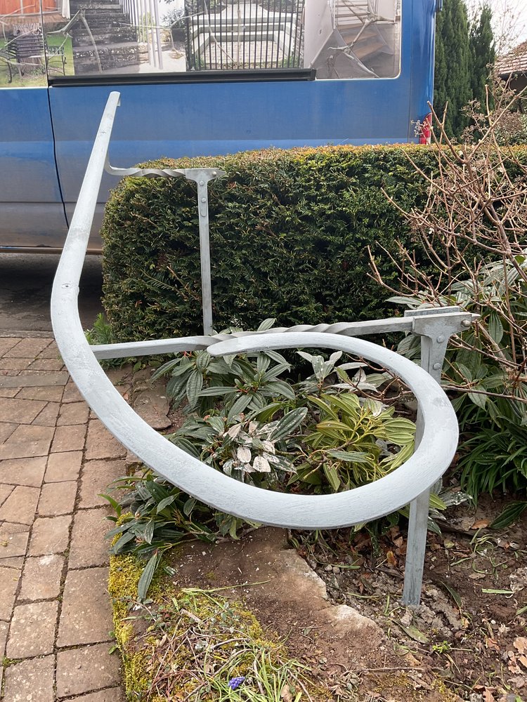

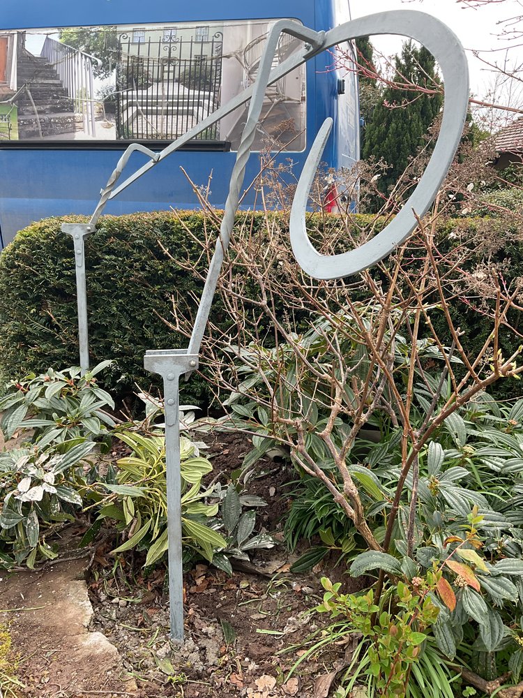

Nice job, do you reckon they will forget to flip it and rip the side out of the van though?First for me,folding handrail as it enables customer to access camper van,the cantilever on the bottom post was 660mm,so that post went in 850. Had to bore the pivot holes 11mm for a m8 bolt,to allow for 100 degrees of transition.View attachment 443322View attachment 443323View attachment 443324View attachment 443325
I was more worried about fingers, young, aged or in-between, in those two guillotine/crushers !Nice job, do you reckon they will forget to flip it and rip the side out of the van though?![]()
