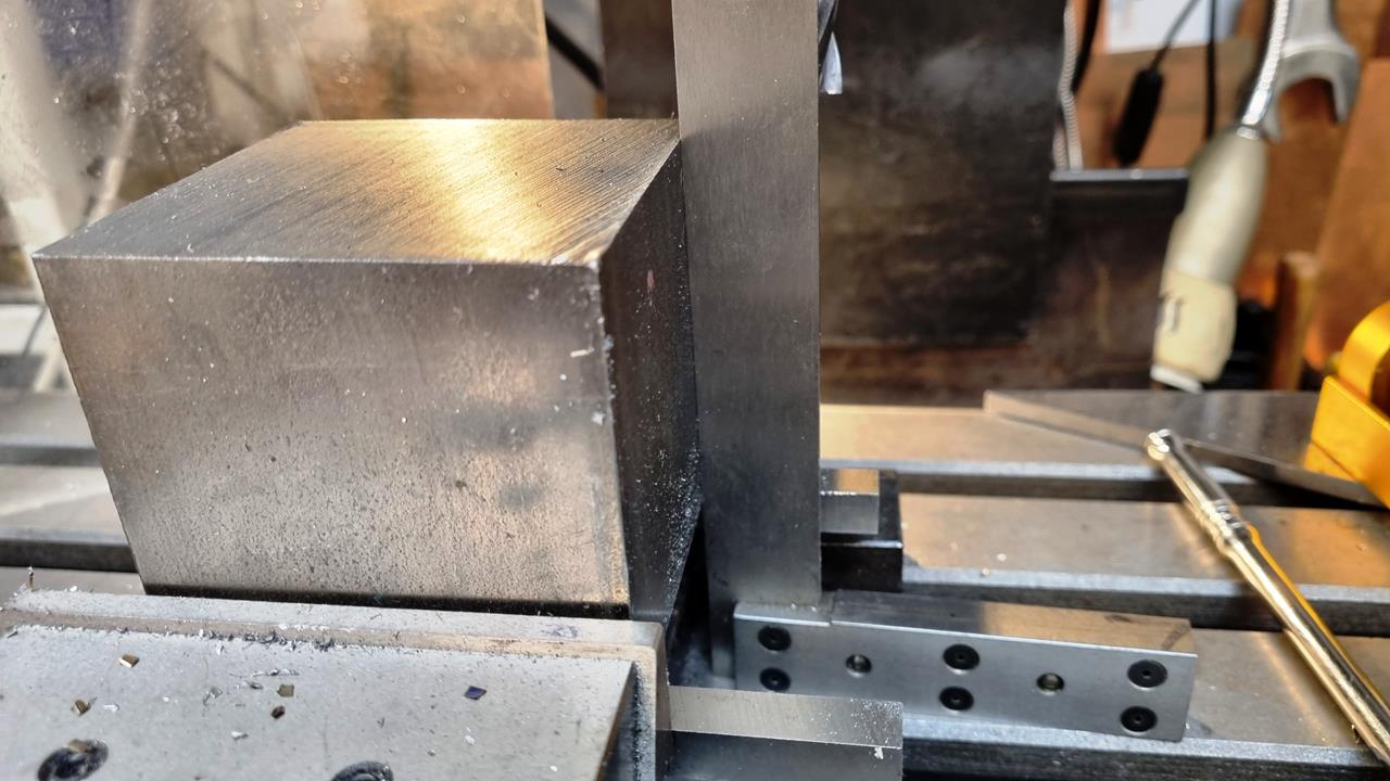

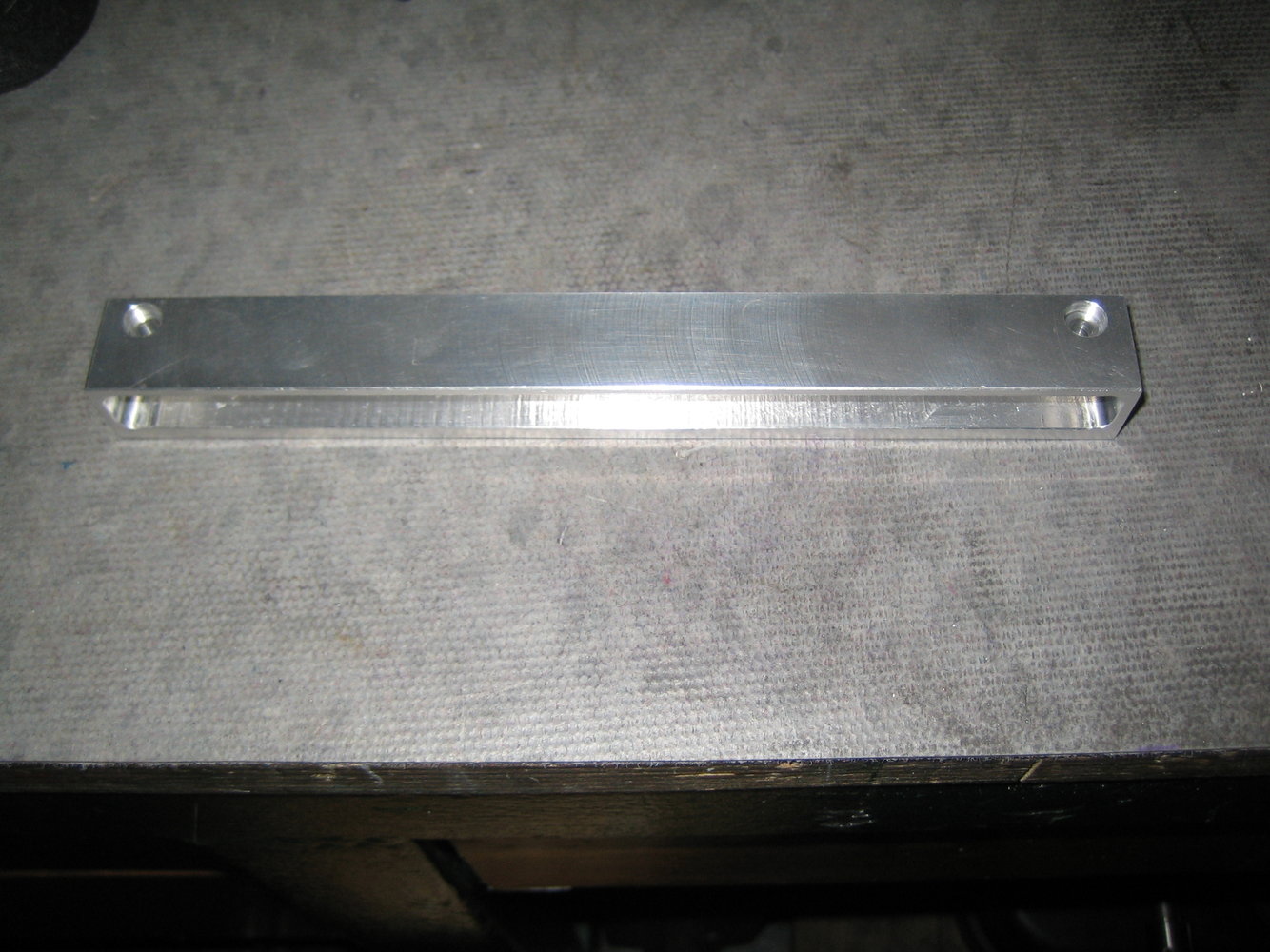

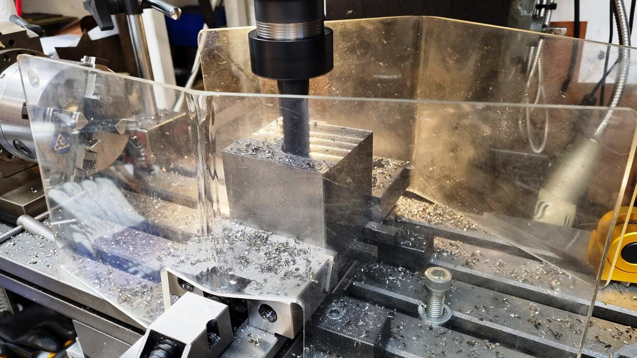

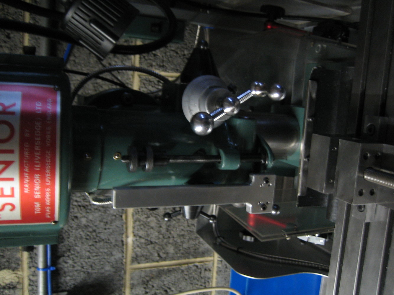

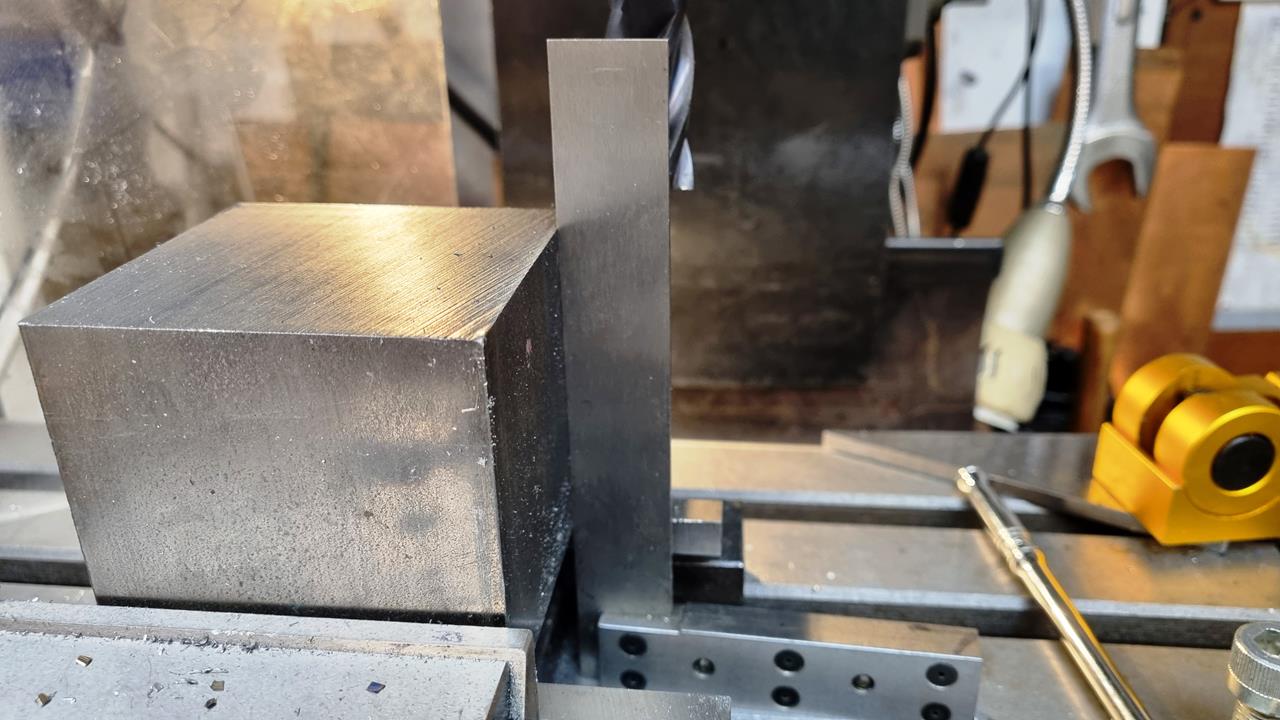

Thought I would start by getting that lump of steel in the mill and squaring it up:
It was well out, but it came right:

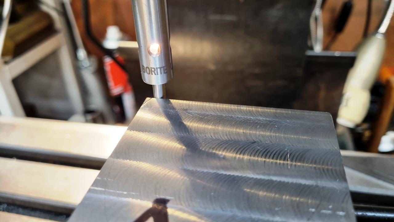

Then set my X and Y zero's:

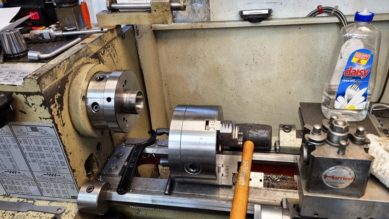

Whilst going back and forth on the manual Mill I decided to set a job up in the lathe, I managed to get the collet chuck in before I remembered I needed the three jaw in:

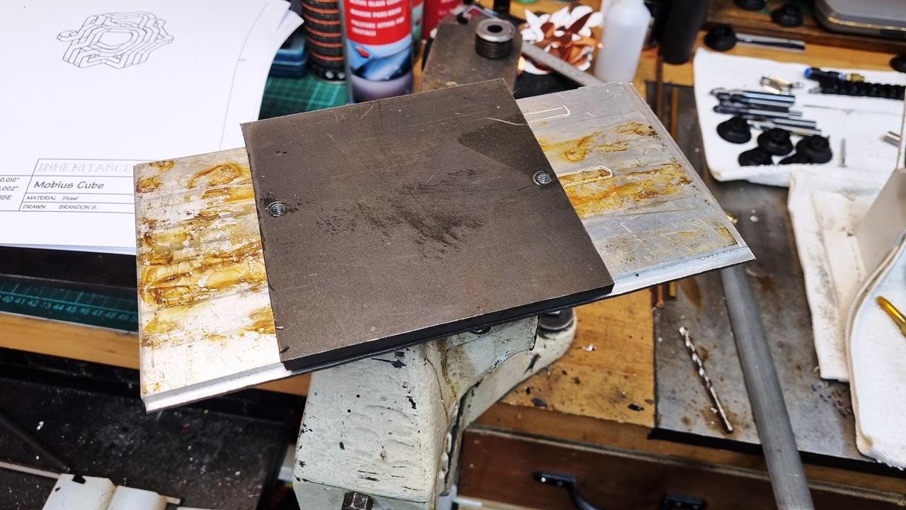

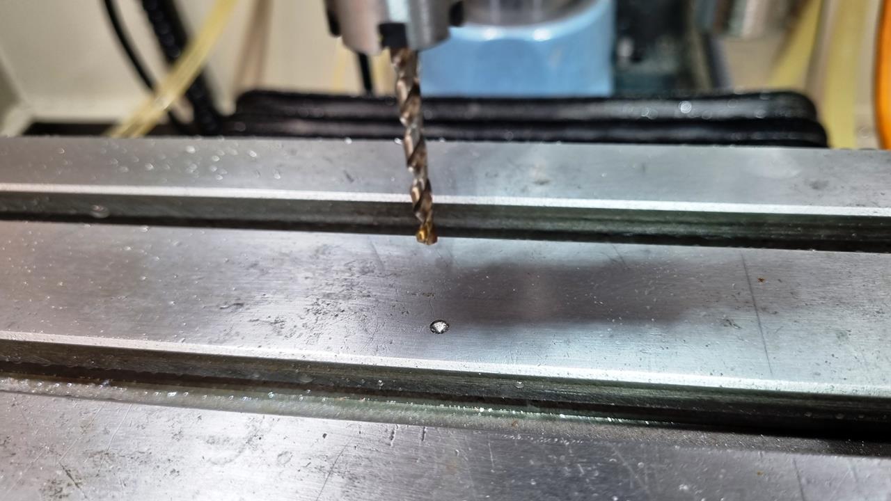

abandoning this idea for a minute I decided to get a job set up in the little CNC, first up, some way of mounting the job. I decided to fasten the plate I would use to the sacrificial using countersunk screws:

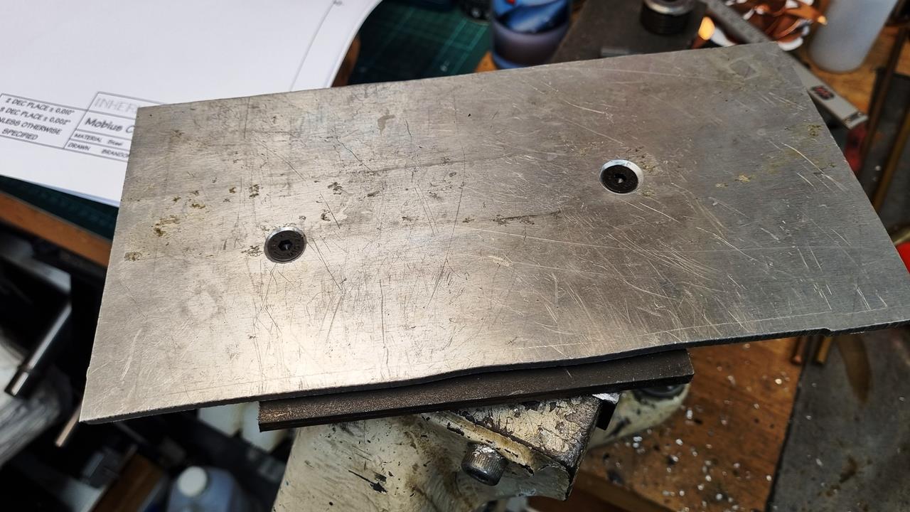

This turned into a disaster, somewhere along the line the drilling program defaulted to 12.7 mm (Bobcad, known bug) and I am just learning so managed to put a mark of shame in the table, I watched it do it, mesmerised like a bloody snake, then I snapped out of it and hit the emergency stop.
