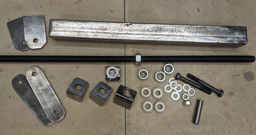

I might have found my mojo and started doing stuff to my Jeep
It's been modified by a previous owner and lots of what they have done needs tidying up

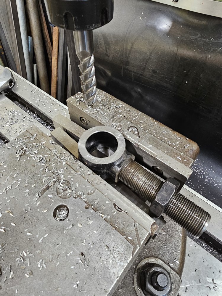

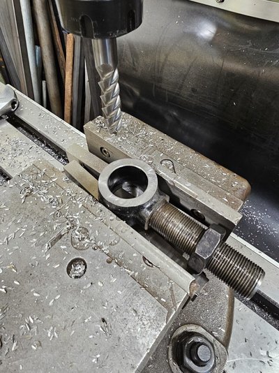

Rear panhard rod was a proper parts bin special and on 1 end had a rose joint type thingy that was shot

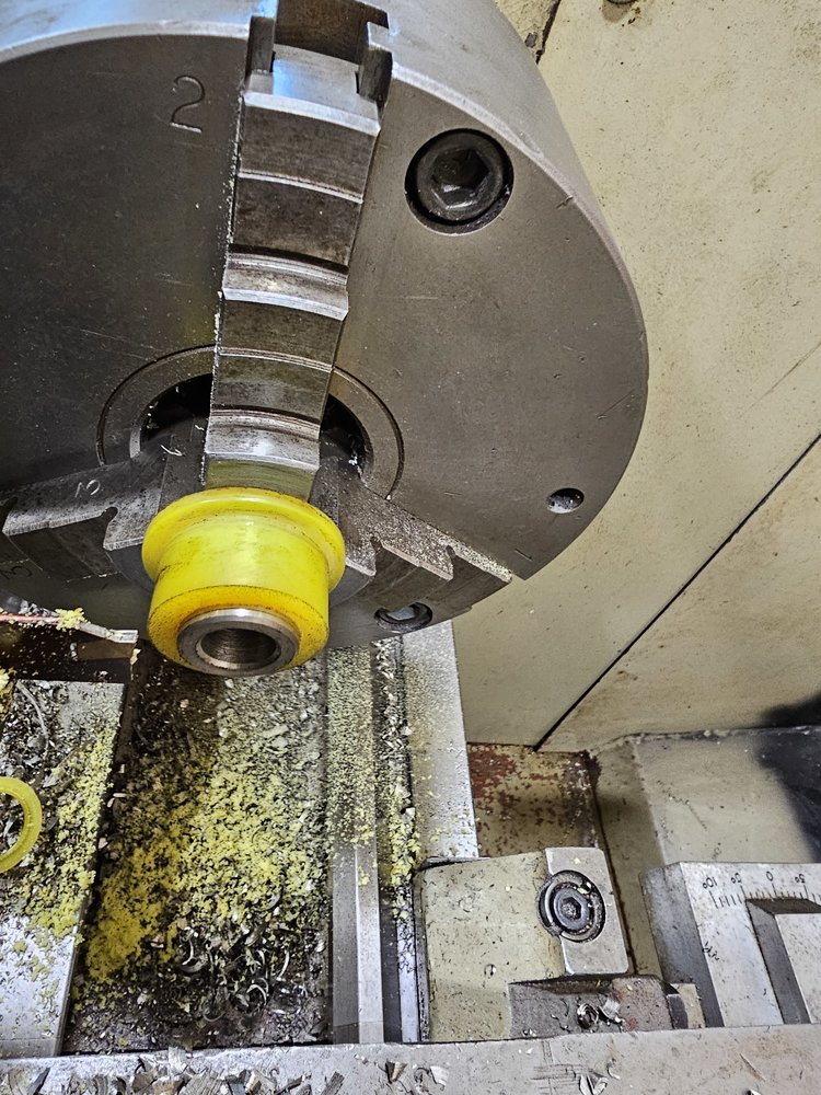

I had a HD Disco 1 front panhard rod that I'd kept just in case it might come in handy so decided to modify it to fit the rear of the Jeep

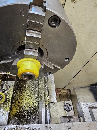

The one end of the D1 rod was 5mm too wide so new stainless sleeve machined, poly bush cut down and the adjustable end slimmed down to suit
Had lots of chatter when milling the eye so quick buzz on the belt sander made it look more presentable
The other end needs to be 5mm wider so have ordered some 35mm stainless bar to make a pair of top hat sleeves
