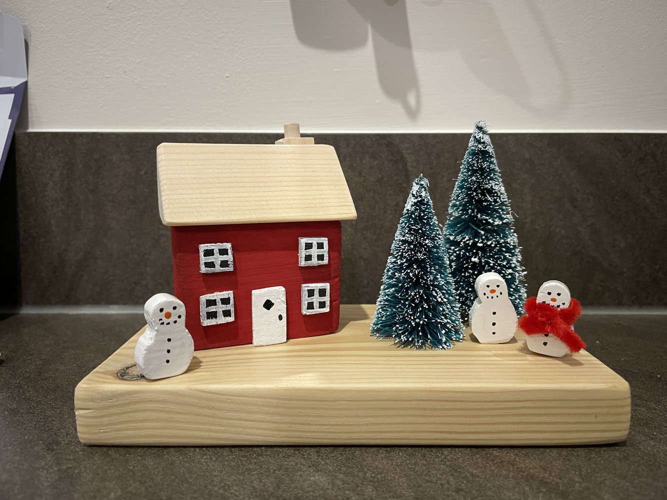

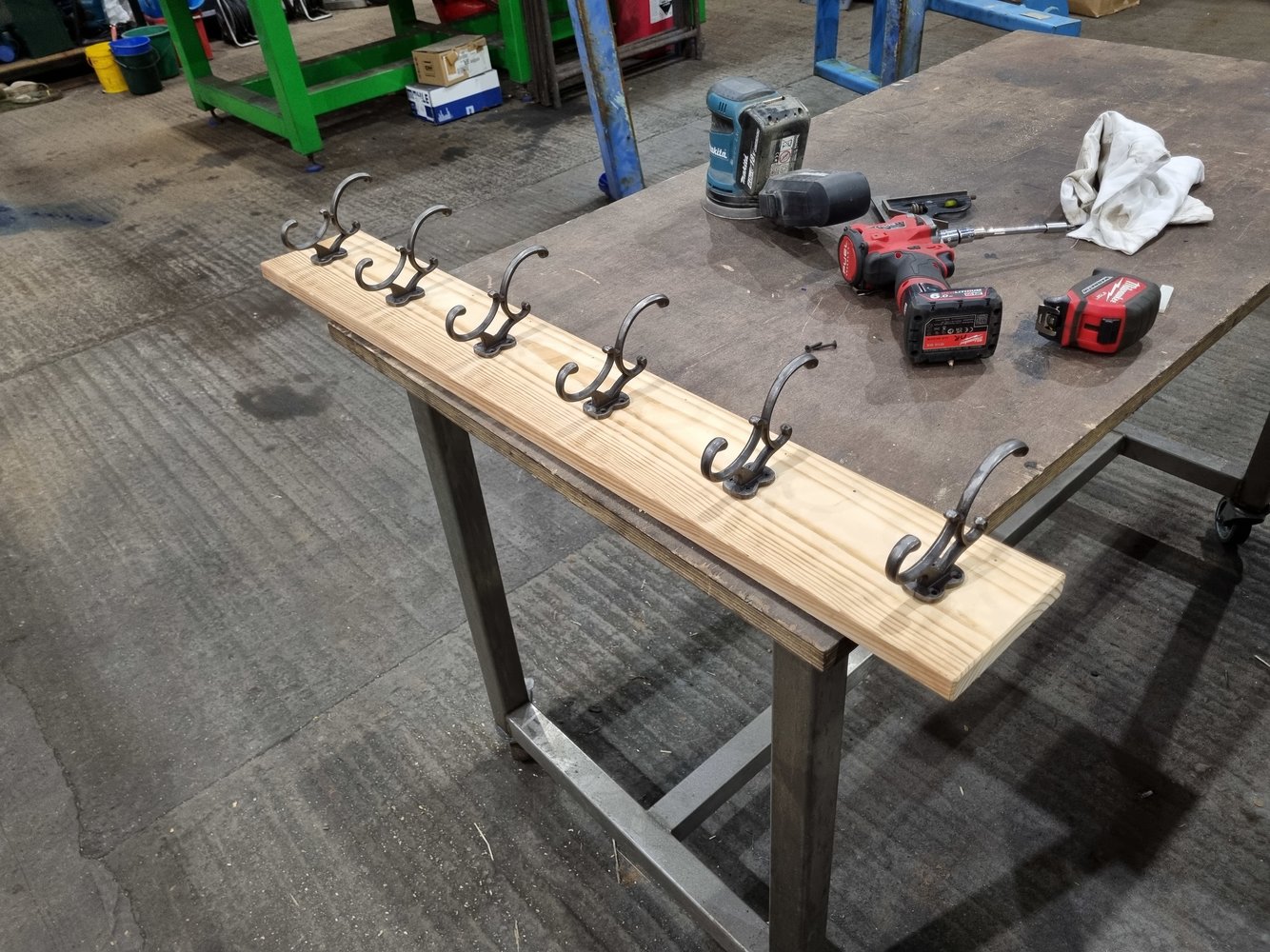

I decided to have a play & try out the welder I bought from @Morrisman & made a wine rack. Horseshoes came from @hotponyshoes Thanks both of you.

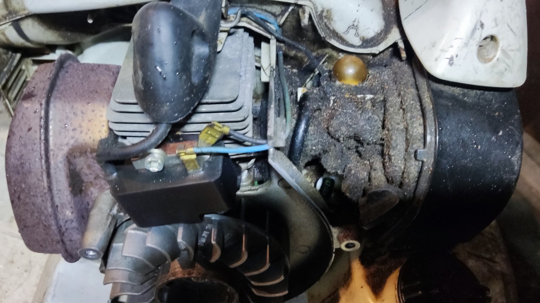

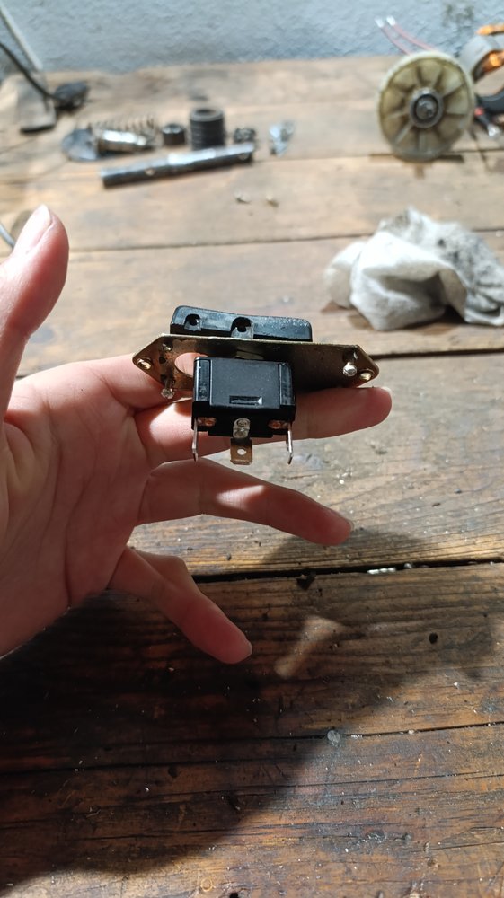

Ended up ordering a new switch but it will not arrive until 2025.Destroyed the stayer Len 200 switch attempting to loosen up the corroded screws.
1 screwdriver
2 hammer and screwdriver
3 impact driver
4 pliers
5 solder flux and soldering iron tempting to eliminate corrosion and transfer heat to make the flux run through the threads.
Didn't work
6 drill through the wire hole to reduce the portion of the screws that I've eventually drilled through.
Unfortunately the brass insert break a part.
Not a fail it's still salvageable.
I'll solder small length of wire directly to it because a similar switch apparently is more than 80 euro plus I have no time to waste waiting for it.
Prior to this little step back I've successfully soldered new wire to the stator windings because they were completely rotten.
Called the day.

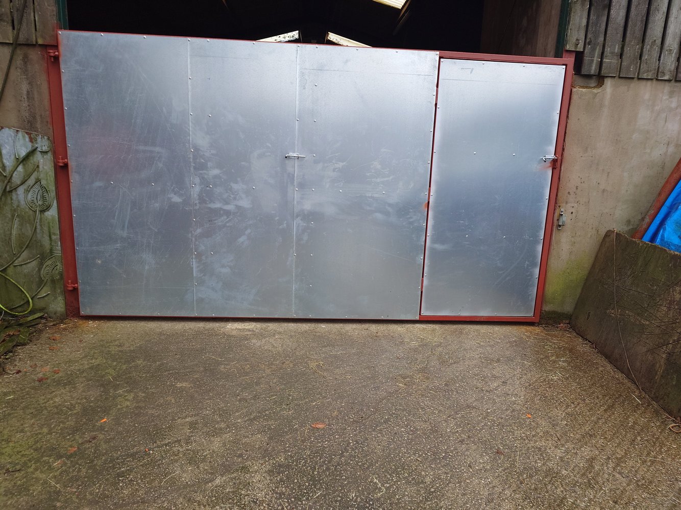

Proper jobNo today but the last week or so I've had a few jobs on the go for my dad on the farm.

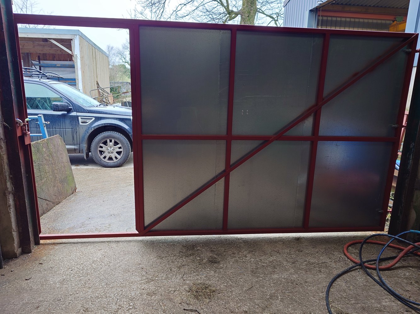

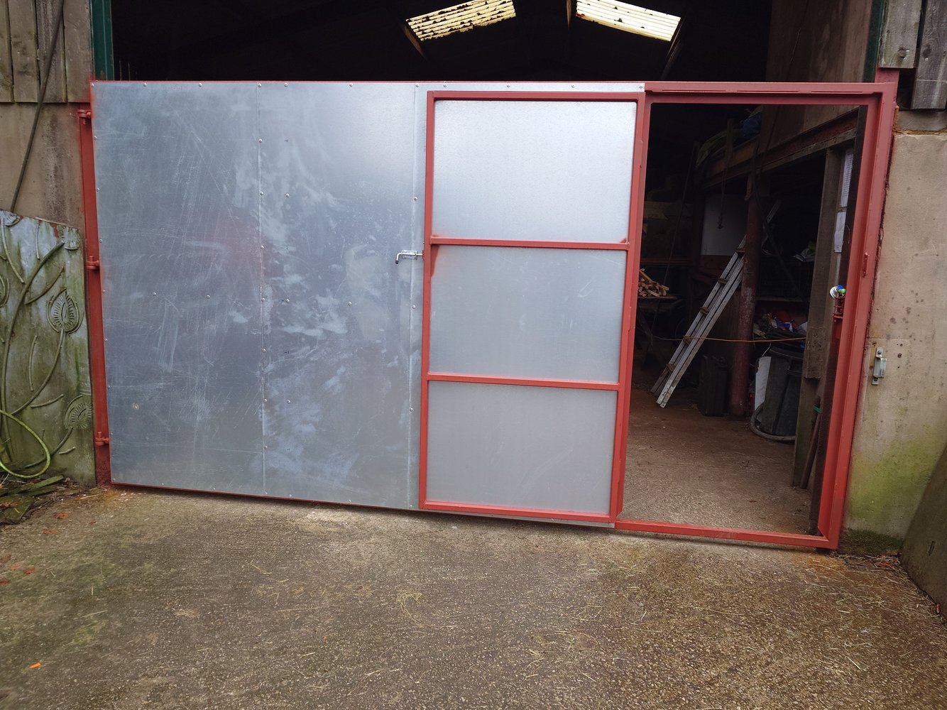

First up a security/sheeted door for the hay barn which is mostly used for storage as the weather has been so carp this year we haven't made any hay!
It has a built in pedestrian door as 90% of the time it's just one person going in to grab something, so saves having the door take off in the wind.
Big door can only be opened from inside, little door locks from the outside.
I braced the back as there's quite a bit of weight to it compared to a normal sheeted door. 3 hinges too.

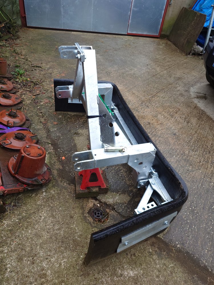

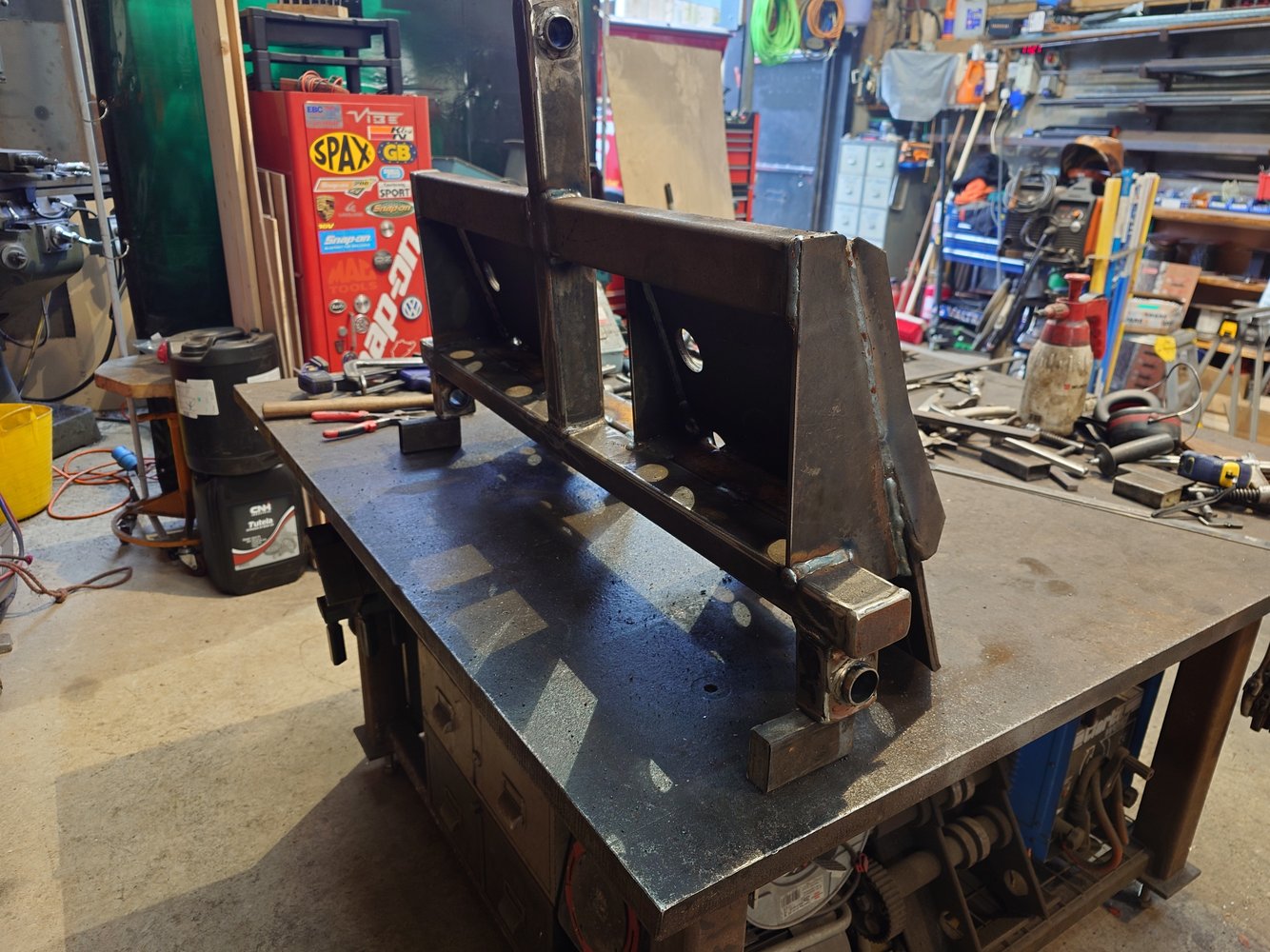

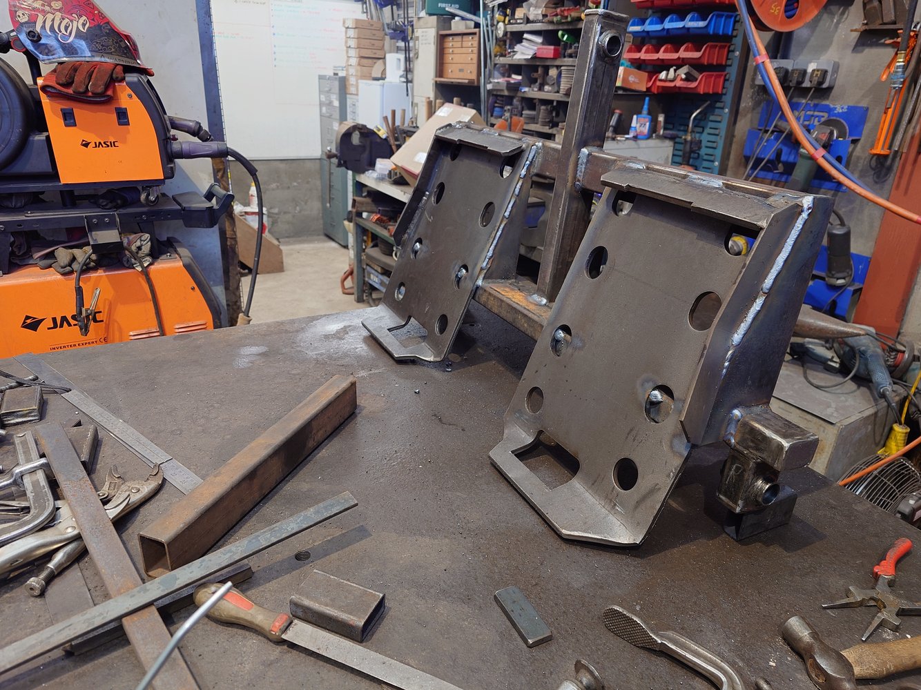

Also made an adaptor for the skid steer, to allow use of the new yard scraper which is a 3pt mount (also has an a frame mount but that would have been more awkward to modify). Saved me grinding galv off a brand new implement, and the adaptor will likely fit other 3pt kit we have.
Really impressed with the brackets I got from sparex, they're usually 6mm max, these are pretty much all 10mm plate! Hopefully stop my dad bending them!!
All welded up, plenty of bracing. The angle is because when fully crowded back the headstock isn't vertical on this machine.
The new scraper, gald my welding is better than theirs...

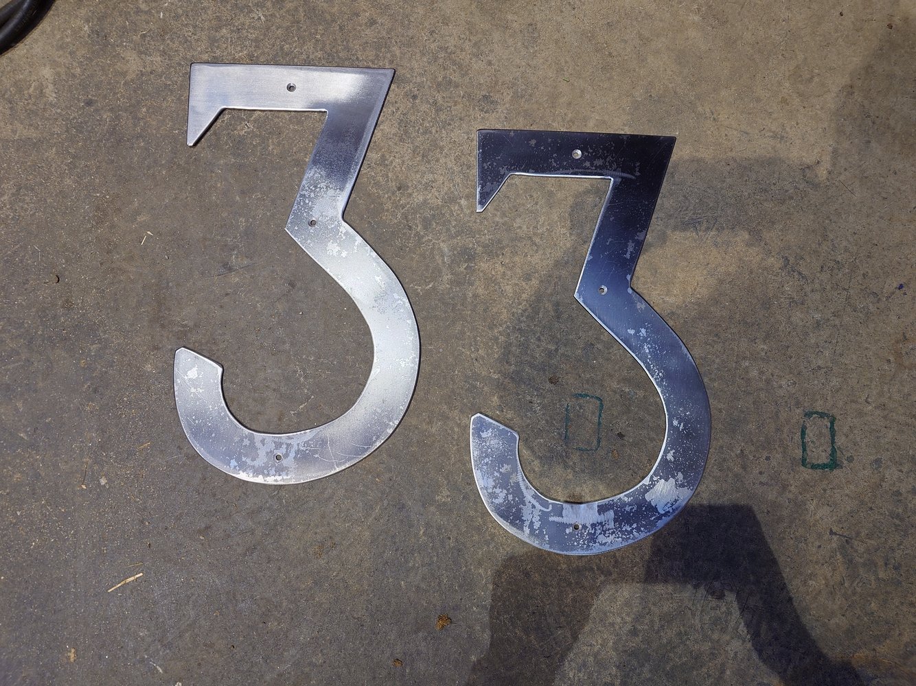

Also made these for a customer.
They're 500mm tall for scale... Should be able to see that from the street!
