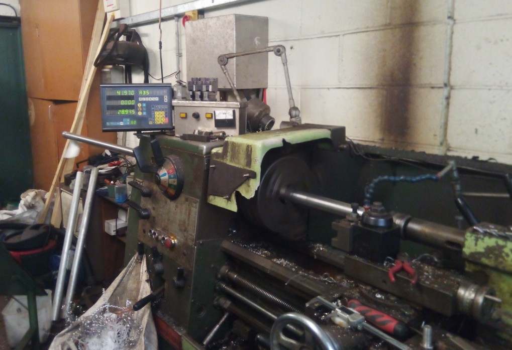

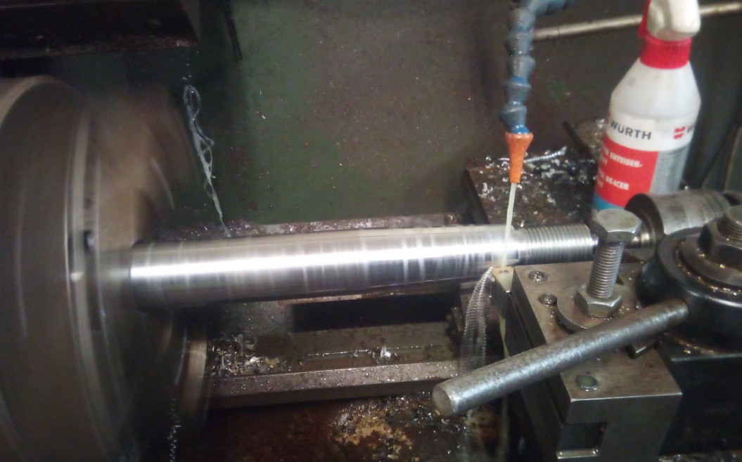

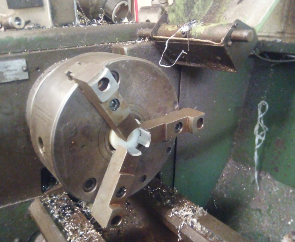

Headed down to the workshop at 3:30 today as I needed to get a shaft made for Monday and also get some bits cut/made for the Cheetah Cat, also for Monday.
First off I made a quick bush to support the shaft.
Then bored out some soft jaws to 1.3/4"

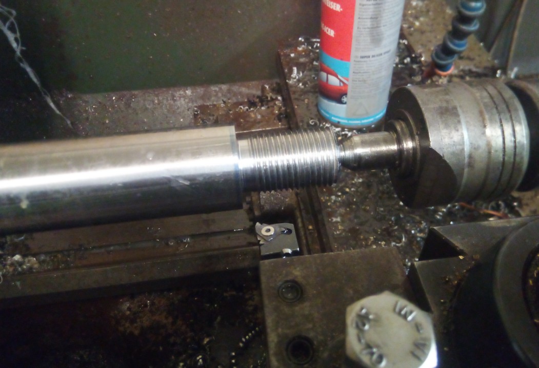

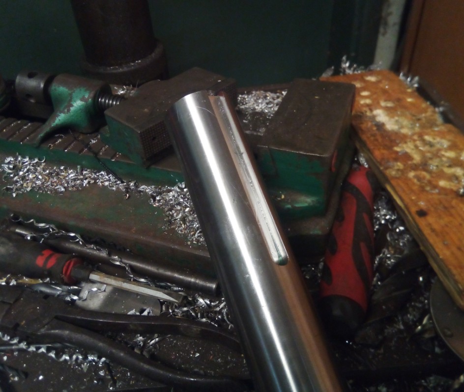

Put the shaft in and drilled a centre. As you can see there is quite a bit sticking out the back of the headstock so RPM's had to be fairly low.
Cut the thread. 1.25" BSF
Then the taper.

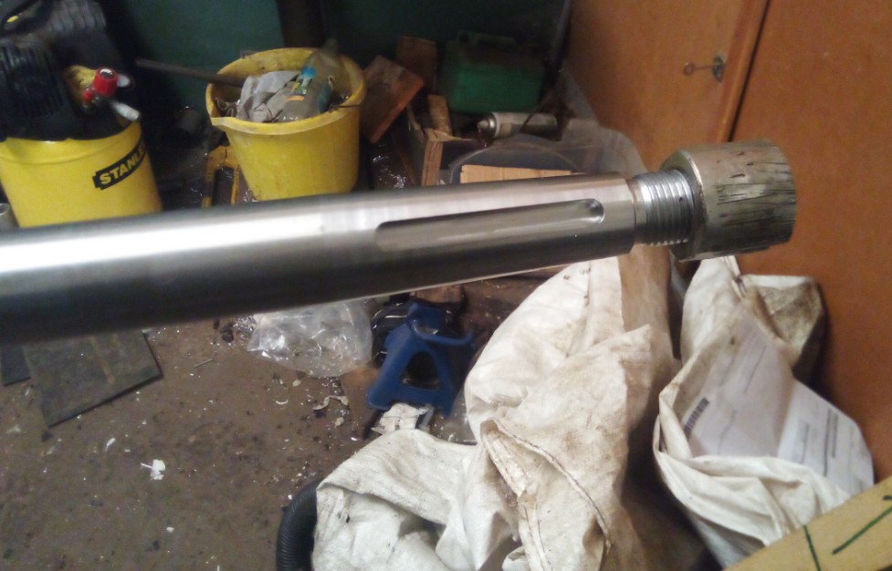

Shoved it into the Chiron and cut the keyway in the taper end.
Birled it around and cut one in the straight end.

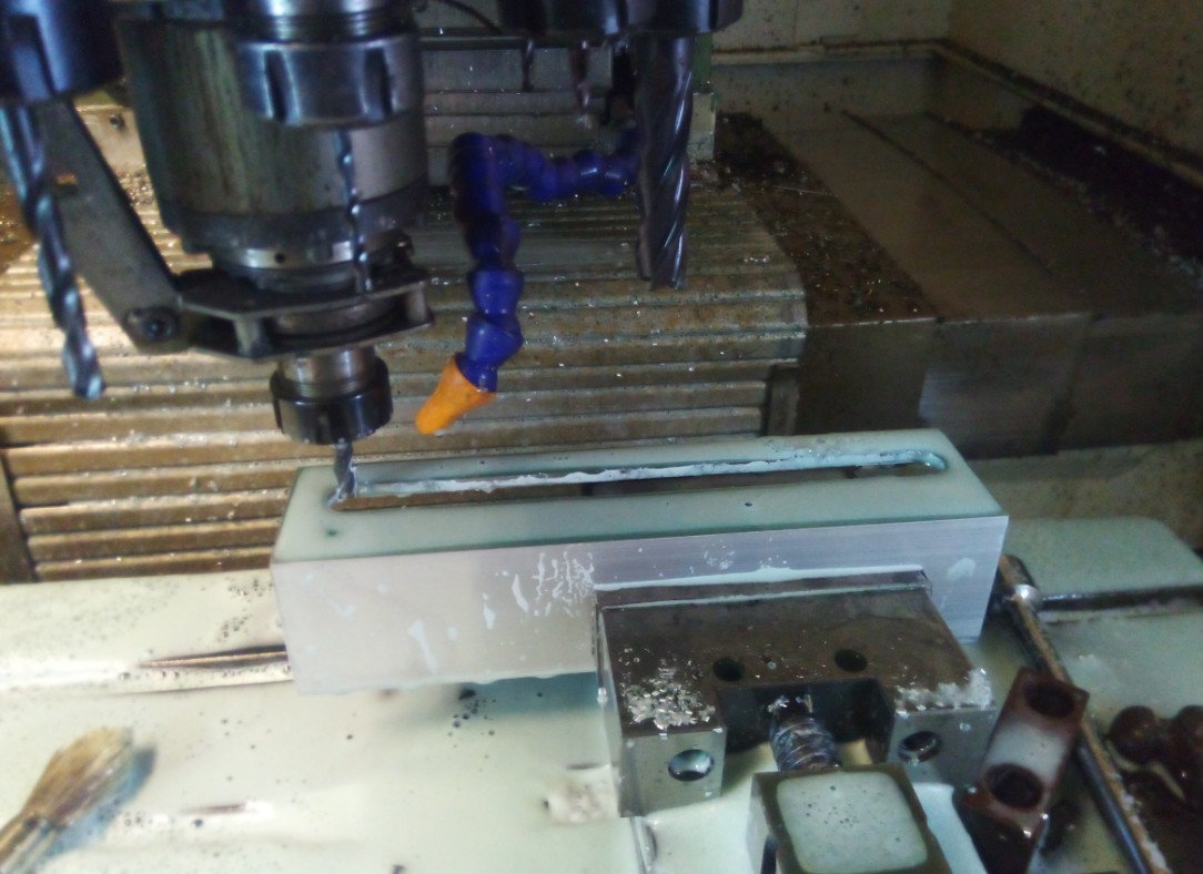

Then moved on to making a guide for the Cats steering to stop it rotating. 3" X 3" X 1/4" Alu with a 21mm wide slot.
Also made a guide pin, 20mm dia with flats for a 17mm spanner and tapped 3/8 UNF in the end, also cut some 6mm plate up to make a battery box for the Cat.
