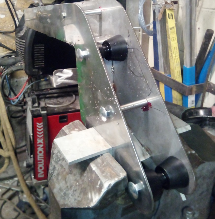

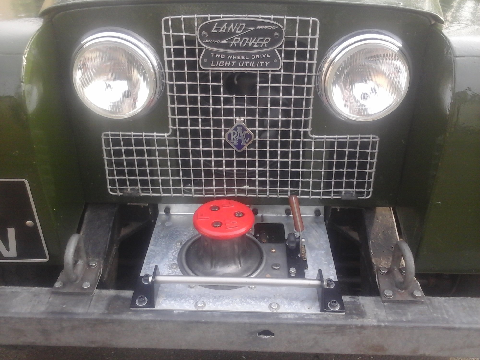

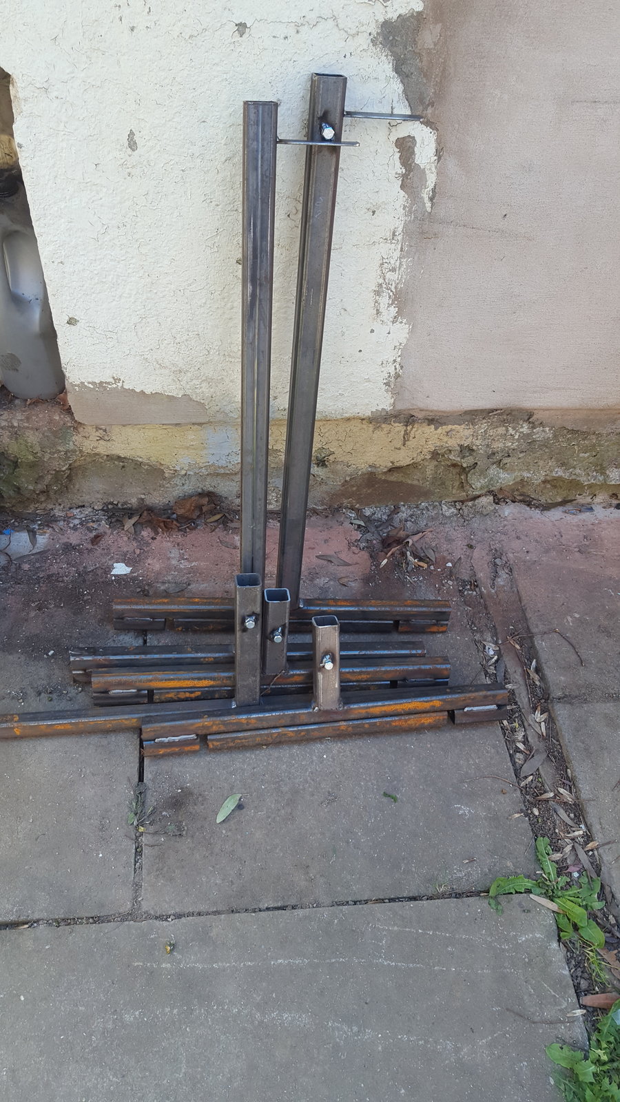

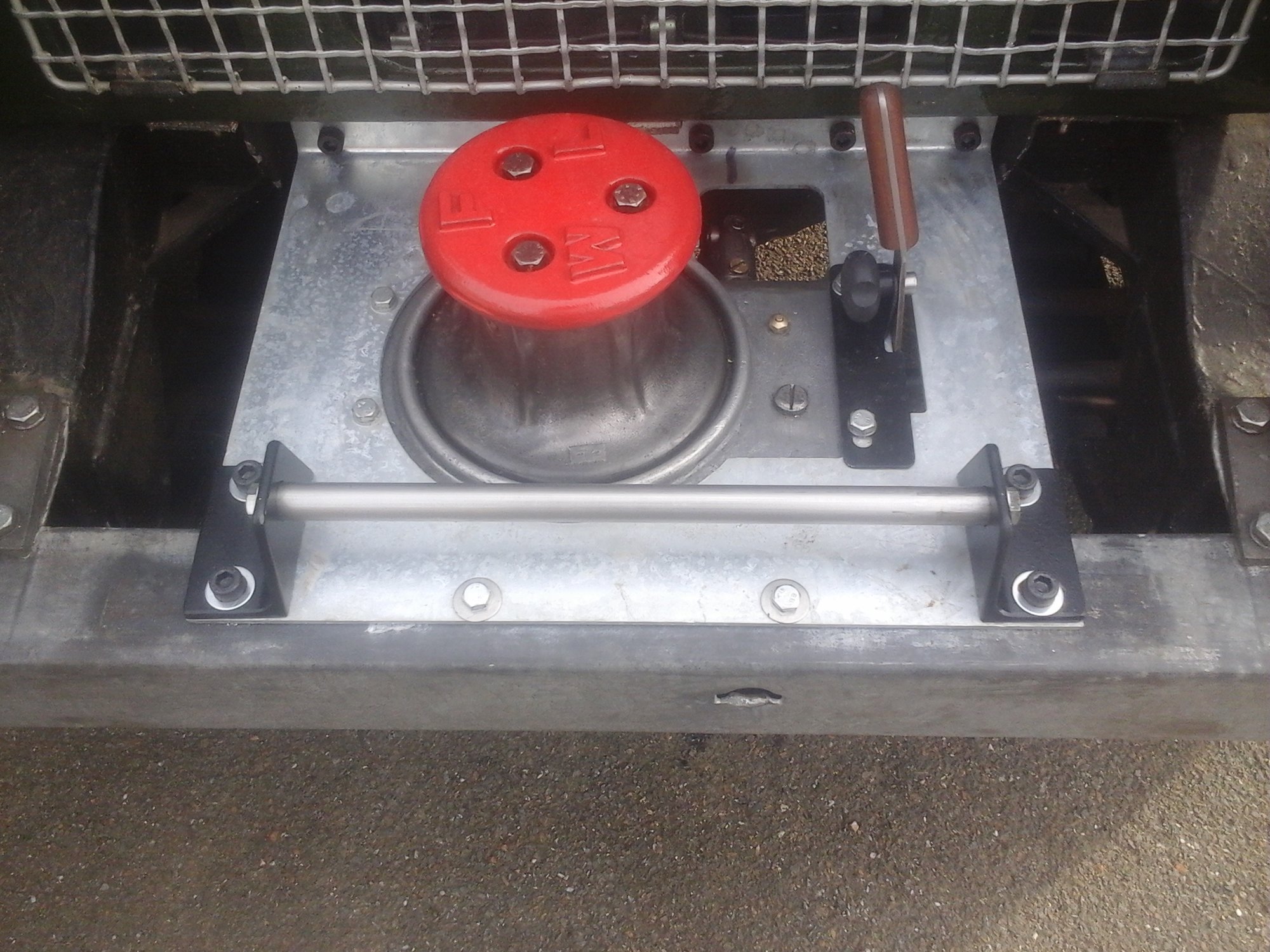

Ive got of of those capstan winches i'm just missing the big green bit with the lights inView attachment 175786 View attachment 175786 Made the fairlead brackets and fitted a bit of 3/4 rod as a roller as the thicker bit I had turned out to be hardened, tried anealling it but only managed to soften surface. Happily a bit of 3/4 pipe should run nicely on it, any one near Liskeard got a bit going , need about 400 mm of it.

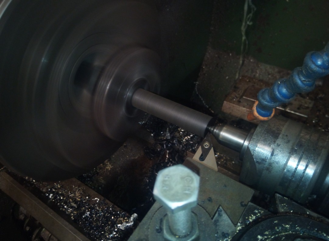

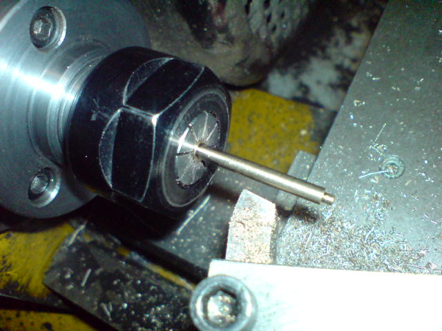

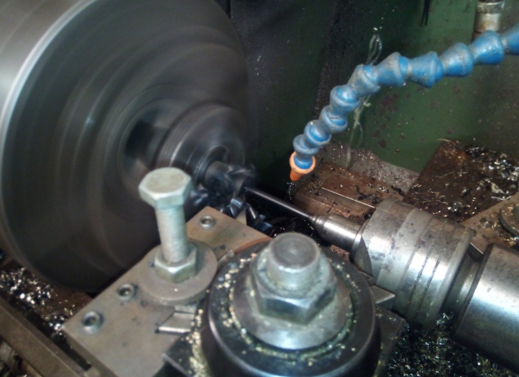

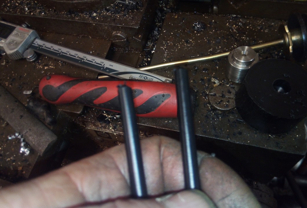

Don't know who he is but yes it is a common way to do it. Normally you wouldn't use the centre but as the Acetal is very flexible I decided it was best. In steel I wouldn't use the centre.Joe Pie demonstrated the same technique turning small diameters in metal, in one hit. Without the centre.

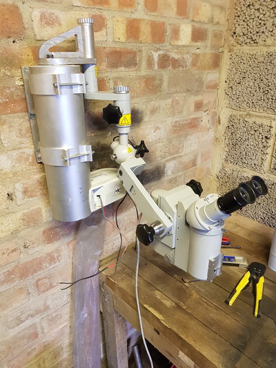

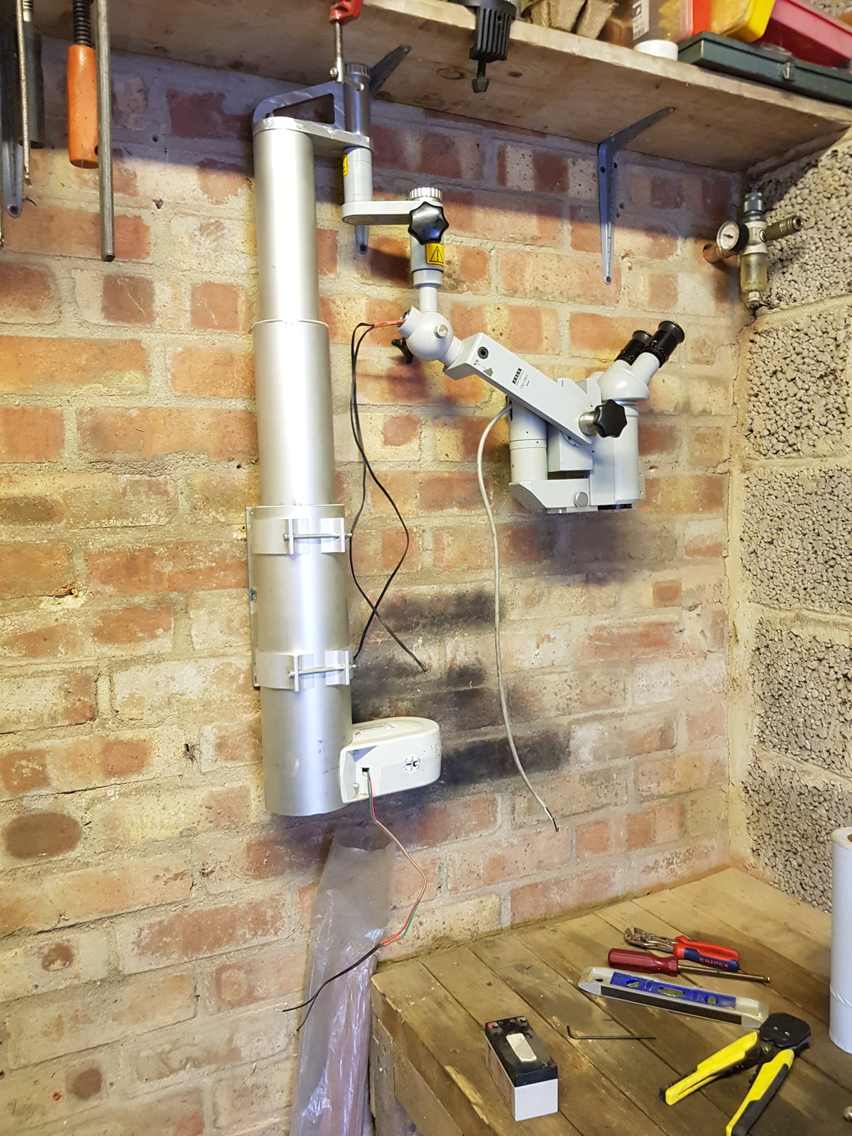

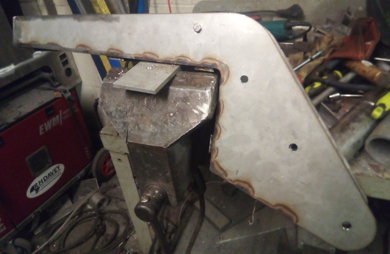

Made up a mounting bracket to hang my surgical microscope on the wall, wanted to do this for years but only now had all the pieces and the time.
The column on the wall telescopes up to keep it up out of harms way. I still need to make up a combined shelf/cover for it to keep it more protected.
Also need a power supply/controller for the actuator, zoom and height motors and the lamp in the microscope. I've also started (About a year ago!) to make another articulating arm section to give it a bit more reach.
