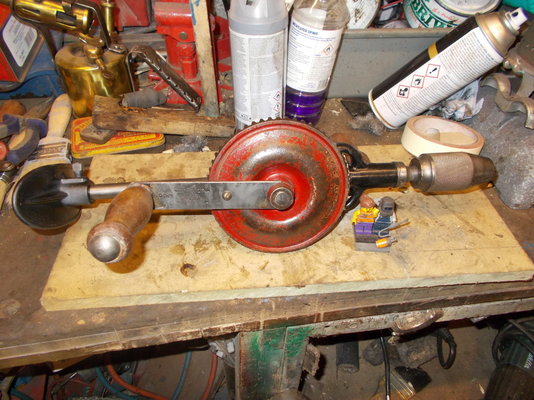

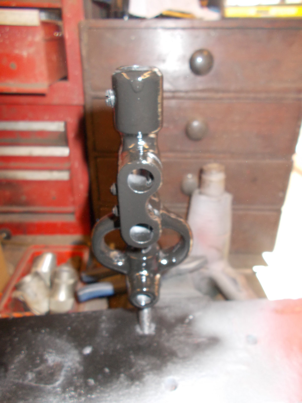

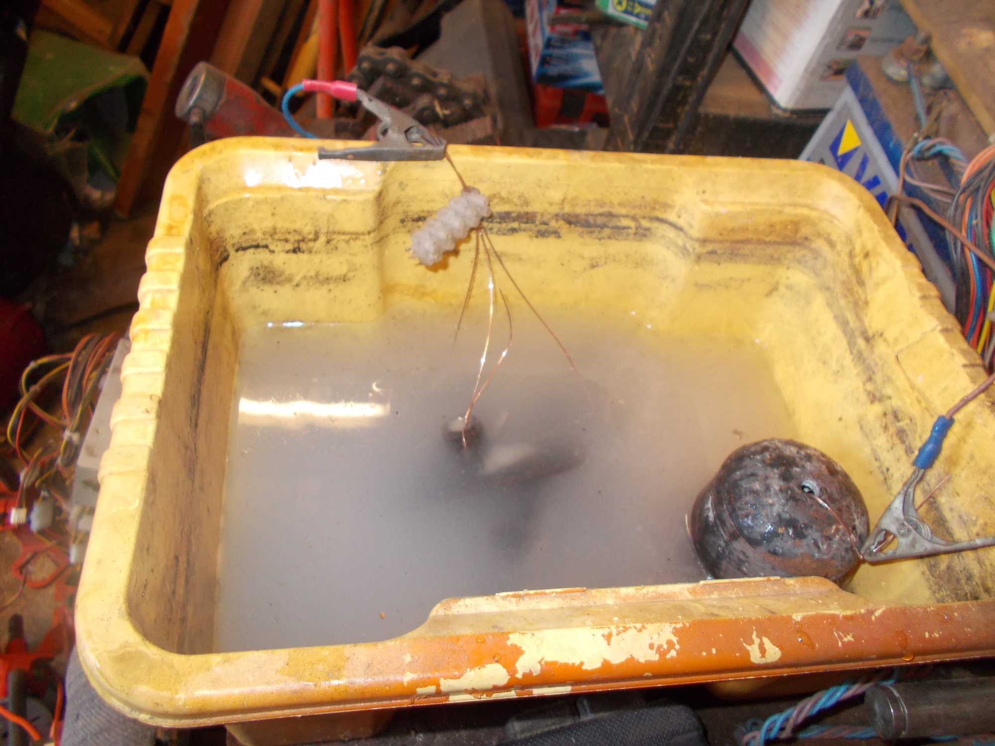

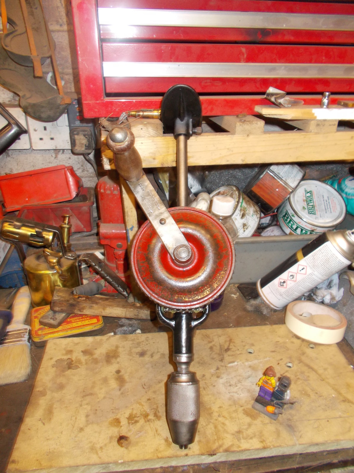

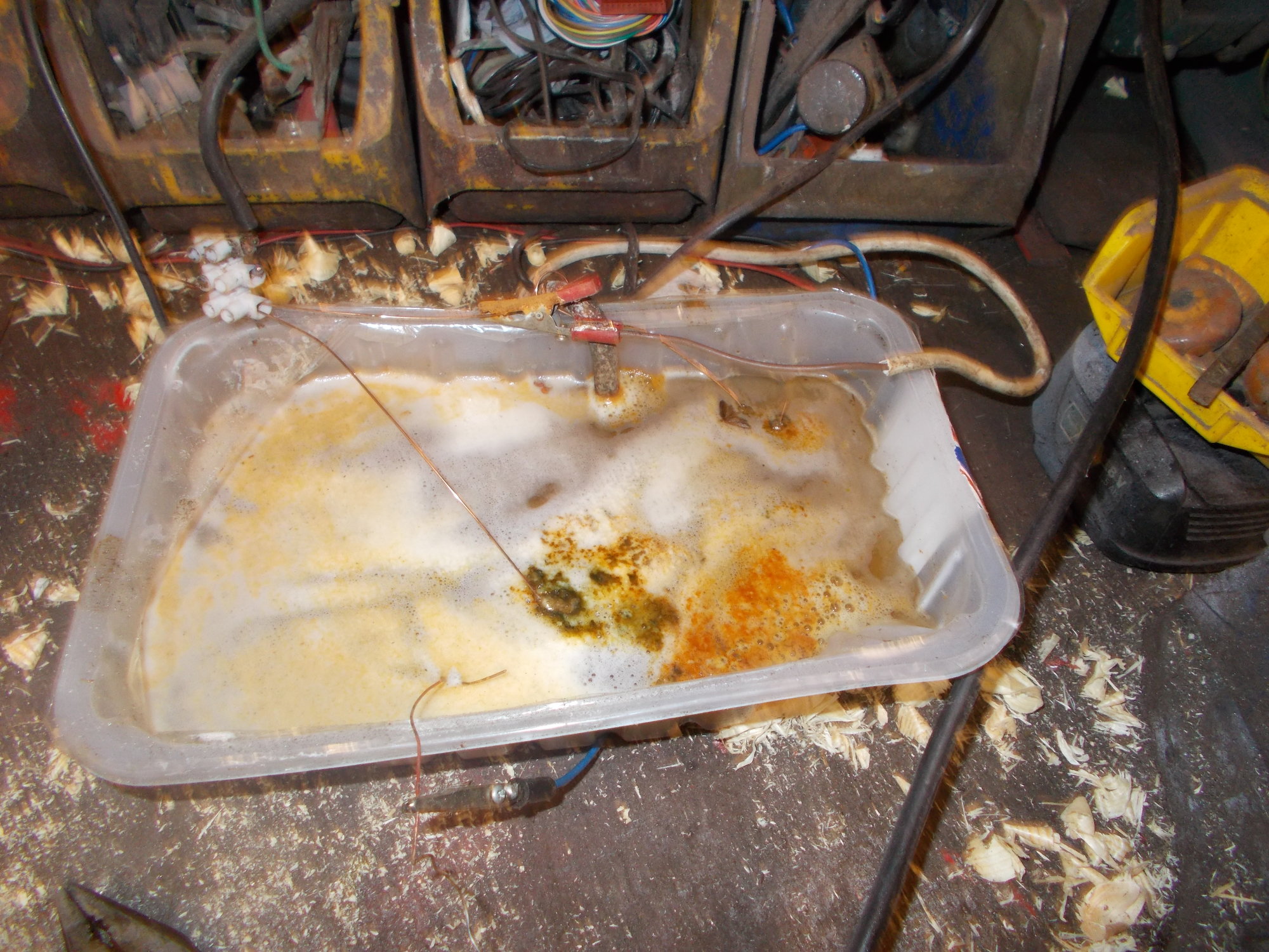

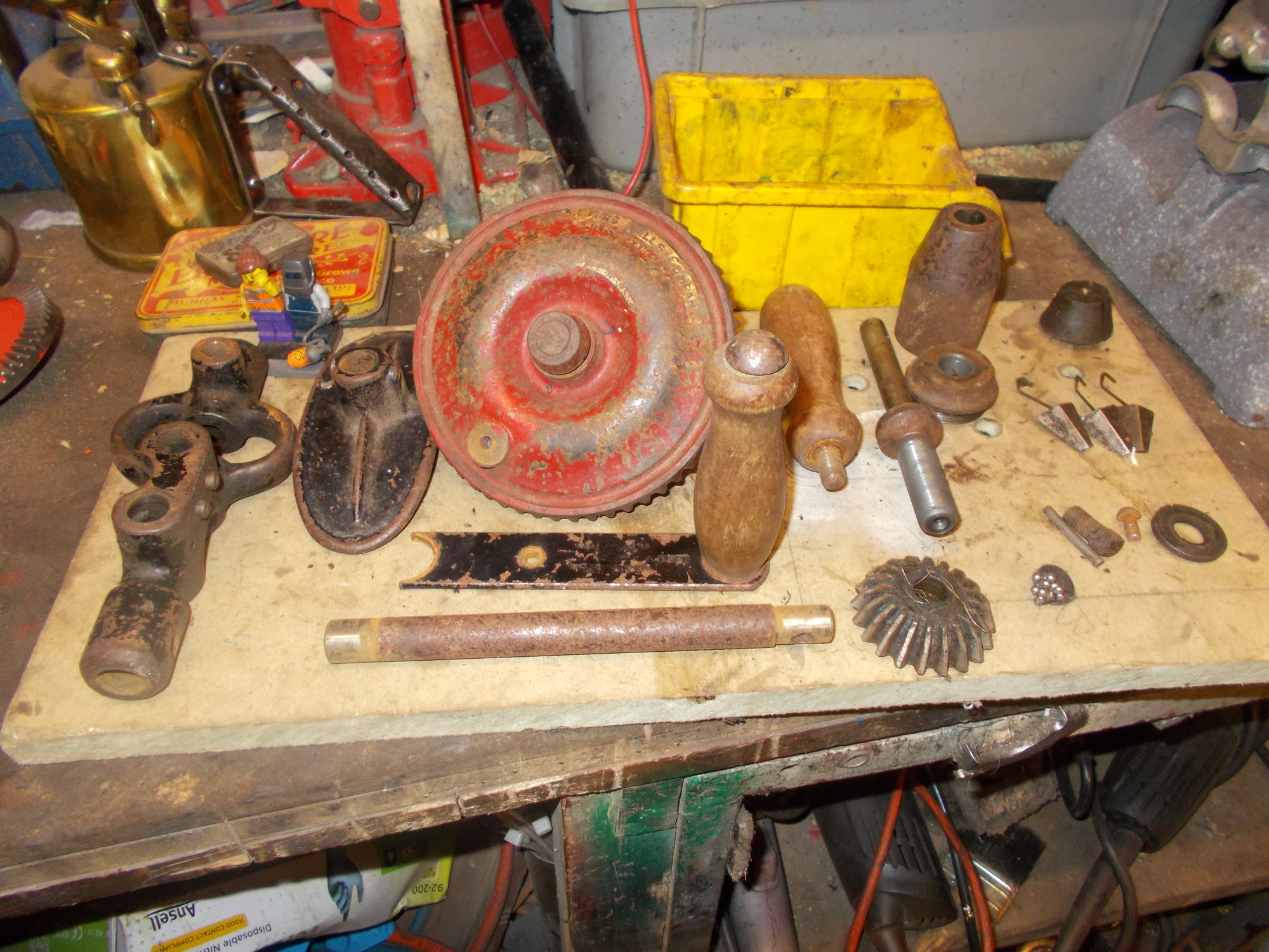

Last night I dismantled the breast drill and let it sit in a de-rusting tank. I also set up another tank to de-rsut some odd bits and balance the 2 x 3amp out puts from my PSU.
The hardest bit was removing the quill from the gear, something I should of looked at. But I didn't and it bit me back later.
De-rust tanks. As Normal I make them up as I need them.
Black enamel, I have not made my mind up if it is any good. I may have to wait until it has fully cured and is in use to see if it is any good.
The painted parts came out with all the paint, grease and rust removed and a few minutes with course wire wool had them to a point the paint could be applied. In todays heat, that did not take long.

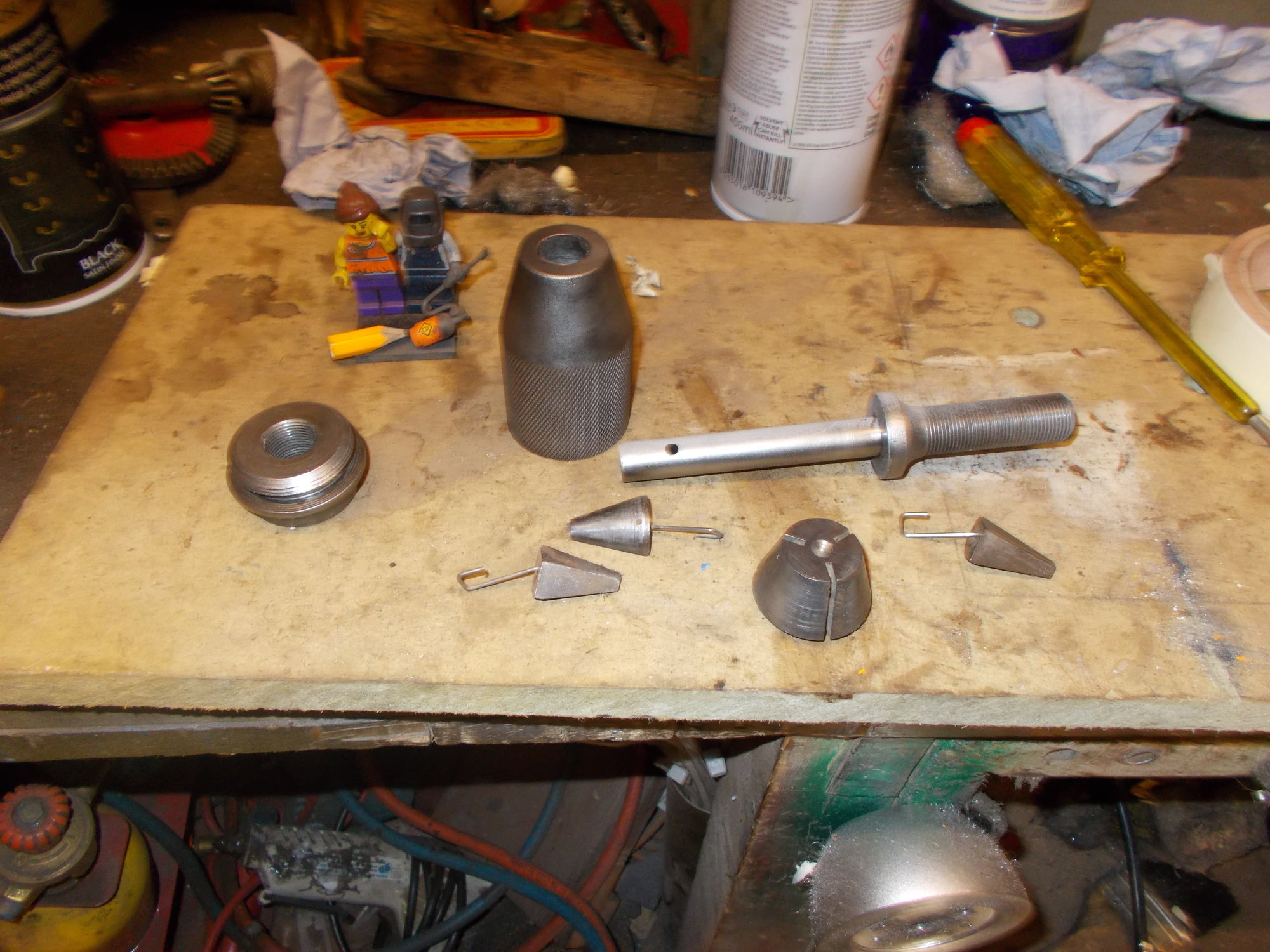

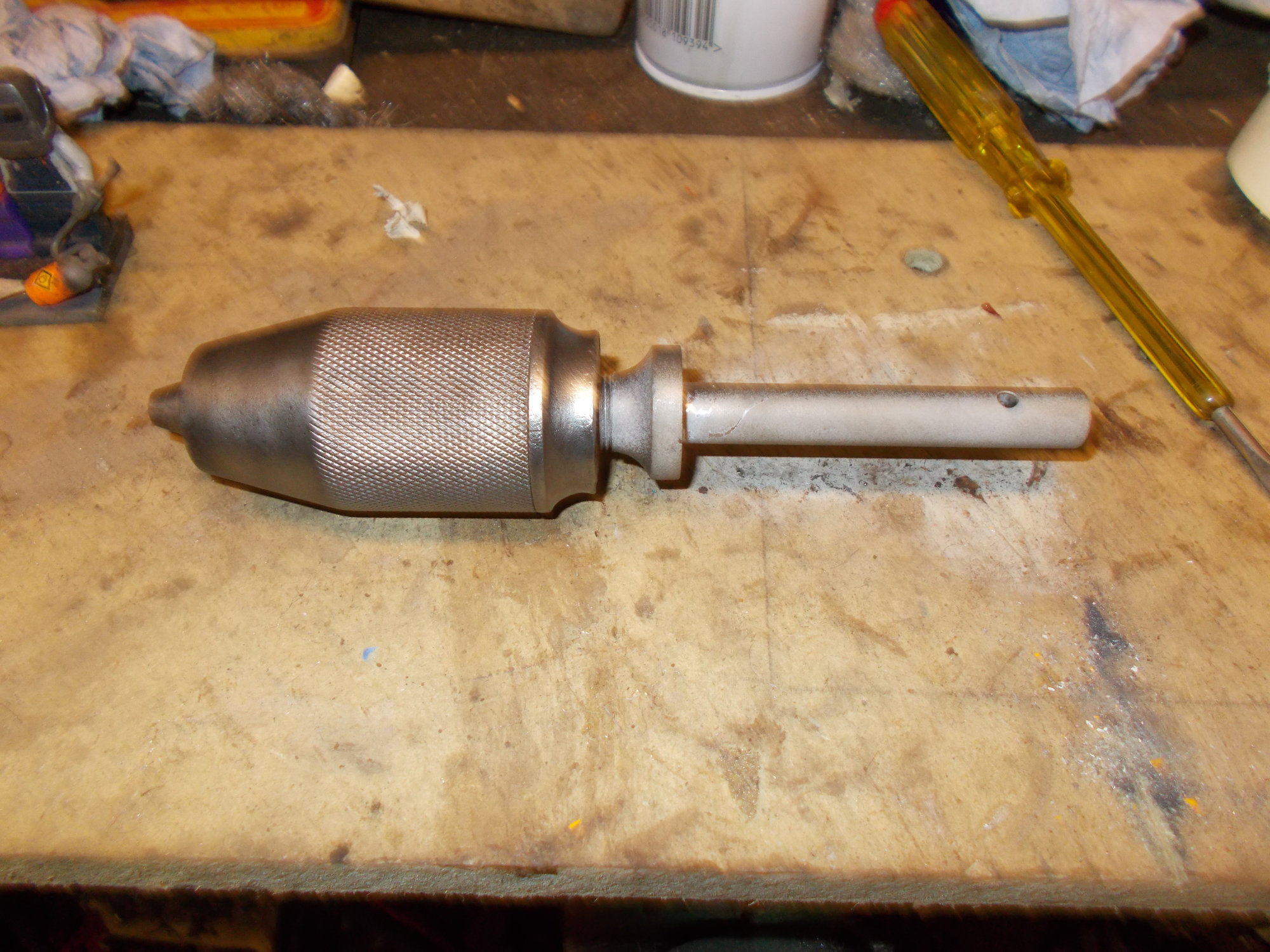

The chuck re-built. This one had some good springs in the chuck. So now I will be able to find some suitable steel and make some of my own, for the other chucks I have which are in need.
Reassembled.
Wooden handles cleaned with "meth's" and then given a good wax. In the heat the wax as being pulled in fast. I ended up with a Satin finish on the wood. It ties in nicely with the main gear wheel.
I did not repaint the main gear wheel. It was in good condition, the age was something I wanted to keep, along with the remains of the manufactures details.

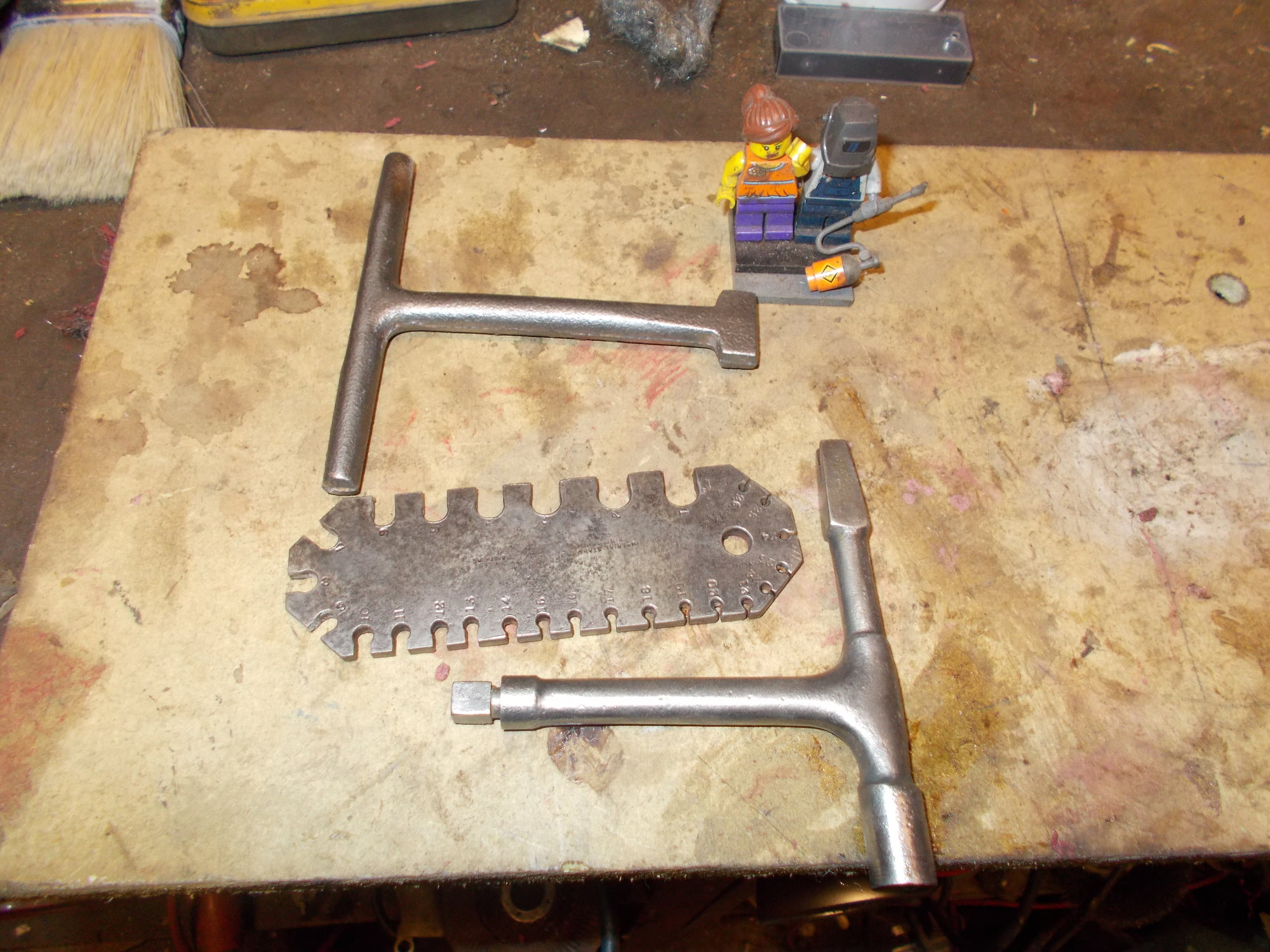

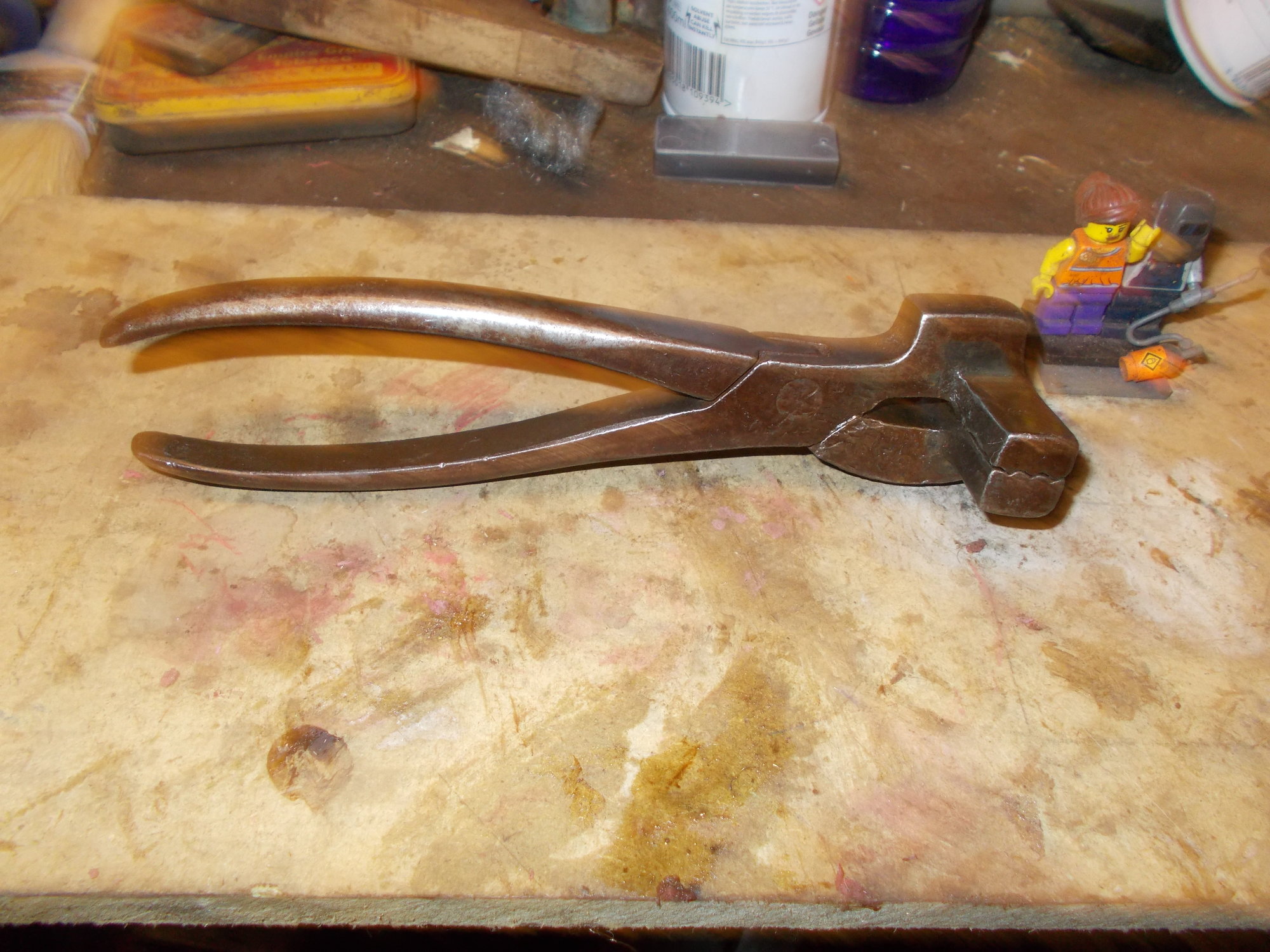

The items in the other tank.

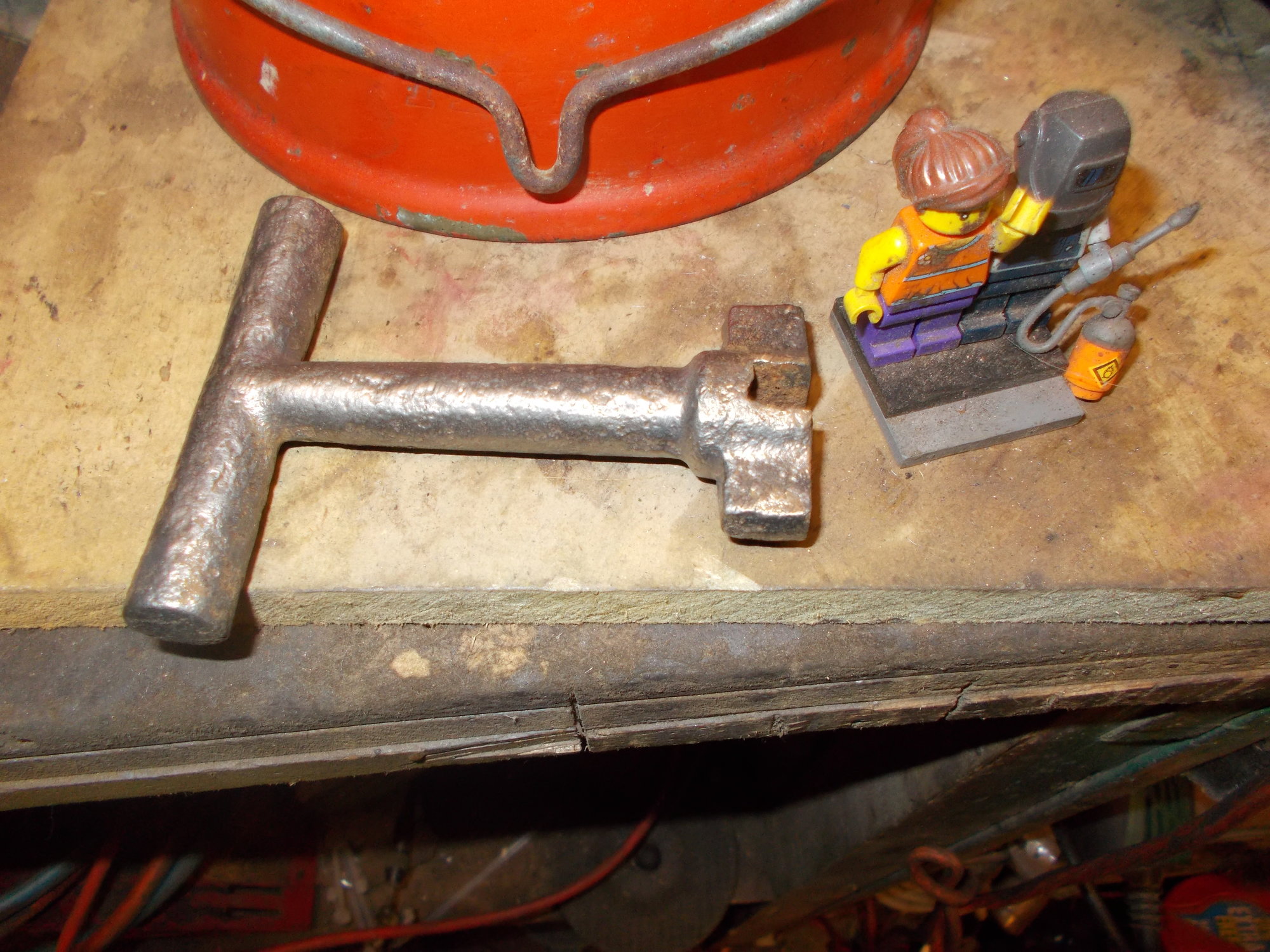

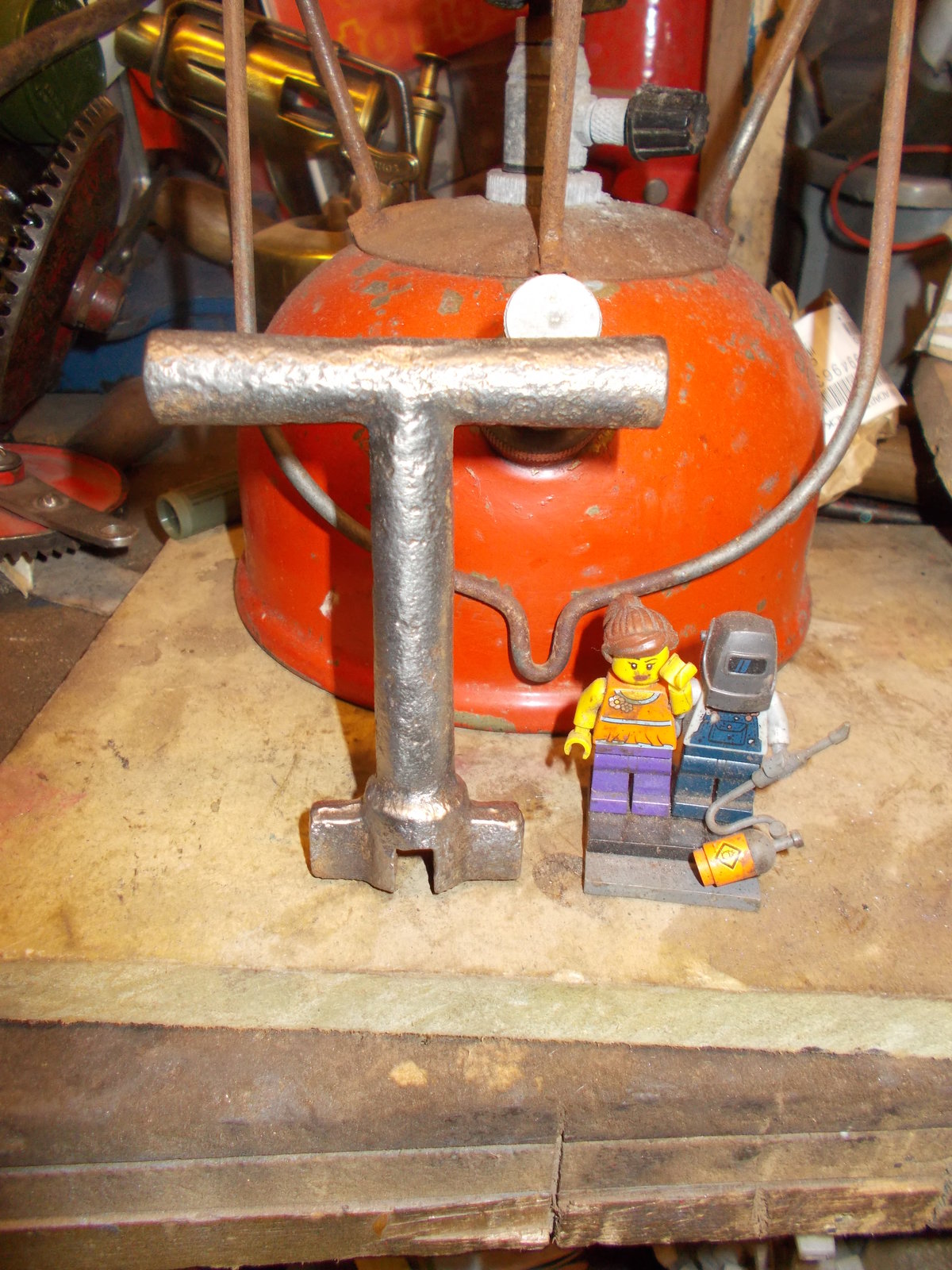

Man hole cover tool.
Wire gauge tool.
GWR carriage key.
