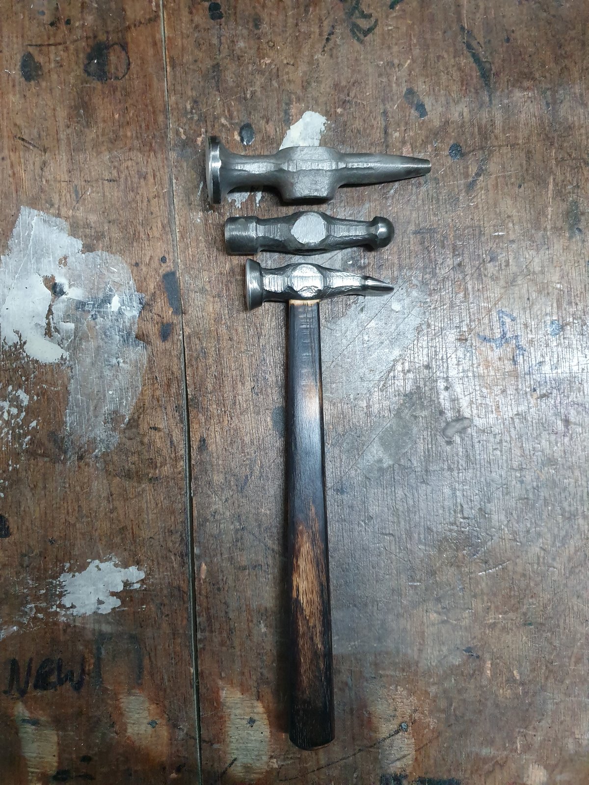

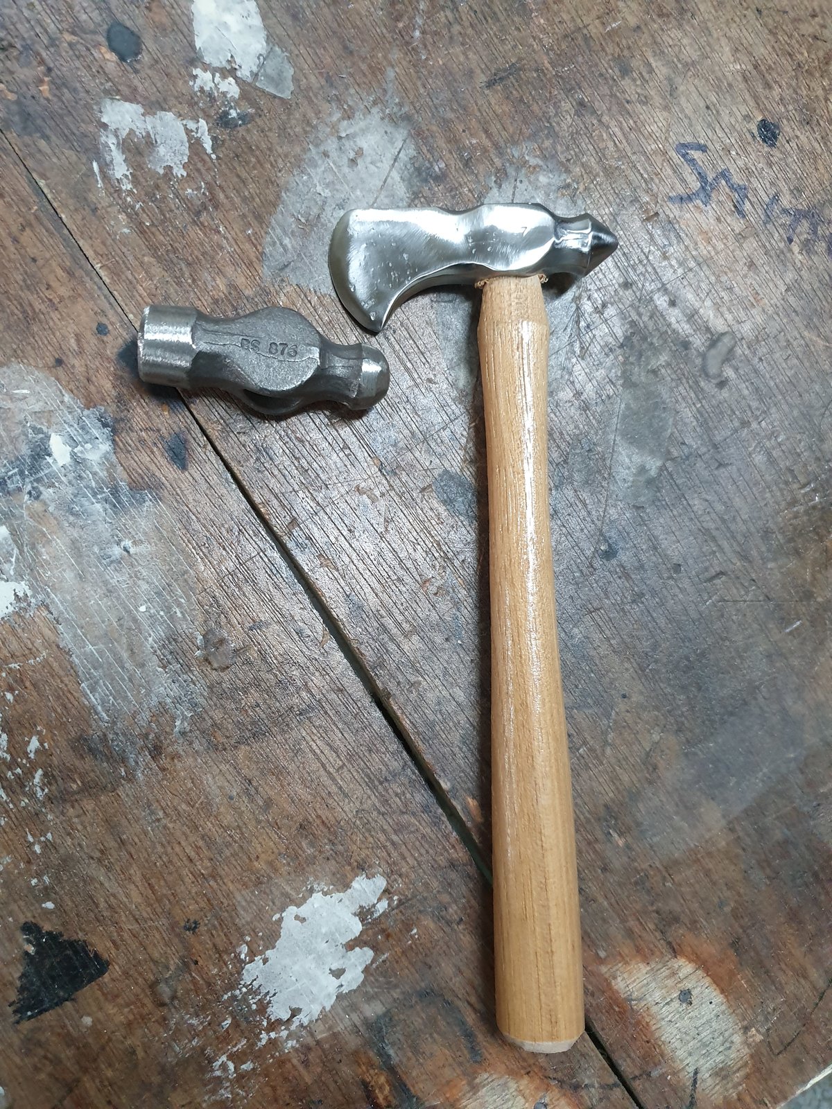

Drawing with them isn't too bad, its the rubbing out the mistakes that takes the time.I'll need a bit of practice to match that!

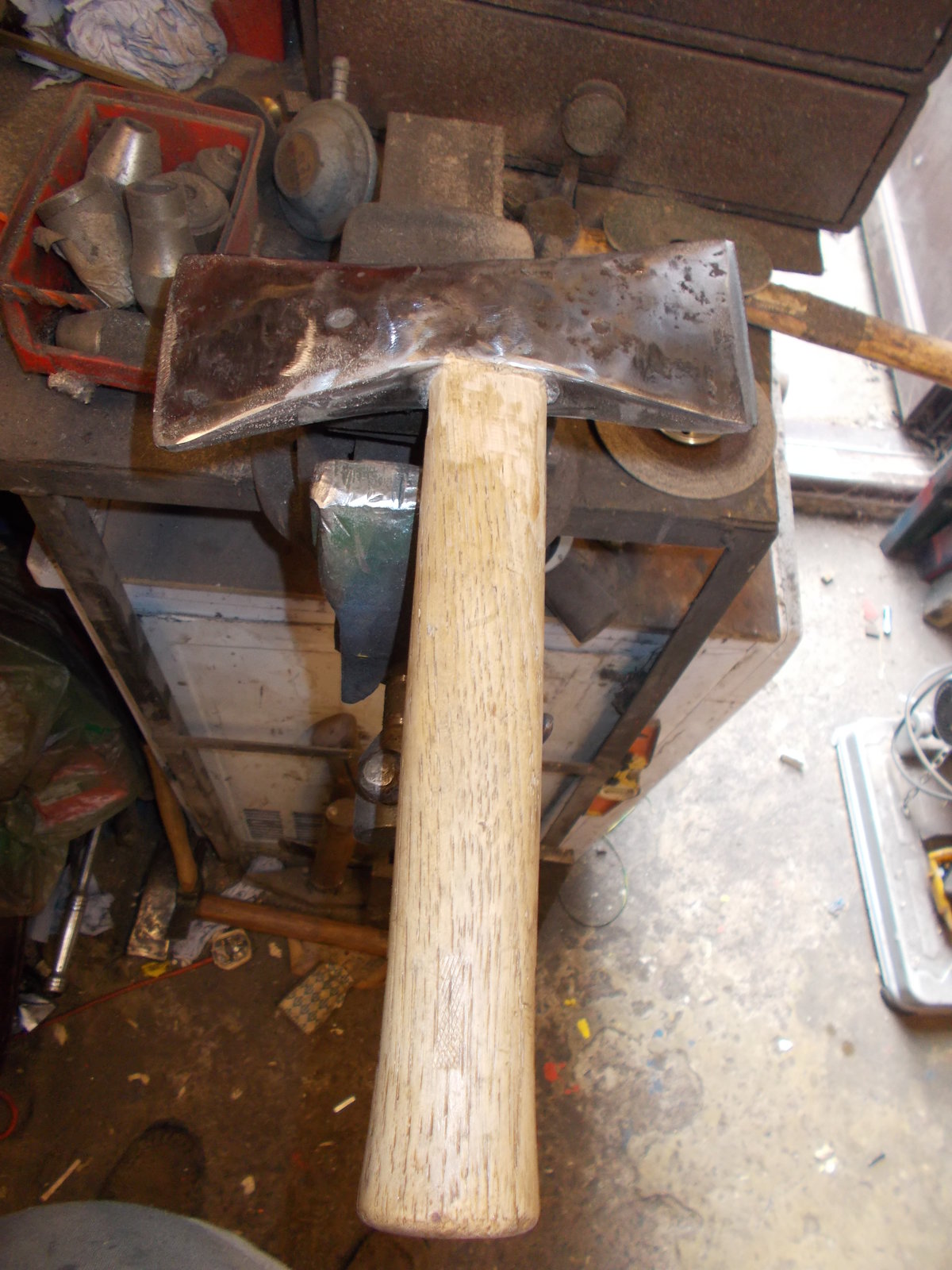

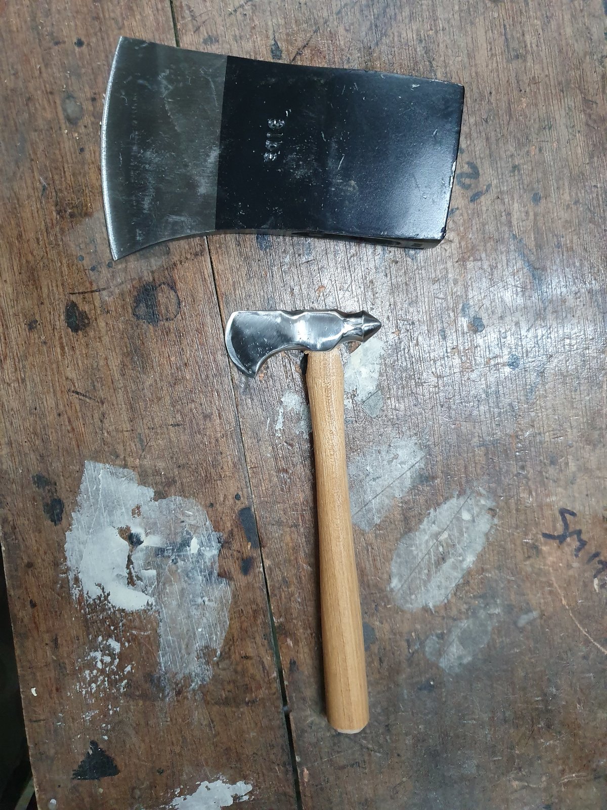

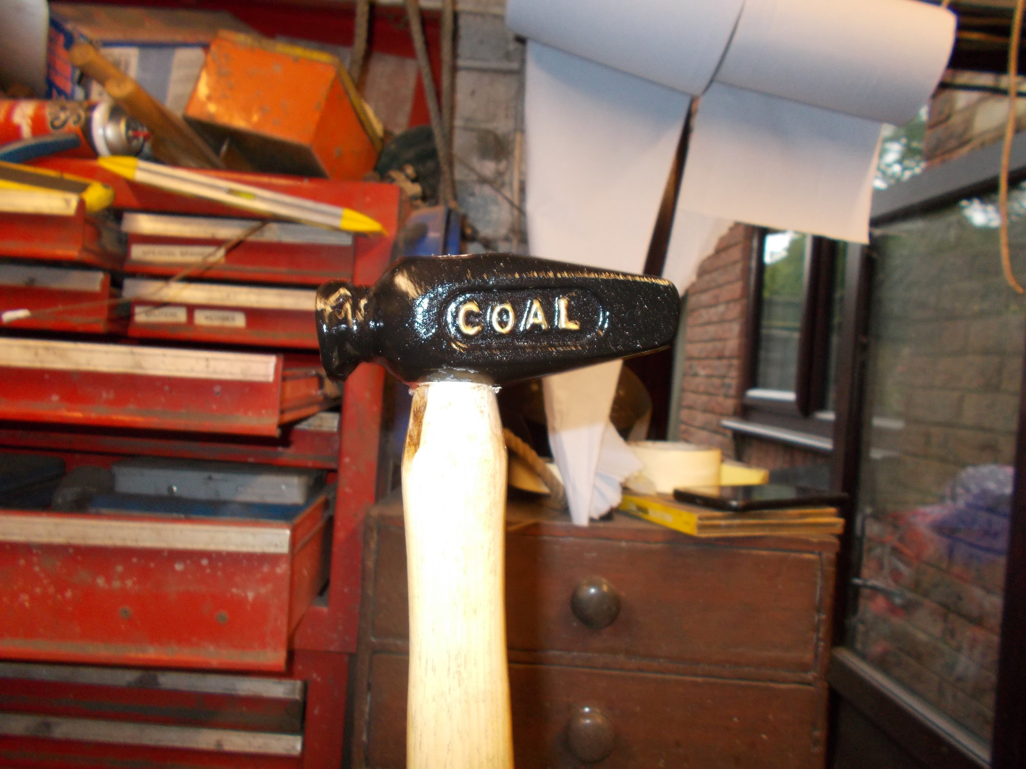

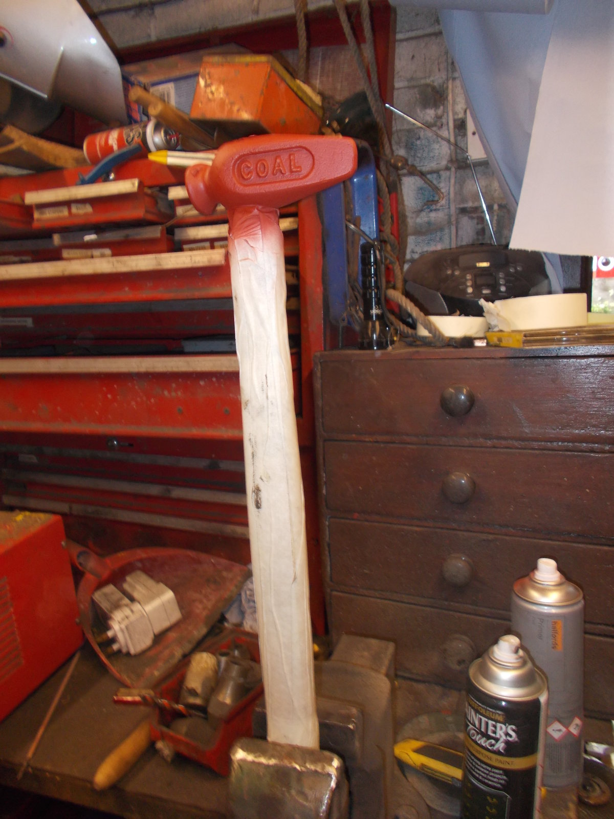

I like that coal hammer what’s it for

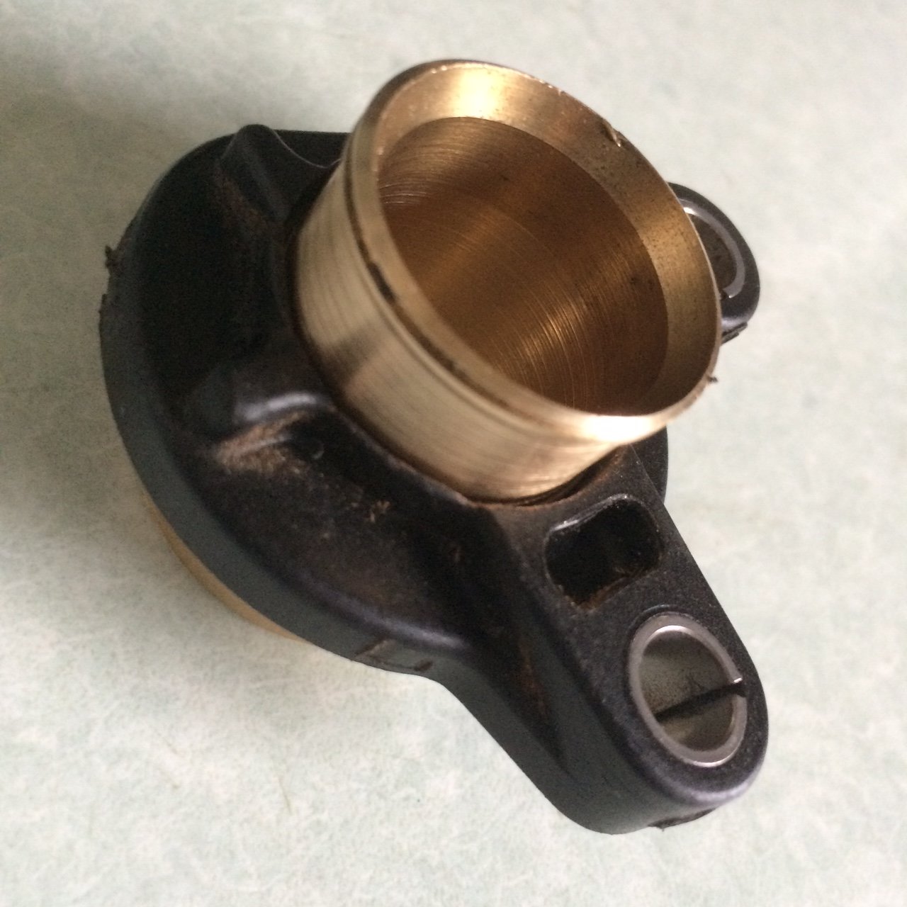

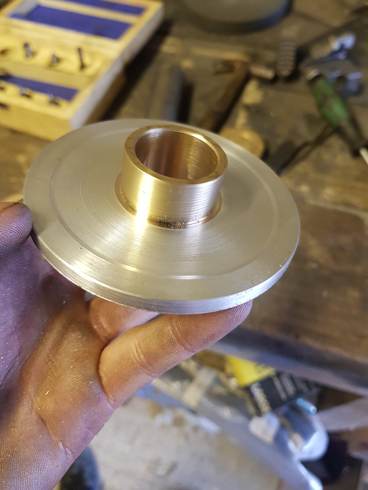

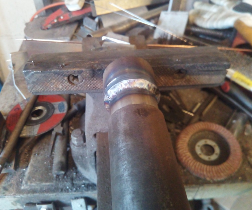

Handy having a lathe in the garage ain't it.@slim_boy_fat The BM discraced itself this morning and I need it on Monday, the earliest I can get a replacement hose and flange from BMW is Tuesday. Looking for alternatives I found these https://www.ebay.co.uk/itm/OEM-Wate...604231?hash=item3fc35d3147:g:Wi4AAOSwXuNcwvam which use the original hose replacing the chocolate plastic spigots.
Too late to buy aluminium I had to improvise with one of these...

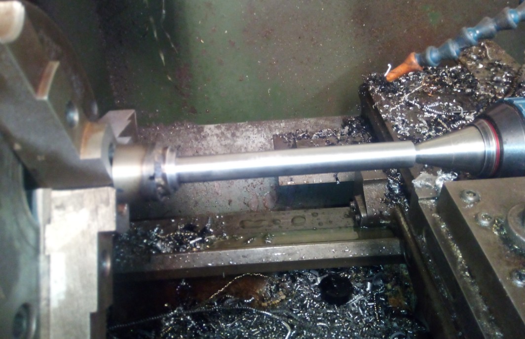

From which I made this.
Salvaging the old flange for re use. The hardest part was locating the plastic flange in the four jaw to take off the old broken plastic spigots and bore for the new brass spigot.
I will fit and pressure test in the morning before re filling with coolant and doing the electric pump bleeding routine.
It only has to last for a week as a replacement hose and flange should be waiting for me when I return on the 16th.
Edit: The hose attachment end should have been longer but I will see if it works tomorrow.

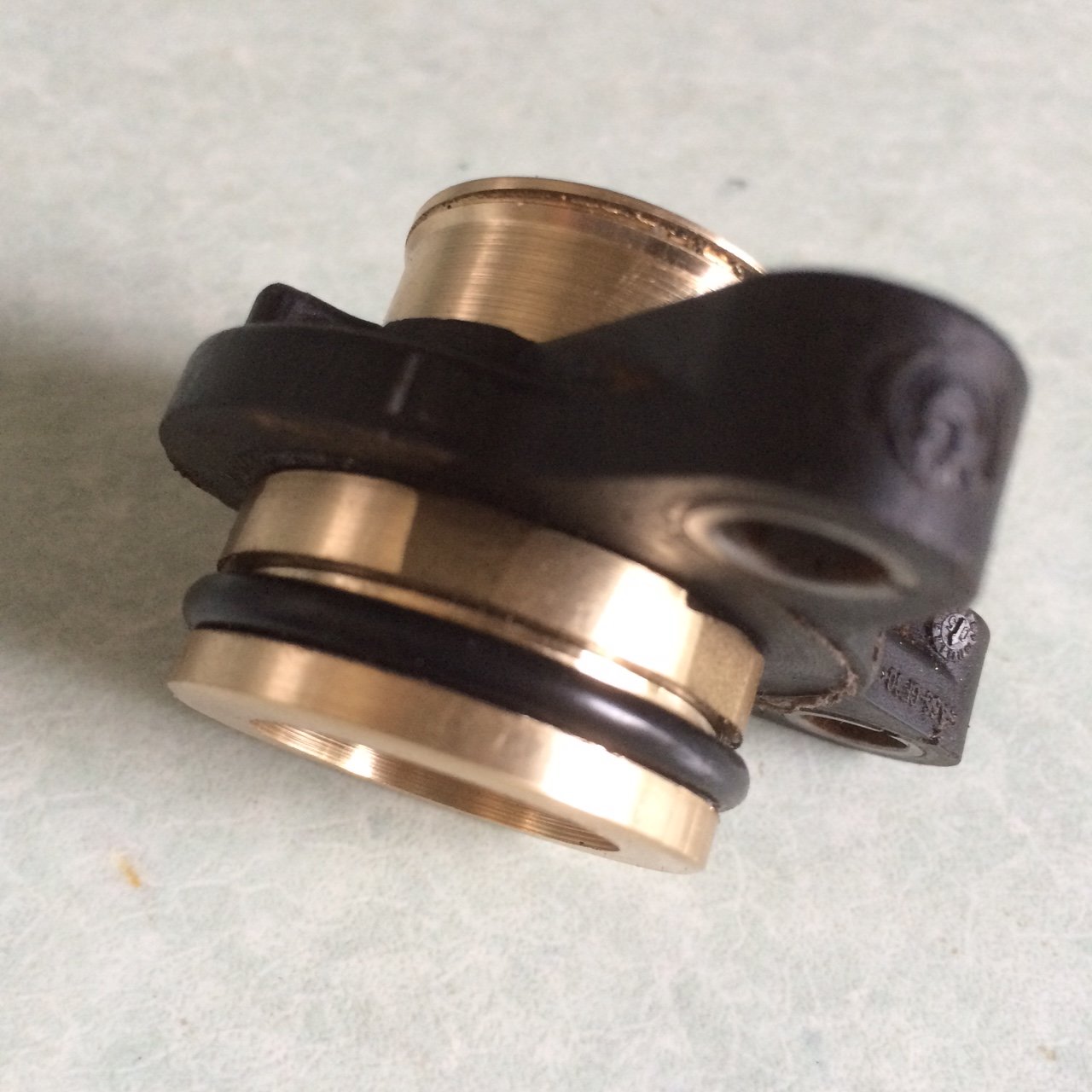

A quick update;@slim_boy_fat The BM discraced itself this morning and I need it on Monday, the earliest I can get a replacement hose and flange from BMW is Tuesday. Looking for alternatives I found these https://www.ebay.co.uk/itm/OEM-Wate...604231?hash=item3fc35d3147:g:Wi4AAOSwXuNcwvam which use the original hose replacing the chocolate plastic spigots.
