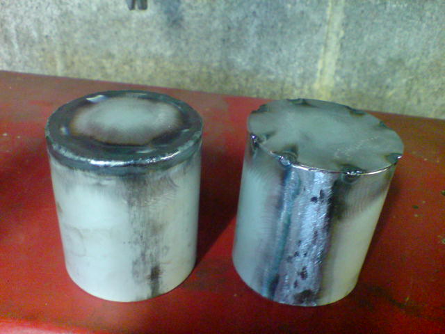

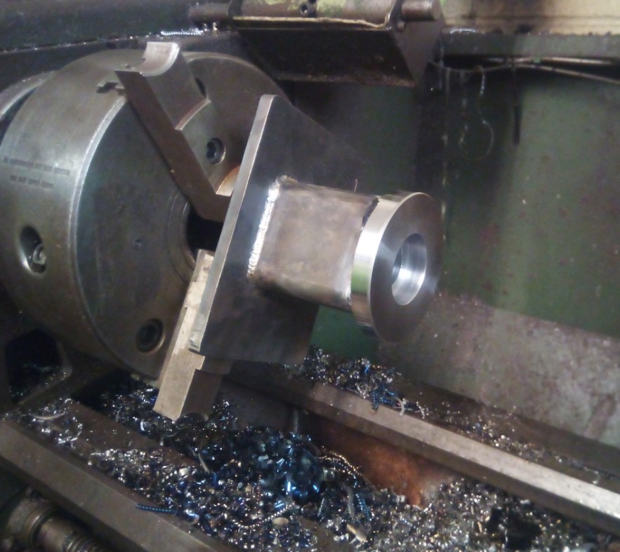

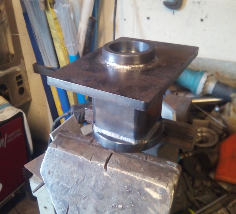

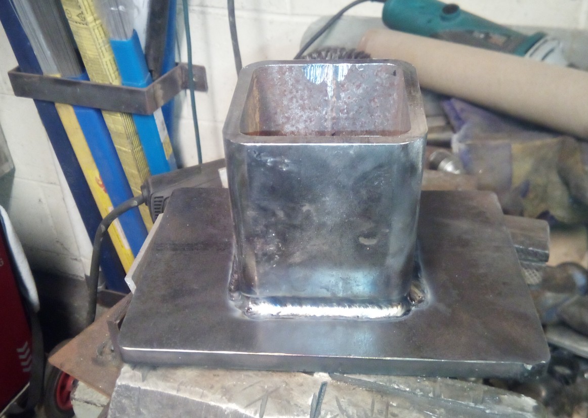

I needed to make some new candles that would be hidden in plain sight, using a mug as a candle holder, so I needed a container to go inside the mug to hold the wax for the candle..... so after looking about for suitable containers I decided to make my own from 0.9mm zintec.
this was rolled around a peice of bar and then tig welded along the seam. the end plates were then tacked in place before seam welding with tig
they were then painted with high temperature paint.

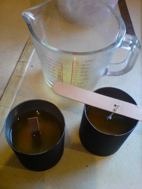

and as for candles, they're not too hard to make, and I started doing it by accident, by recycling used scented candles from the industrial museum that I volunteer at, but they didnt really have the correct smell for the mackintosh section which I end up working in (yes thats me below)

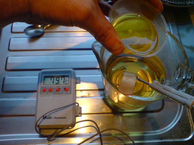

to melt the wax I use a jug in a pan of water and use soya wax flakes

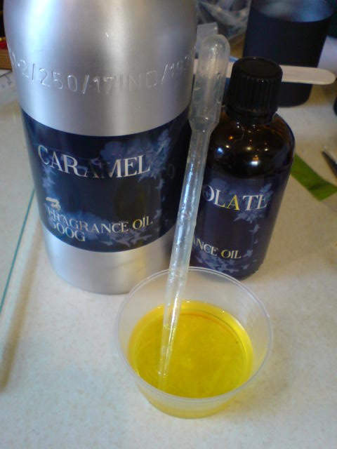

and mix the scents to get the smell I want using a 10% scented oil in the candles
the when the wax temperature drops to 80C I then slowly add the scent while mixing it
when the temerature drops to 60C I'll then pour the wax into the container

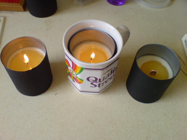

and testing with 3 different wicks
think I'll go for the one on the left as the was pool is the best for the size of the container, so I'll melt the other two down and recycle them and use the same wick as the one on the left.
