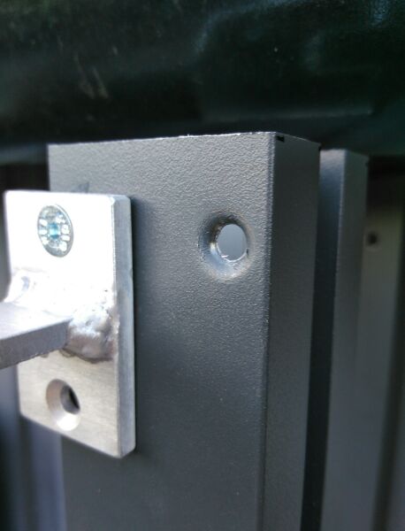

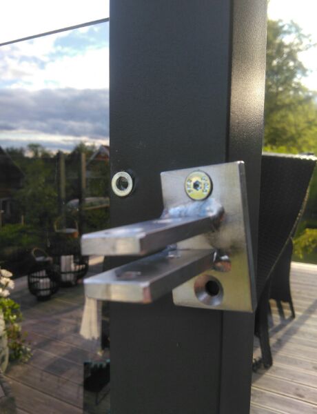

Hasn't been one there before, but I may well put a handrail by the steps.Is there going to be a railing at those edges?

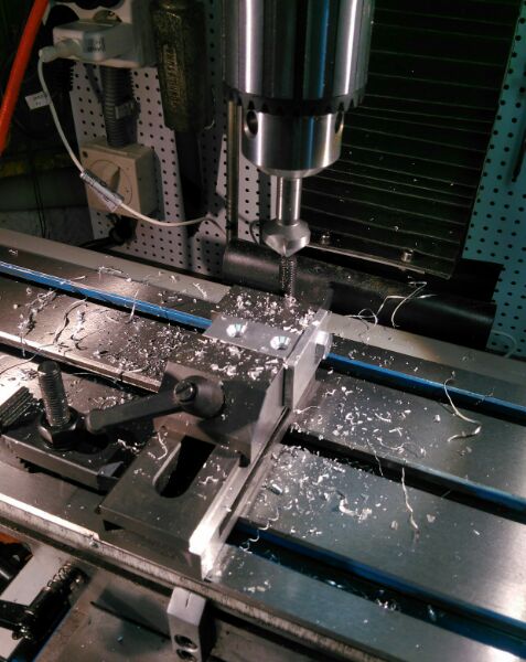

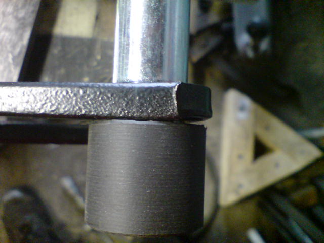

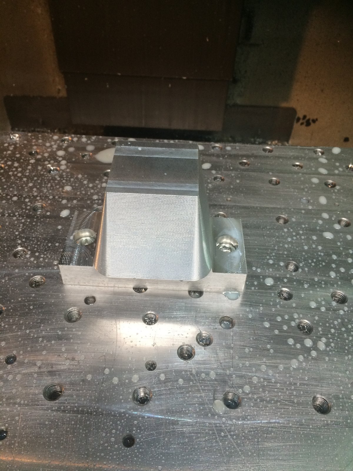

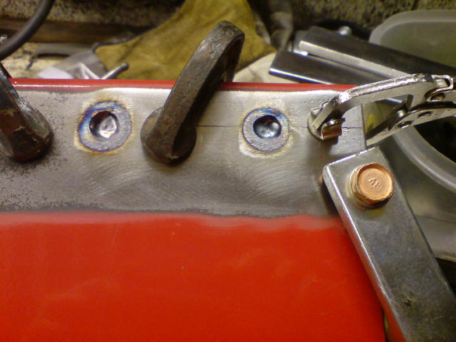

Funny, I did the same yesterday, but in aluminum also with home made tool.A quick home made tool today... .
Ordinarily I'd do them in a press, but it's an after thought, it's now on part of a 12metre long machine weighing about 5 tonnes.Funny, I did the same yesterday, but in aluminum also with home made tool.

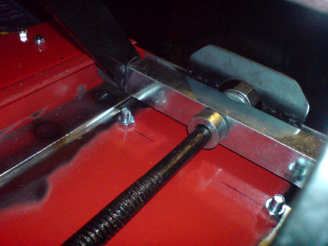

Needed to install counter sunk riv nuts but not enough material thickness to machine.
I have a chunk of steel with counter sunk holes of various sizes to do this. Either in a press or tapped holes.
