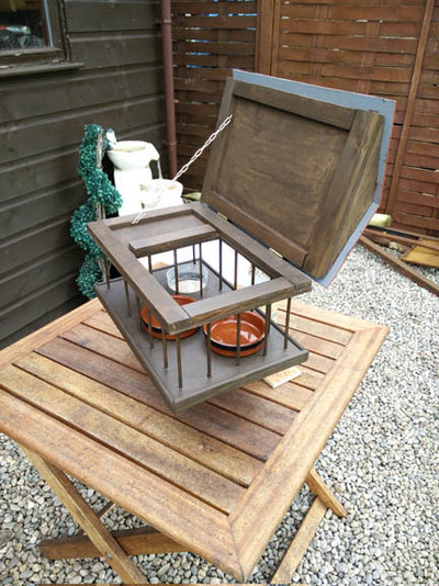

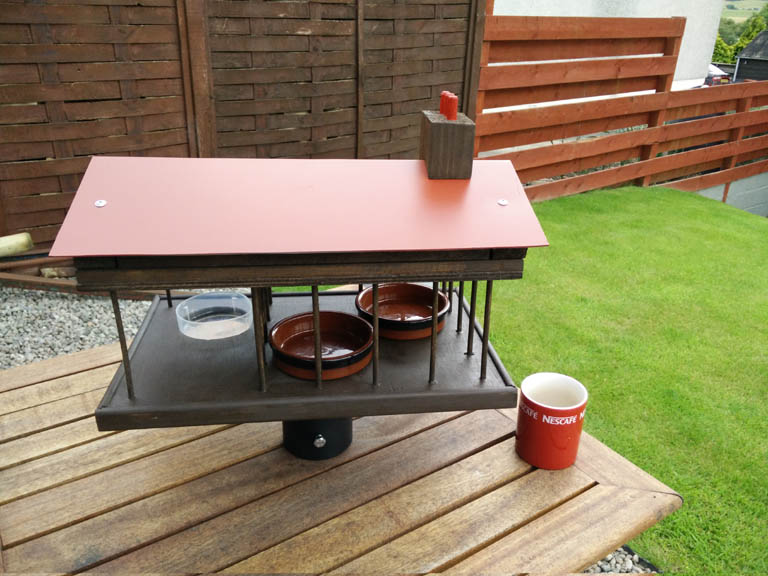

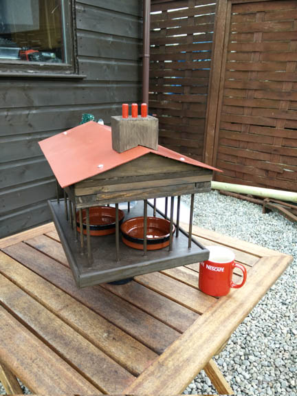

All designed to keep gulls, crows etc out
Yebbut, will it prevent furry thieves?
If furry thieves are squirrels, they absolutely can do that. My dad had a bird feeder handing on a tree, squirrels just climbed straight onto it so he put it on a long chain - they grabbed a lower branch with their back legs, sprung towards it and grabbed it with their arms, then pulled it back to the branch so they could comfortably eat. He's threaded a pipe over the chain now, it looked like it worked until one slid down like a fireman/stripper.Good point, but as it'll be on top of a post 4[ish] feet off the ground, they shouldn't be able to get to the food.
Unless, of course, they can do this - in which case they're welcome to stuff themselves......
We don't have any squirrels nearby, although there are red squirrels about 3 miles along the road.
Reds should be encouraged, if there were some on my land i would feed them.
Do they have a big red light showing the way?The person on whore land they are, does feed them. In fact a feeder for them is on my list of 'projects'. [it's coming to the top....]
