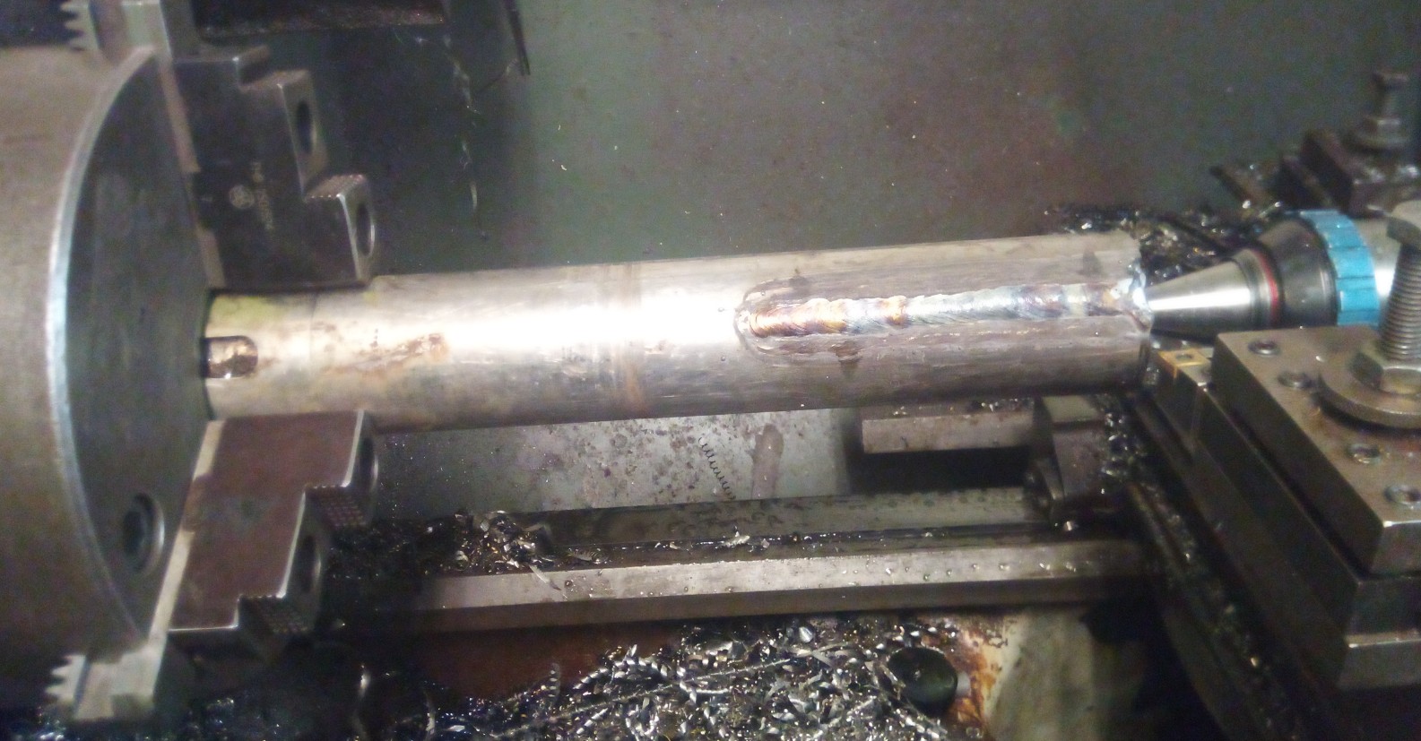

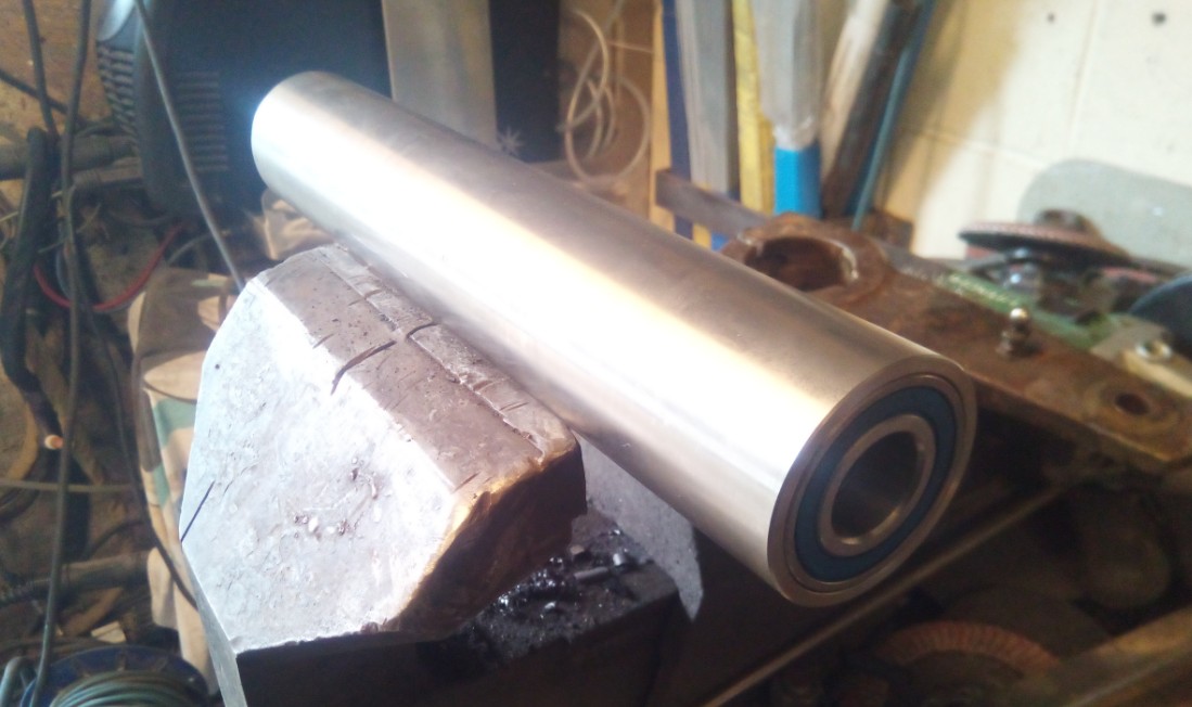

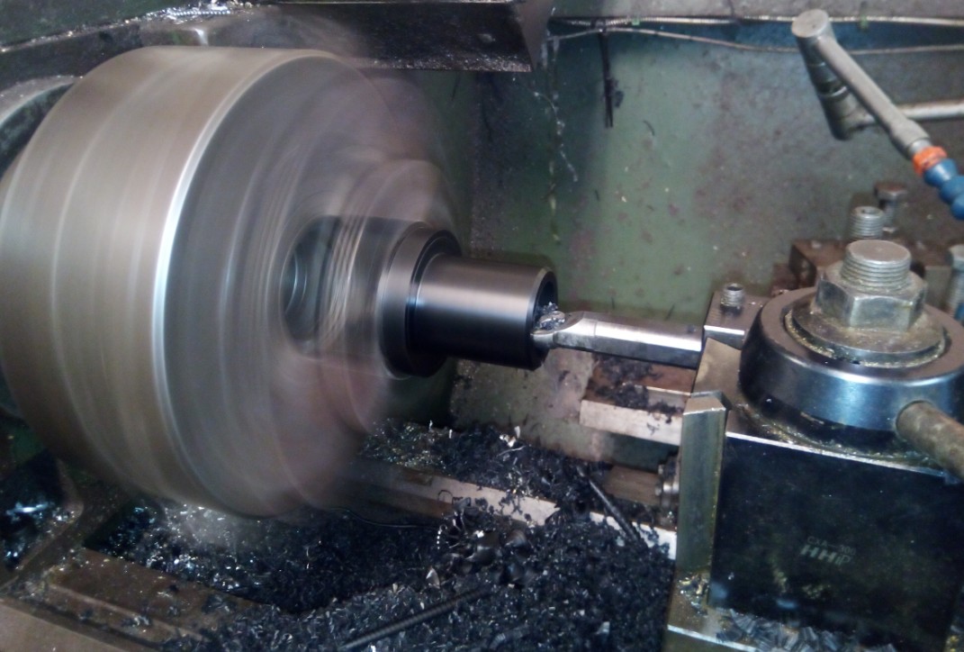

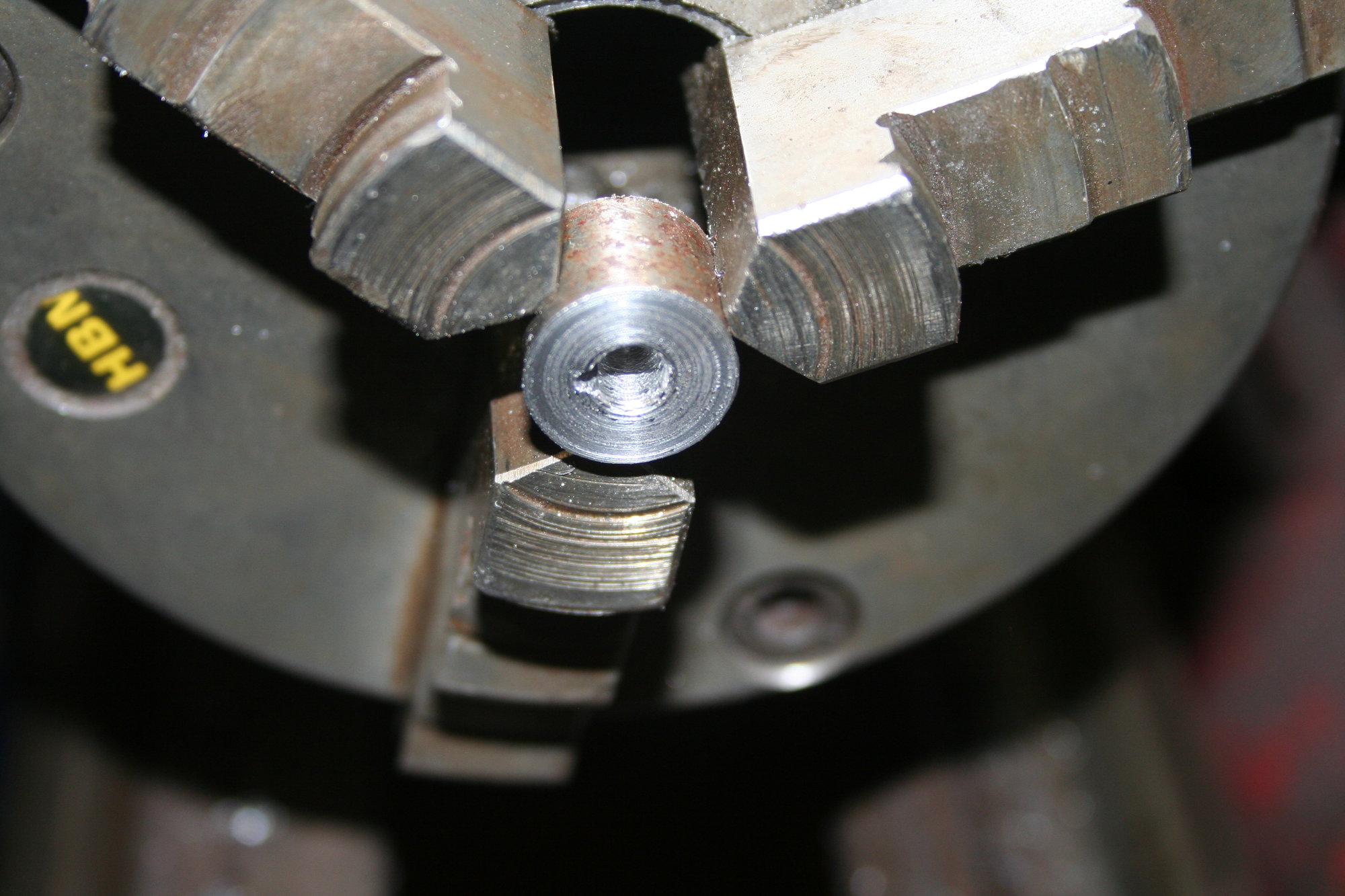

The lathe is one machine I could not do without and what I love about them is you can take an old scabby looking lump of old shaft and after a while you end up with a nice shiny roller.^^^ How wonderfull that is, you just think about it, just pop it into the lathe, take a skim, drill the center, make a recess in the ends to hold some bearings, and bang out it pops. Takes no time at all. Don't know what all the fuss is about. Can't understand why these engineering types charge so much for this, when it is just so simple and easy. I remember there is on utube two guys building a 4wd mini and in one episode they did a time laps of how long it took to build a part, from start to finish. This build didn't include planning or material gathering time, just the build. That made me feel much better

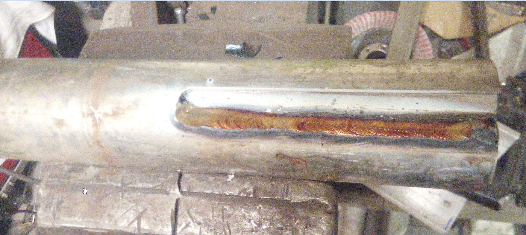

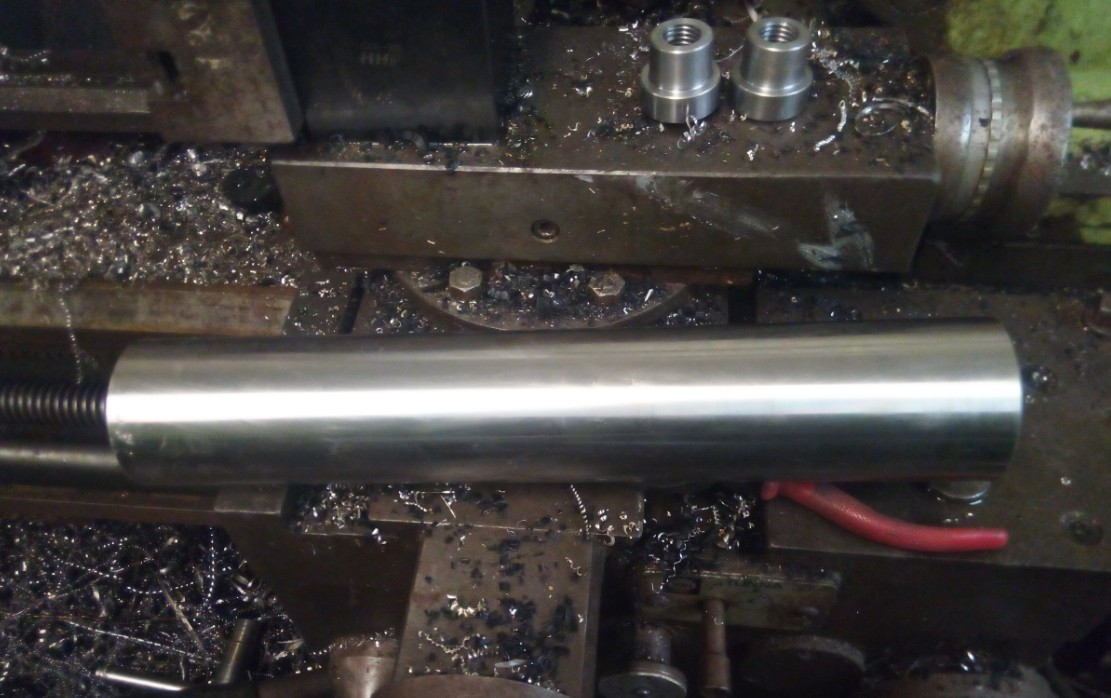

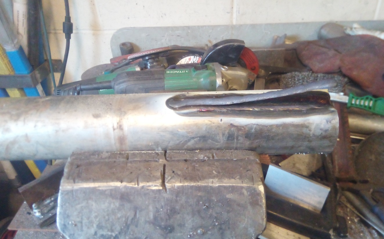

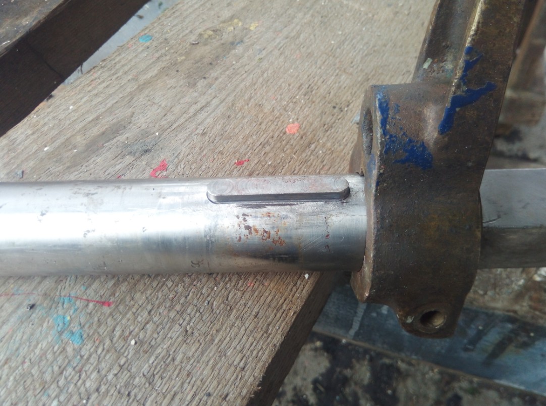

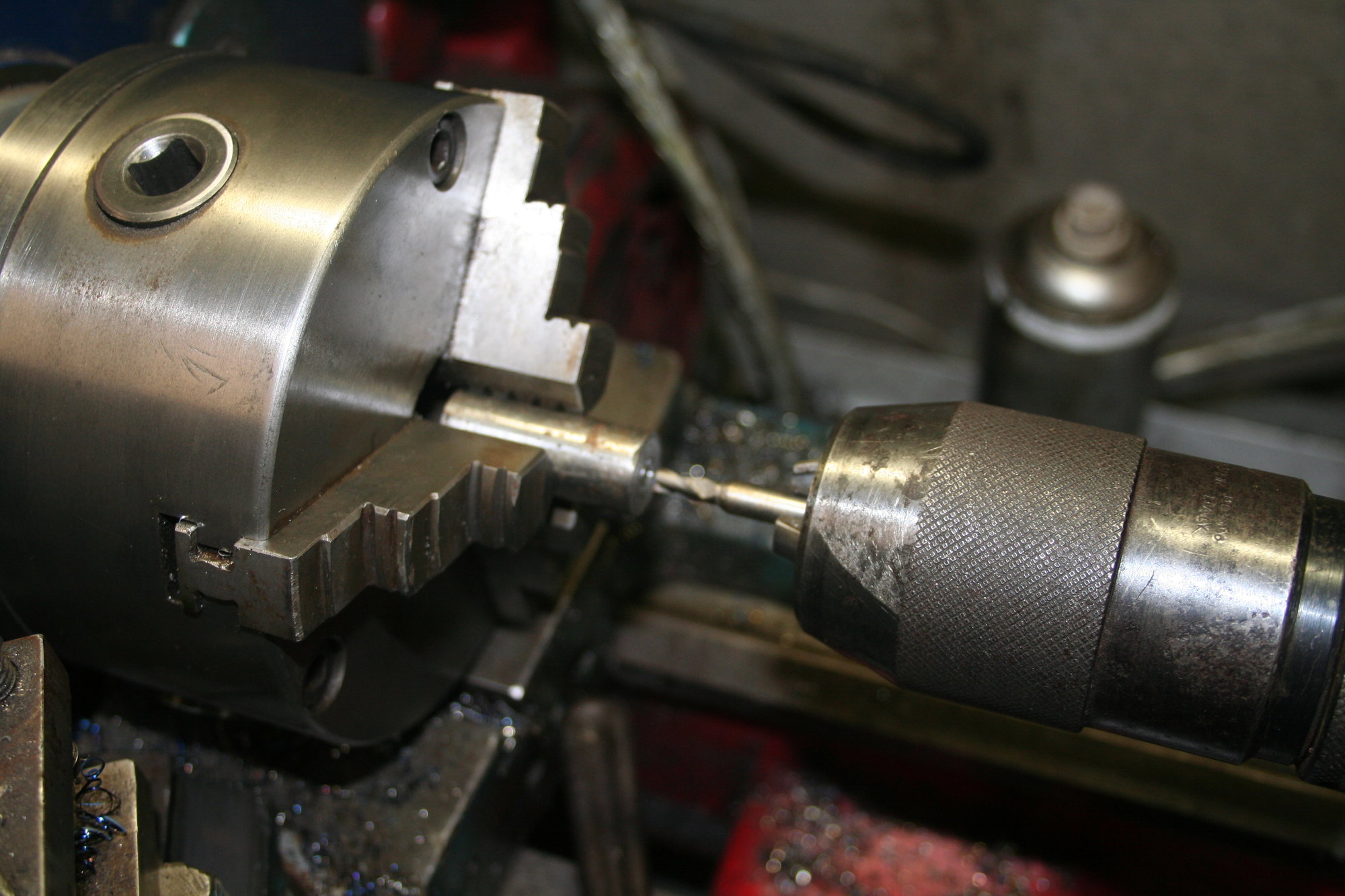

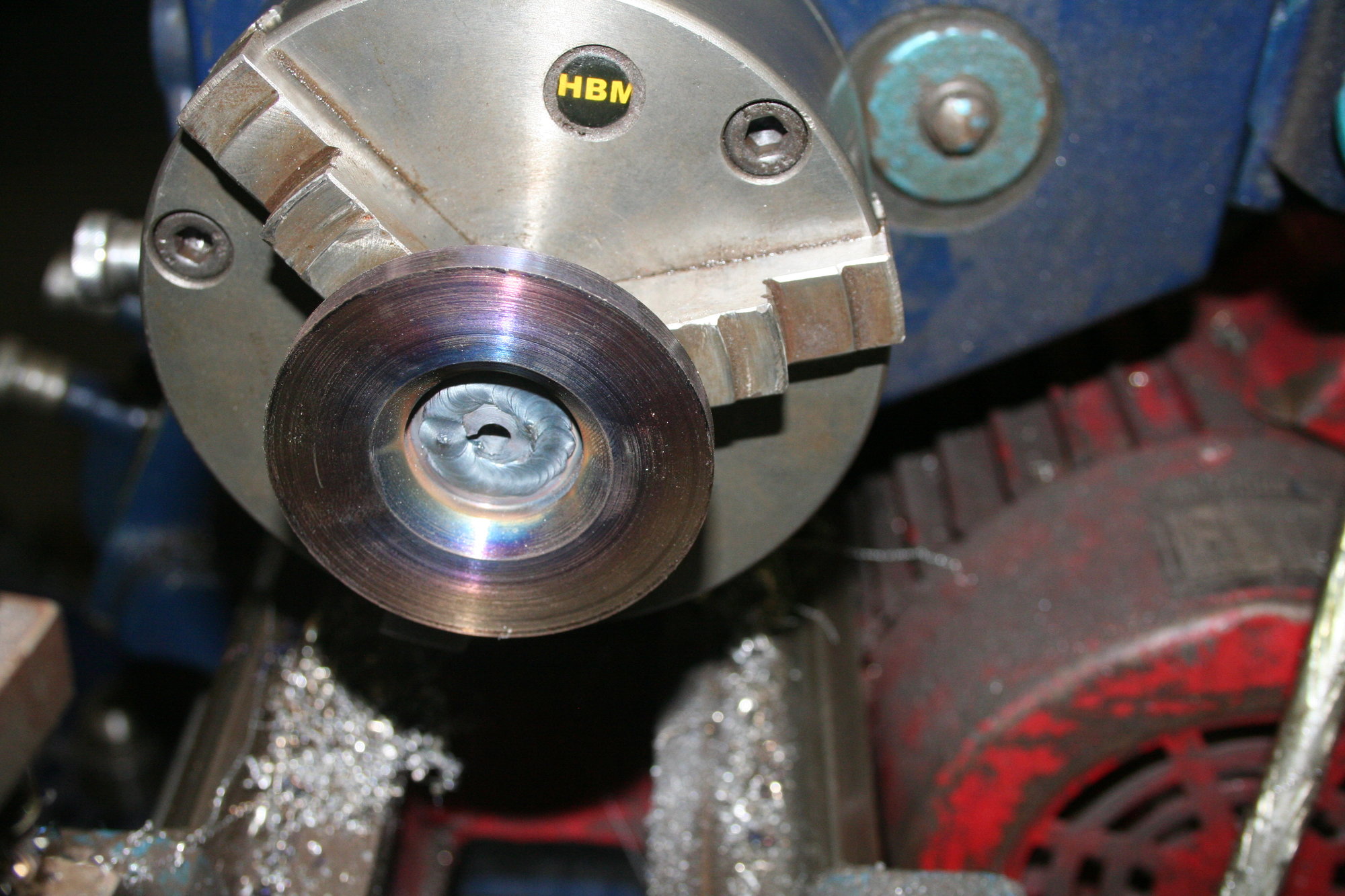

Needed to make a stainless roller 325mm long and 60mm diameter. All I had was some 2.5" Dia shaft but it had a keyway in it so I had to weld it up.
First pass in.
About another 6 passes and it was filled.

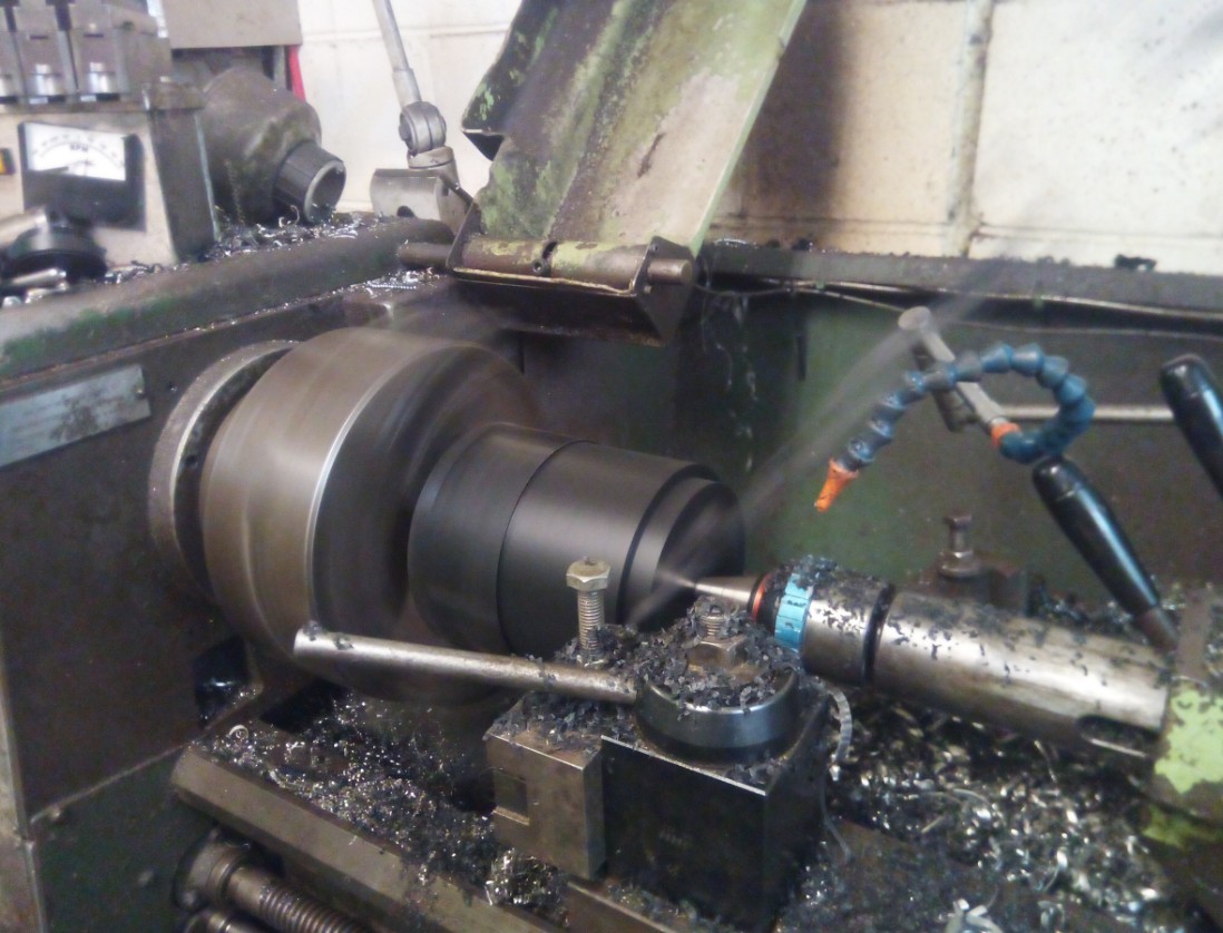

So into the lathe.
Turned down to 60mm, removed from the lathe and chopped off the end on the bandsaw.

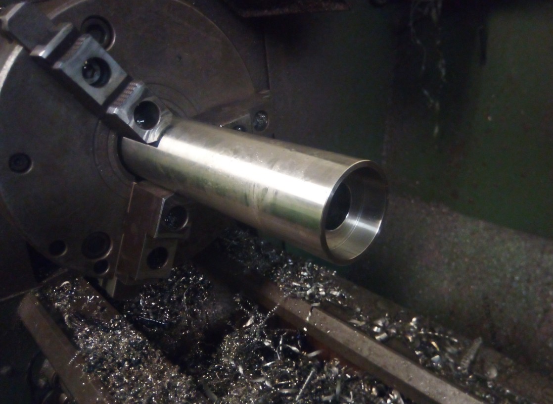

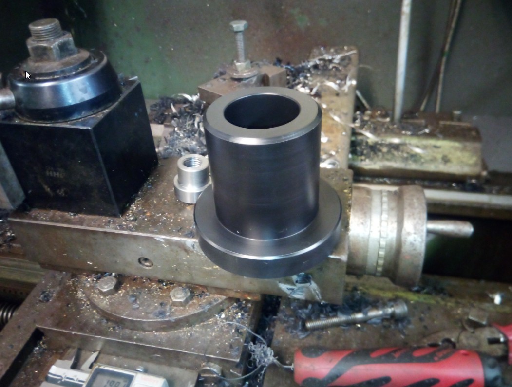

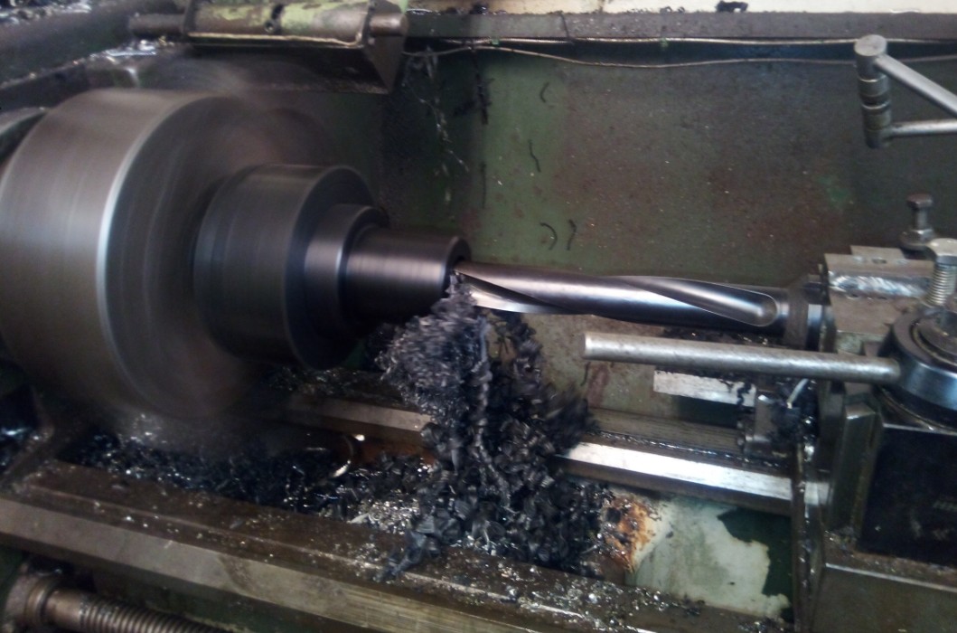

Next job was to drill out to approx 28mm dia and then counterbore each end for bearings.
Roller completed.

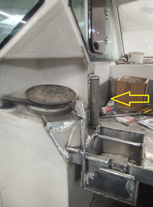

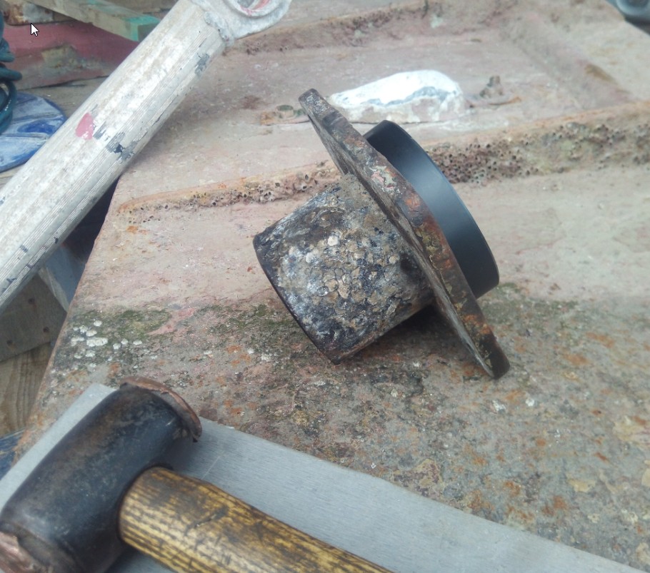

No, it is an upright roller to keep the rope into the hauler, see pic below. The one I made was from Sch40 pipe but it is wearing through so instead of trying to source a short length of Sch160 I decided just to use solid.was that a gunwhale roller for potting by any chance? i make made a couple of them thou..nowhere as nice as that! top marks

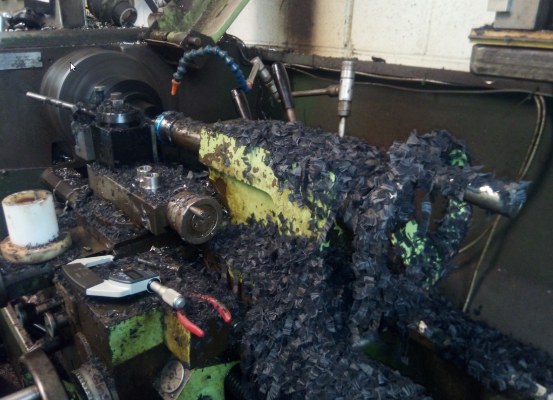

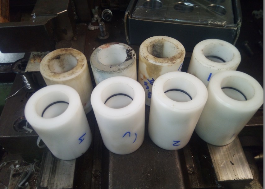

I had to get the hoover out though, this is the only downside of turning Acetal

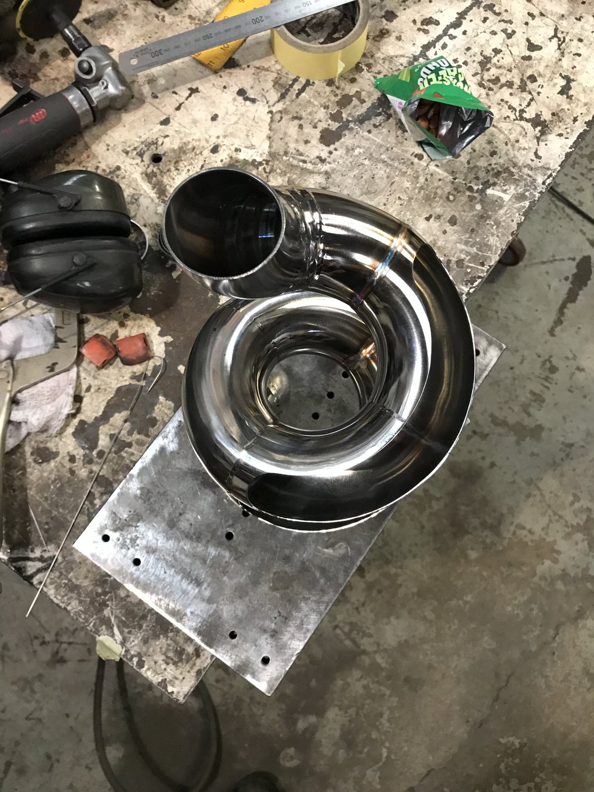

I started playing with another stainless marble run.
