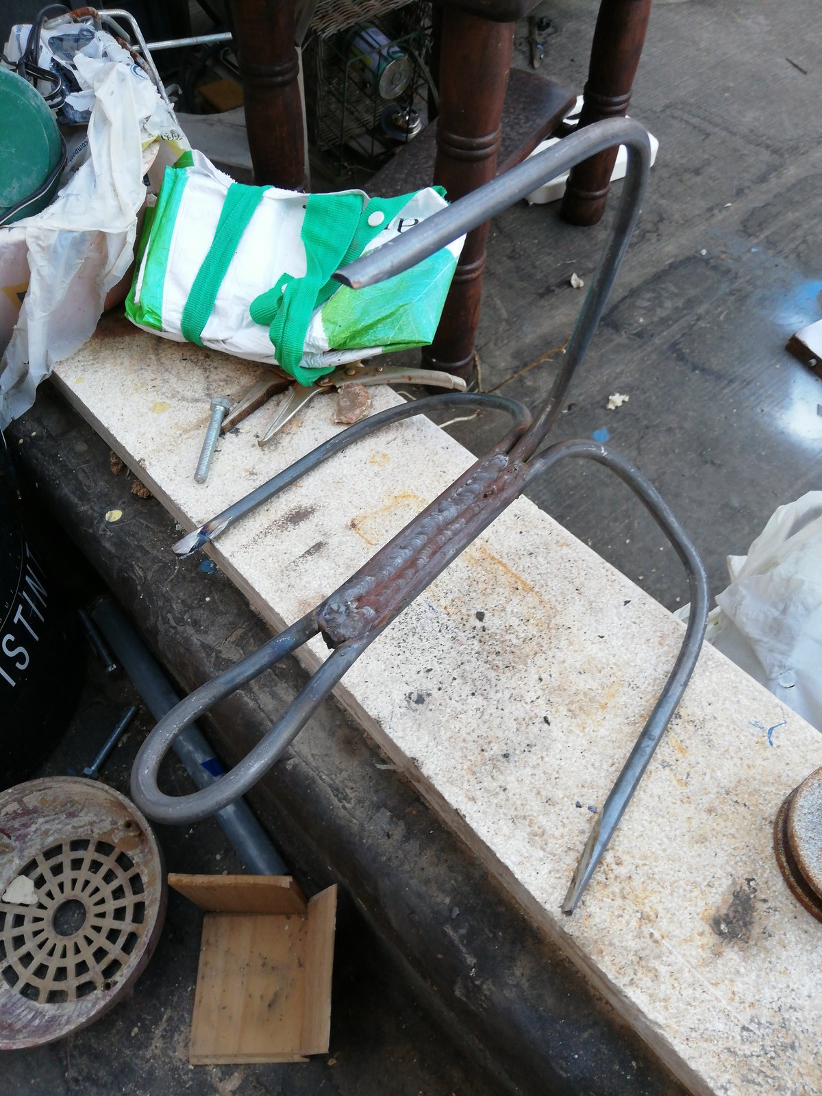

Last night I made a new grate for a cat carrier since we're gonna need it this week, pretty beefy compared to the original.
not going to be very successful at the best of times

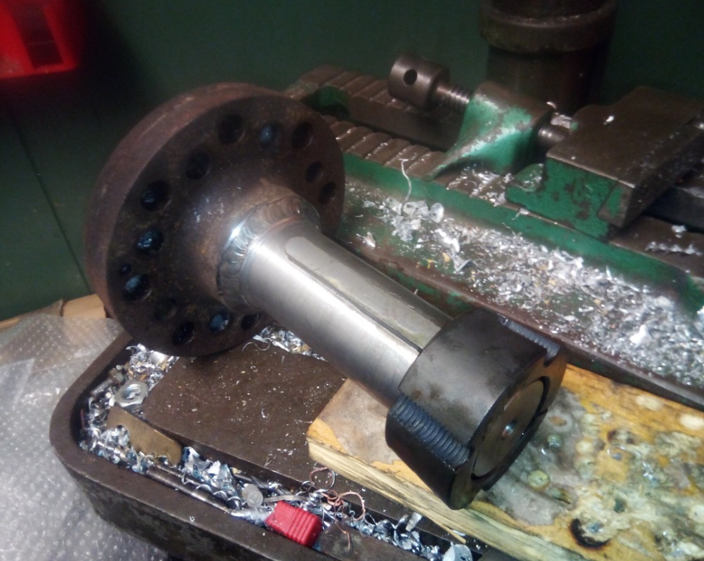

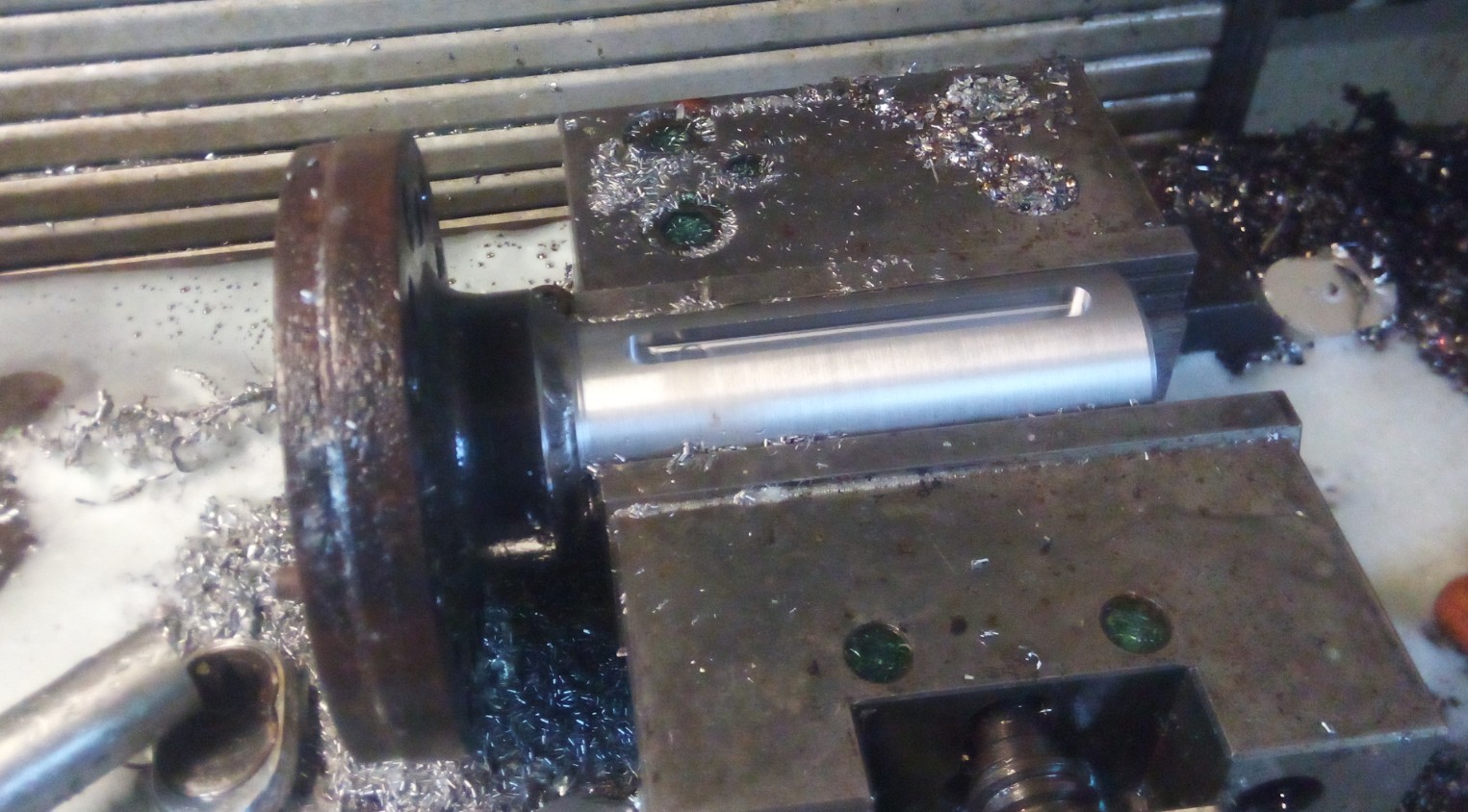

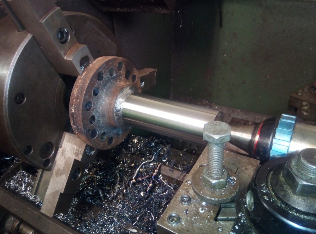

... I got it within 0.01mm over the 10 or so inch and will flip round tomorrow and do the bit held in the chuck.
there not . the jobs accurate once you have taken a cut but not once removed and re fitted .a 4 jaw is needed and clocked upWill you be able to achieve that same accuracy when you flip it in the three jaw chuck? I only ask as we're led to believe that a 3 jaw isn't so accurate.
Soft jaws dear boyWill you be able to achieve that same accuracy when you flip it in the three jaw chuck? I only ask as we're led to believe that a 3 jaw isn't so accurate.
I just set my calipers and check at the drawer these days. My spanner drawers would give some here nightmaresNot me, have to get most of the similar sizes out before I get the right one, luck I don’t need this skill to make a living

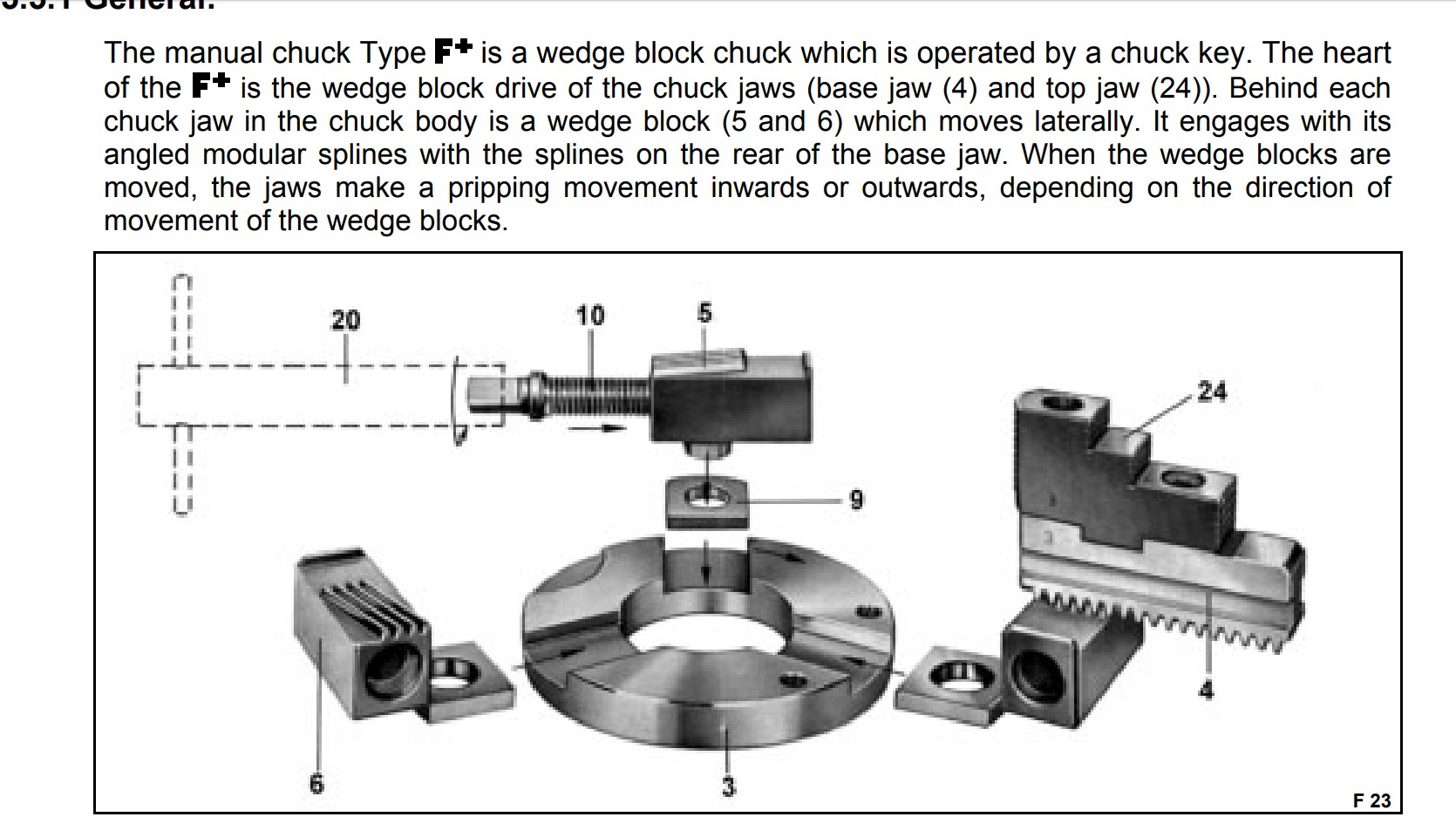

Also worth mentioning, even the hard jaws are pretty accurate in that chuck. It is not a scroll chuck Or at least not a conventional one.Will you be able to achieve that same accuracy when you flip it in the three jaw chuck? I only ask as we're led to believe that a 3 jaw isn't so accurate.
You can't say that without make us curiousAlso worth mentioning, even the hard jaws are pretty accurate in that chuck. It is not a scroll chuck Or at least not a conventional one.

It is a Forkardt F type chuck, pic below of the internal mechanism, basically it is a manually operated wedge chuck.You can't say that without make us curious
Please tell us more about , which kind of chuck you use ?
