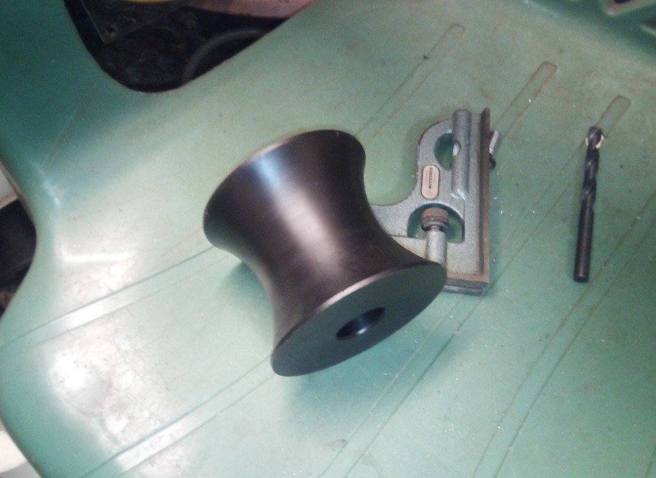

With a lot of pushing, shouting and even being dragged out to the workshop.
This is what I managed.
A Plumb Bob, blackened. The bolt was hand drilled. Egg Beater drill C/O @Chillitt and the string fed through.
Fitted the handle.
Baby steps. @Parm @Wozzaaah and @slim_boy_fat

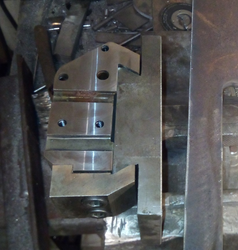

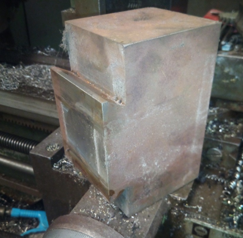

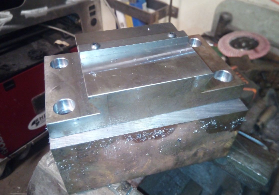

Today I have started to have a go at making a quick change tool holder for the lathe, but can’t go any further as the tee slot cutter I ordered hasn’t turned up yet:
need to find something else to do now.
If you have a beefy mill that can turn a 1" shank tool you could probably grind one down, or better yet get a horizontal mill cutter and braze it onto a stub.

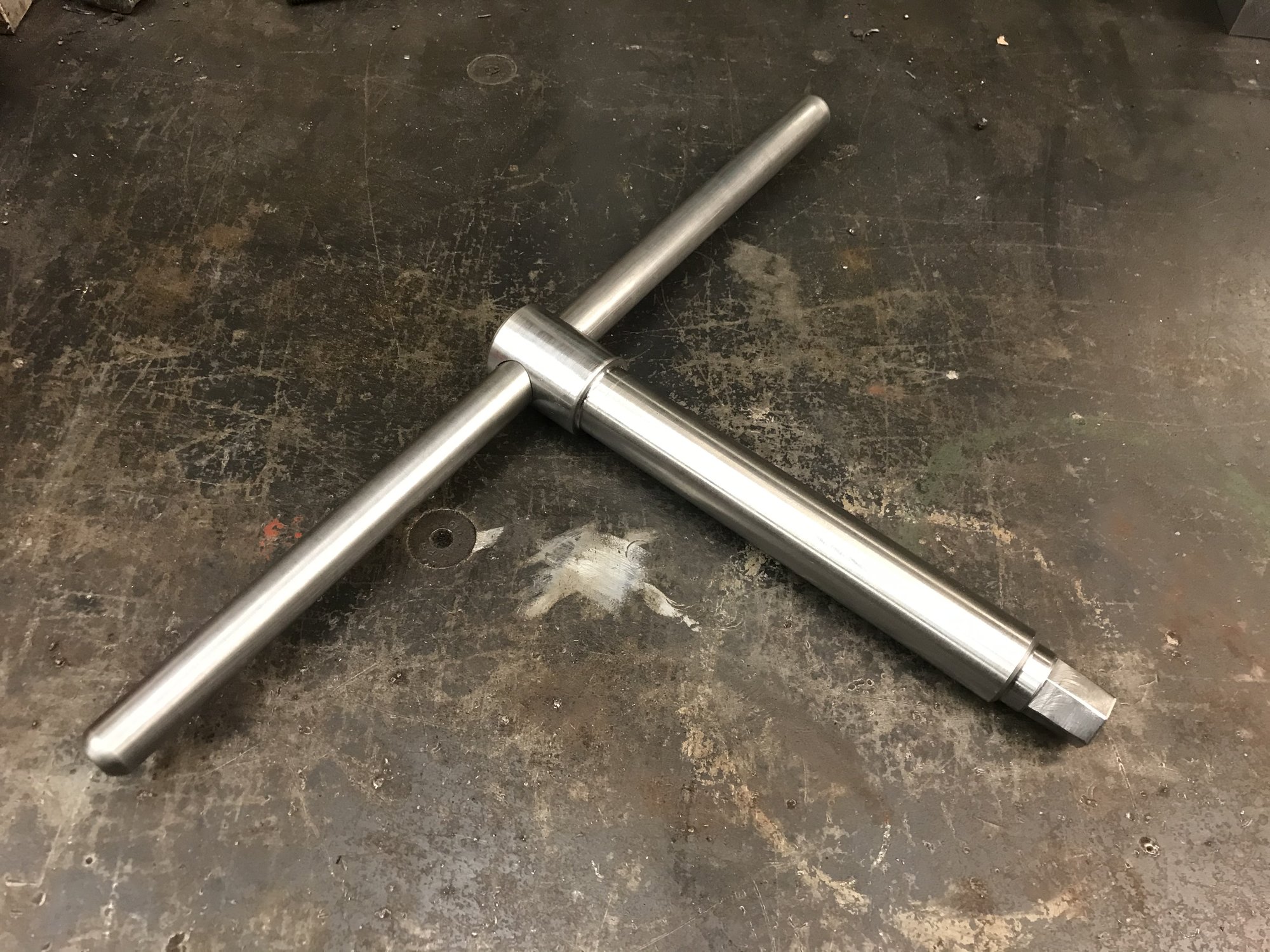

and that wasn’t going to happen so found a pice of EN19 in the rack and knocked this up:Made a few for all my chucks. Far too tight to buy em.Bit of a boring one but I needed a 5/8” hex chuck key for my 4 jaw. The only one I could find on the inter web was about £100and that wasn’t going to happen so found a pice of EN19 in the rack and knocked this up:
Hopefully it will hold up.
Same, it’s the first thing I made when I got the lathe. It’s not difficultMade a few for all my chucks. Far too tight to buy em.
Even easier with one of those on the mill.Same, it’s the first thing I made when I got the lathe. It’s not difficult
