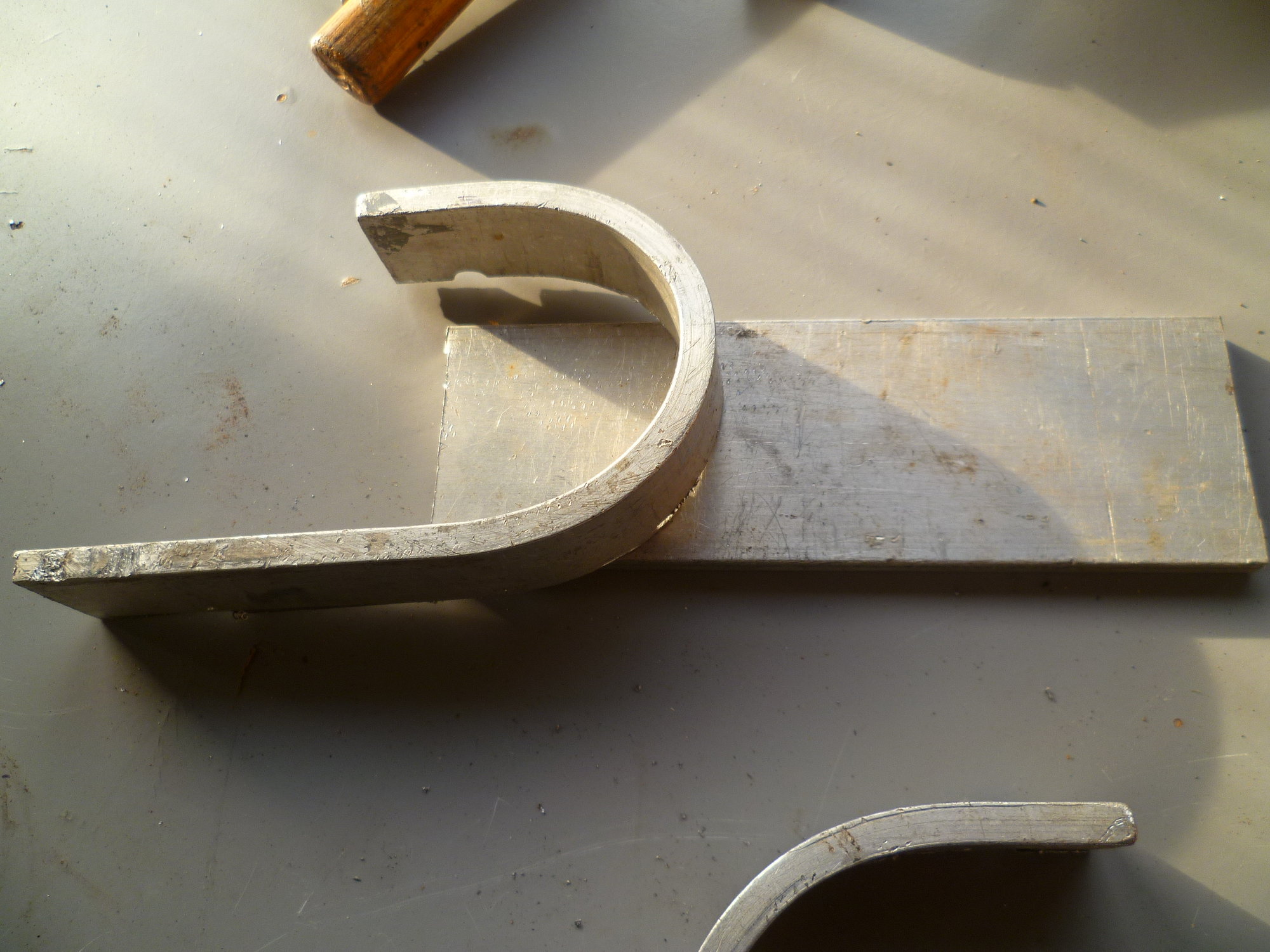

Made a rack for the bike.
Yep, no point having a rack if you cant tie stuff to it. there must be racks available for it, but I didnt even look. Couple of hours and some offcuts and a bit of left over paint.Very good, looks like you made loops for bungee straps too?
Is there a rack available for this make/model already? What's the cost VS this one you have made would you say??

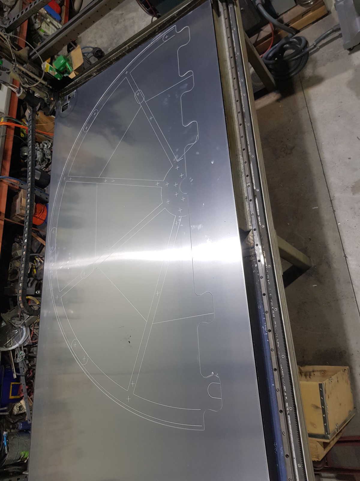

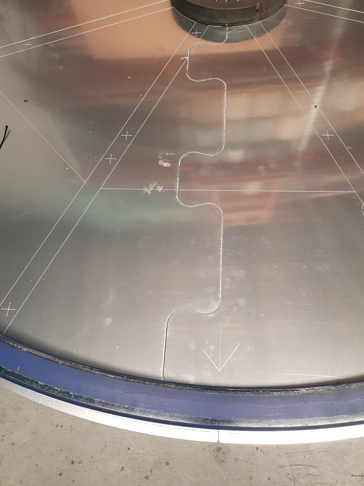

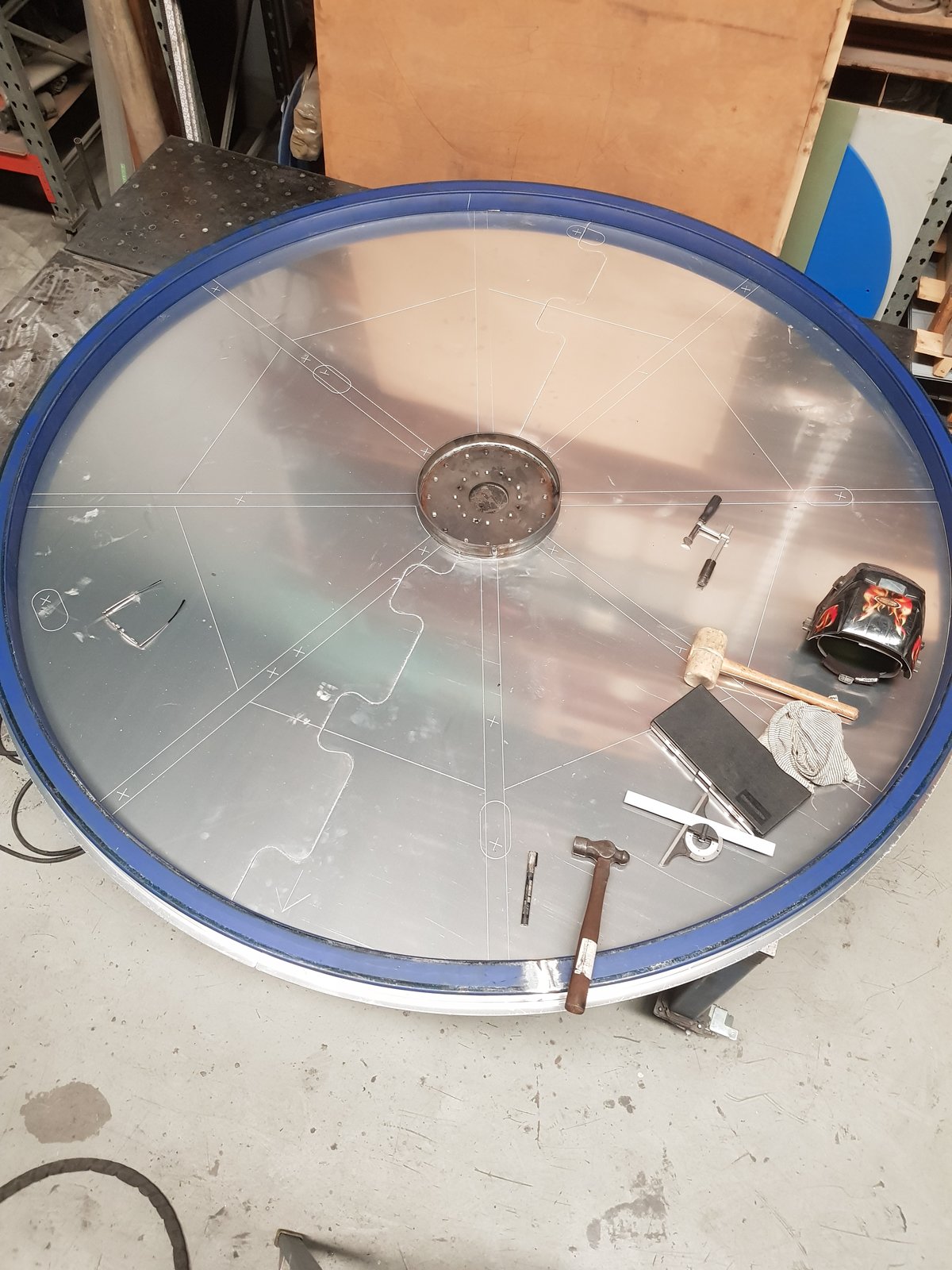

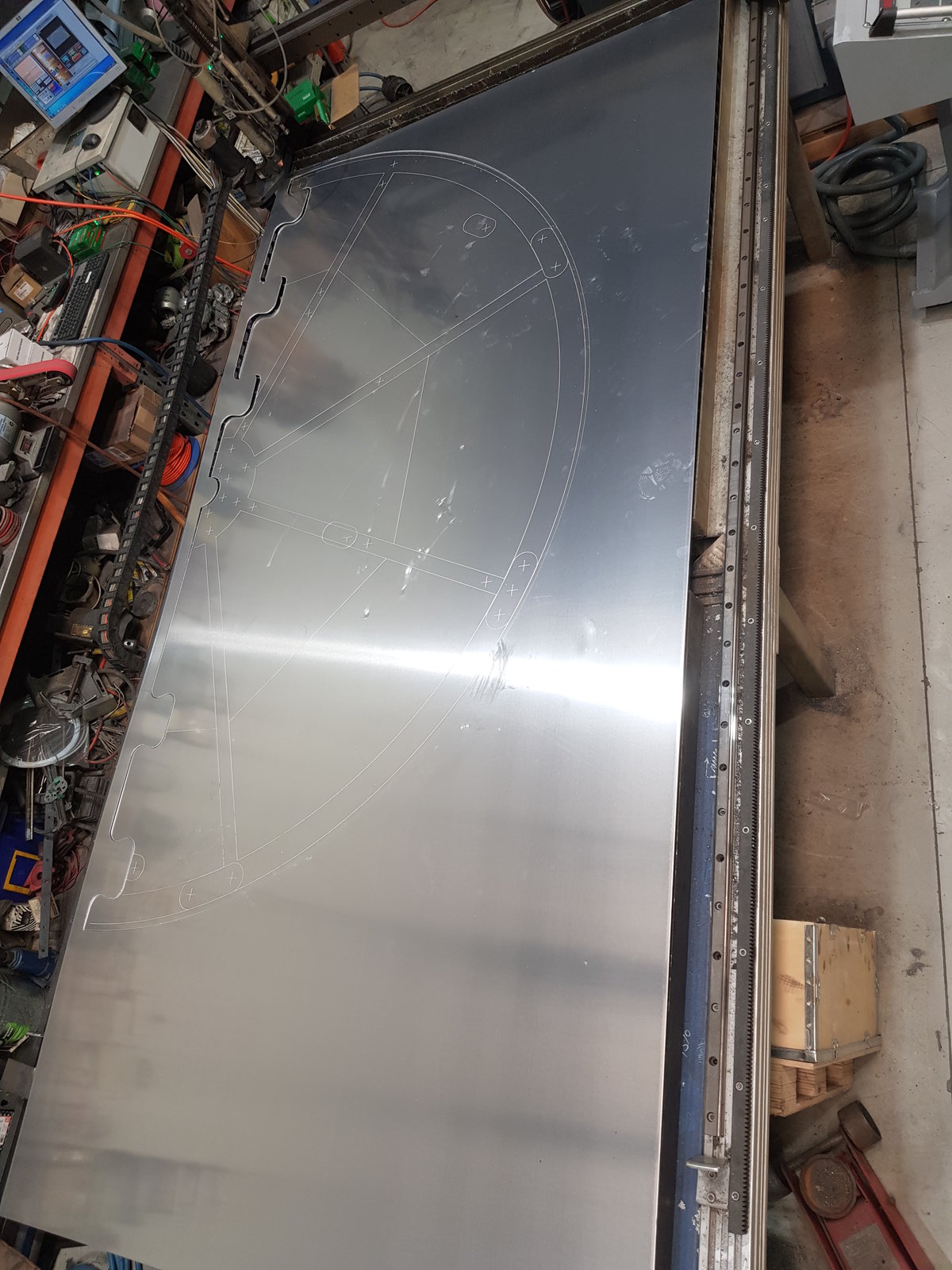

Was supposed to dismantle the plasma machine for it's upgrade, however that didn't happen. Work that was planned for late January/ early February has been moved forward (a lot) so have been making that stuff over that last few weeks. One of the alli templets that I made about 1.5 years ago I wasn't happy with. Didn't quite fit together, line up and generally give much confidence with. So I made a new one
First half and these are 2.4 meters in diameter and are cut from a 1500mm by 3000mm sheet.
2nd half
Assembled on the welding table.

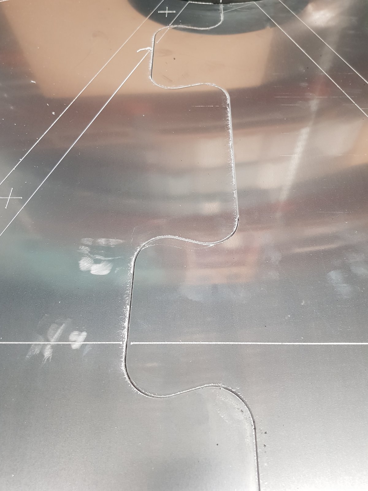

I am quite pleased as how they turned out. Recalibrated the scriber position and the plasma tolerance was set at .4mm
A lot of knowledge has been gained since I first started this line of work and things are slowly improving. Not a lot achieved yesterday with lost of visitors, chin wagging, tea and coffee being drunked. Well it's Christmas time went home early (normal time for everyone else) had dinner sat down with the kids, started to fall asleep, got told to go to bed by the boss and slept 10hrs. This morning still feel that, that wasn't enough. Last pic the fitup is now quite acceptable.
Best of all that is straight off the plasma no dressing to make it fit![]()
Almostwhat is it / what's it for?
a lazy susan?
That looks a neater setup now - nice one!![]()

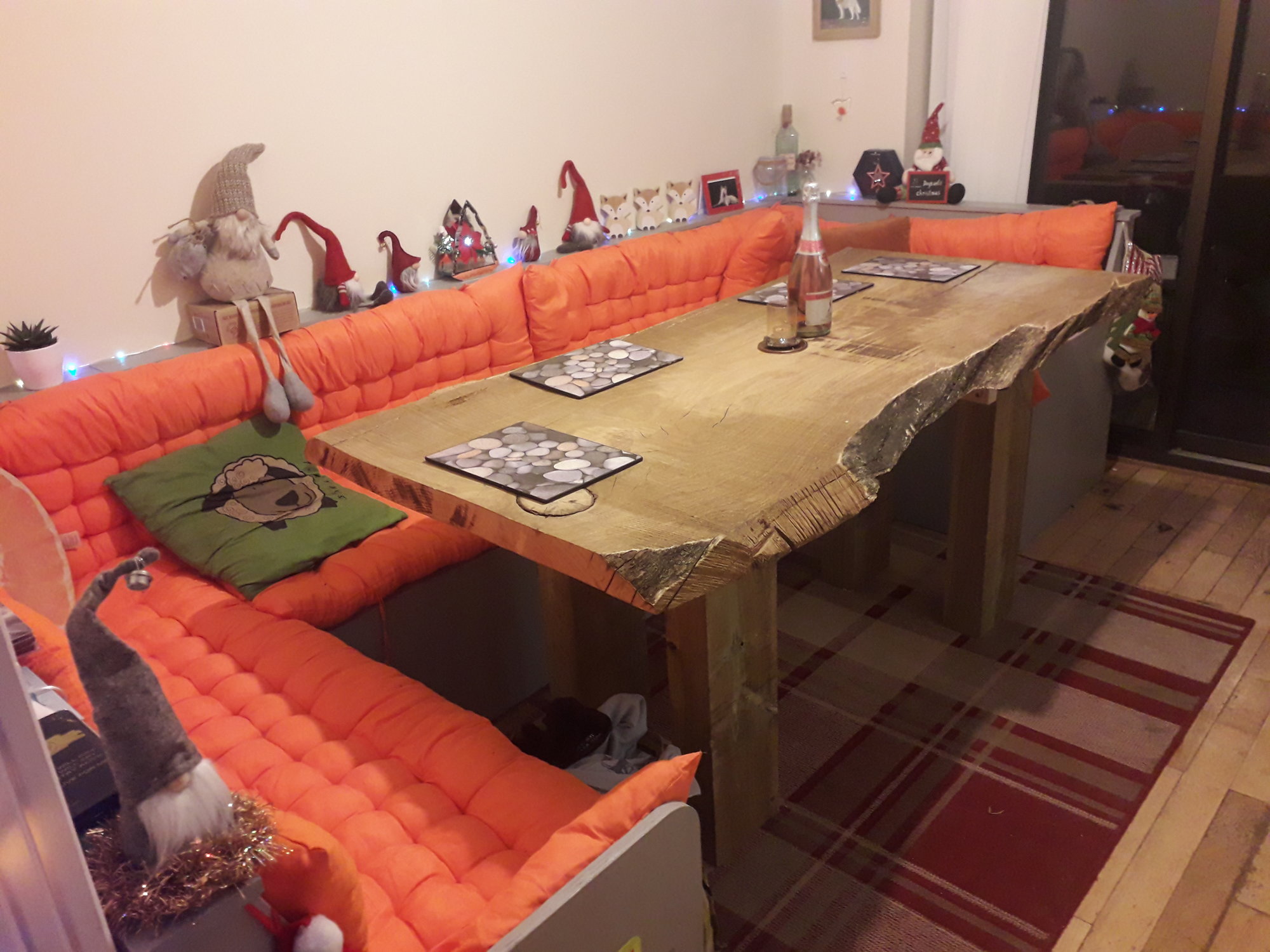

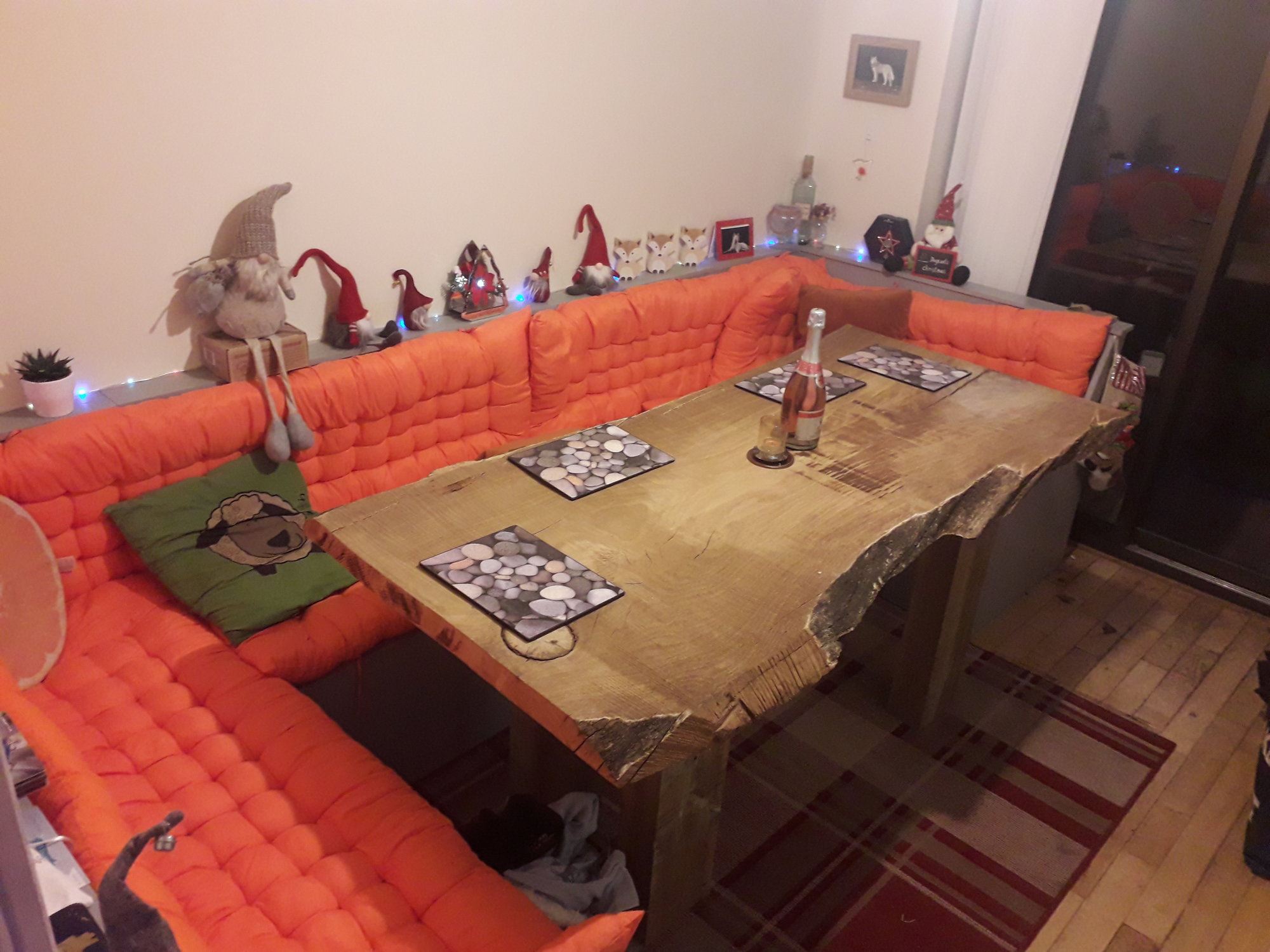

Do you supply the sunglasses or do you ask guests to bring their own.So after the wood being sat in the van for nearly 4 months and thinking with christmas coming and family due round I needed a dining room table sorted.
So not sure if its finished as having second thoughts on the piece of wood chosen but will have too do for now.
So squared up the legs and the ends and built a brace frame to mount the slab on.
Bit bright.![]()

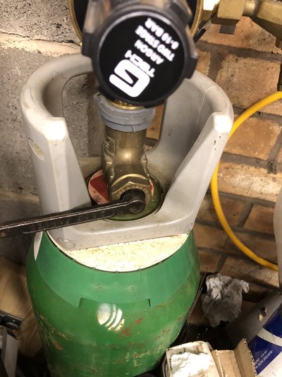

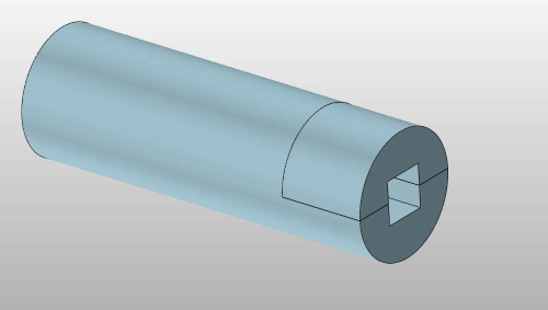

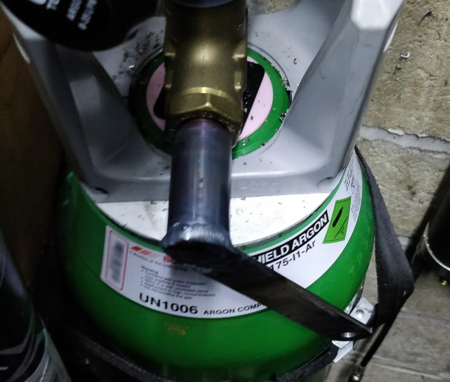

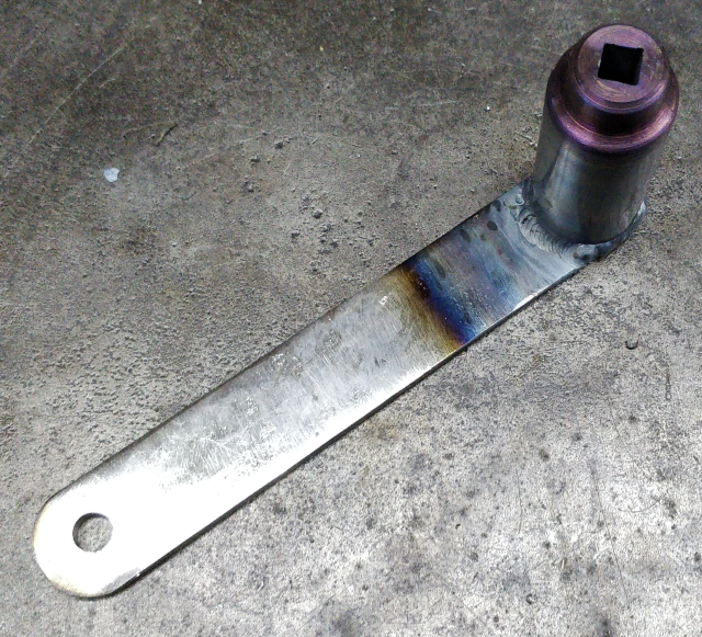

I've been getting a bit frustrated with the spanner I bought to turn the gas on and off. It's very short and (possibly as a result of the orientation of the cylinder and regulator) either seems to clash with the regulator or with the gas bottle. So I made a new one (and it went a nice purple colour with the welding heat):
Fits nicely:

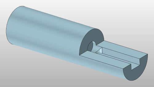

Fairly straightforward to make; the only interesting bit was the 7 mm AF square hole. I took a bit of EN3B bar stock and drilled a 7 mm hole in it. I then stuck it in the mill and got rid of half of it for a length of 30 mm or thereabouts, then opened the round hole into a 3.5 mm deep, 7 mm wide rectangular one. Something like this:
I then cut the end in half, flipped the cut-off bit over and welded it back together:
Then it was back to the lathe for a tidy-up etc.
