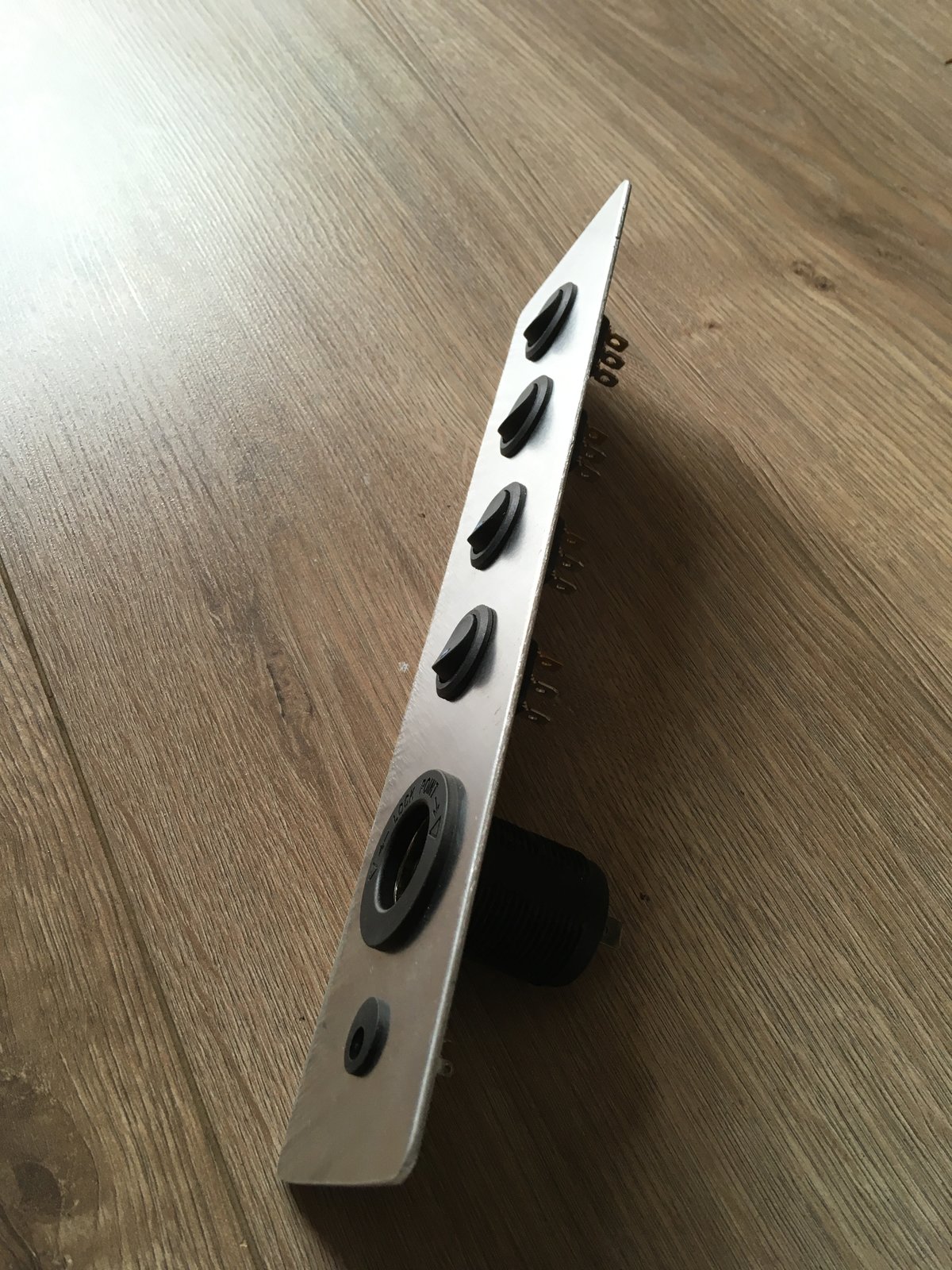

. No more messing around trying to connect the cable from the marker board lights, just plug it in and away we go
