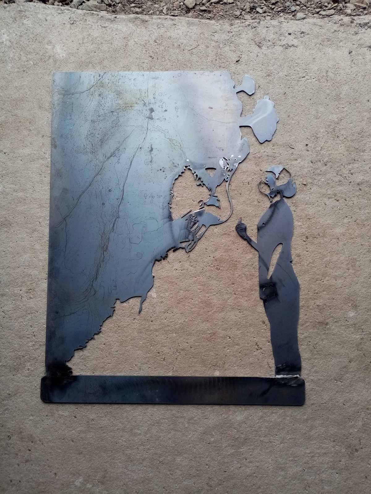

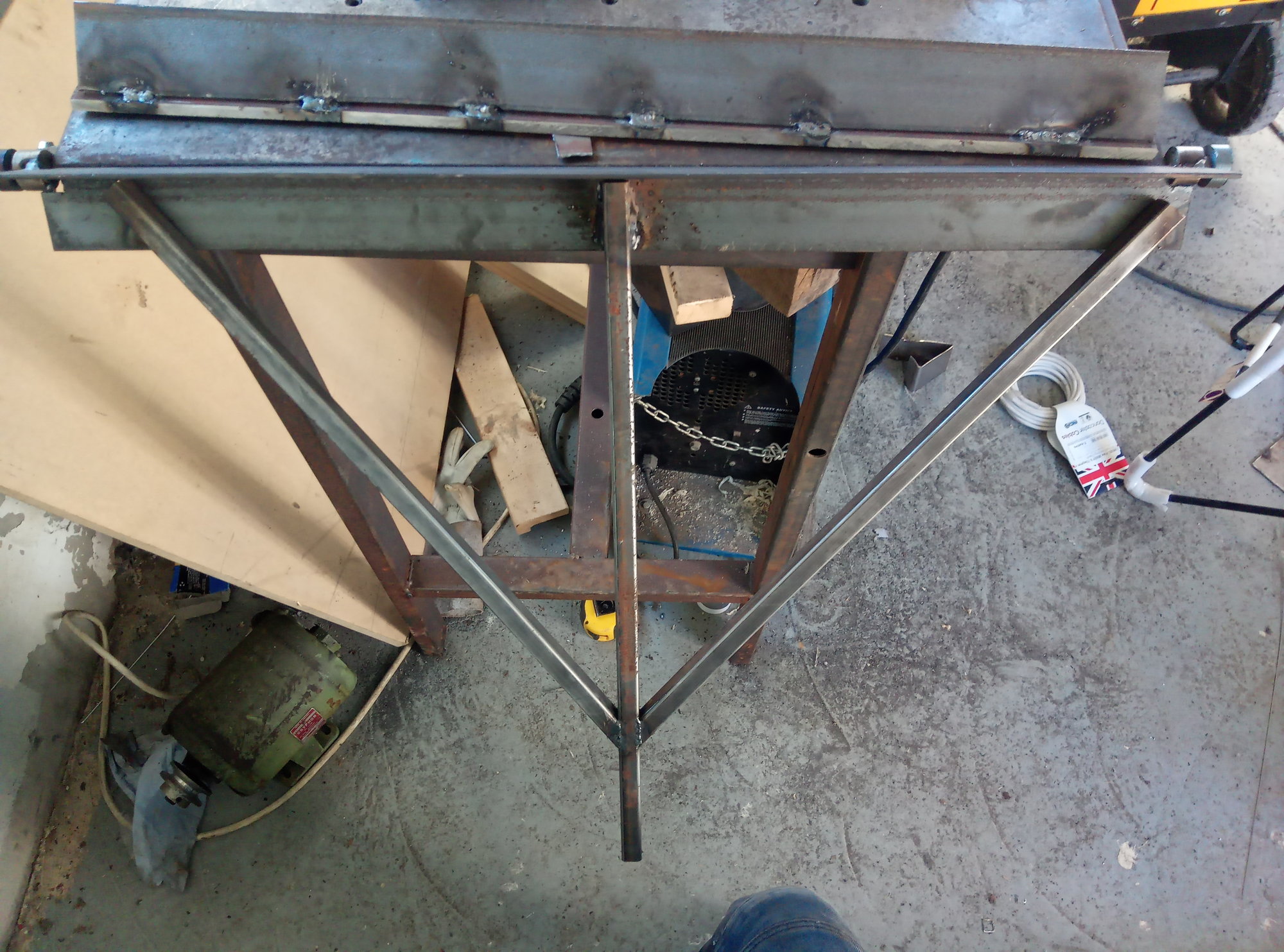

haven't figures out how to do those bend lines yet on mine. You you just draw a straight line on the cad program?

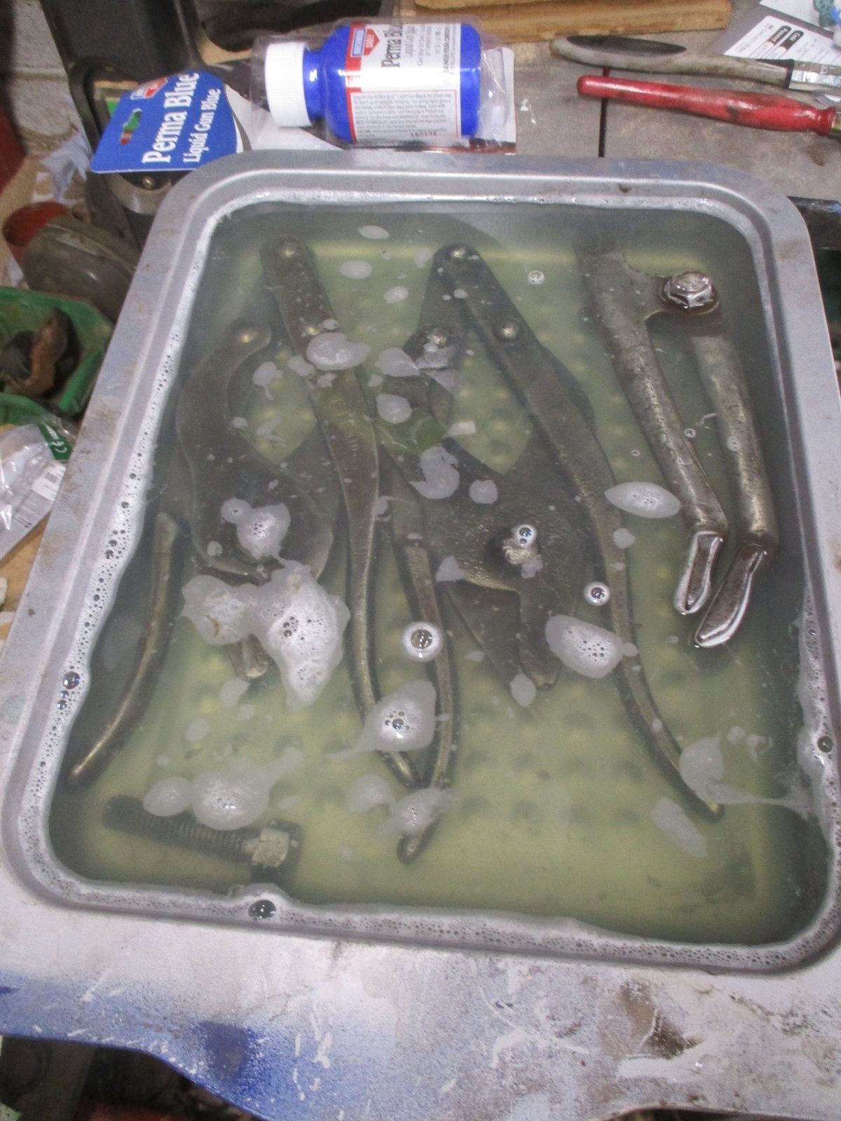

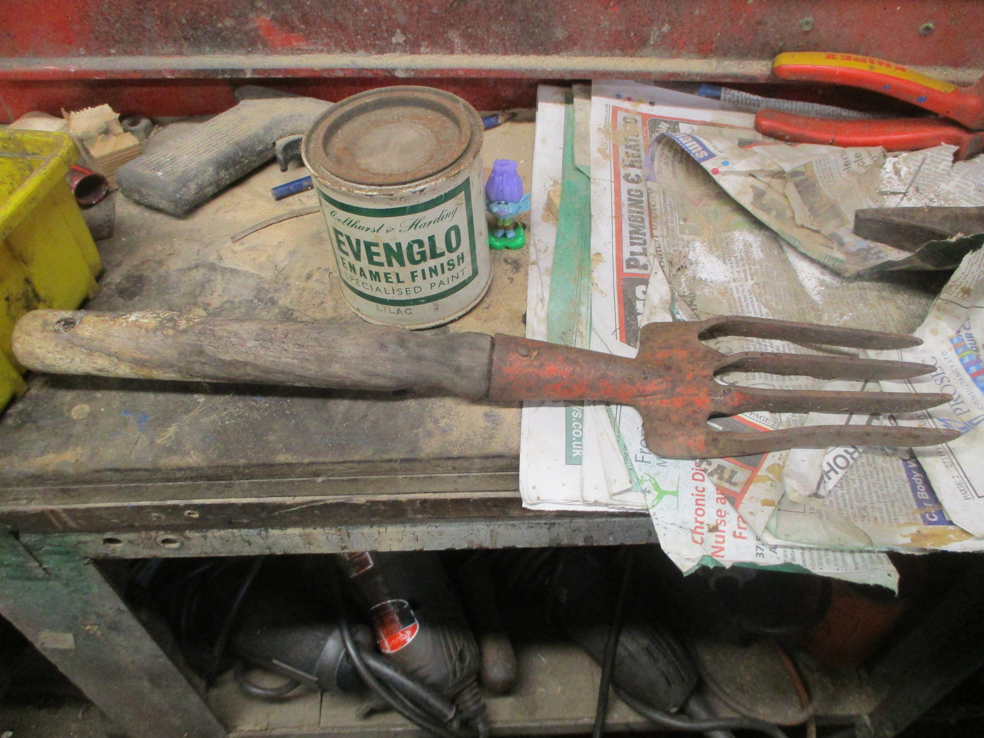

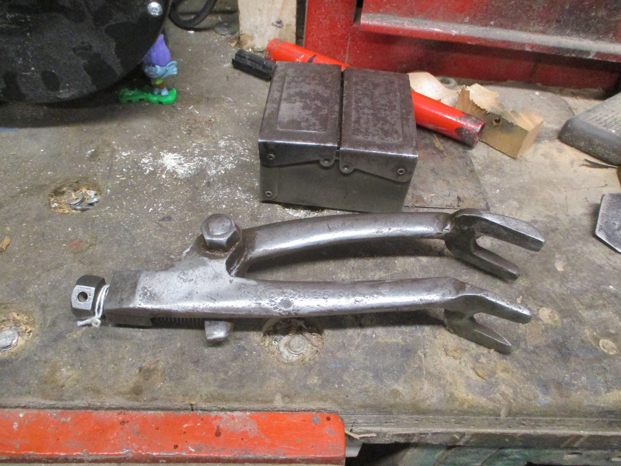

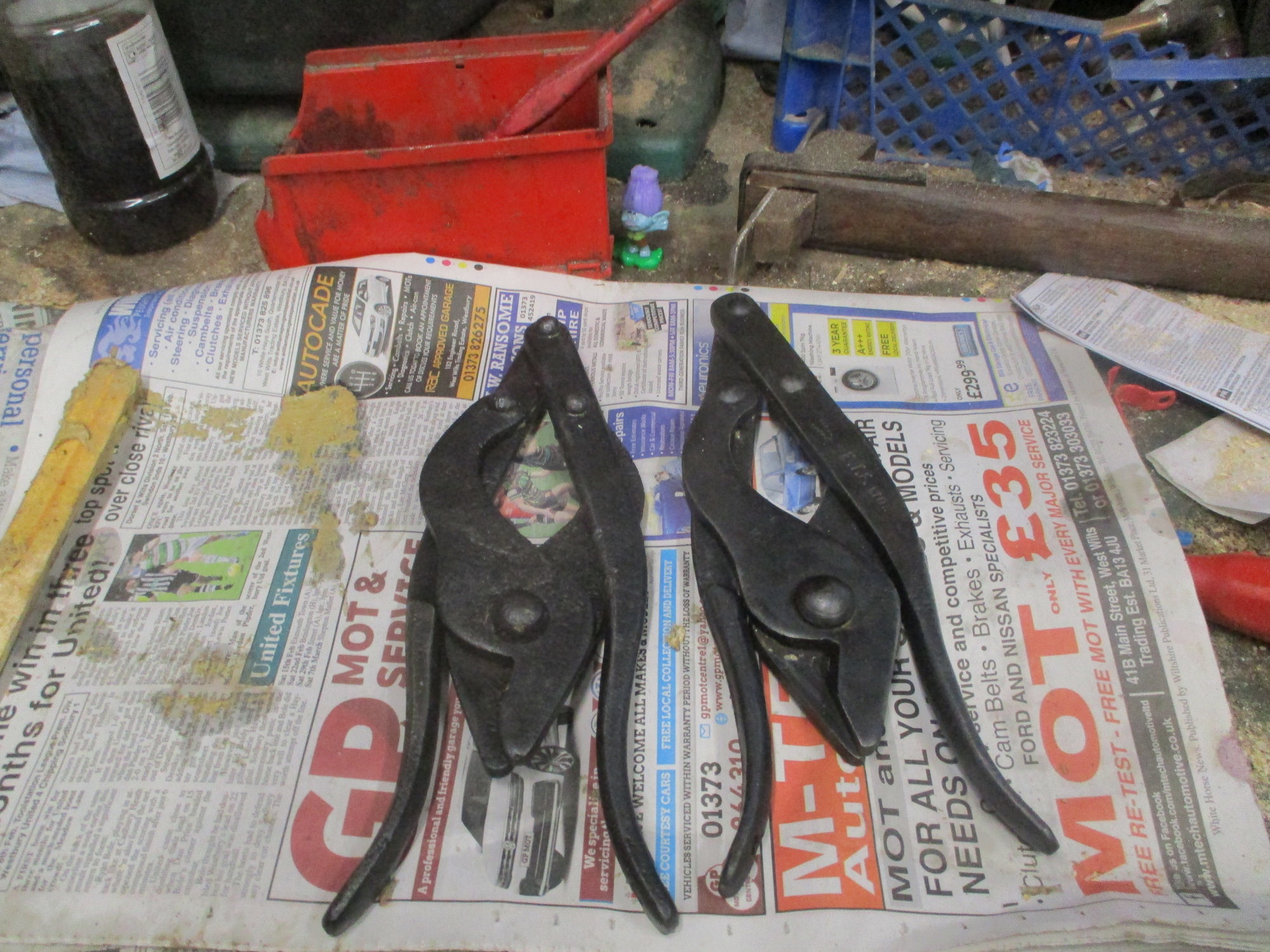

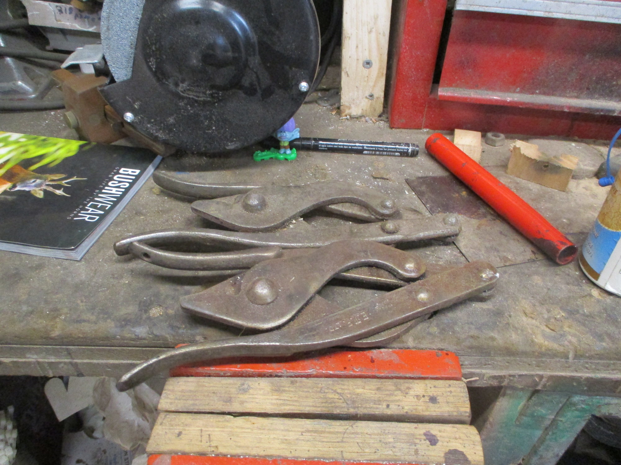

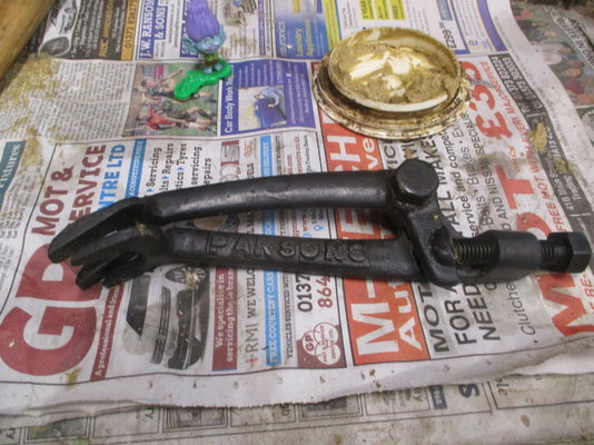

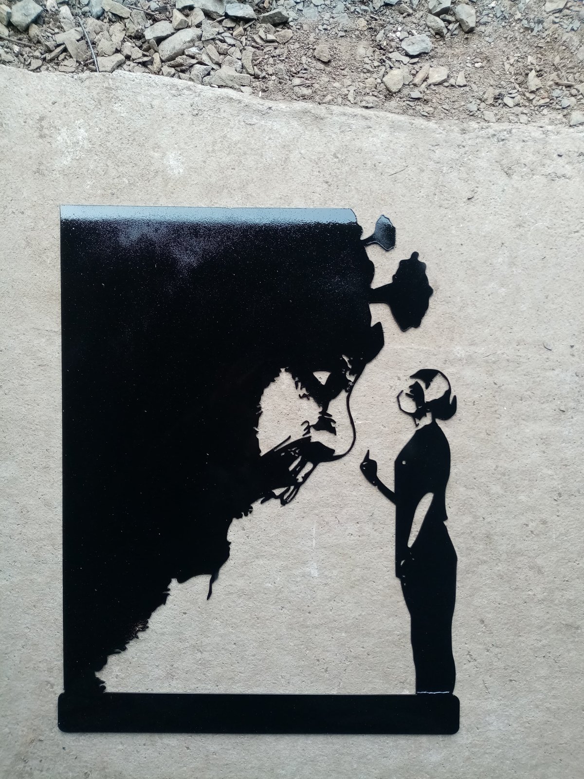

Both were Chemically blackened.
Then waxed with bee's wax and linseed oil.
I am sure you must have said before but can you remind me what you use to Chemically blacken old tools please?
And a wonderful colour.
That lot was done with the Frost Blackening kit.
The 3 part one.
I have yet to use the Gun Blue yet on a project.
https://www.frost.co.uk/metal-blacking-kit/
This one ^^ ?
@£63 I think I might have gone off the idea.![]()
Could probably just get the bluing solution, solution 1 describes itself as alkaline de greaser and 3 as de watering oil so 1 & 3 not so difficult to substitute. I haven't got a clue where to get Copper Selenate for solution 2 I will have a think on that one.That's the kit. I didn't pay that much.
But the good thing is.
That once you done each stage, you decant it back in to the bottles ready to be used again.
