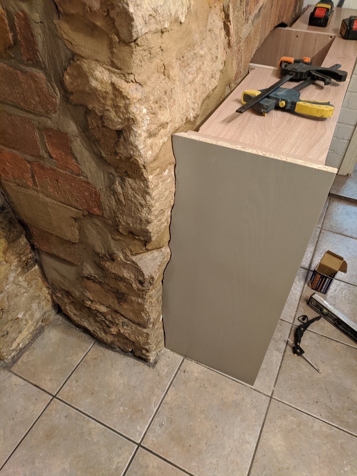

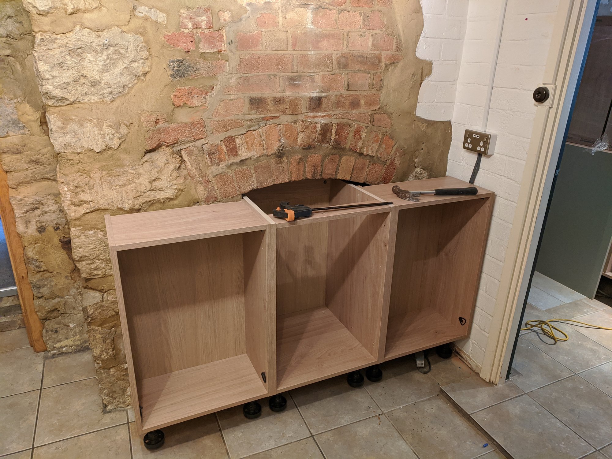

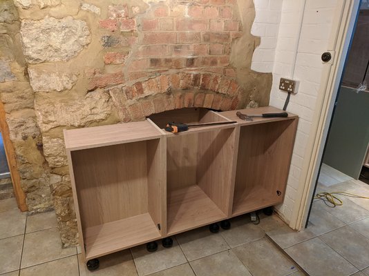

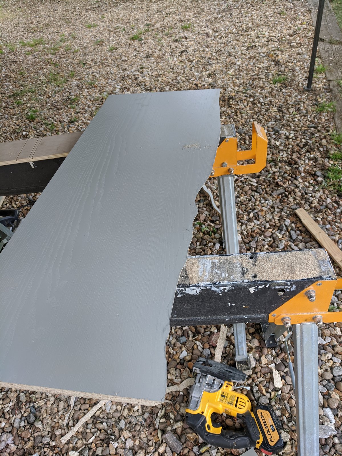

You'll have to explain how you scribed that line! I can never get it right![]()

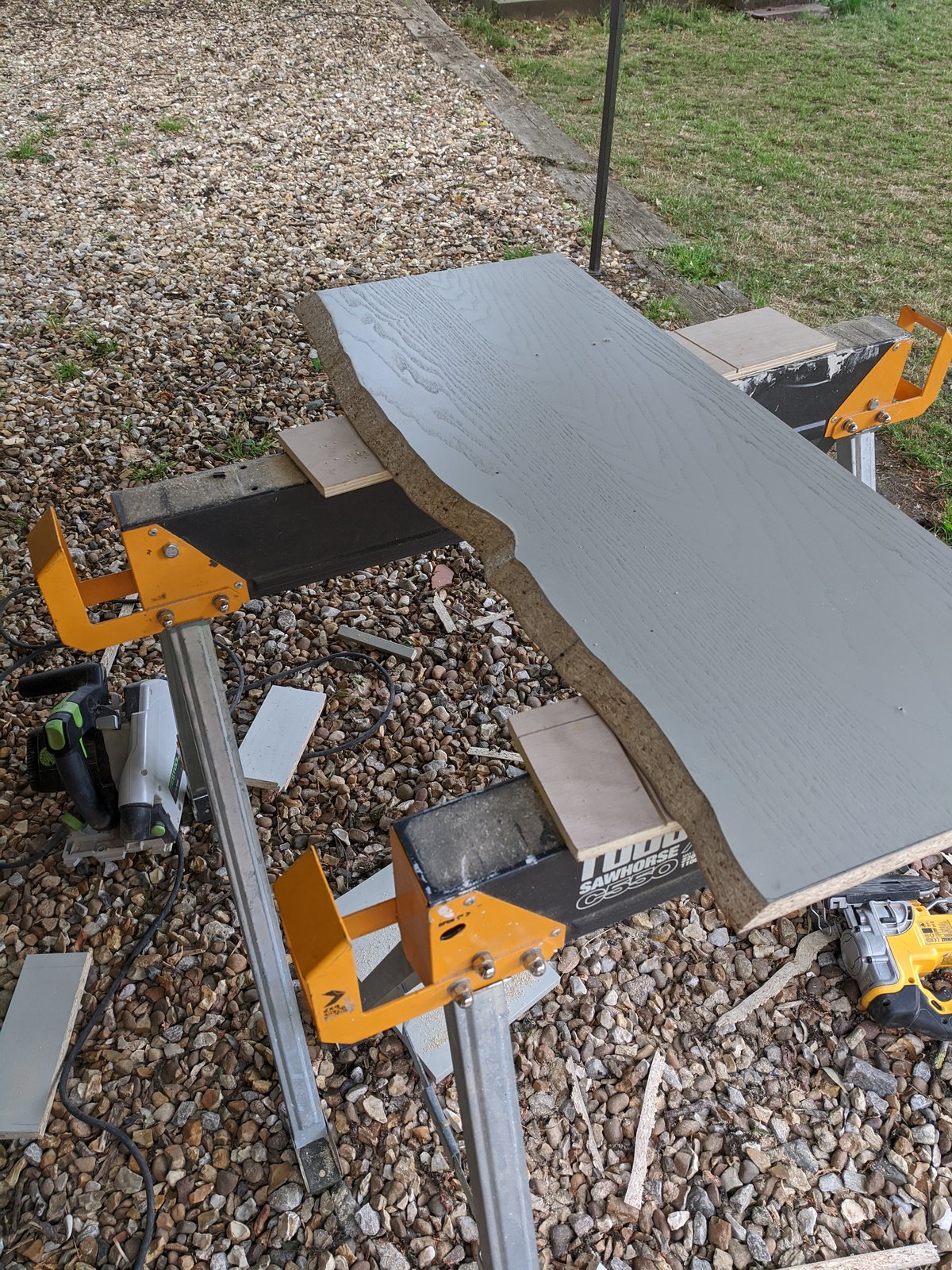

Always used to cut a bit of wood with a v one ond and a pencil notch the other end but one scribe one jobPractice and one of these.
Gone up a lot since I bought mine 5 years back think I paid a tenner
Though had to be inventive due to the contours. Used it flat with a second pencil to mark
But how do you set the scribe?
For infills.Il use this picture to explain.
I Cut the board 60mm wider than the unit.
Temp screwed in place and scribed and cut to the floor.
Mark 22mm from the front. (offset for doors)
And temp screw in place level and plumb
Set scribe from carcass face to 22mm mark.
That's how much needs to be cut off from any point in the wall to fit
Run scribe down wall and transfer that distance to the end panel
I cut 15 mm shor of the line
Refitted it temporarily and double checked and adjusted. (not normally needed on a normal wall but this was all over the shop.
Then set the angle on the jigsaw to allow clearance as per
And cut to my final line.
Different tools but same process.For infills.
