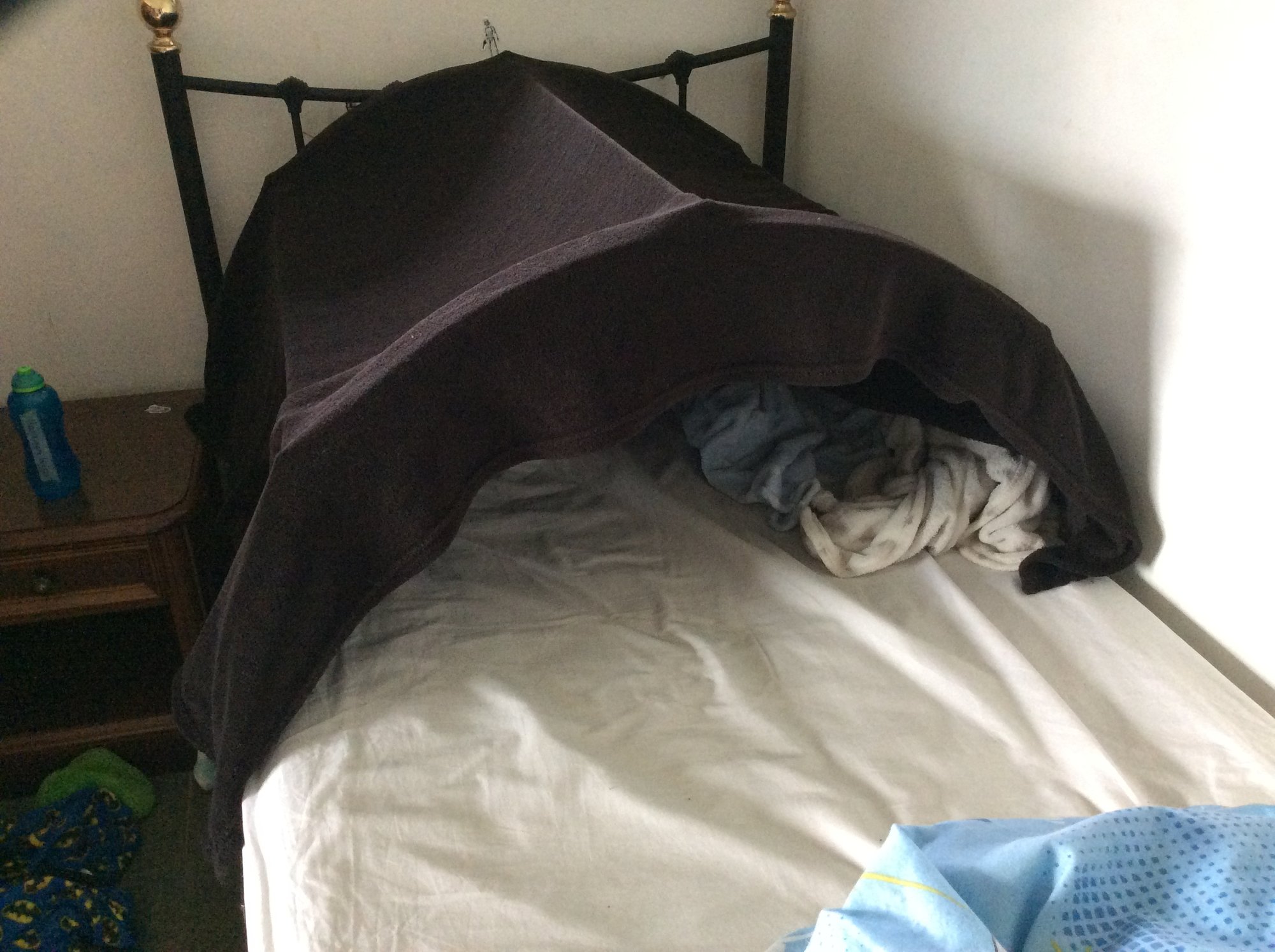

That's great, love that.View attachment 268487 View attachment 268488 As our other 2 sons have a bunk bed each! My youngest twin wanted a canopy,so I made this, he thinks he’s camping.
Just need some pipe lagging over the steel edges.

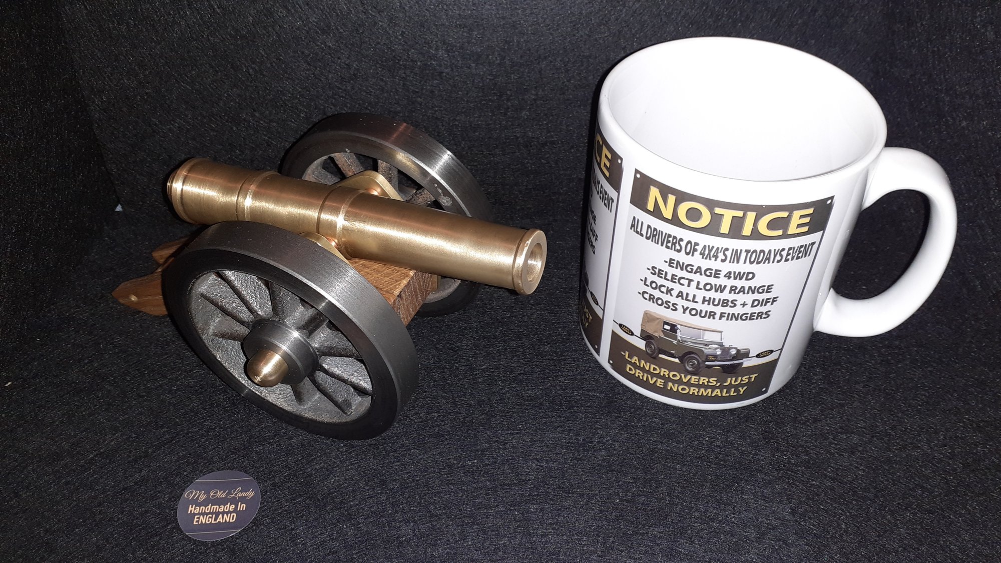

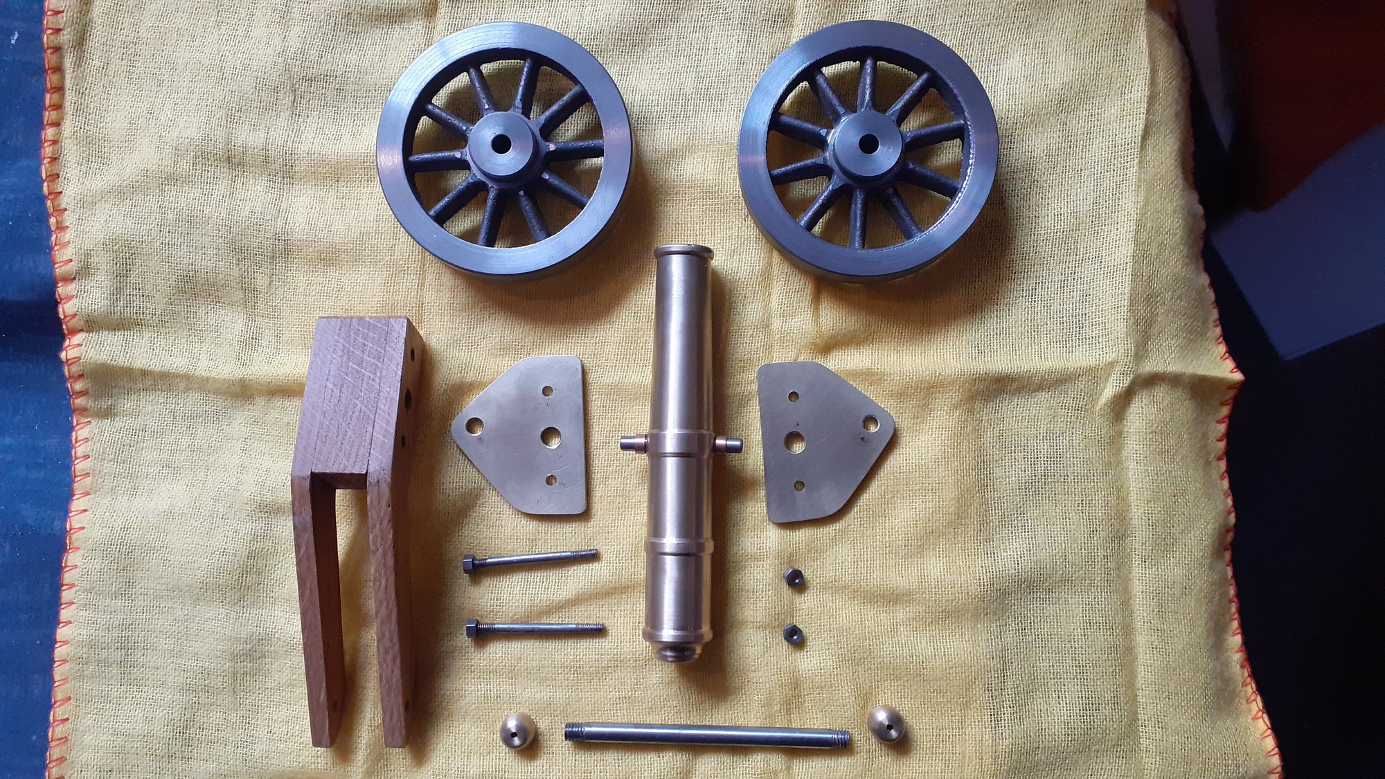

I have finally finished the canon
All the components laid out before final assembly.
Then all done, with mug for scale.
That's it, on to the next project........

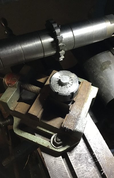

I quite enjoyed making this, shame it didn't work! 38mm hex, two 5mm holes for pins to dismantle an inner steering rack tie rod for re-shimming the play. A washer and nut hold it in place, another special tool should be used to hold the body but as it has three 1/4" slots I held it lightly in the lathe 3 jaw. It flexed my shiny new Snap On 24" breaker bar then sheared the pins.![]()
