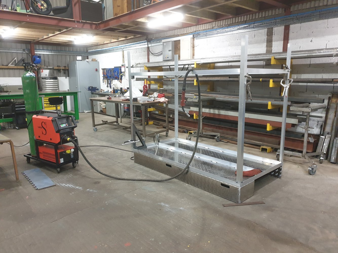

If it was on 100 mm hard nylon lockable castors you'd have storage space underneath too for strips of flat bar or thin tube .

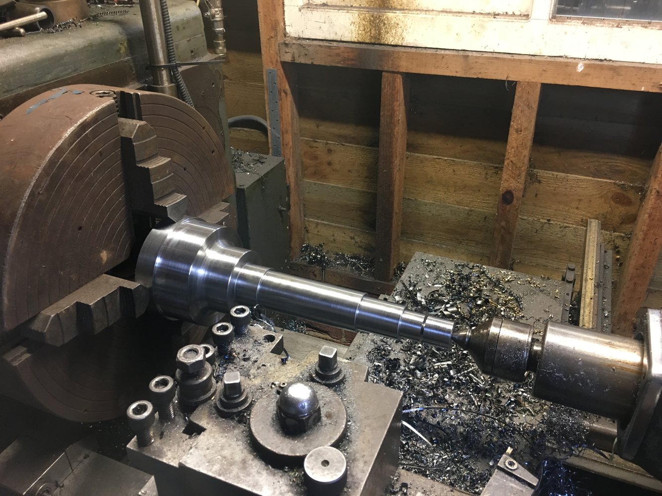

What's going on in this photo? And what is that tool please ???Today I made lots of swearing sounds.
These turned up earlier than expected and as some things that were expected hadn't turned up I thought I might as well get on with these.
They are segmented grabbers for a Capto tooling block. A real nightmare to fit.
They are No 6 in the below diagram. Trying to get them all held whilst I tried to get the O Ring on, then the split collars and all the time struggling for room due to the dished washer and spring. I would get 4 or so in place then fitting the next one a previous one fell out, took me a couple of hours.
Completed and ready for putting back into the body.
I then hacked up a VDI capto adapter I had made and welded it to a wedge holder, I faced off the wedge holder, some lovely fireworks with that.
Once done I had to mill a circular pocket in the top so I could get the adjuster in.
And fitted to the lathe with a threading bar inserted.
Just facing off some hardened steel.
