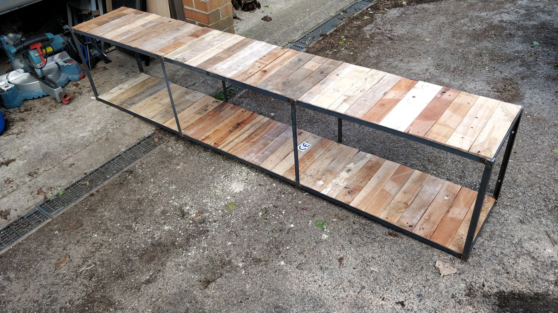

It's even CE marked..... nice you will soon fill it I expectMade a new big shelf for the garage to consume more stuff

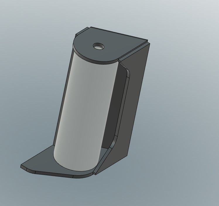

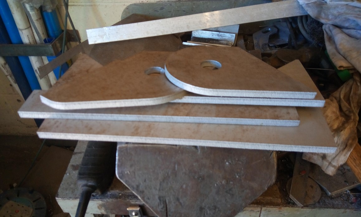

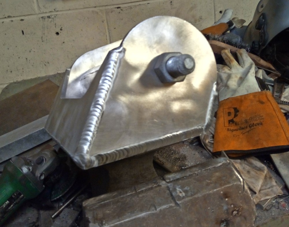

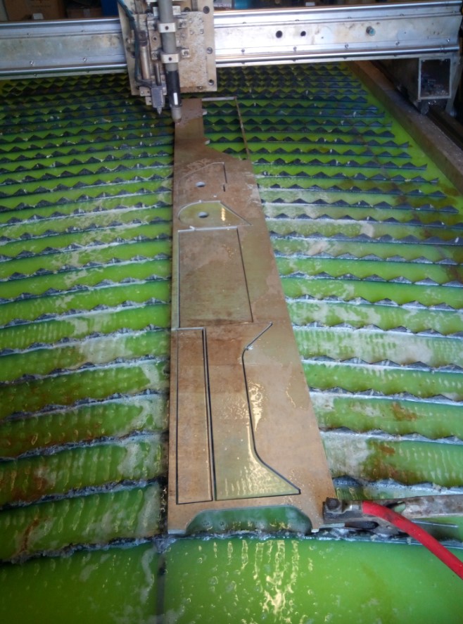

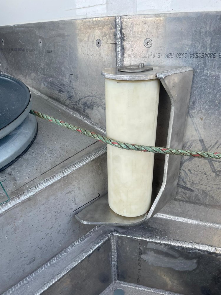

Nice tig work Hood.Last night I drew up a model in Fusion, it is for a side roller for a hauler, the roller is 100mm dia nylon and 300mm long..

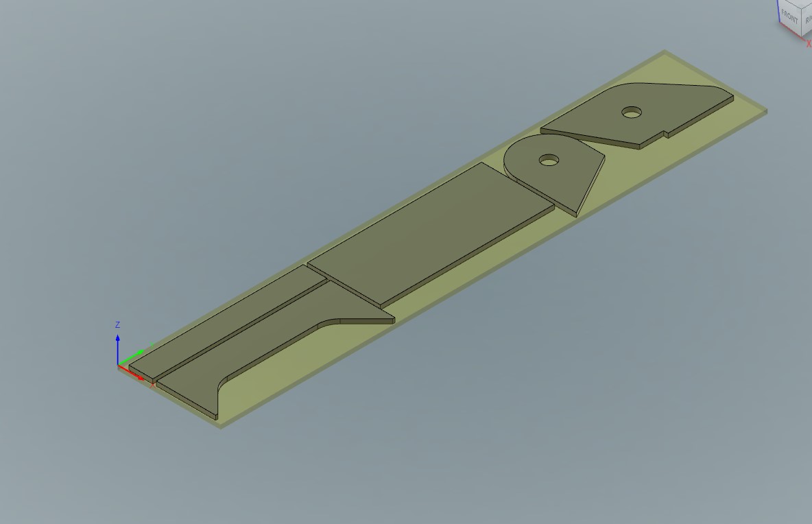

When I got to the workshop I looked out some 8mm aluminium and input the size into the arrange feature in Fusion so it could lay it out for me to then be able to choose the toolpaths and produce the code.
Then onto the plasma with the aluminium and cut it out.

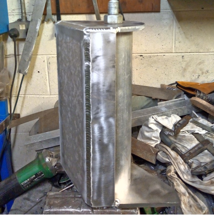

The bits ready for cleaning the edges for welding.
Normally I would Mig it but the Mig is not in the workshop at the moment so I thought I would give it a go with the Sherman, with it being 8mm I wasn't sure how well it would work as the Sherman is just 200Amp and I had just sold the Stealth 320 amp so couldn't use that.
Needn't have worried, it went fine and even had to lower the current to 190Amp. Granted it was outside corner joints but even still I was quite impressed with the wee blue machine.

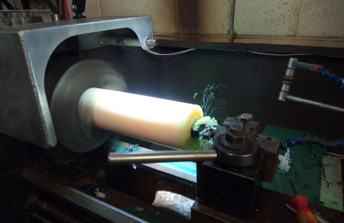

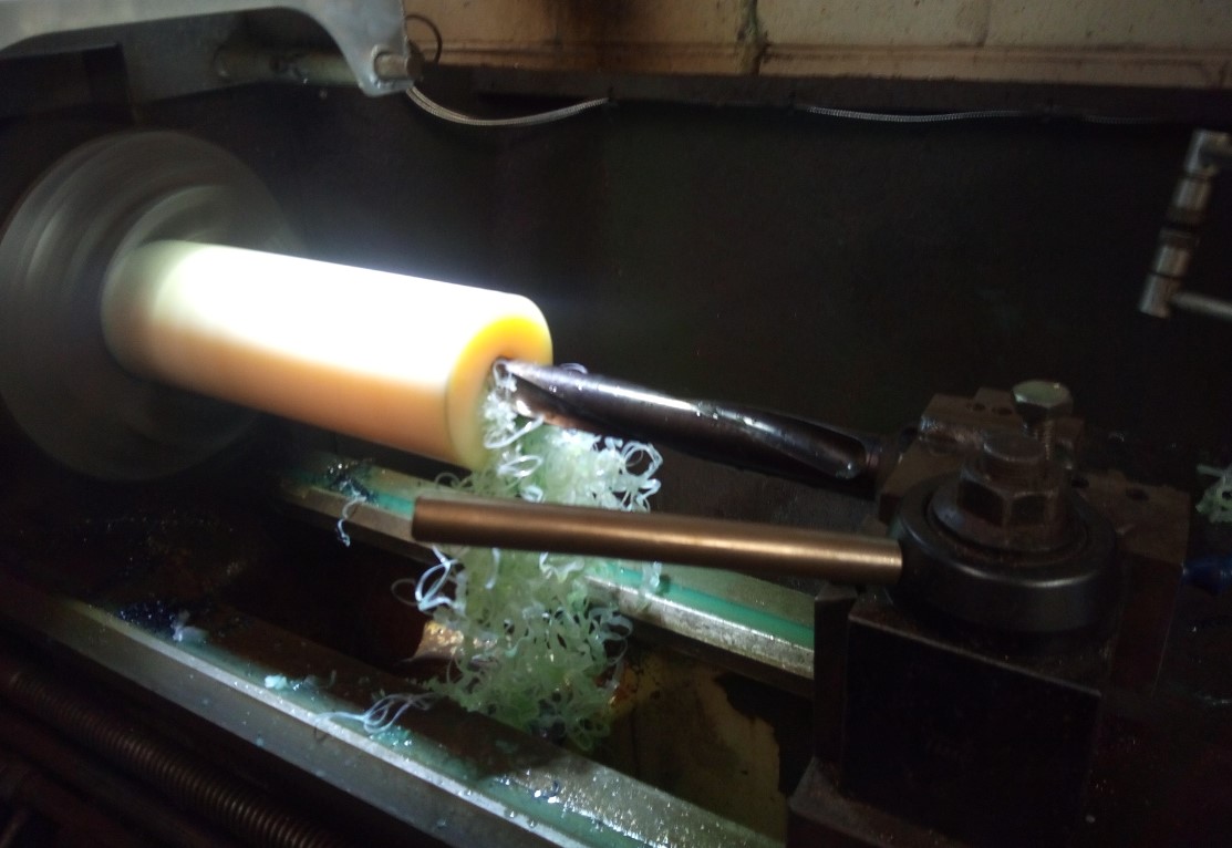

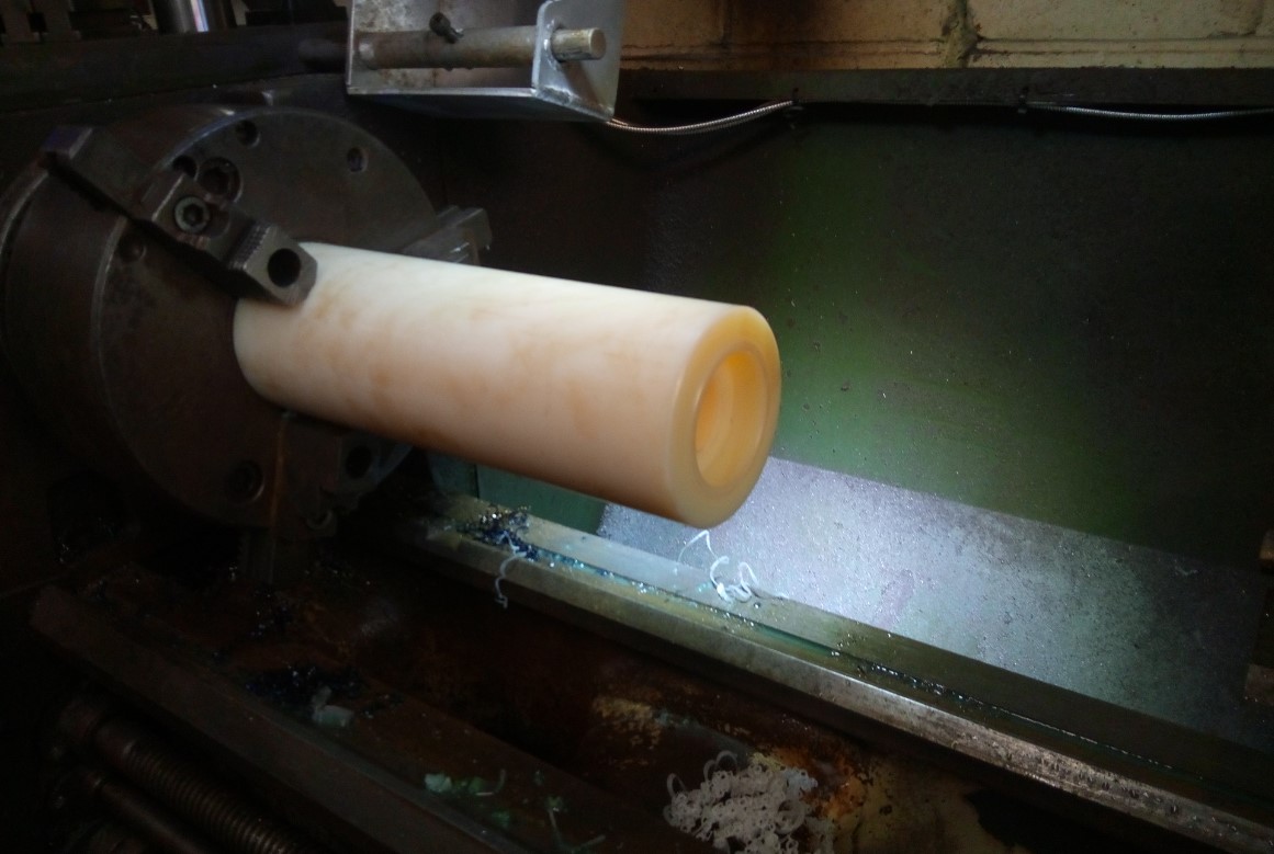

Next up I chopped a bit of Nylon, faced off the ends and then put in the spade drill to bore it out.

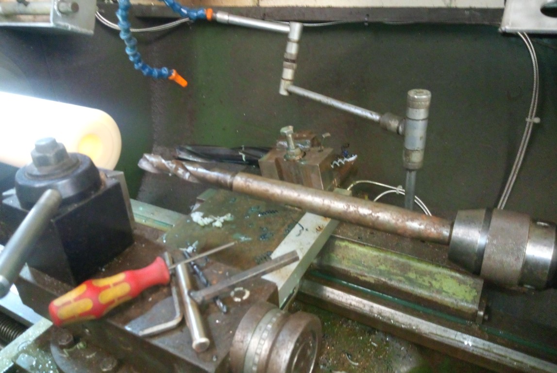

Spade drill however is less than 300mm long so wouldn't go all the way through.
So I grabbed a morse taper extension adapter I had turned the end down on and put in a drill, this allowed me to bore right through and thus I had a start hole for when I turned the roller around.
I then bored out for bearings both ends.
Tomorrow I should have the bearings and will make up the pin and then probably next week I will weld it to the boat.

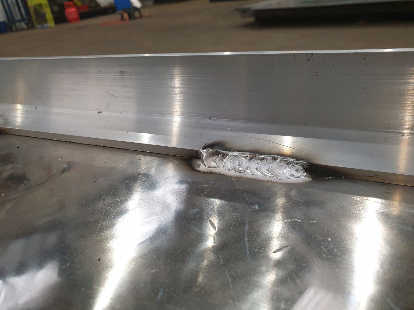

Starting to think he's got the hang of itNice tig work Hood.
I actually think I am needing some practice, don't do enough now due to the Mig being faster and reasonably neat.Starting to think he's got the hang of it

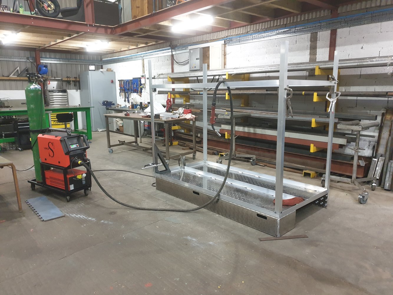

If it was on 100 mm hard nylon lockable castors you'd have storage space underneath too for strips of flat bar or thin tube .Made a new big shelf for the garage to consume more stuff
