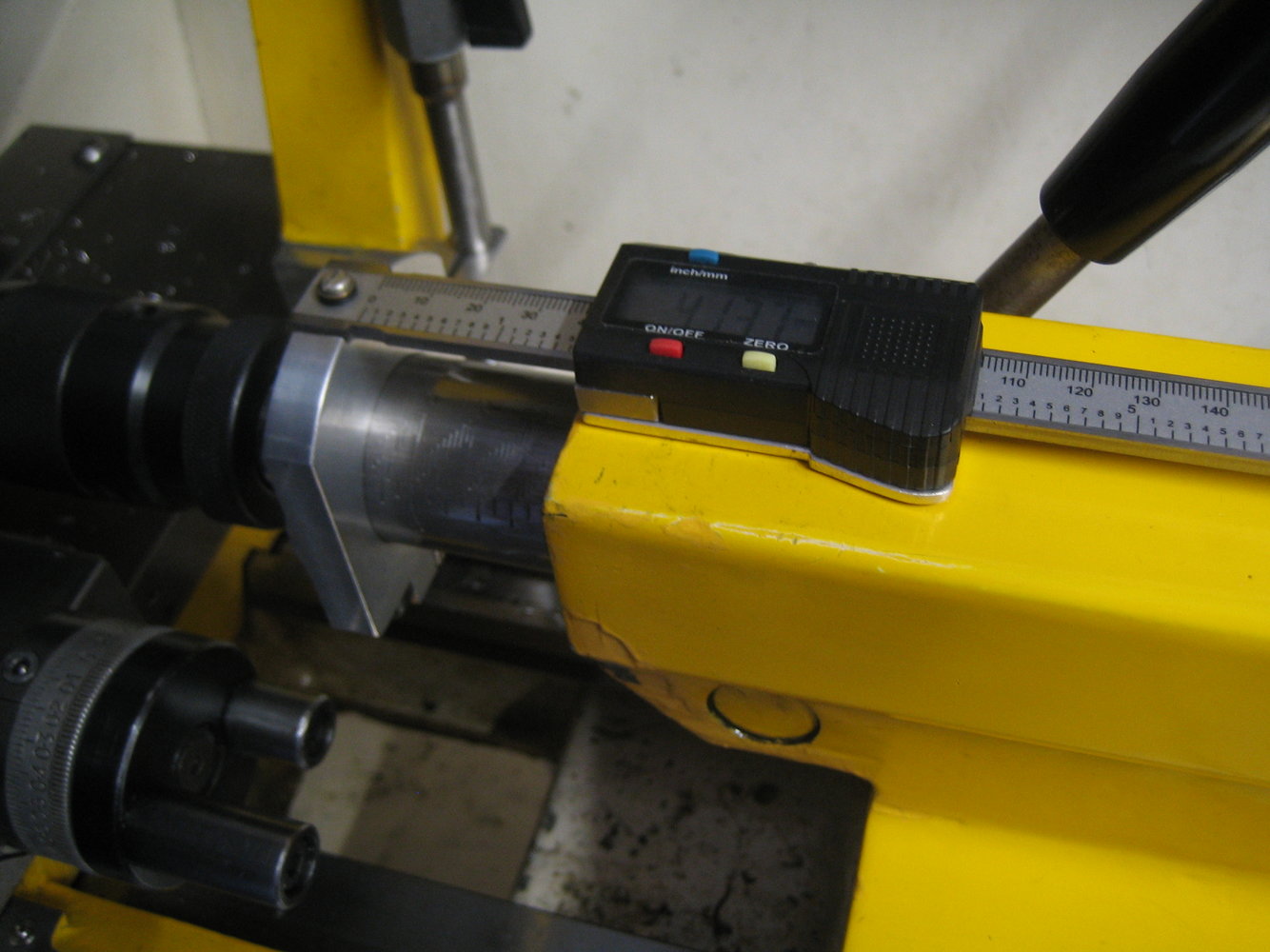

That’s really smartWell not today but just before I collected the Centec.

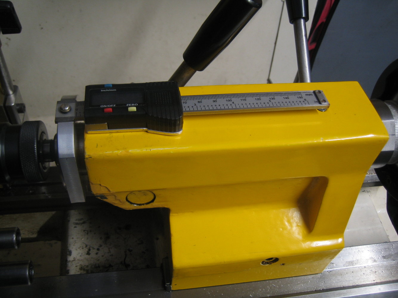

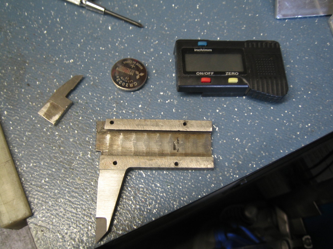

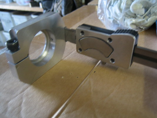

Following on from @Hood putting a DRO on his tailstock I invalidated the Lidl guarantee
Then did a bit more to it, fitted a magnet from an old hard drive and made a clamp!
So it fits like this
I once used a cheapo caliper for the manual Bridgeport but couldn't drill the bleeding thing even with a carbide drill, ended up welding a bit to the endWell not today but just before I collected the Centec.

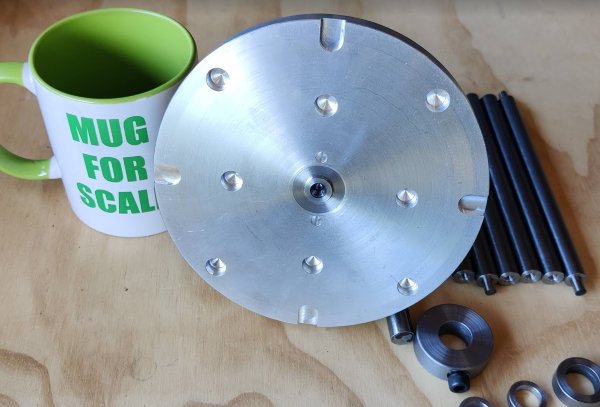

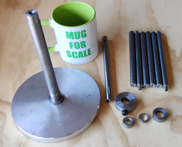

I love the "Mug for scale" mug, for scale. What's the faceplate for?I made a selection of round objects today:
The main shaft thing took two attempts as I completely c**ked up the diameter of the shaft and made it a beautifully close sliding fit in the hole in the aluminium disc instead of the need-an-oven-and-a-freezer interference fit I was aiming for. Second time was spot on though.
About 6' slim build and dark hair.How big is the mug?
