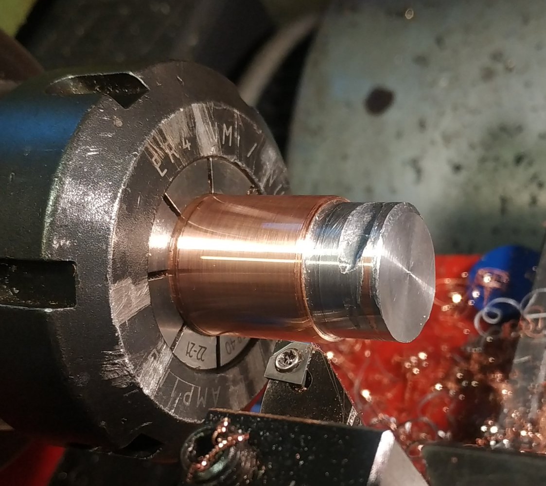

Lead to cold, plus may have poured to fast.Decided to use copper tube for the lead hammer. First used CuP to braze a sheet on the end. Im thinking I will keep this as a copper faced end that wont deform too much. Shrunk badly, must have had an air bubble.
Reheated, poured some more in and another ingot.
Turned copper off the lead end. Big air bubble. Used pcd insert. Lead tarnishes instantly.
View attachment 309133I will do another when I find my length of 28mm as this is only 22mm. 350grams.
Unsure best way to fit a handle. Im thinking to drill an oval hole and knock a wooden shaft in, but Im tempted to use it without. Will use mostly for tapping parts true in lathe.

I did warm it, probably not enough. It cooled a bit while I skimmed the slag off the lead.Lead to cold, plus may have poured to fast.
Did you warm the copper first?

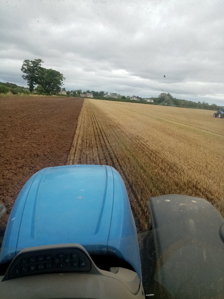

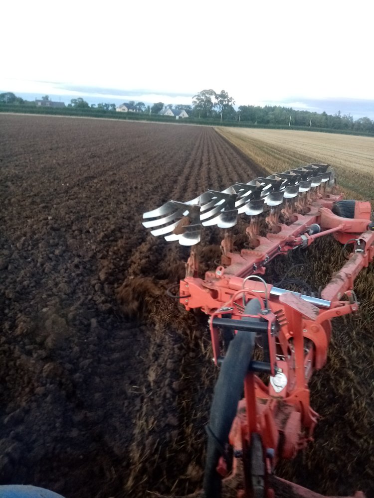

You don't need to steerI’d love to have a go at ploughing, though I can’t keep a straight line over 10m mowing the grass, so what I’d do to a field that size who knows…

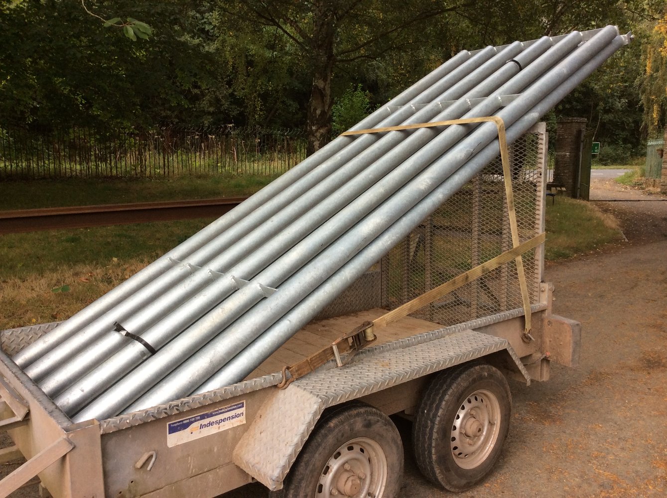

The first thing I thought of seeing that was a pali rocket launcher but the wrong way round!Collected from the galvanisers yesterday,2 piece cattle grid,farmer has his own method of fixing to the pit.View attachment 309177
