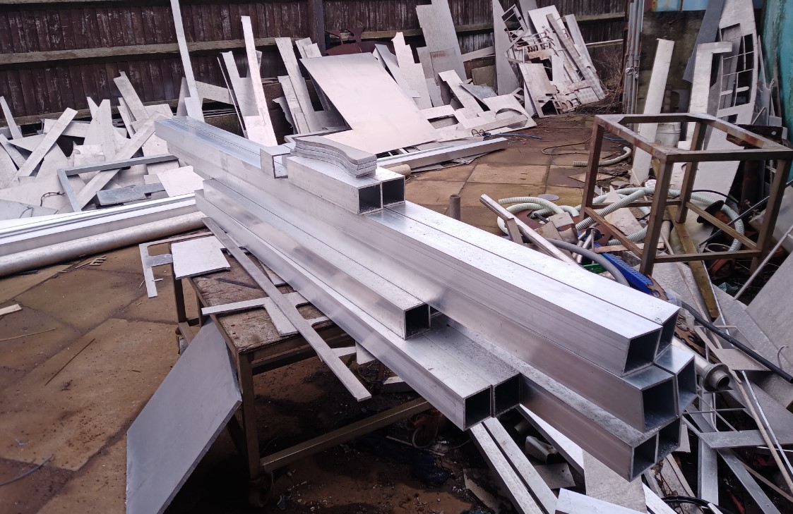

Got the box section for the hopper chopped up, also the 12mm plate for the stiffeners at the top.
Most of the box is just straight cut at the ends but the 4 gantry ones have angles at either end and are diagonal, so basically 12 degrees at one end and 6 degrees at the other. Made up a simple jig (just a piece of 12mm cut at 45 degrees) so that I could position the box diagonally in the vice which made life easy.

I don't suppose any of it's stainless, and jiffy bag sized?
