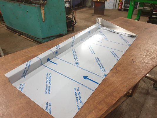

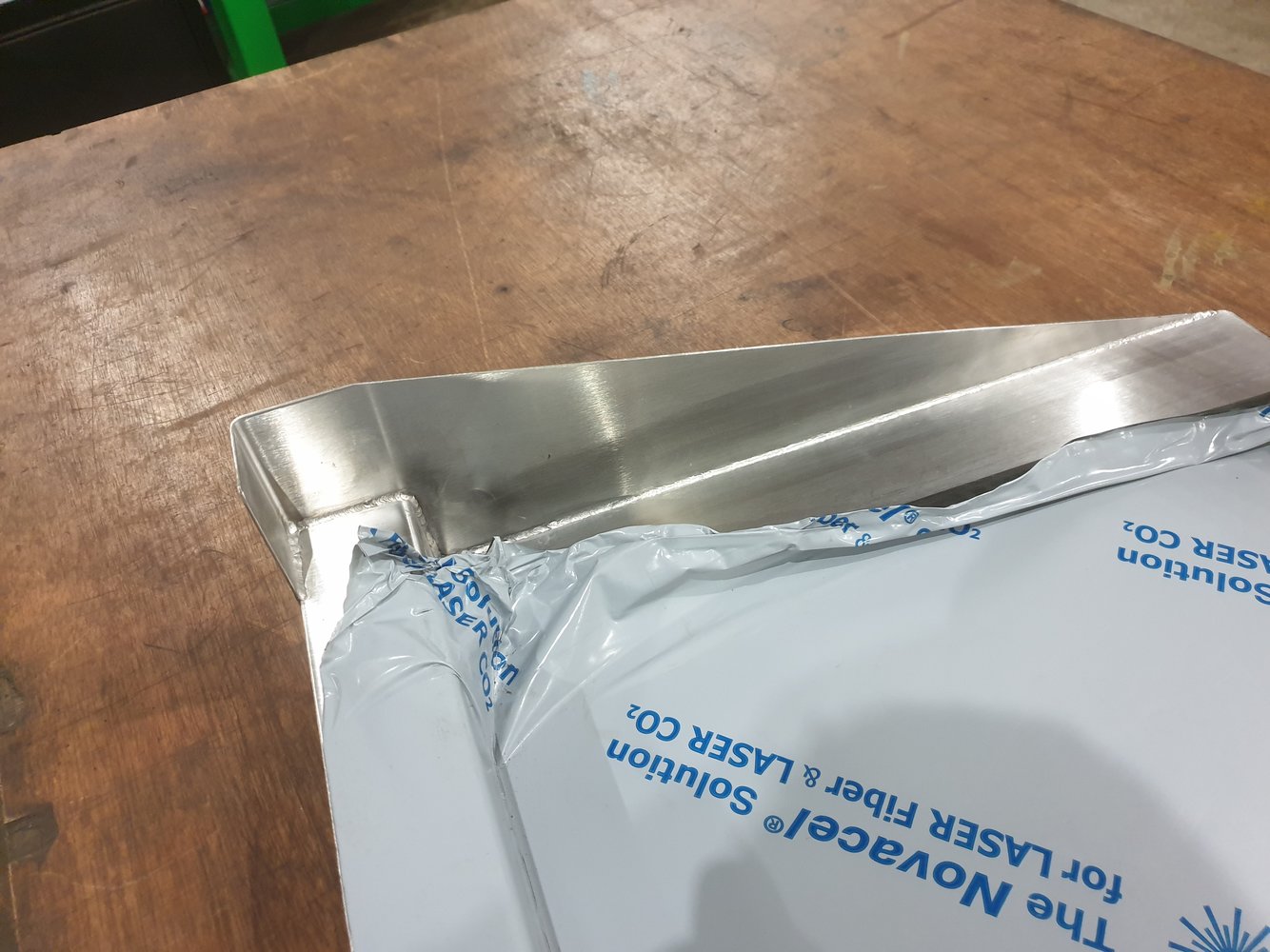

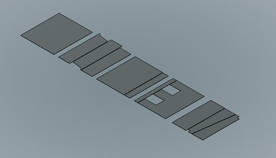

Planning some new way covers after melting the abs sheet. Ive cut, flattened and annealed the copper after photo but not decided if I will use vice or try making a wooden form to bend the V. It will fold up onto the saddle with some extra bits brazed on.

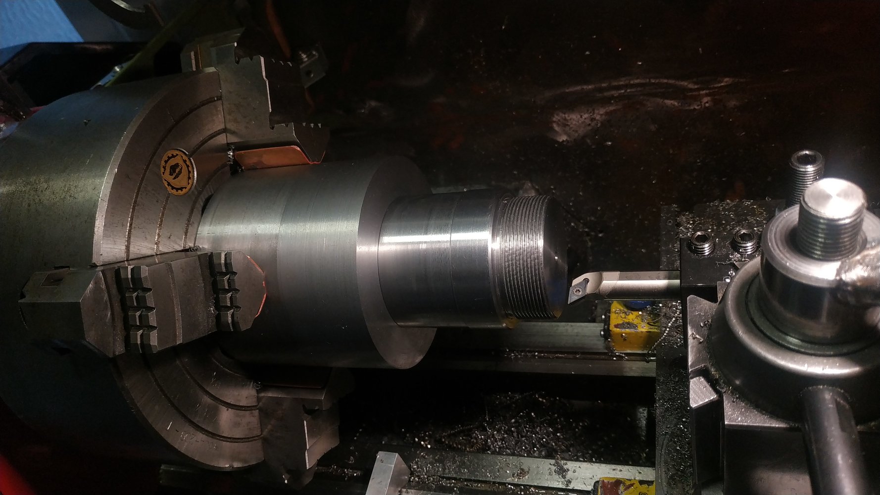

Now turning some usacut55 making a mini er11 die grinder collet chuck, 6mm shaft so I can hold the smaller bits, without them constantly pulling out!
